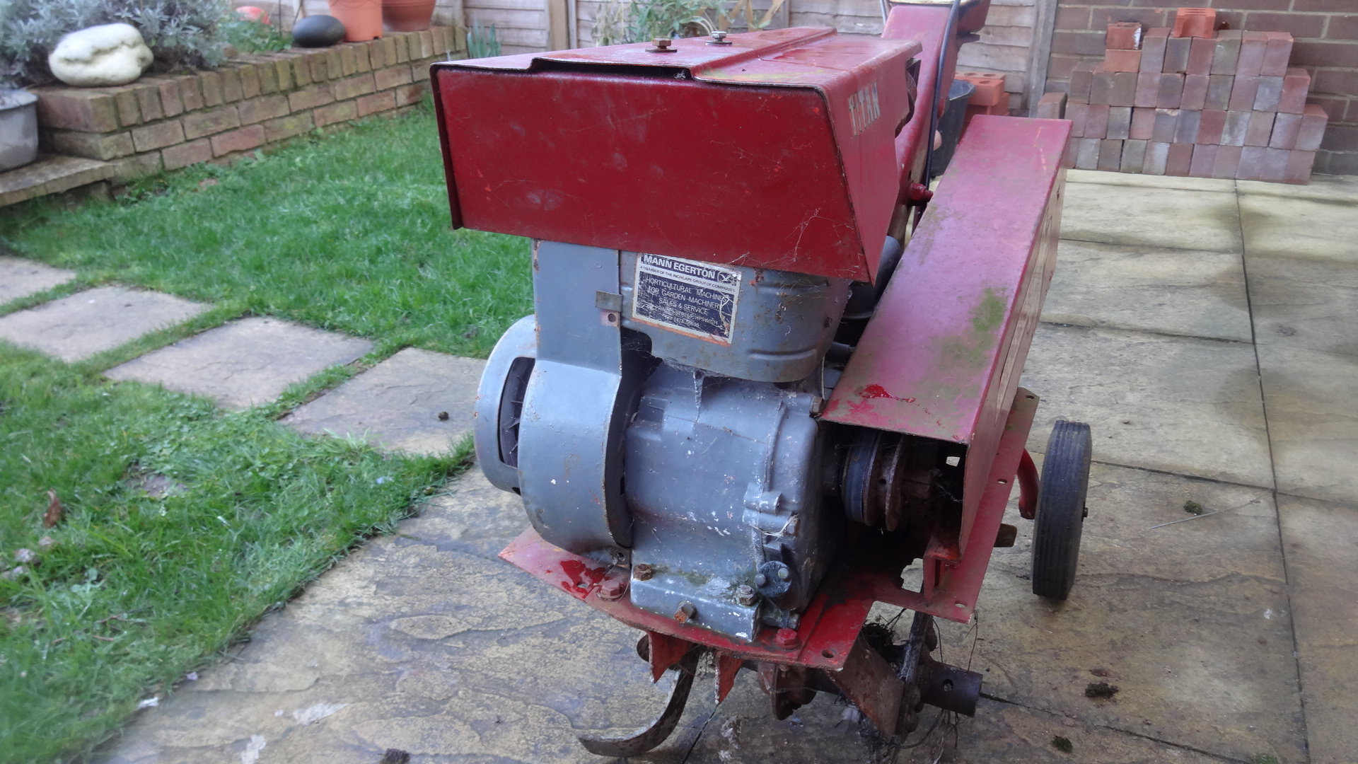

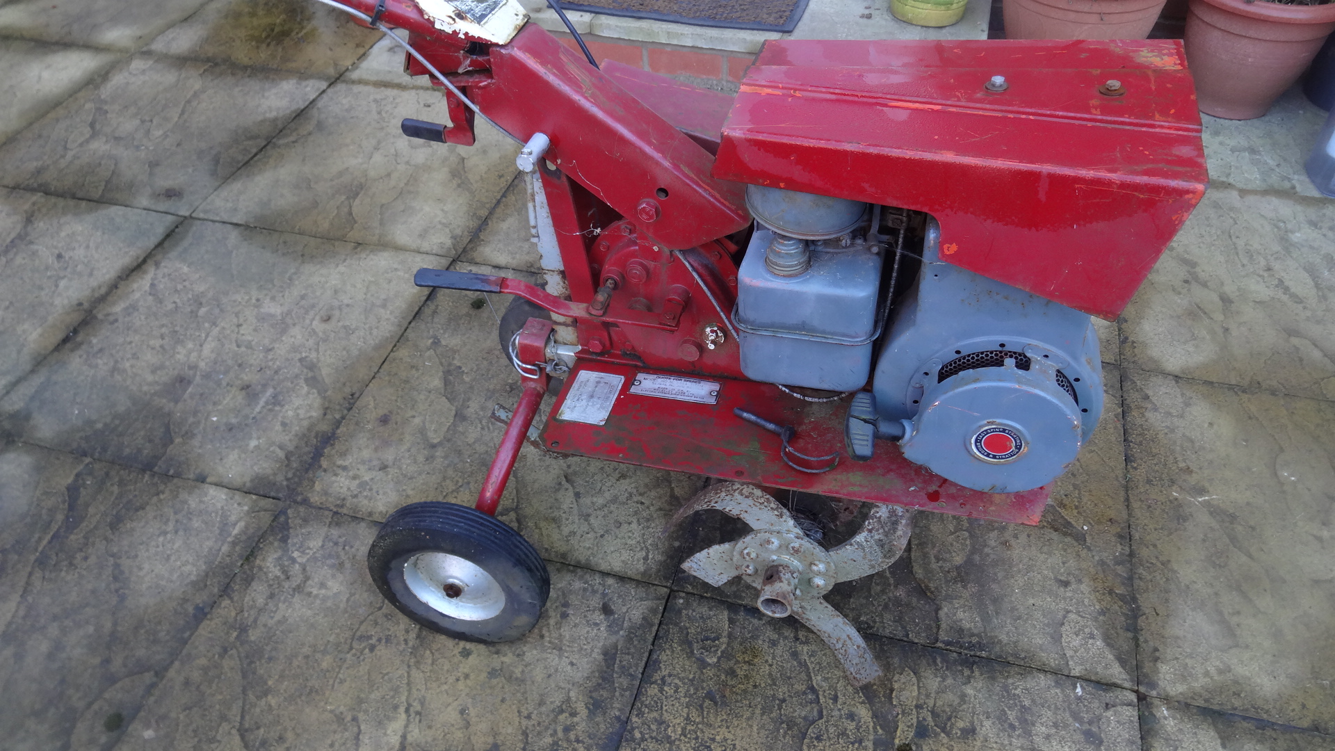

    Hi Guys I have a 1978 Wolseley Titan Rotovator that has given years of great service but has now developed a fault.
    It has no H/T spark & infact I have now misplaced the H/T coil so I need a new one but have no idea what the part number is to get on off the internet so unable to order one.
    Can you help with a supplier please ? Regards Ian

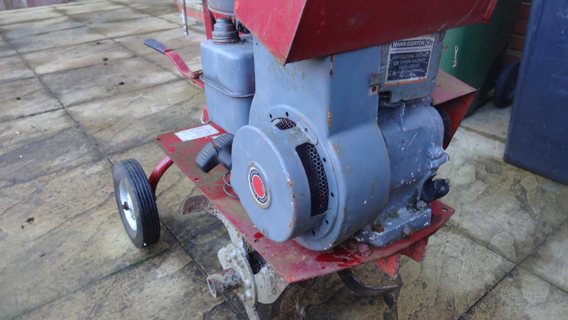

    I’m guessing that you have a Briggs and Stratton engine ? If so, stamped into the blower housing ( the shroud that carries the recoil starter) you should find the words Model, Type and Code. Below each word you should find a series of numbers. Assuming thayour engine still has the original housing, those numbers will identify it right down to the day it was made and even the production shift.
    This will determine the coil that you need. Pre ‘79 it is likely to be a points ignition magneto – that is, under the flywheel will be contact breaker points and a condenser. The good news is that a modern Magnetron, electronic ignition coil may be fitted, without having to dig around under the flywheel. Even better, most small engine / mower repair shops will have a box of good coils removed from scrap engines .

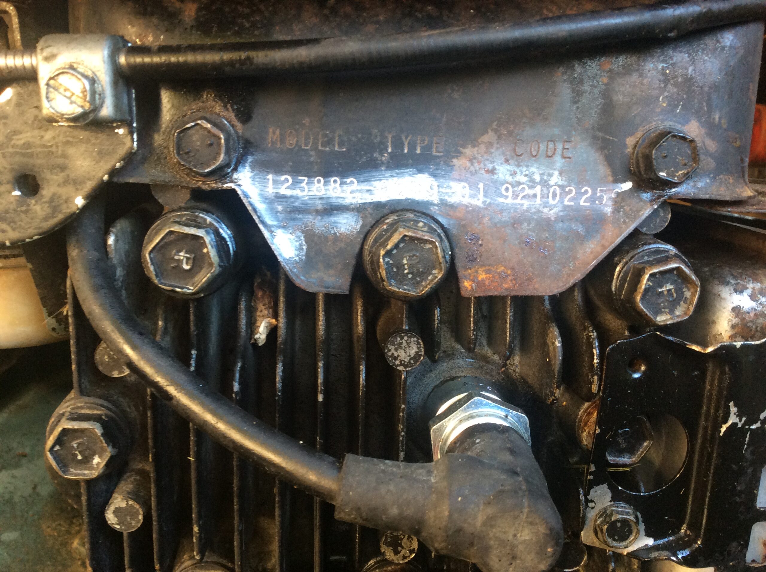

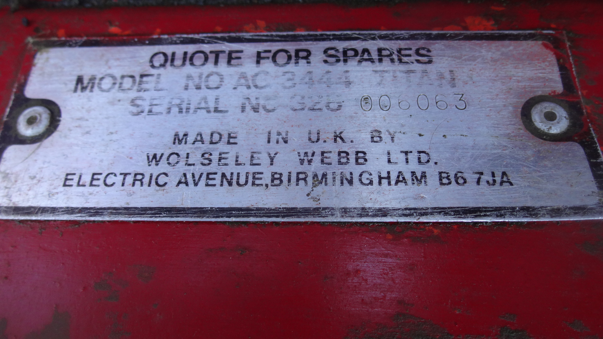

    Hi Wristpin thanks for your reply, I couldn’t see a number where you mentioned but there is this number 006063 on the data plate, is that the one ? there is also a number stamped on the engine which I cant read yet as its quite rusty where someone has previously rubber the paint off. regards Ian

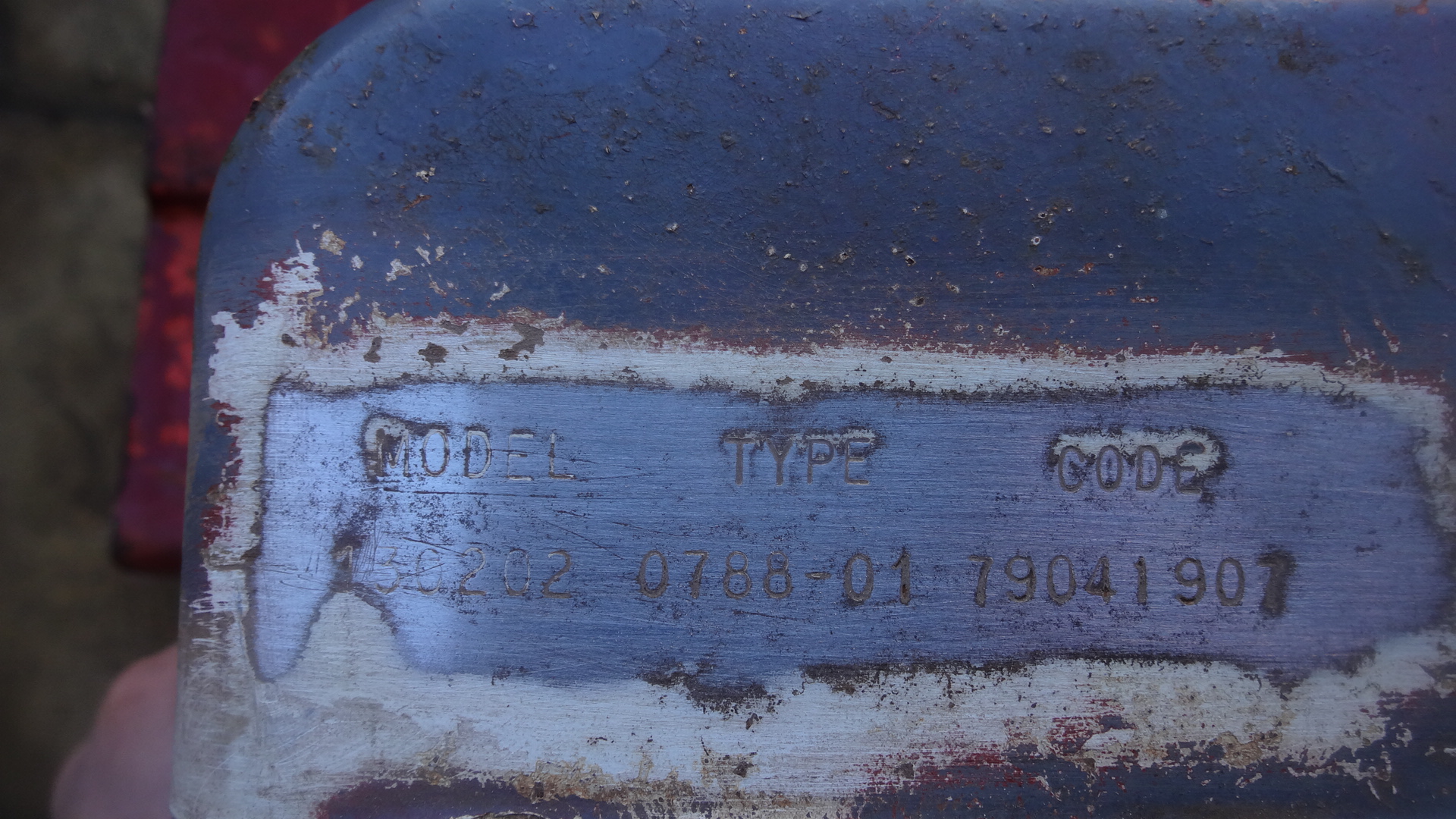

    Now I think I’ve got what were looking for ? it was stamped on the side of the recoil cover.
    Model Type Code
    130202 0788-01 79041907
    #30142
    This information may help see B&S website
    #30143
    That interesting, if I’m reading it correctly it was manufactured on 19th April 1979 ? and its 13 cubic inch etc etc.
    Can you tell me for that information what ignition coil I need ?
    Regards Ian
    #30148
    Your numbers indicate that you have a points ignition 5HP engine that would have been fitted with a 397398 coil which has been replaced by a 397358 Magnetron electronic coil that does away with the need for the points and condenser and may be fitted without removing the flywheel.Roughly £40 + vat)for a genuine BS one.

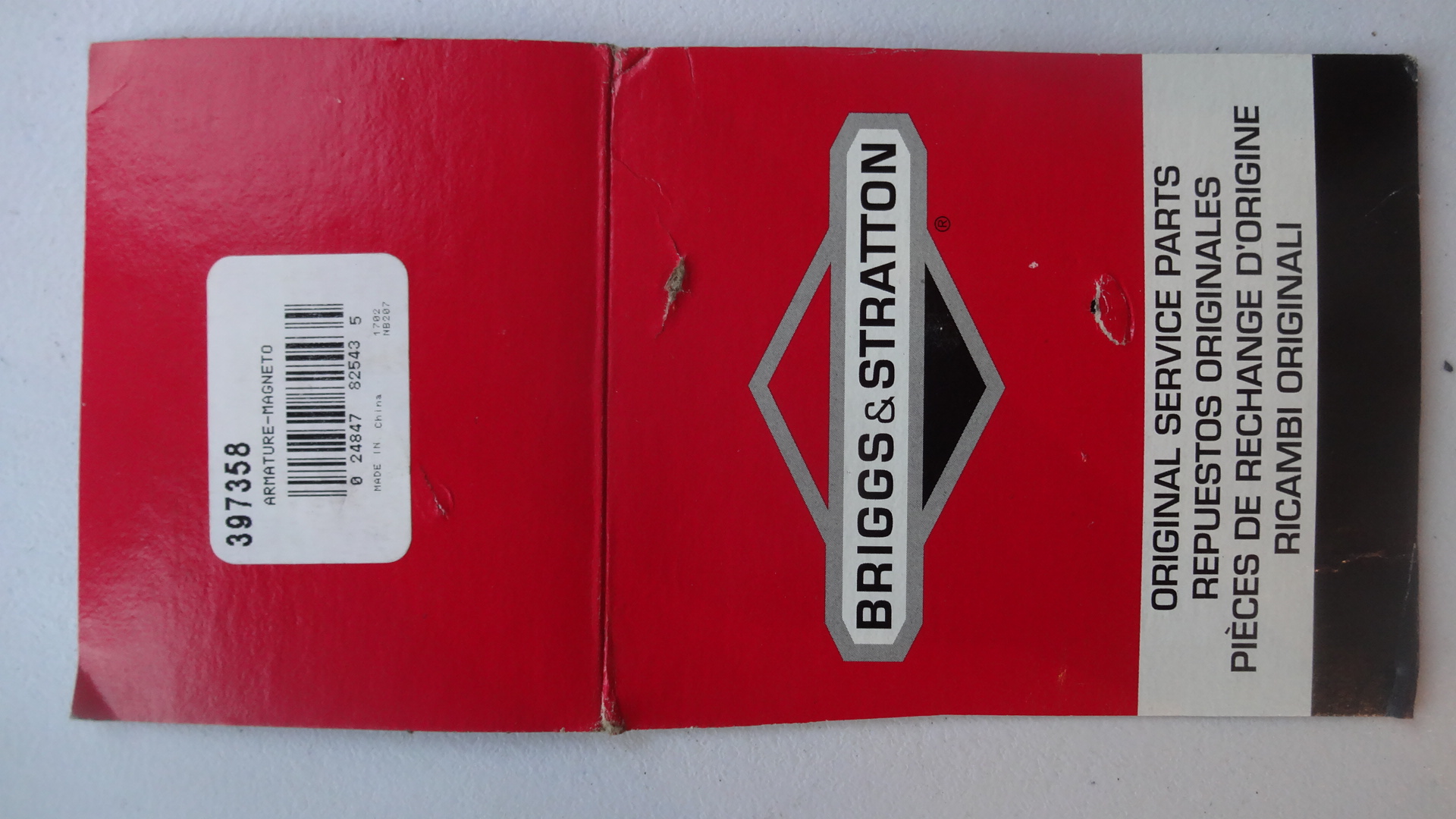

    But I decided to buy this one from China for £9.46 with free P&P only problem is it take 3-4 weeks for delivery. (e bay link removed by admin)
    Electronic-Ignition-Coil-5-HP-For-Briggs-and-Stratton-397358-5-HP-Engines-Model/142832951017?
    #30346

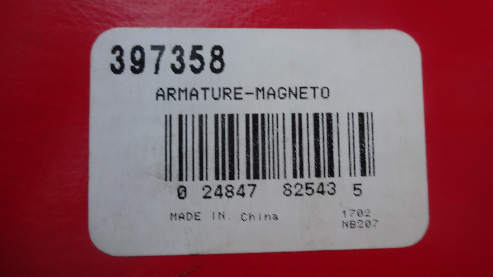

    Well my £9.46 ignition coil arrived from China and guess what ? it was wrong, the mounting holes were 64mm apart rather than 59mm.
    So I ordered a genuine one from a dealer at a cost of £45 and guess what ? it was made in China.
    Anyway my rotavator started 1st pull despite standing for over 2 years & having stale fuel.
    Lastly a big thanks to this forum & especially wristpin for his help.
