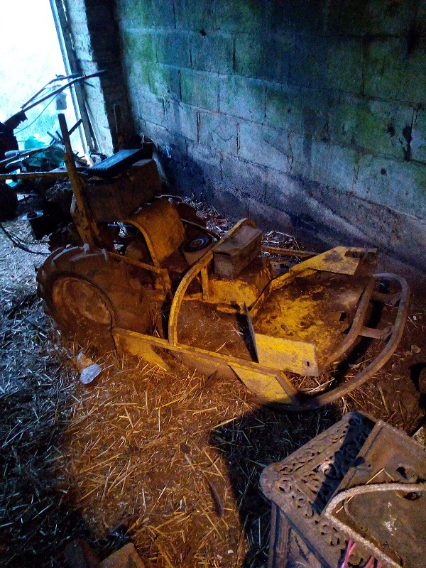

    Hi,
    I’m restoring a Wolseley Clearway. It’s been stood in a shed at my fathers house for 20 years.
    I’ve managed to track down and fit a new coil/points/condenser/air filter, and the engine now runs (10hp Briggs and Stratton). The hydrostatic transmission also works well. I’ve built a new deck, and bought new timkin bearings for the spindle. I would like to find out more about the machine, there is not much information on line. I have tracked down a spare parts booklet which is handy.

    Thanks to dorigny for your encouragement. I wondered why they fitted mudguards to some of them, I guess they prevented the branches from getting damaged by the wheels. It would have been interesting to hear more from the guy who’d worked on the Clearway development.
    I used the machine in the eightees. As you said it was very good for rough grass, with the hydrostatic drive, and large wheels.
    It had had a hard life before we got it, it belonged to a contractor, and was probably in constant use during the growing season.
    After getting the engine running, I’ve not been able to get to the machine due to the lockdown. Fortunately I’d brought the old deck home, so I was able to order a laser cut steel disc etc, and get on with the deck fabrication.
    I’ll post some more pictures when I get back to work on it.
