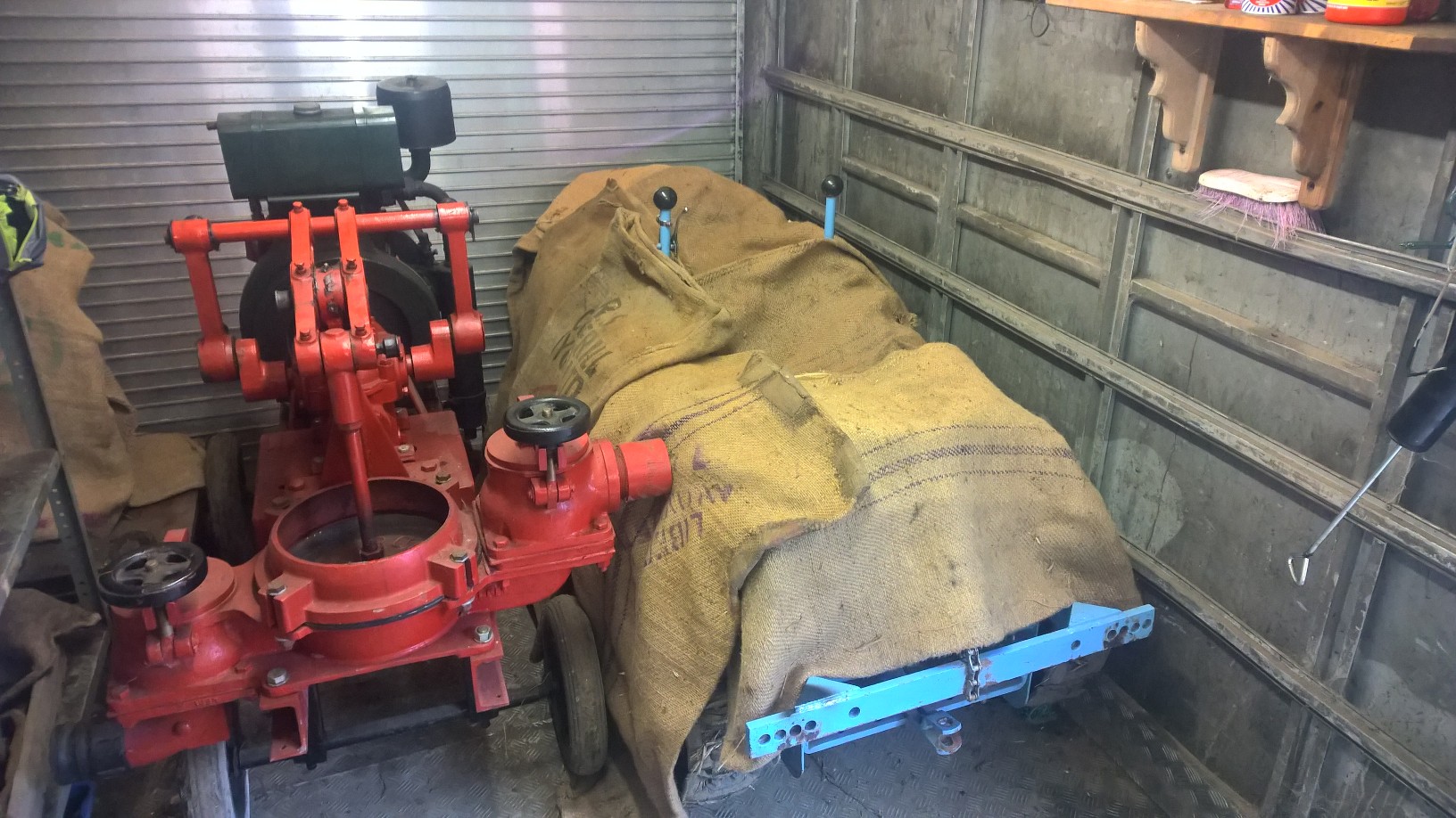

    Thanks wrist pin been thinking I will do the oil in bore just a ligth coating of sae30. Hadn’t thought about spraying the carb and exhaust only sealing after expeatfarmer said about mice but don’t suffer pest issues. It’s more the fuel tanks that’s causing issues as I have two on the mg as its tvo. The main one is just going to get brimmed with tvo when it gets parked up. And think same with petrol one. Still open on the idea of this fancy fuel as I’ve normally just used ultimate unleaded and been fine when I get back in spring , some times drain it and mix 50-50 with new and use on Morden machines.
    For damp i luckily have a 40ft ex fridge box that’s fully insulated and my workshop isn’t to bad just the little shed suffers. I fine the hessian sacks work really well I’ve used for about five years. They keep dust and muck off and act as insulation layer and and damp then do get they keep rather than it getting to the machine. Then let them air in summer.

    #22698
    All tucked away for winter
