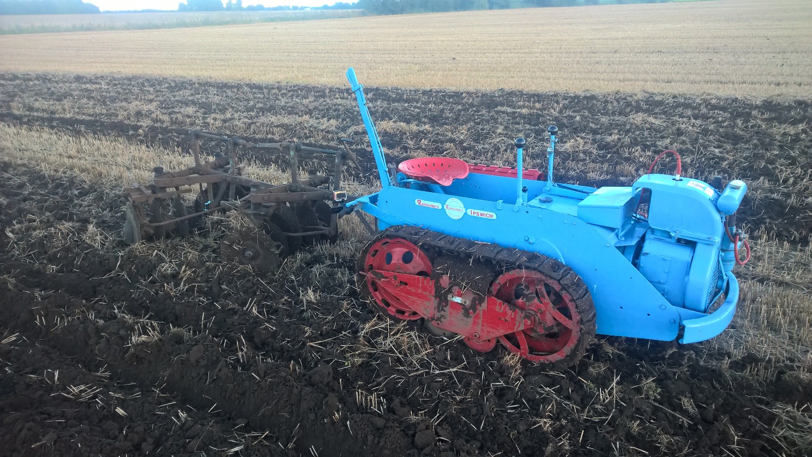

vhgmcbuddyMemberHello after any tips for storage of a ransomes cawler over winter. Was going to do same as I do with my Howard machines and engines. Which is spray with duck oil grease/wax oil and bright parts and cover with hessian sacks. This be first year I have wintered a mg cawler and would like to be okay in spring without to much trouble. It will be in a shed dry.
I will not be able to start or run it for about 5 months.
Thanks for the help
