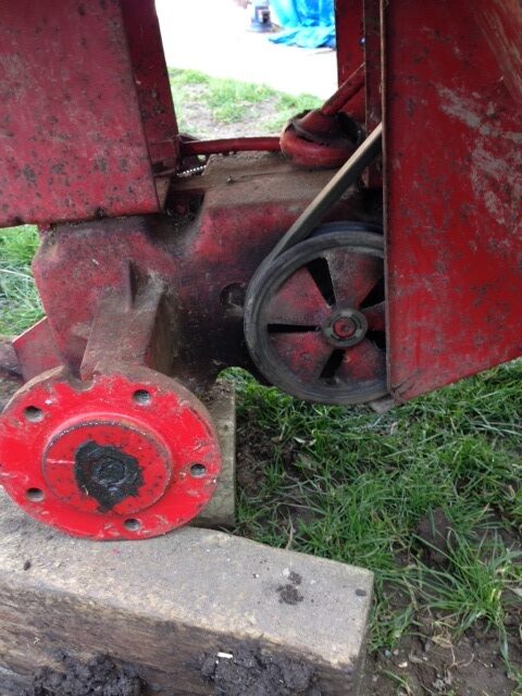

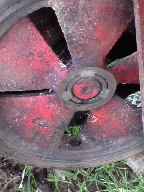

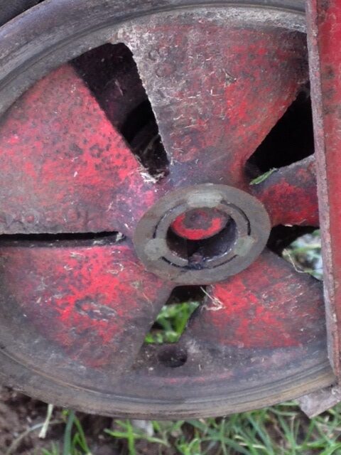

    Is the drive Pully on a Wheelhorse Command 800 supposed to be ‘floating’?
    See pictures, Pully moves about freely on shaft.

    Seem to remember that there’s a grub screw in the reverse side of the pulley hub – so no, it shouldn’t float!
    #12560
    Wristpin is right. If you look up Toro master parts viewer, Model No 1-0130 you can see the pulley.

    All fixed…while up doing safety boat duty I took my tools…..some days are Luckier than others..I found the grub screw hole actually through the Pully V where the belly runs, took a small Allen key to see if anything was in the hole….it located, was right size, one nip and all sorted….
    ….how many times have we fiddled and struggled, well today was payback, two mins and all fixed….thanks guys…
