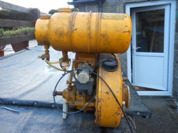

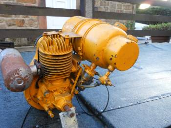

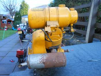

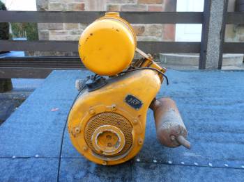

vhgmcbuddyMemberHi, today I fetched a job lot of engines bought on a well know auction site, included were 3 “new” JAP 2 stroke engines, it looks like they have been run for a few minuets only as there is just a bit of burnt damage on the silencer and around the exhaust port, does anyone know what these could have been fitted to ?

ParticipantLook like a 16H model , they were fitted to Landmaster (150 model I think) rotavators , can’t recall seeing them fitted to anything else. I’m sure some of the lads on here will know of more.

vhgmcbuddyMemberI checked round the engines and couldn’t find a number, there are 4 holes in the cowling which looks like where a plate could be but seems they havnt been numbered from new. It seems unusual to have a separate oil tank, an early version of autolube, and a mix tap where the oil and petrol mix before the carb, so this may be a clue as to what they are off.

will-haggleParticipantHi Sten, E is the year, 1942, according to my info… It was made for paraffin, the small tank is for starting petrol, they made a petrol/paraffin version for Landmaster, my list says it should be a type 5. Normally my type number list goes up to 15, so a type 26 doesn’t appear…
The full list of types for 16H are as follows:-
16H type 2 – Landmaster, L150
16H type 5 – Landmaster, L150 (TVO fuel)
16H type 7 – Various, JAP Standard, (less governor)
16H type 8 – Jackaroo Go-kart (Villiers Nameplate)
16H type 9 – Landmaster, L150 (Rope Pulley Start)
16H type 10 – Various, Go-karts (JAP Standard, less governor)
16H type 11 – Various, (JAP Standard, horizontal C/shaft)
16H type 14 – Landmaster, L150 (Rope Start and Landmaster’s Fram air filter)
16H type 15 – Landmaster, L150 (Recoil Start and Landmaster’s Fram air filter)All others were 16V, vertical crank for outboards….
