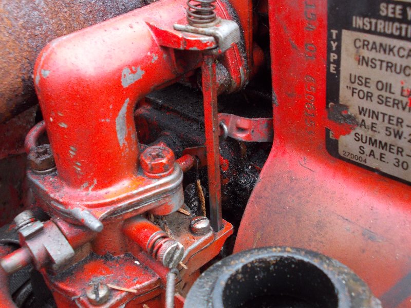

vhgmcbuddyMemberHi, I am new to vhgmc and I am hoping someone with knowledge of early Westwoods will help me roughly identify or age a sit on that has just come my way via ebay for renovation. I can,t find any model or series plates under the seat or under the bonnet. the same applies to the Briggs & S engine though I might see the marking on the engine after de-greasing. The bonnet is orange, plain (no raised boxes) with square edges it is locked down by an over the centre sprung clip. Black front grill with headlights. There is a black spare petrol tank mounted between driver legs. I have had a look at my neighbours Westwood which looks almost the same but has no bonnet clip, no headlights, no spare tank. I notice his tractor has rounded control knobs where as my one has square knobs. I am hoping by approximately ageing the tractor I can look at a parts list for parts recognition. Thanks in anticipation

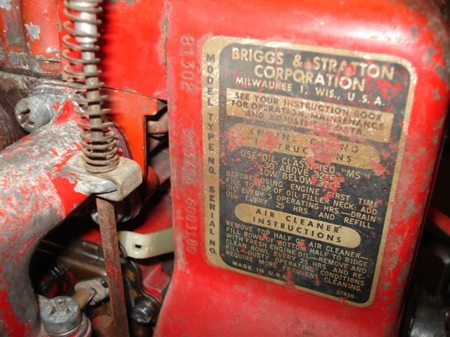

will-haggleParticipantBriggs and Stratton engines have a date in the engine number. This is a link to their site where you can de-code your engine number. https://briggsstratton.guided.ss-omtrdc.net/?q=*&do=faq It is stamped into the cowling….
June 28, 2015 at 12:05 pm #13613
stuartParticipantIt will be mid 1980,s.Providing its still the original engine fitted (or cooling cowl fitted) then its easy to date the engine as the reply above.

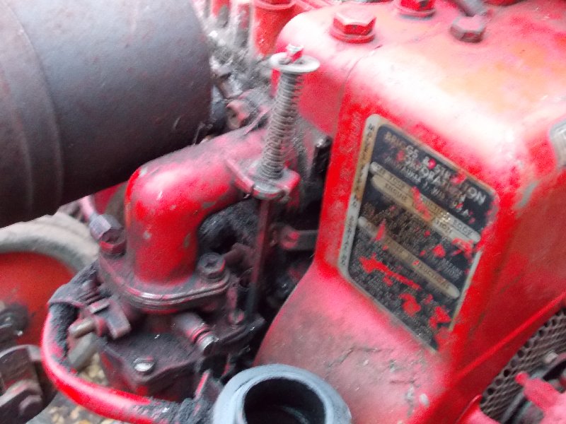

vhgmcbuddyMemberStill haven’t found the engine number on the side of the cowling, it might be hidden by the petrol tank that raps itself around one side of the engine or hidden by the air filter on the opposite side. Engine is as shown in the early 1980’s parts lists and diagrams.

stuartParticipantThe engine model,type and code numbers should be stamped at the front of the cowl (just above the spark plug).If its had a new cowl fitted in the past then there will be NO numbers stamped on it at all.
The 11hp B&S engine is i think a 25cui (25 cubic inch capacity) engine so your model number stamped on the cowl should start with 25####

vhgmcbuddyMemberI have found the area where the engine number should be but someone has ground the number away, but it still has the indentations on the underside of the metal, not quite readable.I would like to think the cowling has been taken from another engine as a replacement part and the numbers ground out to stop wrong identification of engine, but as the tractor recognition labels are also missing I have my doubts and learnt a lesson from my first attempt at renovating old machinery. I am now hoping that as the renovation progresses, a job for this coming winter any parts I need I can identify from the 1981 – 1985 parts diagrams. Thanks for your help once again.
