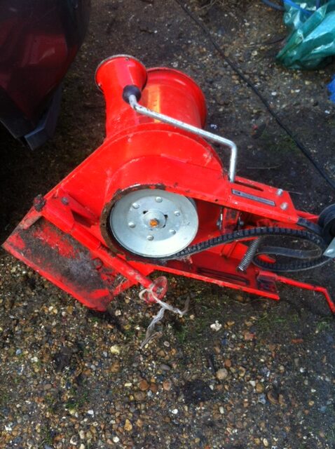

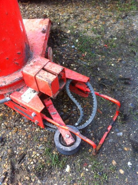

    Just exchanged emails with a friend who used to work for Westwood and he confirms that the only chipper of that era was side mounted. A square section spigot bolted to the chassis and a mating one on the chipper which he says was a copy of an Alko one.

    This is the beast! think made 89/90 guess I will be making a mount for it!

    I can see where this mounts , anybody have the square mount they can photo or even sell me ?

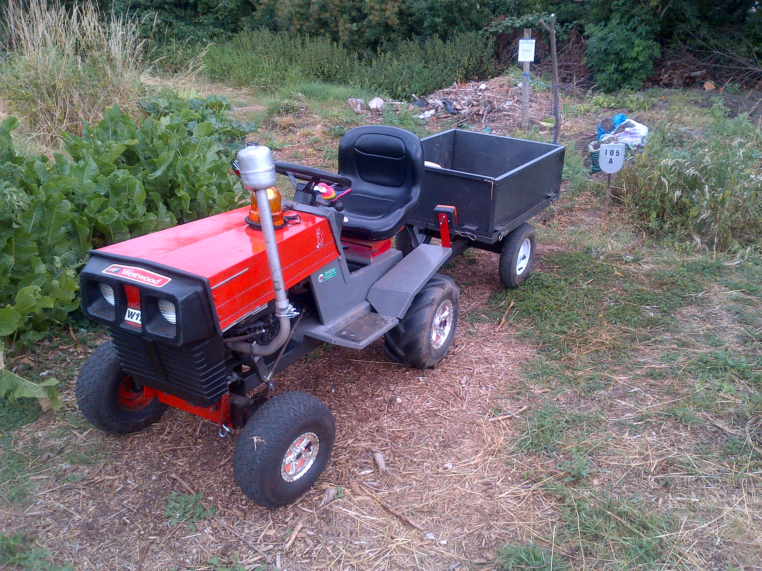

    Hi Westie
    Sounds interesting . I have an ancient Gazelle W11 Which is or was a side discharge possibly I’m trying to ft the mounting for the rear grass collector . I want to do this to fit the transport box I have waiting in the shed I believe this is another unusual attachment and was not really designed for the earlier Gazelle But I have a drill and a hammer !!!
