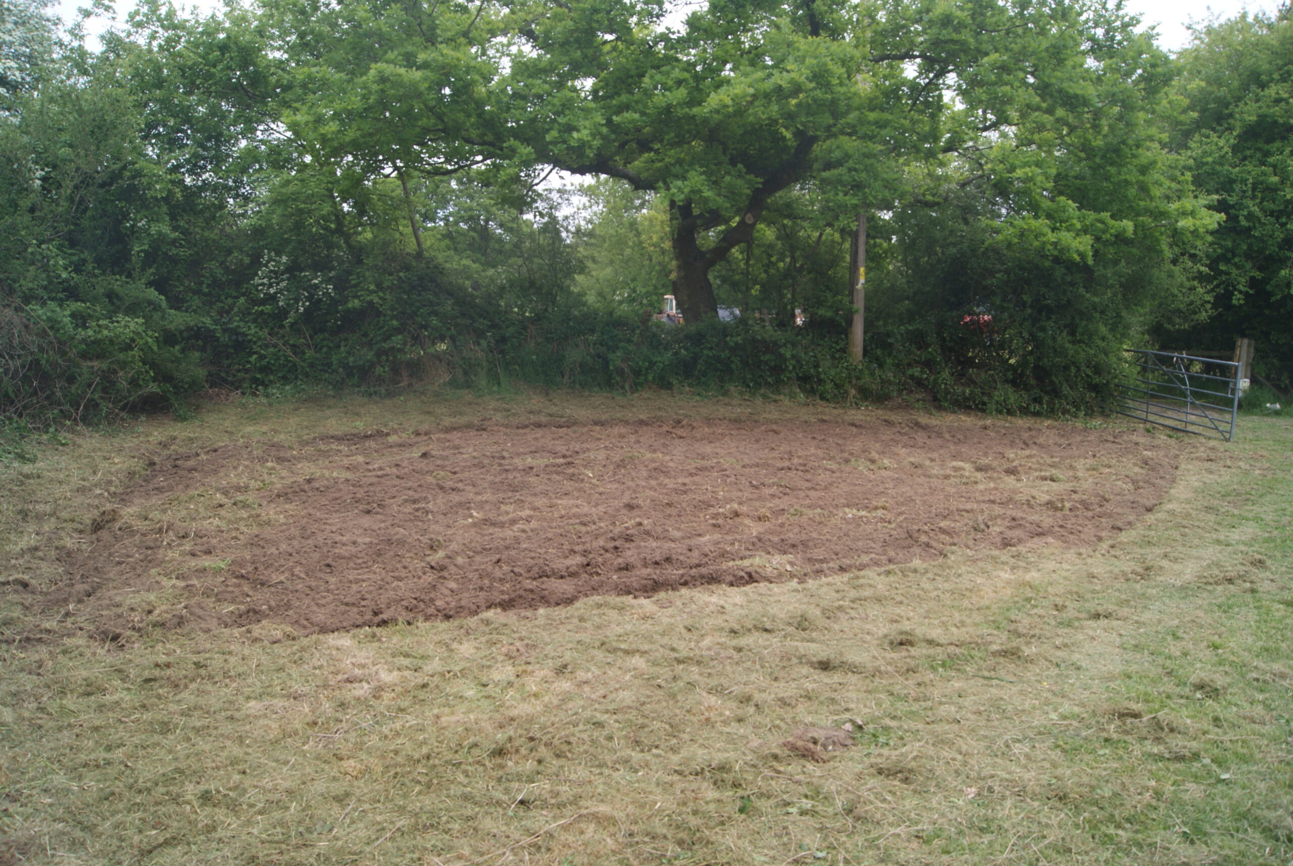

    Those of you who remember Wartime Farm on the telly will know that the storyline with the Trusty was to plough, cultivate and plant a small patch of ground in order to grow a crop of beans as a part of the “Dig for Victory” campaign.
    Earlier on this week our great friend who owns the farm where we keep the horses/chickens/tractors said that someone had given her some seed potatoes but she had nowhere to plant them. After batting a few ideas around between us we came up with the idea that there was a corner of one field that was just made for the job- it couldn’t be grazed because there was a track that went diagonally across the corner, leaving this piece of ground cut off from the rest of the field.

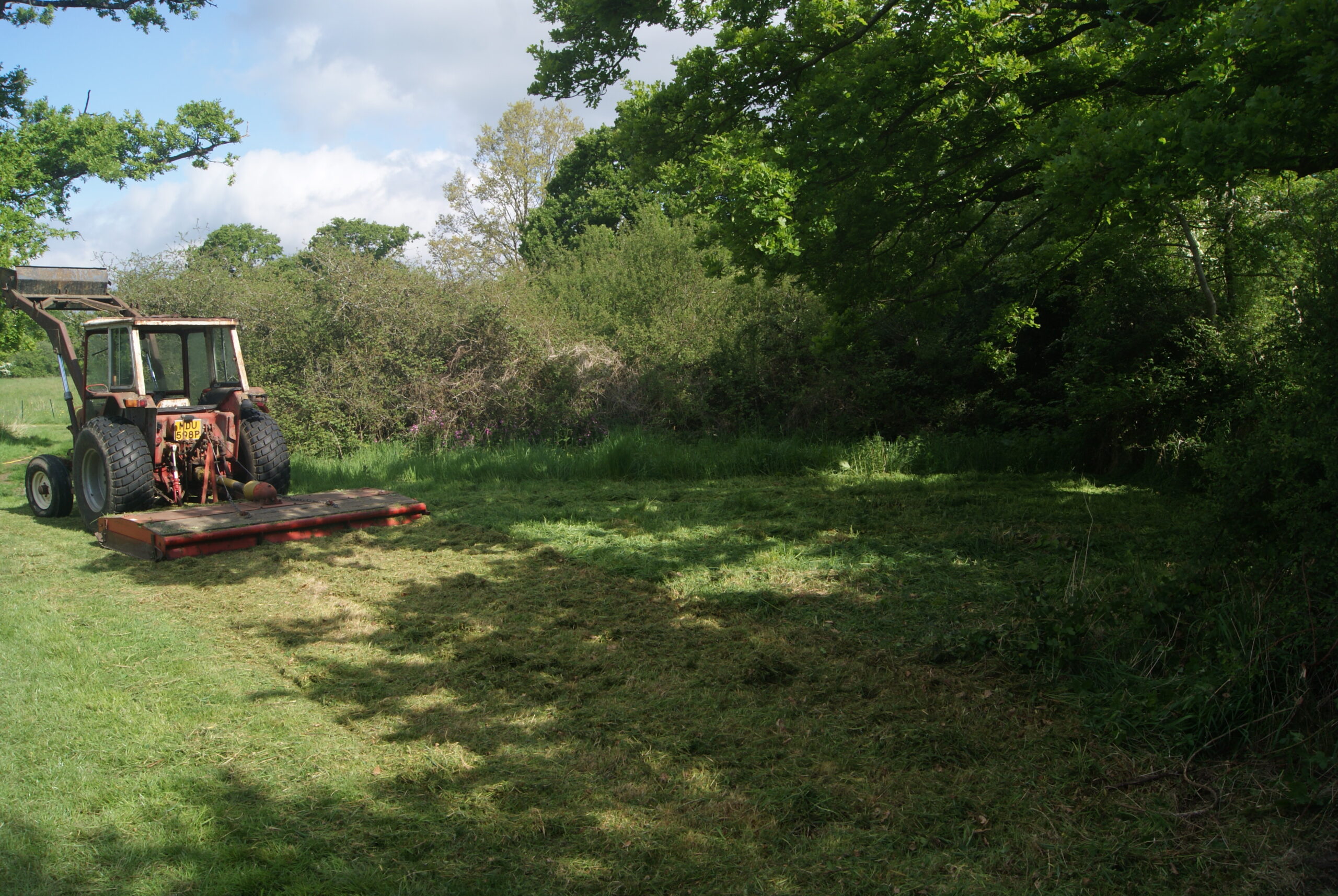

    Friday morning came nice and cool so I loaded up ready; first job was to trim some overhanging branches off an oak tree, so the chainsaw came out and the branches transported to the bonfire on the tractor and trailer. Next was to knock down the grass and brambles so my International 454 was put to work with the Votex topper. Brambles, grass and Blackthorn suckers all got mashed up by the Votex and the ground looked level afterwards. I left the debris on top to provide something to rot down and turn in with the plough.
    My Trusty 3-speed came out next with the Greyhound Plough and it took next to no time to turn everything over, brown side up. Off came the plough and on went the disc harrows to knock the furrows down into some sort of seedbed. Half an hour later and I was all-in! I’m not used to pushing a Trusty around these days especially when the ground is so hard and sprinkled with roots.
    I’m leaving it for a while until I can get the Earthquake out to chop it all up; I also need to sort the water bowser out so that I can park it on the corner to water in the potatoes when they get planted. The bowser has a Robin engine with a water pump which supplies two outlets fitted with 1/2″ hosepipe, so it is well suited to the job in hand, the only trouble is the engine feels as if it is seized. I’ll get to the bottom of that next.
    Enjoy the photo’s.

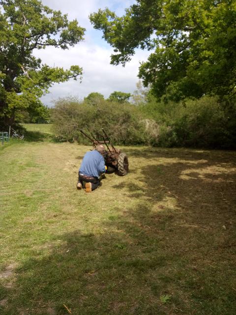

    I’ve been struggling to get the Earthquake to run today. Outside in the bright sun from 9 o’clock this morning until 1 o’clock I’m now very brown, covered in oil and stinky! By 1 o’clock I’d had enough so I’ve left it to carry on with tomorrow.
    The Earthquake isn’t the easiest of machines to work on. To remove the cowling off the Villiers 25 you have to remove the clutch lever cover- to do this you have to take the right hand wheel off. You can see why I called it a day! I’m not in any hurry after all and I can soak the ground with the water bowser once the spuds are in, so I’m not racing the weather either.

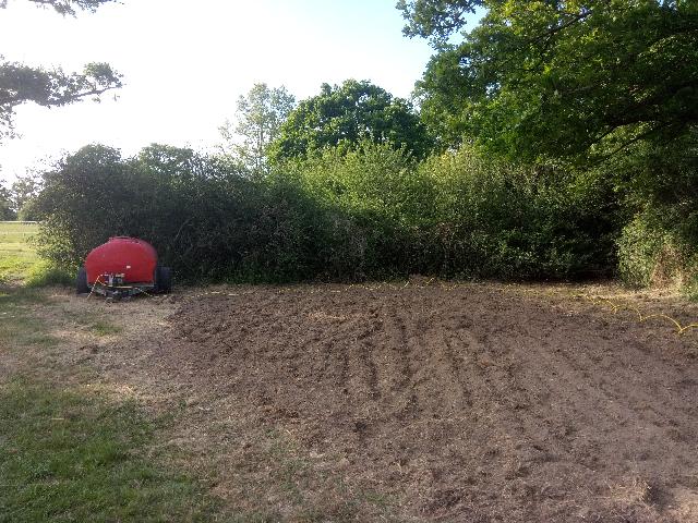

    Firstly the engine went back together with no problems and fitted back onto the Earthquake. It fired first time (honestly!) but stopped after a couple of turns. Second time it started and ran sweetly, so I pumped up the one tyre and went off to do some rotavating.
    It has now had three passes in first gear, each one at right angles to the previous one and each one a notch lower on the depth stop. There is still a lot of fibrous root material in the soil but at least it is all chopped up now, so it is ready for planting.
    Secondly I needed a water source close by- the “allotment” is over 100yds away from the house- so I gave my water bowser a bit of a going over. It hasn’t been used for two years and when I looked inside the tank it had a carpet of green algae across the bottom and about 18″ up the sides. The pressure washer had limited success and the green algae just blocked up the outlet and so there was nothing else for it but to climb into the tank and bucket out the water. Mrs. Geoff emptied the bucket and passed it back for me to refill and before long we had it epty again. I unscrewed the filter inside the tank (I didn’t know that it had one) and took a scrubbing brush and hose pipe around every part to get it clean. It is now spotless inside and ready for use. As you can see from the pictures it is now on the plot with two hoses attached to the pump- one goes through the hedge to water the horses and the other will water the allotment.
