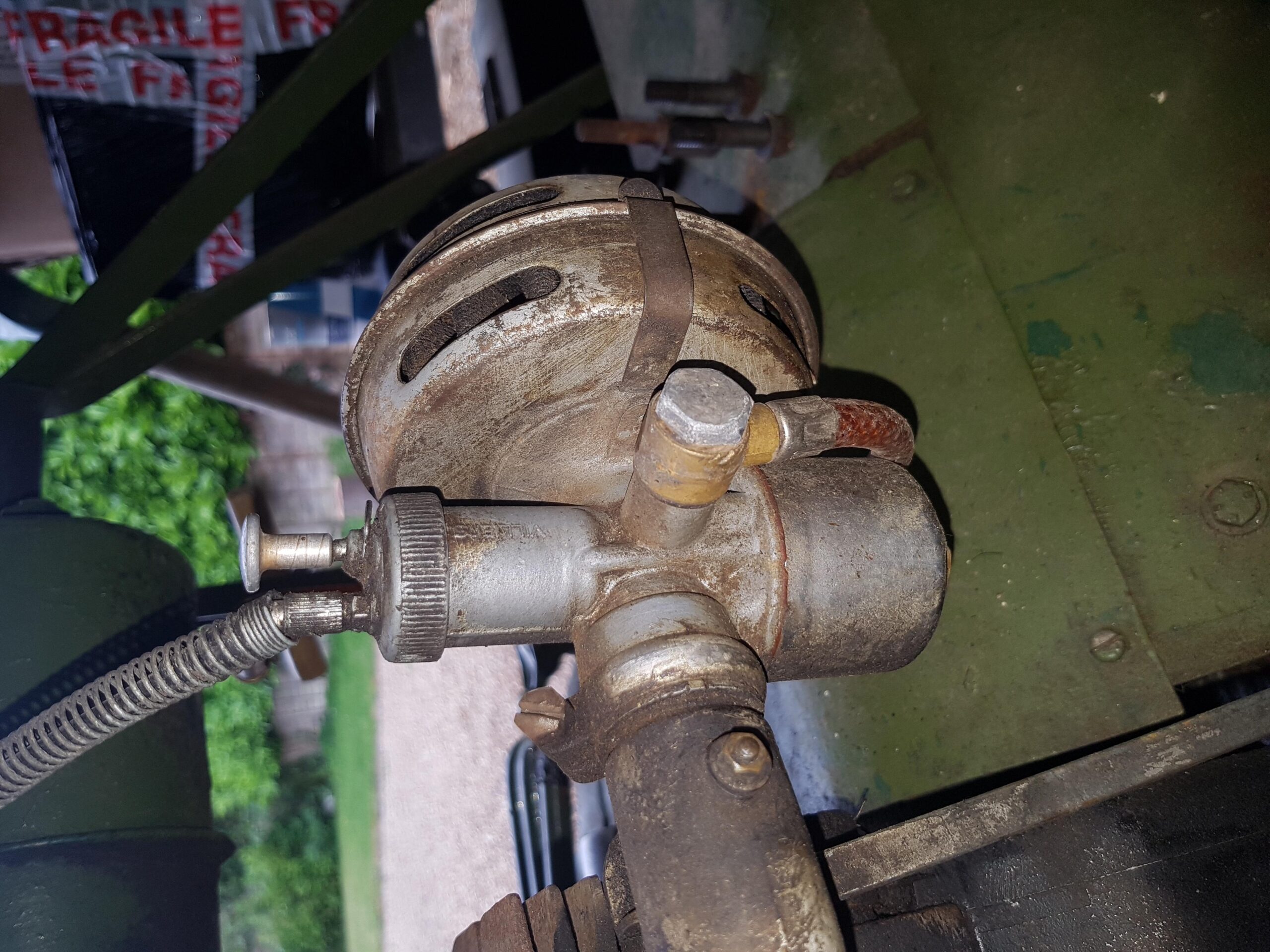

    Hello All. I would really appreciate help on identifying what carb I have on my Mk25 Villiers, and then point me to a manual or something to tell me how to tune it up?
    I have cleaned it thoroughly inside but it is still running quite rough, engine missing and a fair few puffs of black smoke.
    Picture attached. It only has one adjustment screw on it, as well as a tickler and strangler and is a Villiers own carb, not a Zenith etc. Thanks in advance!
    #34720
    I’m fairly certain that is a variant of the 4/5 Carb , which was unique to Atco(I’m not 100% on that , but have never seen it on any other machine)
    It’s a very simple carb to work on and get clean , which leads me to suspect you have an ignition problem , either timing , or coil/condenser failure.
