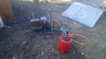

vhgmcbuddyMemberhello , am new to the site ,I am after some help on how to time a Villiers Mk12.1 engine, there is a arrow on the flywheel and that is all there is no key way on the crank.it is of a Ex MOD gen set, which I thort id have a play with before I start on my Howard 200 which needs a look. Any comments and help would be good

vhgmcbuddyMemberhello. thank you all for the help. I fitted the new coil and fitted the new gas pipe and she fired up a dream at weekend, runs nice and the genitor works to, I was wondering if any of you would know what things this would of run when in service? as it runs at 24 volt 20 Amp.
