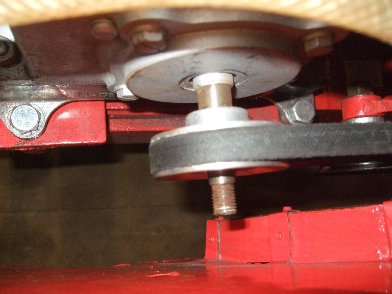

    i have just restored a bmb hoemate and fitted a villiers engine, the engine starts first pull every time. only trobble is the engine dont like ticking over. evry time you go to shurt the revs it stop. this is the second engine i know to do this.
    the engine has a tarperd sharft and a nut on the end so dont know if it was off a water pump or some othe machine which was desinged to run at high speed.
    any info or help would be very greatfull.

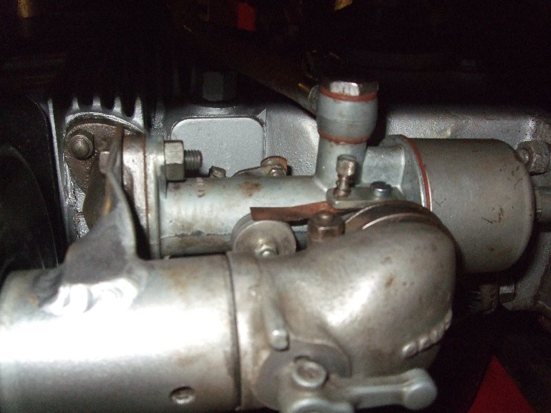

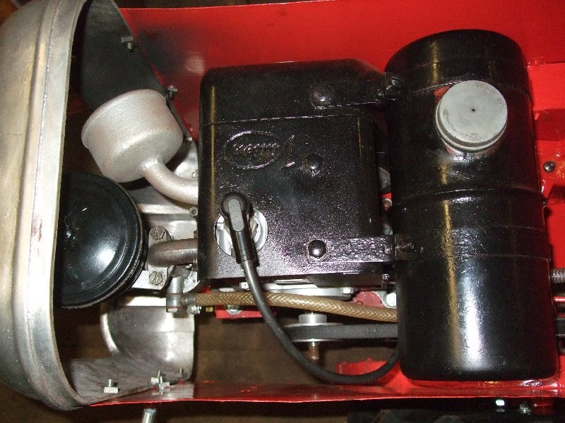

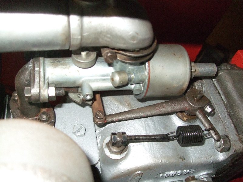

    photos of villiers mk12 hs engine fitted in BMB hoe mate.
    #5639
    Doesn’t have a throttle, as far as I can see. My Spraymobile doesn’t either….
    #5681
    If you look at your photo 1106 you can see a threaded hole at the top of the carb. this is where your mixture control screw should be, it is a simple bolt, with a lock nut, this controls the mixture of air and petrol, yours is missing, so you must have a weak mixture, you screw it in to richen the mixture, should be an easy fix.

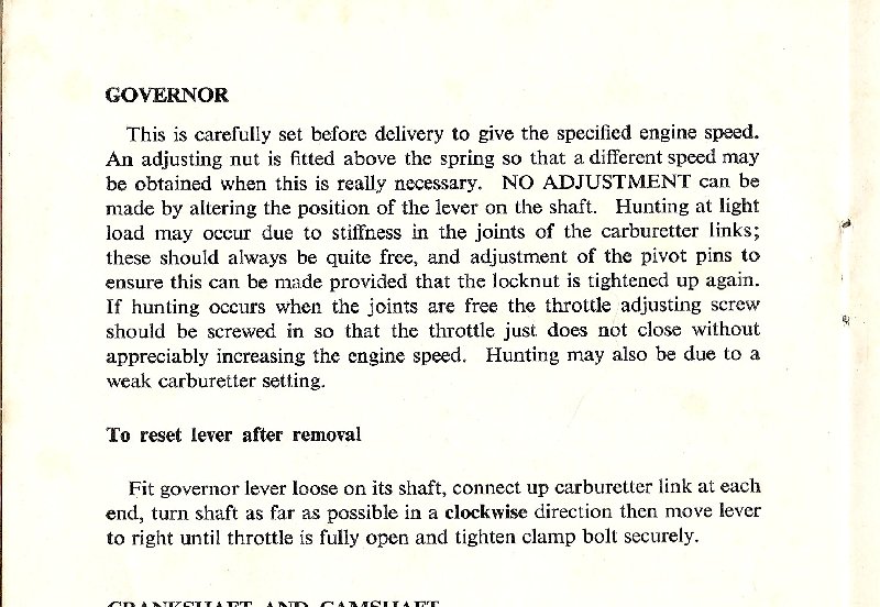

    Not all carbs have a mixture screw see below.
