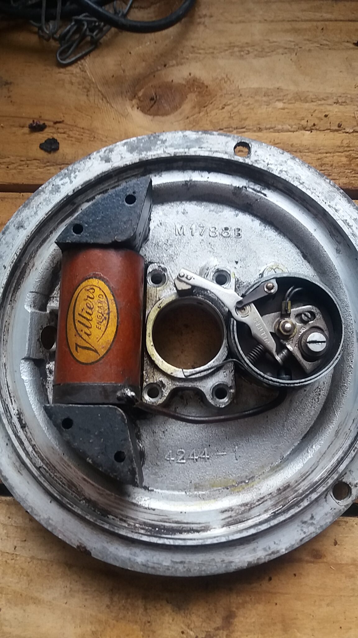

vhgmcbuddyMemberHaving no spark on my clifford mk1 rotavator I have taken the magneto out to take a closer look. All seems clean and operational. Having tested the coil I’m getting 0.4 on the primary (set at 200 ohms) and 2.55 on the secondary (set at 20k). Does anyone know what the readings should be for a villiers mk 25 c? Do these readings look ok?

ParticipantI’ve said it countless times on here , you can’t test a coil PROPERLY with anything other than a purpose built ignition tester , your local mower/small engine centre should have one.
November 24, 2016 at 9:24 am #23200
charlieKeymasterThe problem with a simple resistance check is it cannot take account of running conditions ie insulation can break down as soon as coil starts working. If a good clean of points and mating surfaces between coil and backplate etc does not give a good spark, I replace coil, points and condenser, not a cheap option but it does ensure a good spark. Do not buy cheap or secondhand coils.

wristpinParticipantI 100% endorse the need for proper coil testing. Stressing the coil with a proper tester will soon show up internal breakdowns of insulation and frequently on Villiers engines. ” leakage” between the HT termination of the coil and the magneto backplate; so best to test the magneto as an assembly and not just the coil. If a test of the mag gives a negative result it is then worth doing a separate test of the condenser. This can be done in situ but it is necessary to separate the condenser wire from the coil primary wire and Make sure that the points are either open or disconnected.
