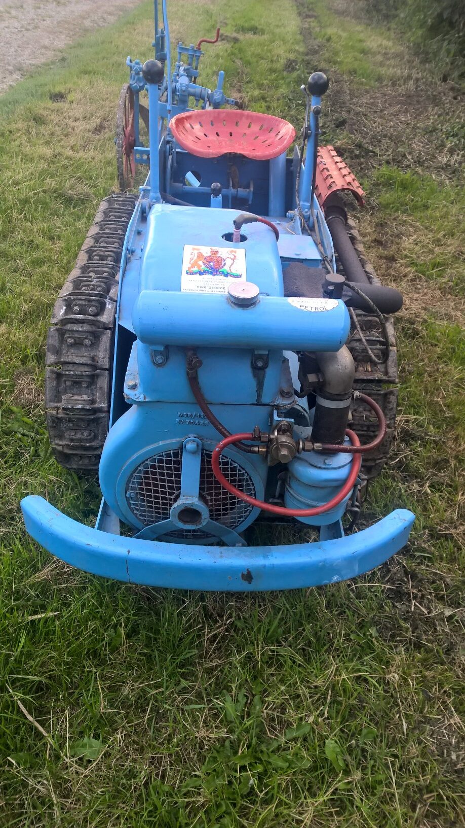

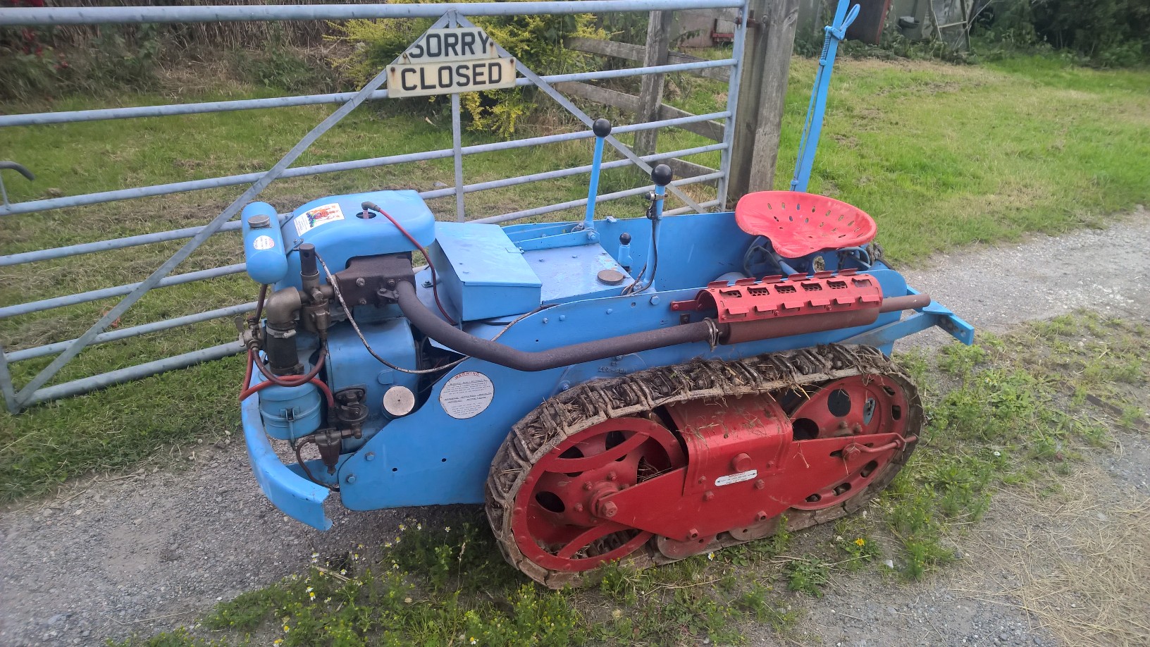

    Hello
    I’ve just got myself a ransomes mg5 tvo model. I have nothing else tvo. Wondering what is the mix to make some is it same as for a tractor?
    Been told 1 gallon petrol with redex,too 4 gallon Kerro/paraffin. With a splash of ligth oil.

    dave
    I use 4 gallon kerro to 1 gallon petrol. It seems to work OK.
    Please send tractor no and engine no for Ransomes register.
    Thanks. Dave.

    Okay thank you Dave, do use leaded petrol or a splash of redex? And il send on the numbers the plate at back of machine is bad to read and where is the engine number?
    Thanks you for the link Charlie made some good reading

    The engine no is on the offside of the engine near the cylinder base.
