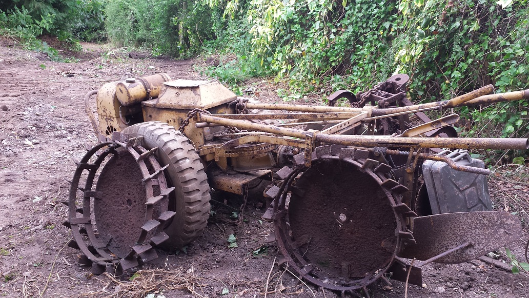

maxParticipantI am looking for information on Dad’s old tractor
, more to the point what engine is fitted to it ?
Basically, the reason for joining is I want to transport the tractor and implements back here to Germany and do a full restoration well at least my 18-year-old son wants to renovate it.
Before we go to the cost of transport and the associated trouble of getting it here I need to know if the idea is viable .
A little bit of background to the whole story dad died in 2015 and in 2018 we set about sorting his place out where we came across his old trusty now I realise it has no real monetary value but the sentimental value is enormous as my first memories as a small child are of myself and younger brother sat on the toolbox as dad ploughed the garden.
so the main questions are :-
What engine is in it ?
Are spare still available?
What weight has the machine with plough disc harrows and spade lugs .Max
PS I should add we live in central Germany

trusty220KeymasterThe engine you have is a JAP 5, made by J.A.Prestwich of Tottenham, London. It should have JAP stamped in large letters above the inlet holes for the cooling air and it will have JAP cast into the crankcase just above the output crankshaft. Engine numbers should be stamped into the crankcase at the base of the barrel.
Parts are (or were) available from Meetens Industrial Engines, but I understand that Paul Childs (who runs it) has sold out to another company. Generally there aren’t many parts that you need for these engines as they seem to have been designed for a long working life. Gaskets and spark plugs are just about all you will need and maybe a rebuild on the magneto if you can’t do it yourself. Parts for the tractor are non-existant beyond the usual bearings, seals and chains and you may have to make some parts such as the drawbar pin for the swinging drawbar- this is a usual part that tends to seize in the drwbar and wear the castings above and below it.
With all of the bits and pieces you have I would allow about 750kgs for the weight of the tractor and associated parts. It may come to far less but the only way to know for sure is to put it on a weighbridge.

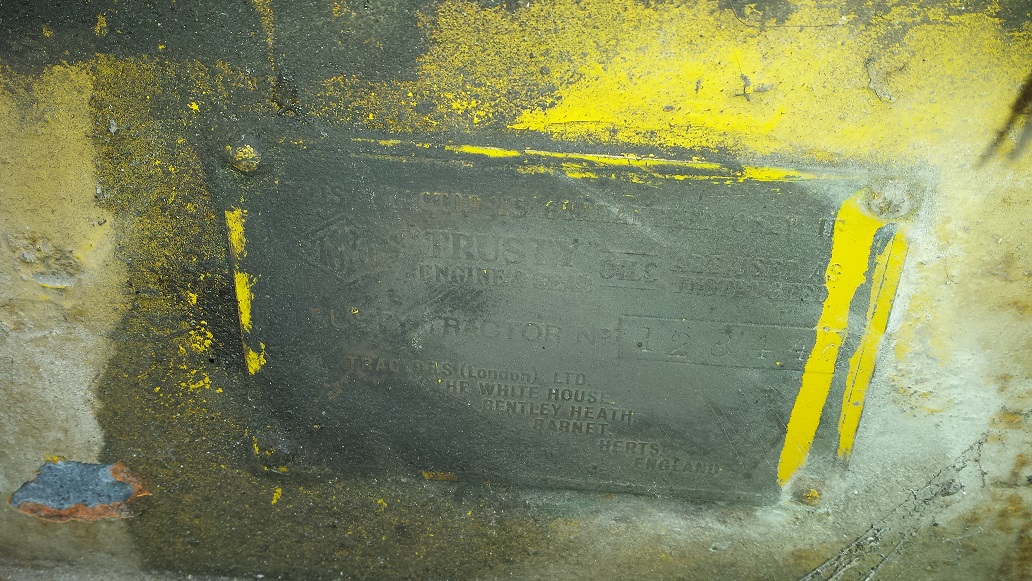

trusty220KeymasterOne further point…….I’ve just noticed your serial number has too many digits. Could you check it again and possibly post a photo of the serial number plate? It looks like you’ve been having trouble with the size of your photo’s- check out Charlie’s instructions for reducing photo size so they don’t get too big for the software.

apologies you are correct the serial number is 12844C

have enclosed a photograph of the serial number to confirm your thoughts.

trusty220KeymasterA very rough date for your tractor will be June, 1948.
