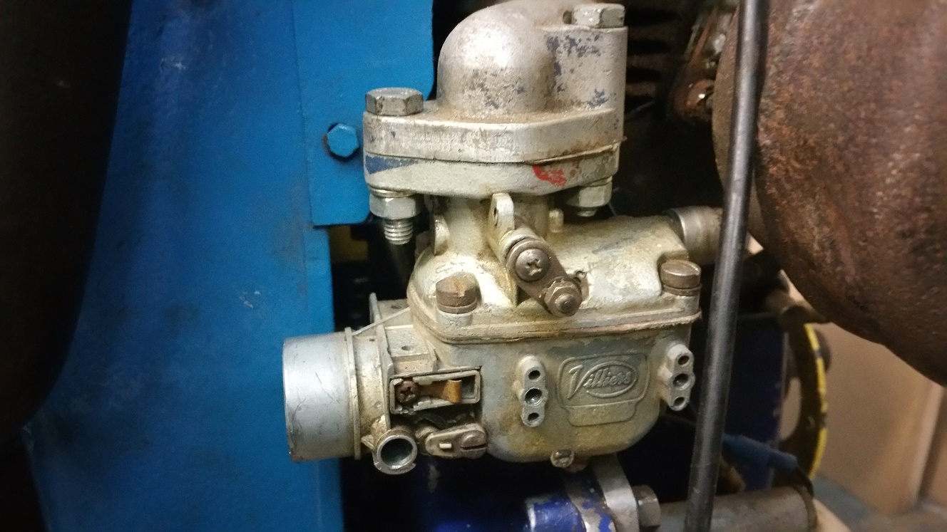

vhgmcbuddyMemberHere are a couple of pics of the carb, I have checked the jets are clear on the carb but it looks like something is missing from the front of it.
So my question is can the missing bits be obtained or would it be easier to replace the carb?

ParticipantYes , your choke assembly is missing , try calling Paul Childs at Meetens.

trusty220KeymasterHere are two pictures in my file that you may find useful. The Earthquakes don’t belong to me but were sent to me some years ago to help identify them.
Hopefully you can see what is missing. Don’t forget, though, the Earthquake never had a throttle lever and relied on the engine running at a constant speed controlled by the governor. -
