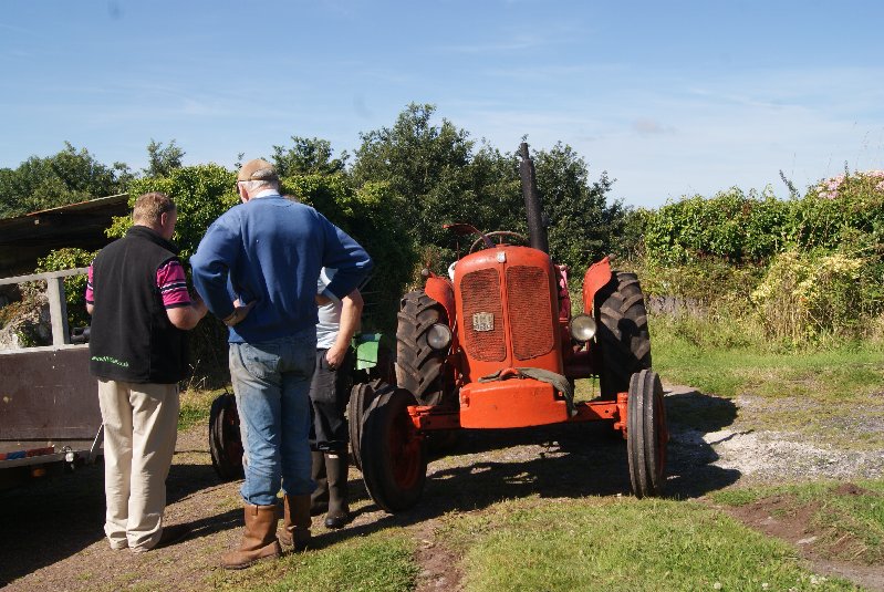

trusty220KeymasterThe final part of this saga took place yesterday when we took the Trusty back to Wales. Lovely weather (as you can see from the pictures) but it didn’t go entirely according to plan.

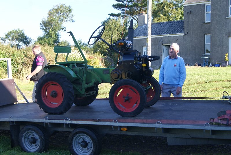

We got there nice and early so that the owner, Pete, could have a good look at it before he went off to do his voluntary work at a local museum. Once at the farm we unloaded it onto a piece of level ground so that I could start it up. As you can see from the pictures there isn’t much level ground in the neighbourhood, but there was a bit at the back of the trailer and so I prepared to start it up where it was unloaded.

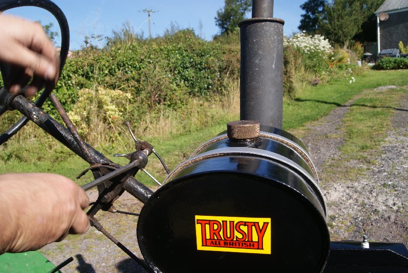

Wind the strap onto the pulley, set the throttle to 1/4 open, turn the petrol on and flood it on the carburretor, set the ignition to “Retard”- the advance/retard cable came loose at the magneto end! It was either the nipple had come off the cable or the cable had come out of it’s collet inside the mag, so I had to do a quick strip down to find out.

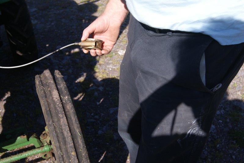

Luckily it was the latter- I think the cam ring had jammed in it’s housing, then when I moved the lever the cable pushed the collet out of it’s location and came free. A quick re-assembly, tightening the collet at the same time so that it couldn’t happen again and fingers crossed- it started! Pete couldn’t climb up onto the footplate because of his arthritis, but his son Barry had a go and went for a spin up and down the farmyard. It was going great until yours truly had a go back up the farm drive; I put it into third gear and gave it full throttle, then halfway to the top the engine just died. Jumping off I found that the nipple had come unsoldered from the end of the petrol pipe, so it was back to the farm to see what we could do.

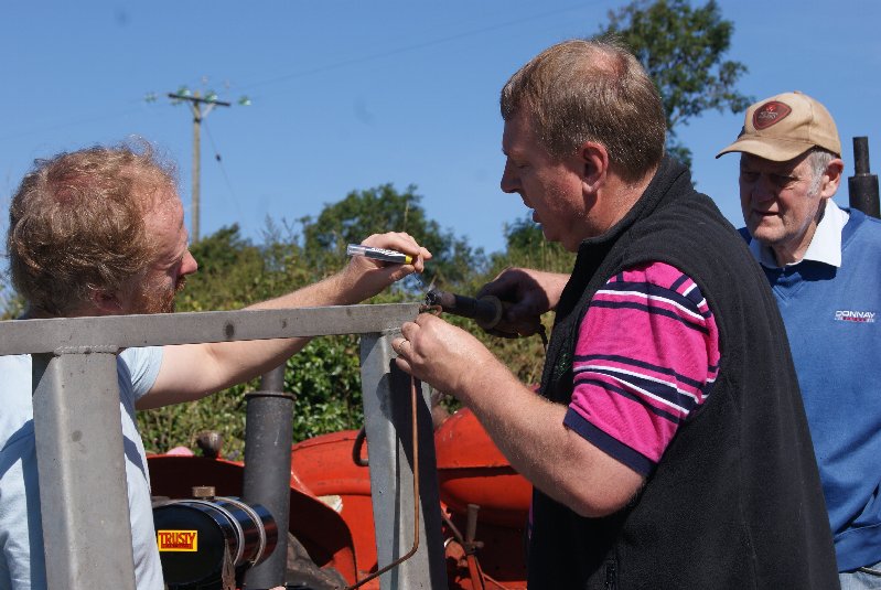

Pete’s neighbour, Dave Packer, came to the rescue with a calf de-budding tool. It was really a large soldering iron that you could clip onto a tractor’s battery so that you could de-bud (de-horn) calves in the field, so Barry brought the Nuffield round and we set to work trying to get enough heat into the joint to melt the solder. As you can see from the pictures it was a team effort to repair it but eventually proved successful. Quite an eventful morning and I can’t thank Barry and Pete enough for mucking in to help.
