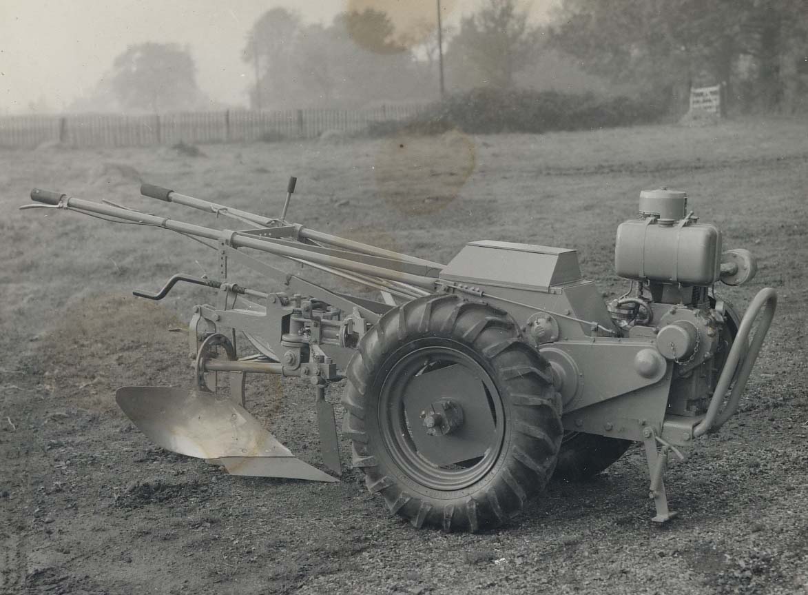

trusty220KeymasterWhy don’t you try a JAP 5? There are plenty on the auction site and it should fit straight on with very few modifications.
What you have to watch is the height of the crankshaft above the chassis because the castings around the clutch were made in two different heights. The shorter one that you have (which fits the B+S ZZ) also fits the JAP 5 engined tractors, but some of the other engines such as Douglas SV54 or the JAP 6 need a taller lower clutch casting because the crankshaft is about 1″ higher from the chassis plate.February 5, 2016 at 11:15 pm #17505
will-haggleParticipantThere’s a precedent for a Petter diesel, see P13 of 50 years of Garden Machinery… They considered the Petter was too heavy…

chapParticipantIt was a petter pc1 fitted to the trusty there are a few variations around but i believe the pc1 is the right engine they are a bit scarce i know becaause its the same engine fitted to the Crawley 75 not many spares availible either. the only trusty i know with this engine fitted is in somerset i think Gerald Harris has it now i have his contact details if you pm me.
