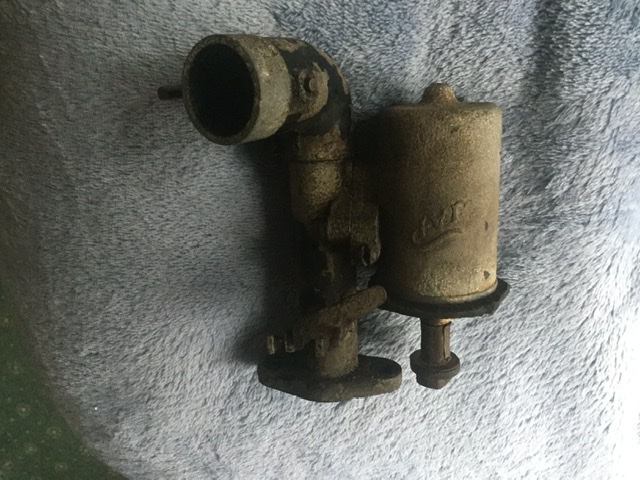

trusty220KeymasterIt may have had the early type JAP carburettor fitted; this has “JAP” cast into the aluminium barrel of the float chamber. They aren’t too good and are a little erratic (you can set it up to run fine with a lovely slow tick-over, then you rev it up and it somehow loses it’s settings); parts are not available for it either.
By far the best carb to use on it is the Zenith 24T-2 which is common to a lot of other engines and is easy to set up. You can get the parts from most of the regular suppliers and it holds it’s settings without the need to keep re-tuning it every five minutes (Bill Gates take note- why can’t you design software that doesn’t need to be continually updated?).

trusty220KeymasterIf it has had the early JAP carburettor fitted you will need a different inlet manifold to suit the Zenith. This has a horizontal flange fitting with two bolts. If I remember correctly the JAP carb has a sleeve type fitting and a pinchbolt to tighten it around the fitting.
October 8, 2019 at 9:35 am #32170
vhgmcbuddyMemberOctober 8, 2019 at 2:55 pm #32174
trusty220KeymasterYes, that’s the early type carburettor which I haven’t had much success with. I haven’t found anyone that can supply parts for it but yours may be repairable if it hasn’t got anything missing.
If there are parts missing I would look for a Zenith carb and manifold which should bolt straight on. You will need different throttle linkages as well, so if you can have a look at some else’s set up that would be the best advice I could give.
