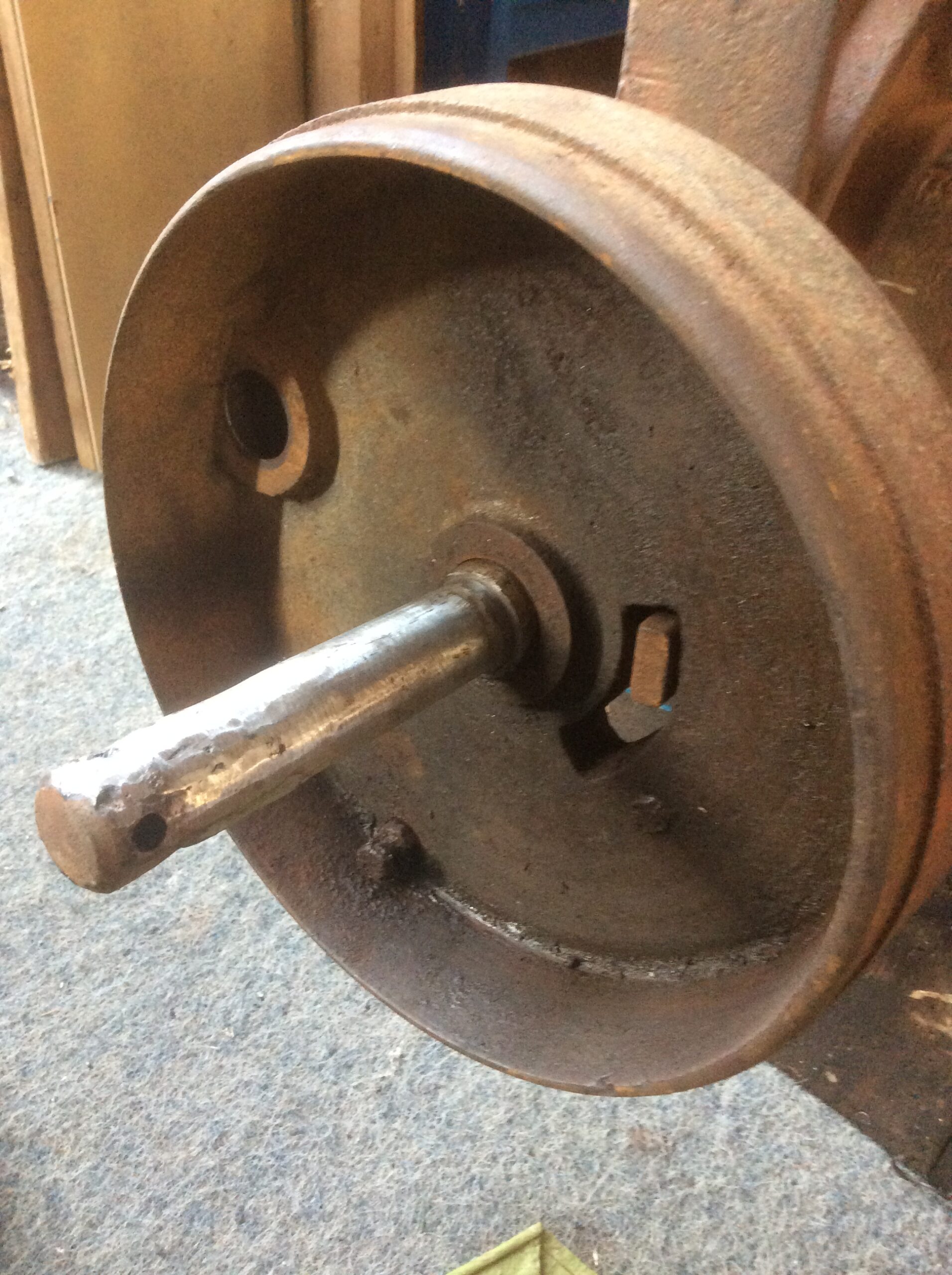

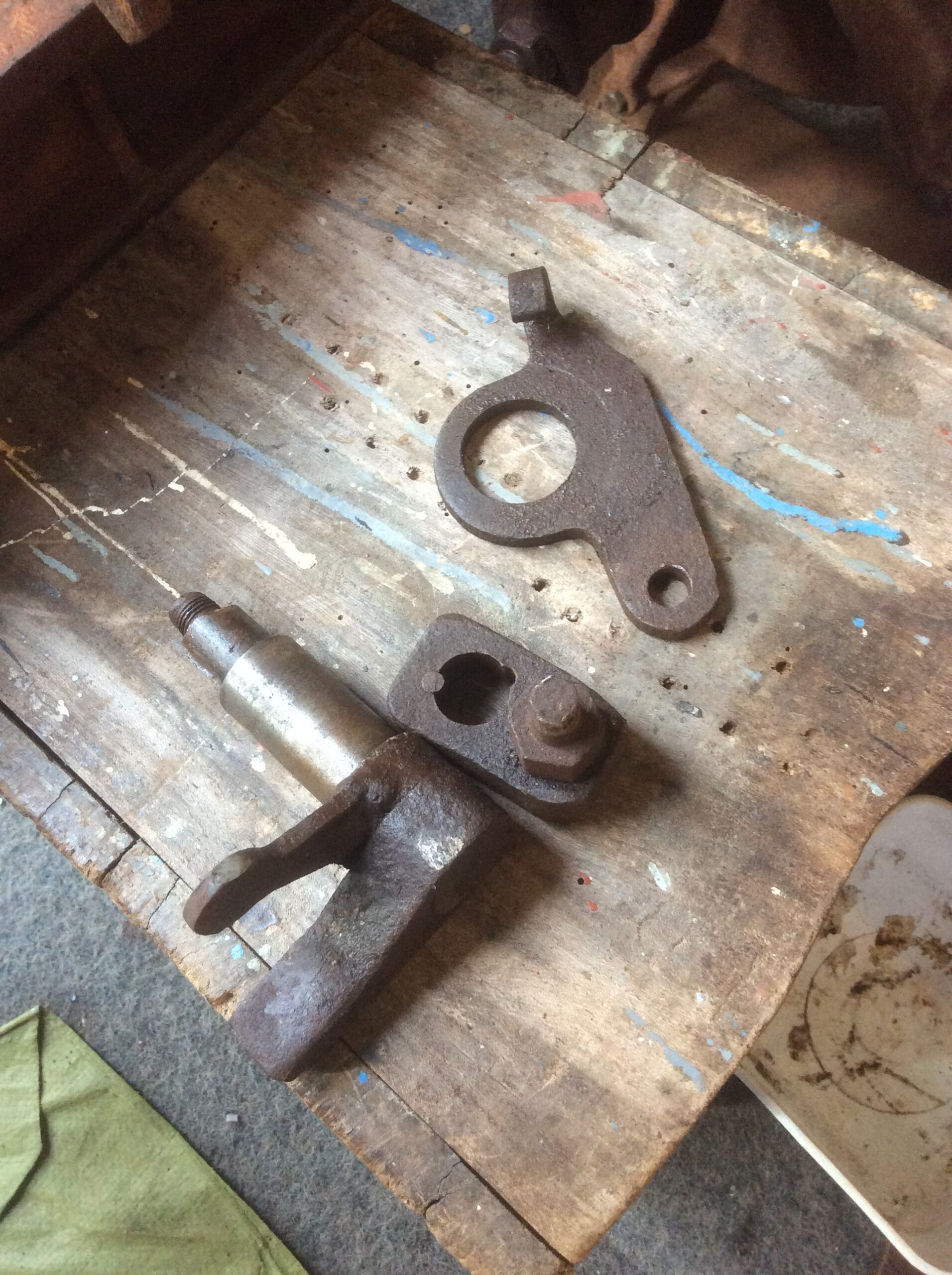

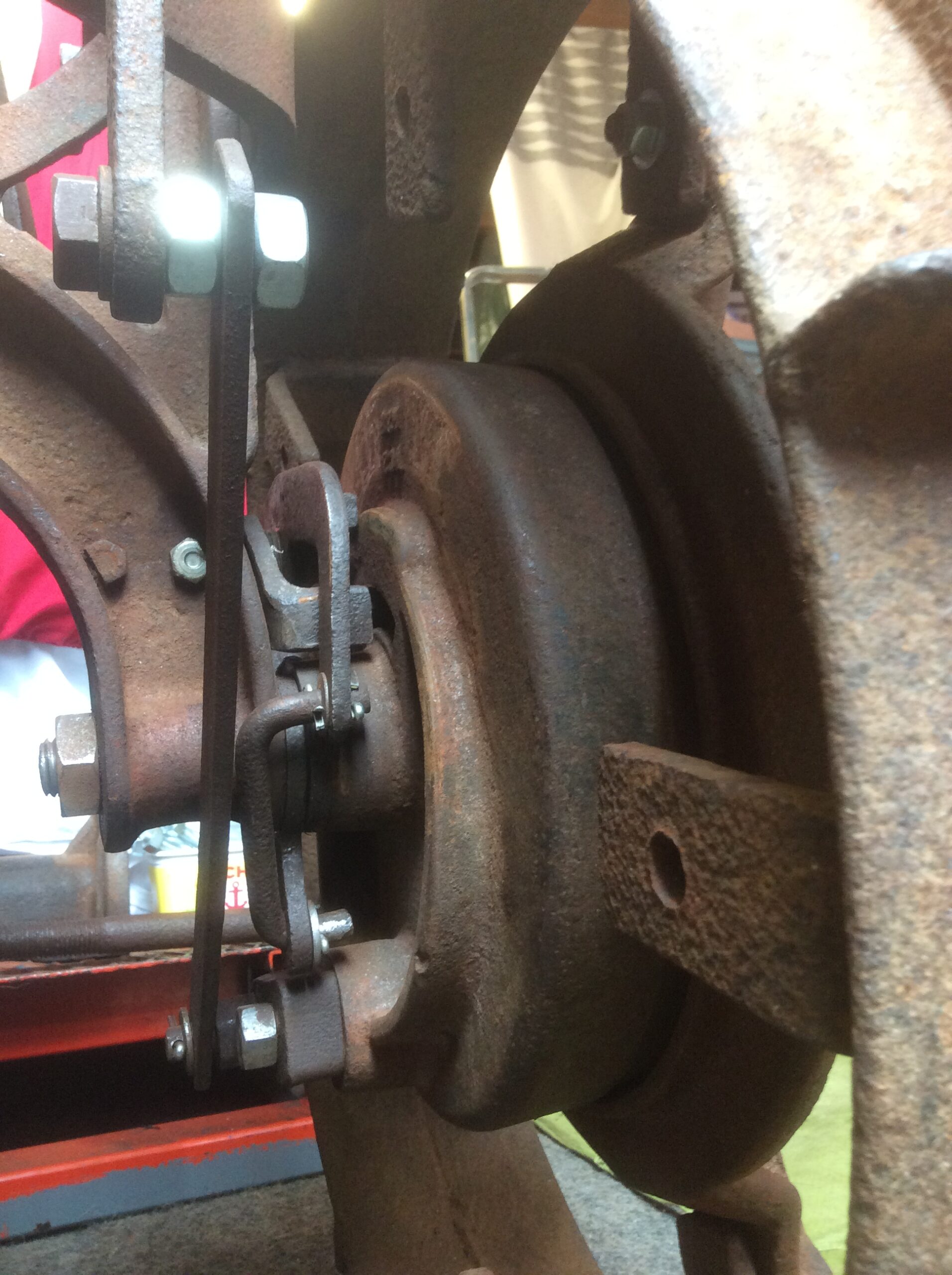

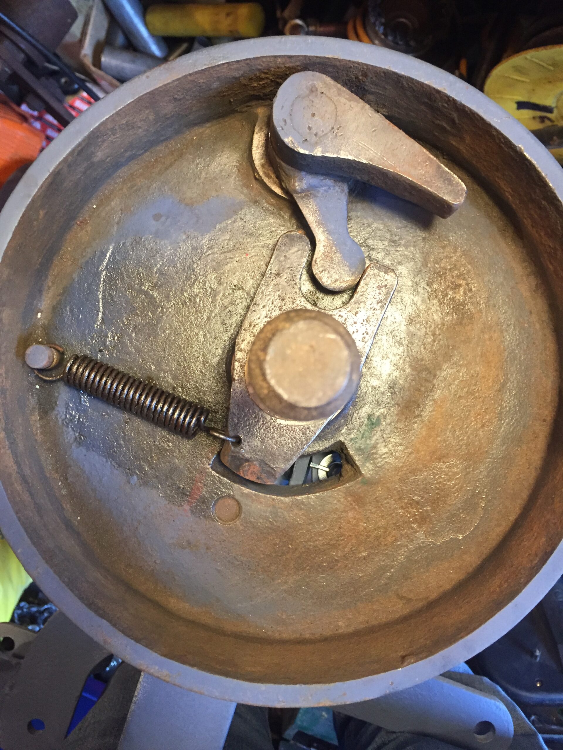

ParticipantI have purchased an auto lift cultivated in lots of bits, so not sure if everything is there yet. I trying to work out the auto lift mechanism, where springs go etc, let alone the linkage set up.
Does anyone have such info or can take any photos of yours that may help me. I have lots of bits 😃
I have looked at as much as I can on line, but nothing is clear enough detail
Attached is the main drum an some parts

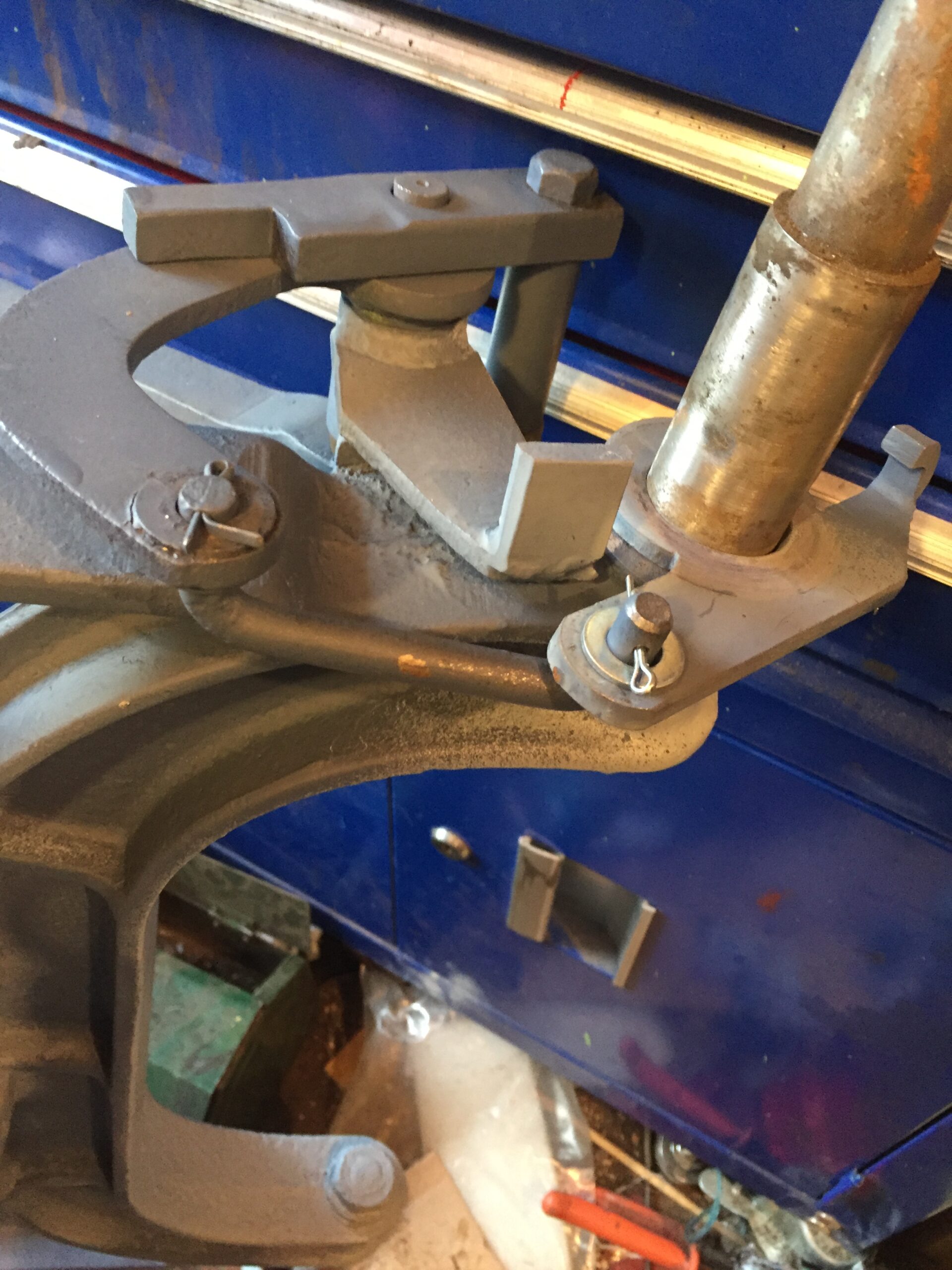

Many thanksJanuary 19, 2018 at 8:58 pm #27666halfa
ParticipantI’ll take some photos over the weekend for you. I’m rebuilding one myself.

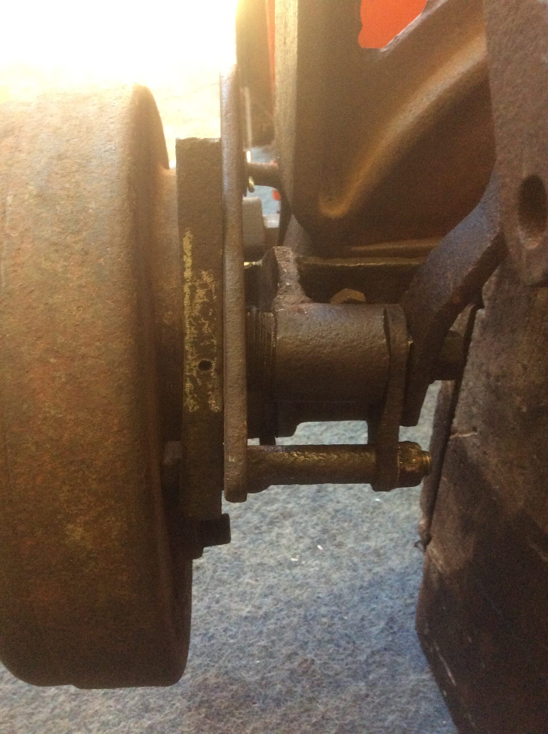

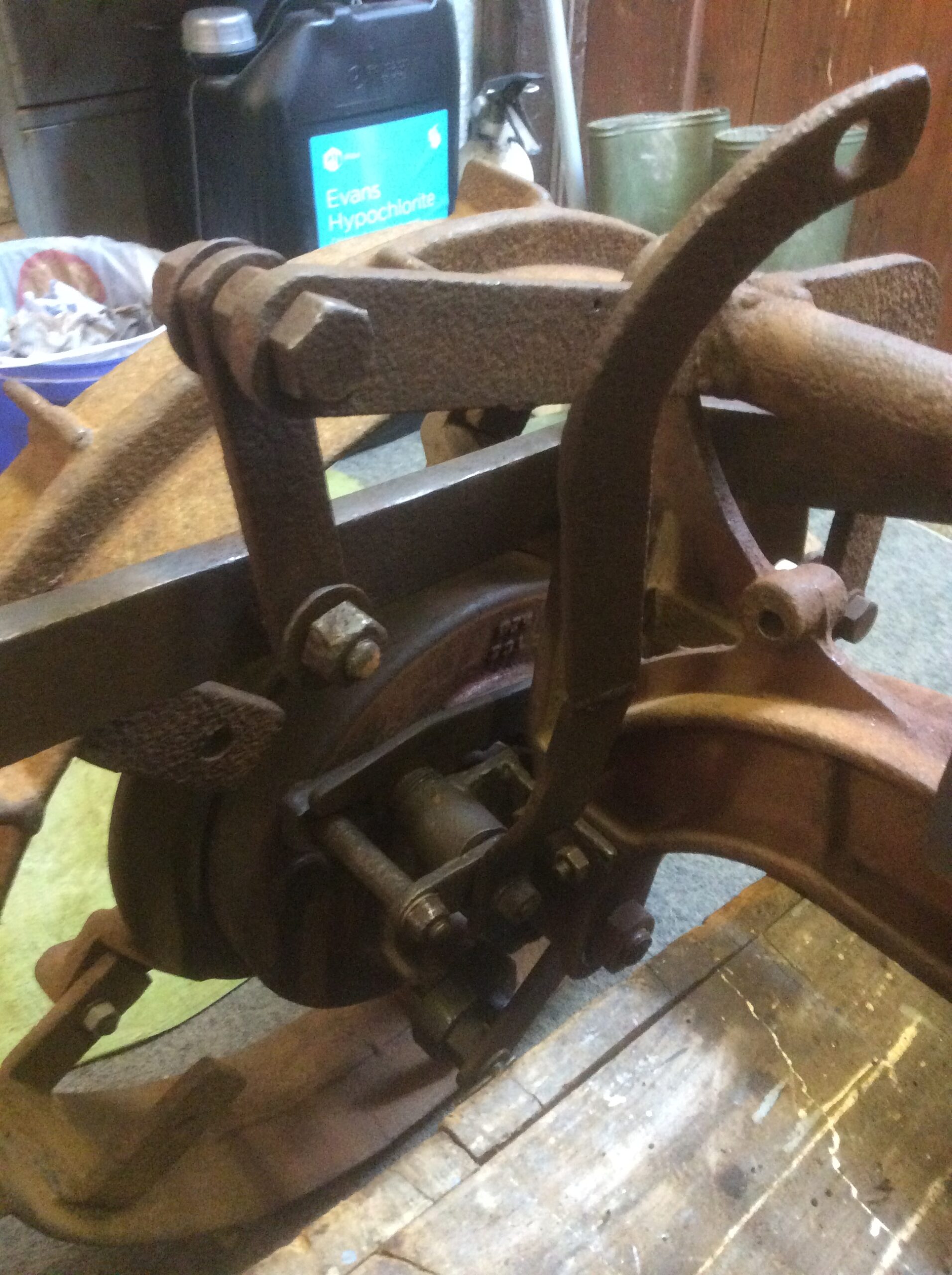

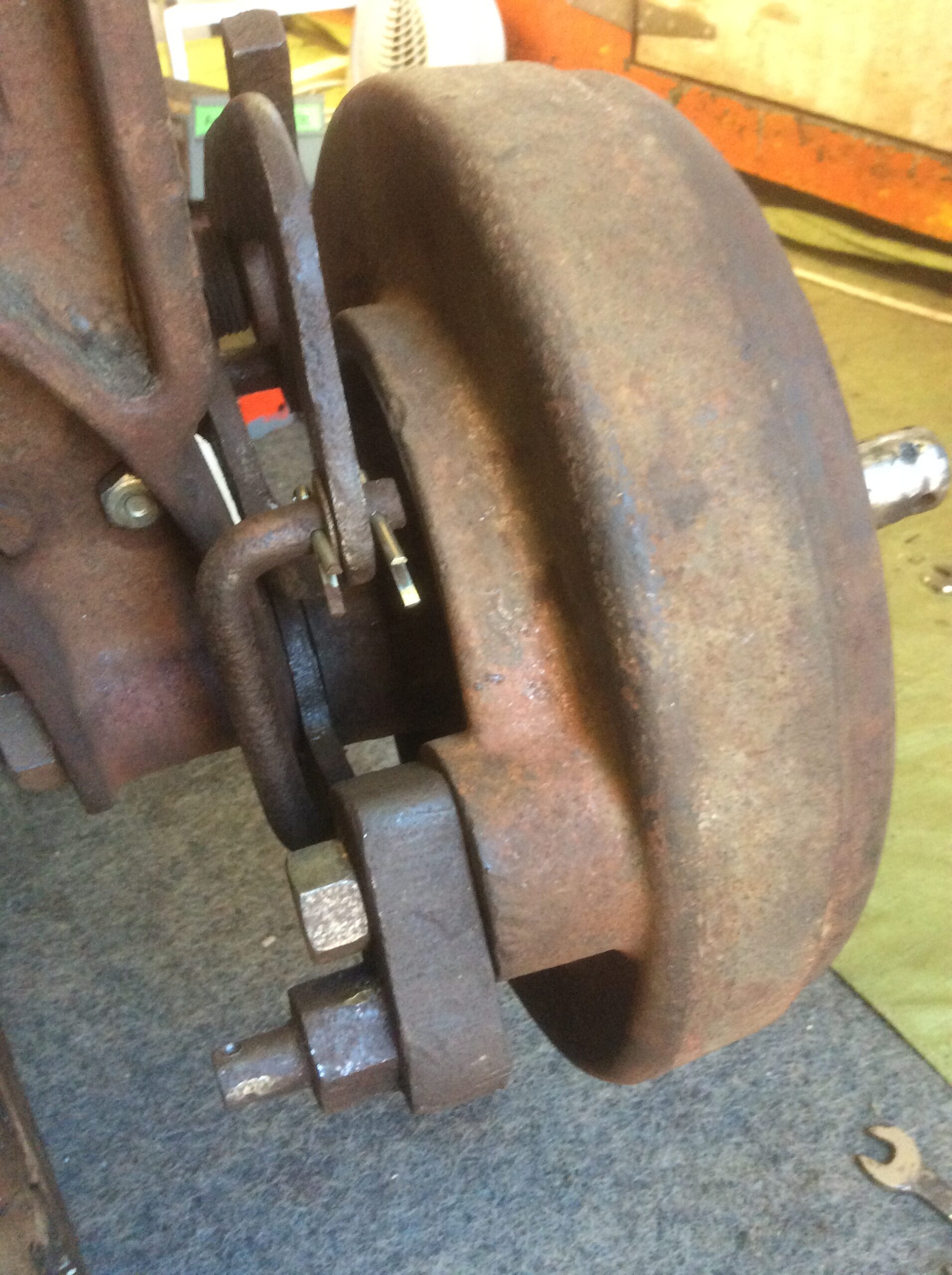

Many thanksJanuary 20, 2018 at 3:35 pm #27674halfa
ParticipantJanuary 20, 2018 at 9:30 pm #27716properjob
ParticipantThis is a great help.When you get chance the main frame will also be helpful as all I have is a pile of loose parts 😄

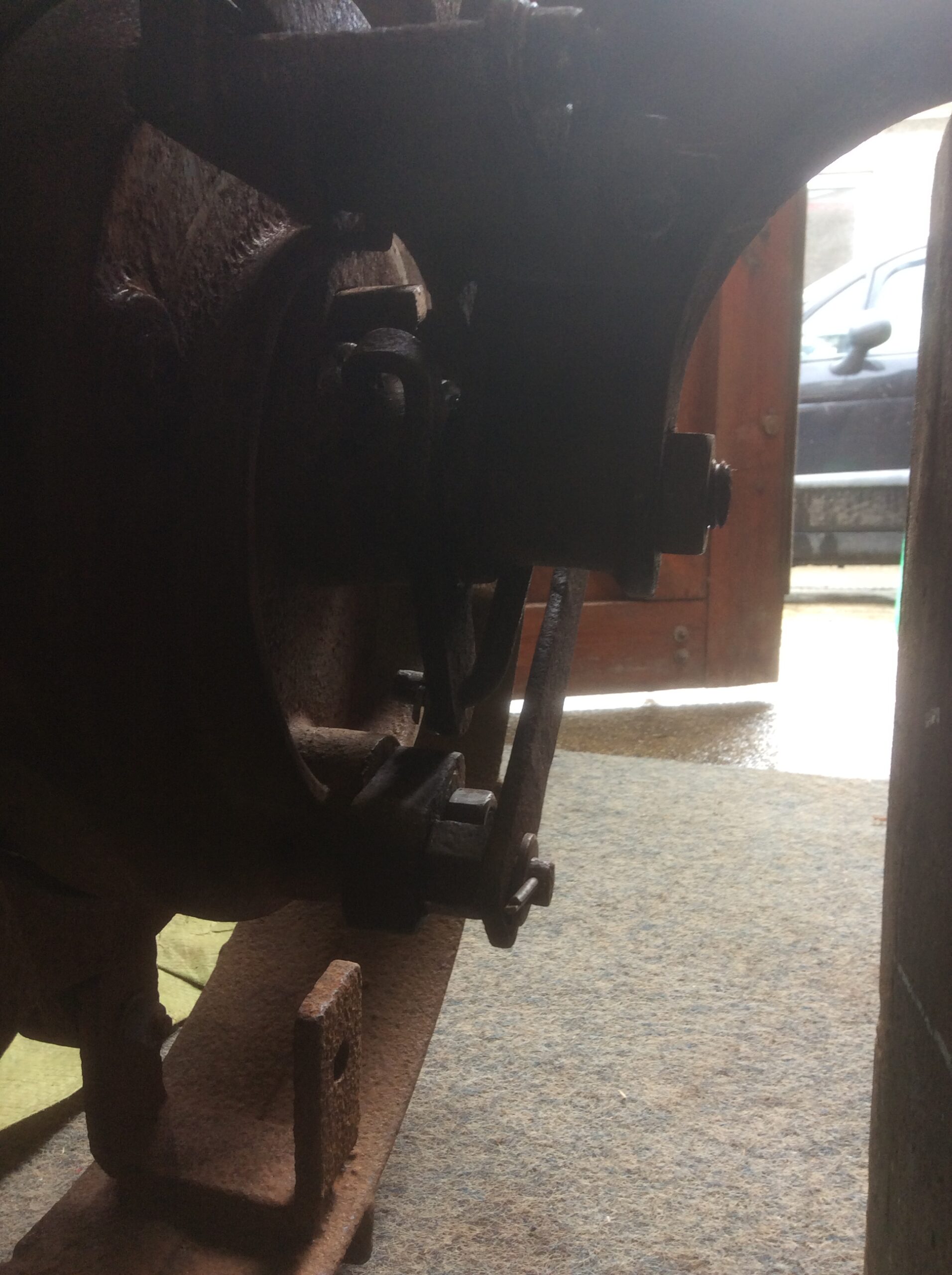

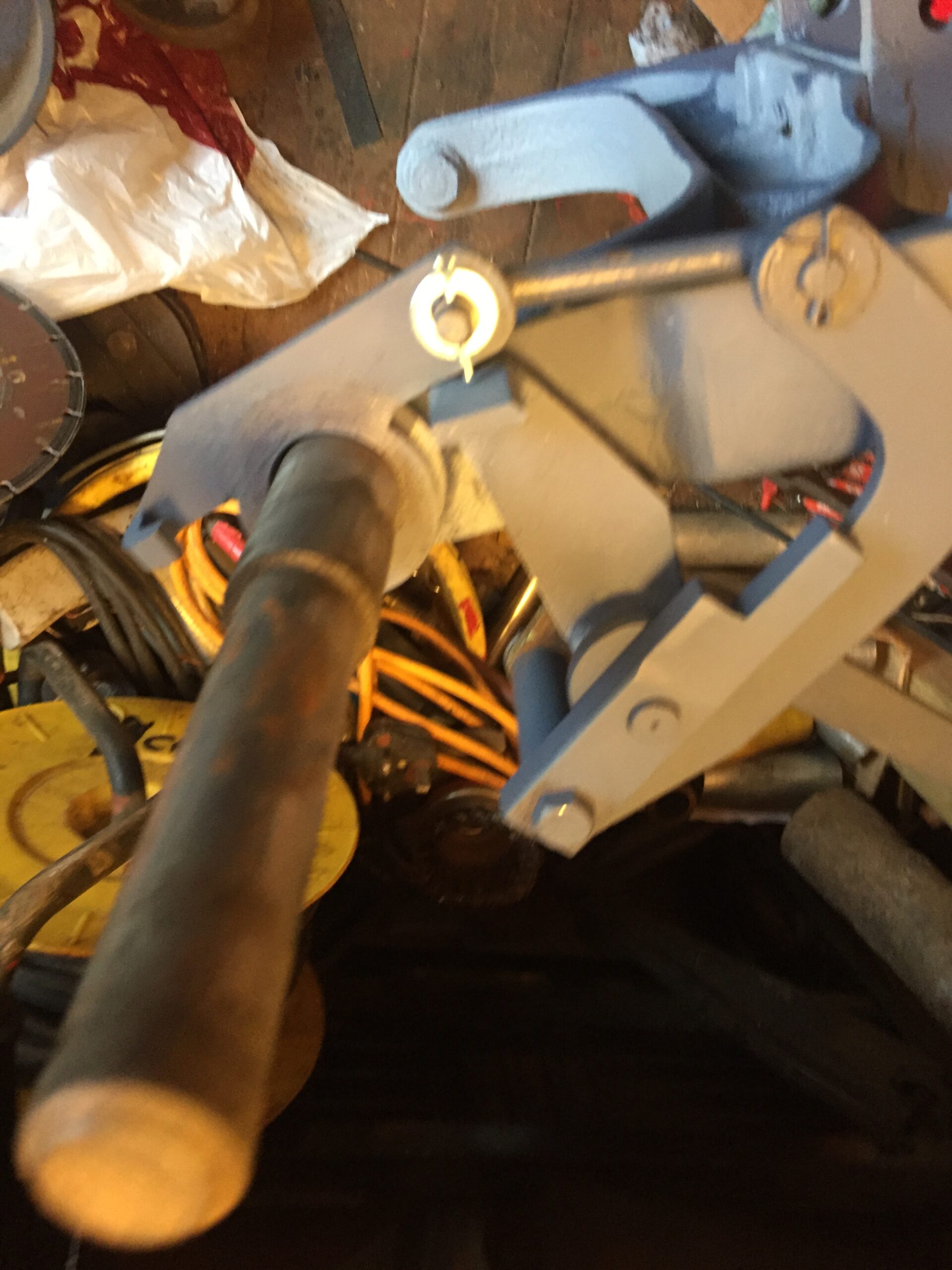

Thanks againJanuary 20, 2018 at 9:50 pm #27717halfa
ParticipantNo problem, this is as far as I have got at the moment but as it goes back together I’ll update you. I’ll get some better ones for you when it’s not chucking it down I’ll lift it all outside. My workshop is rather tight for space, Good luck.

February 17, 2018 at 10:02 am #27943properjob
ParticipantI think I’ve got things something like it but I’ve has to make /extend the shaft which possibly was located by a roll pin? I would need to know approx position as this part of the shaft was broken. There was also a spacer (that looks like threads), should this be there or further out as the bolt head rubs the casting, but this may be due to linkage not all fitted. If you wish to phone to explain or email me yours, mobile is 07747783881.
