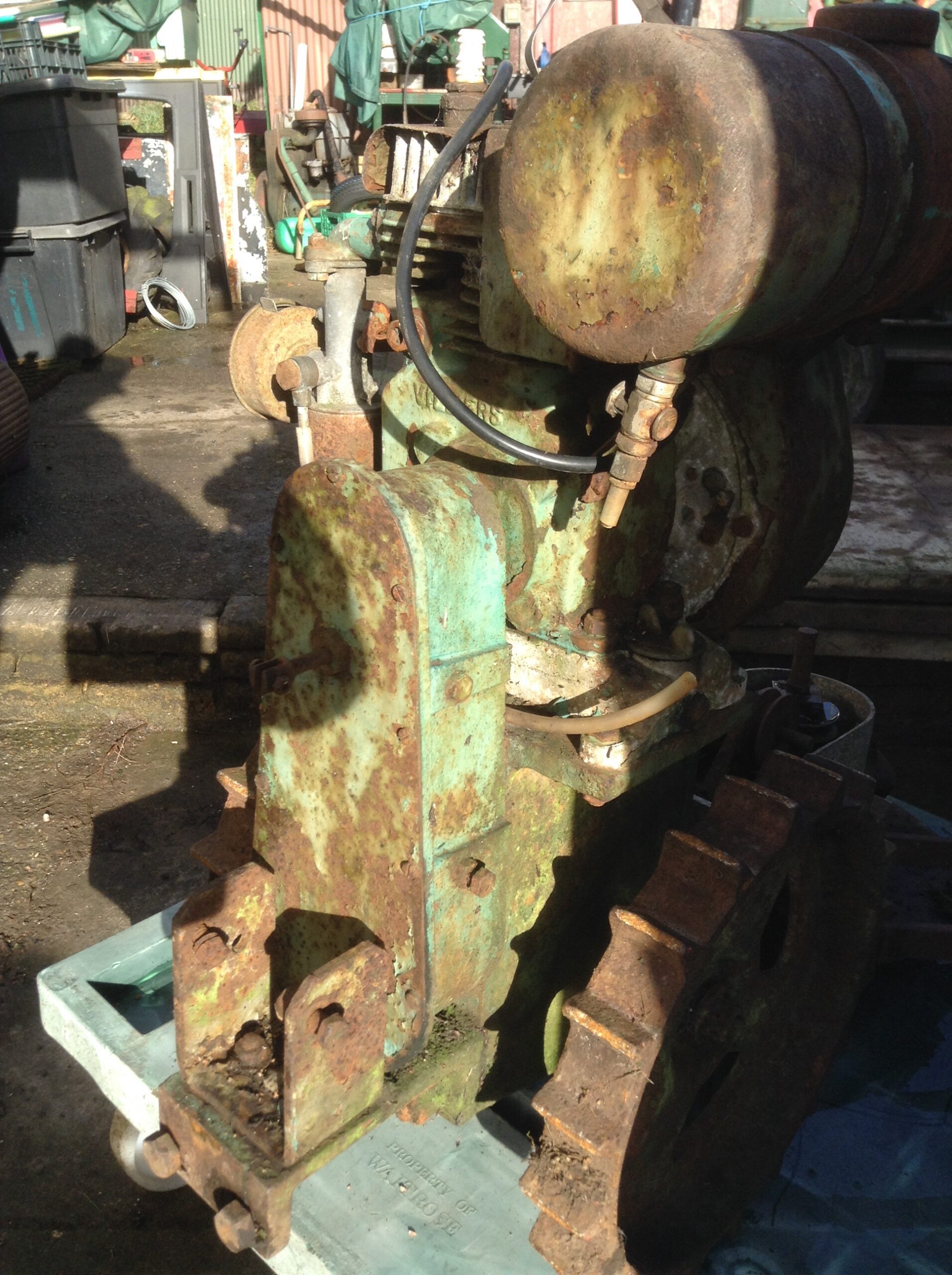

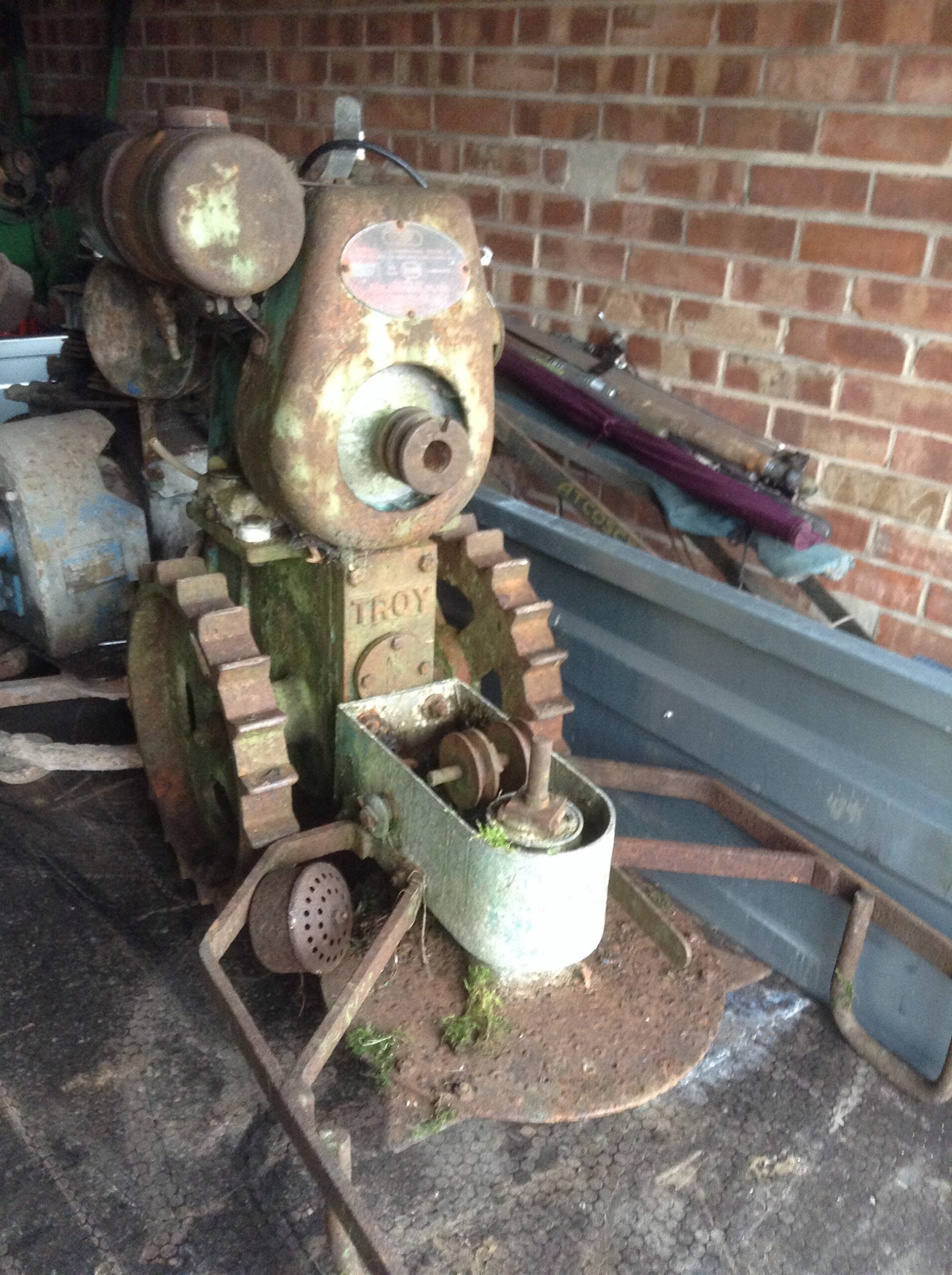

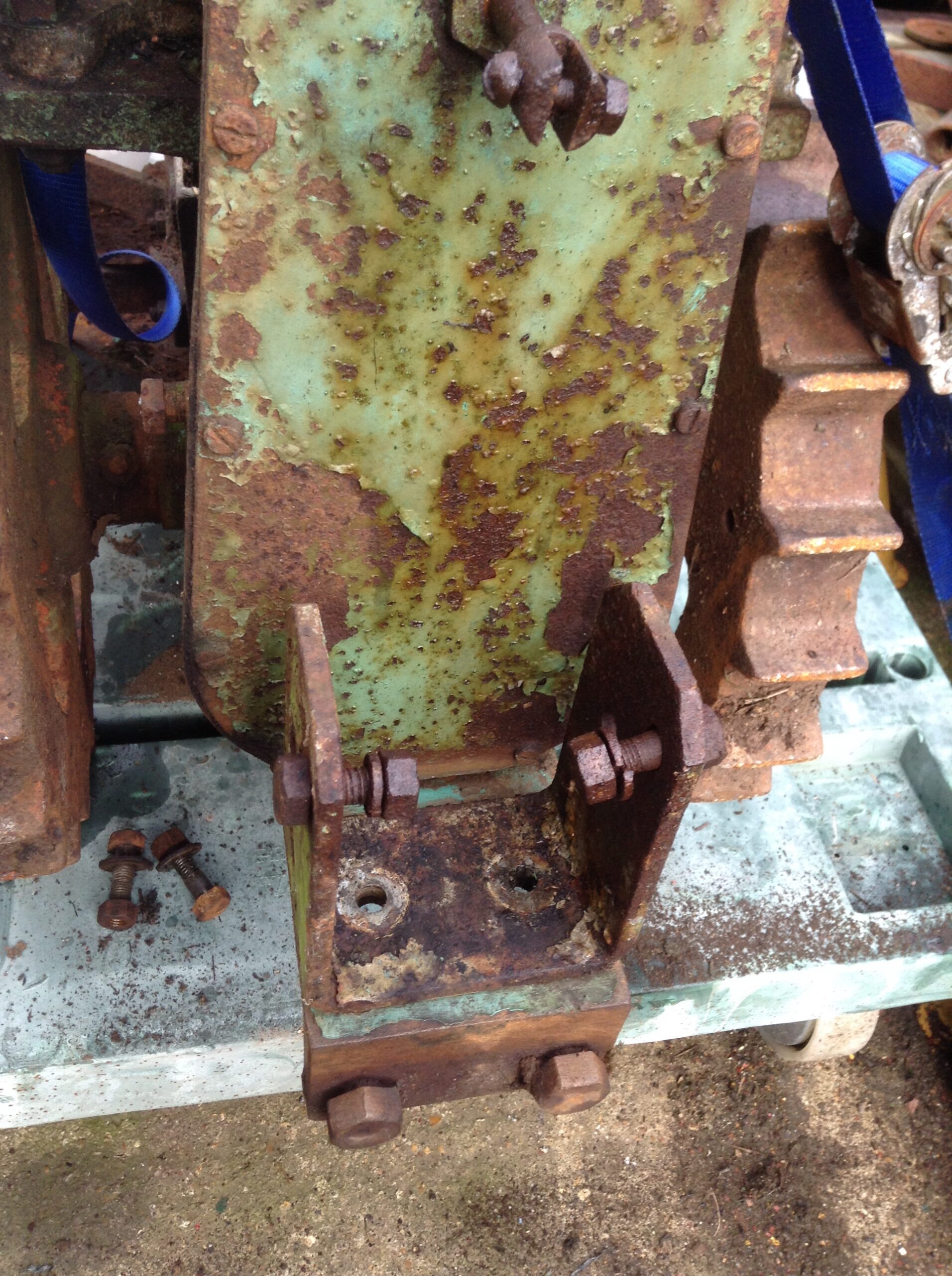

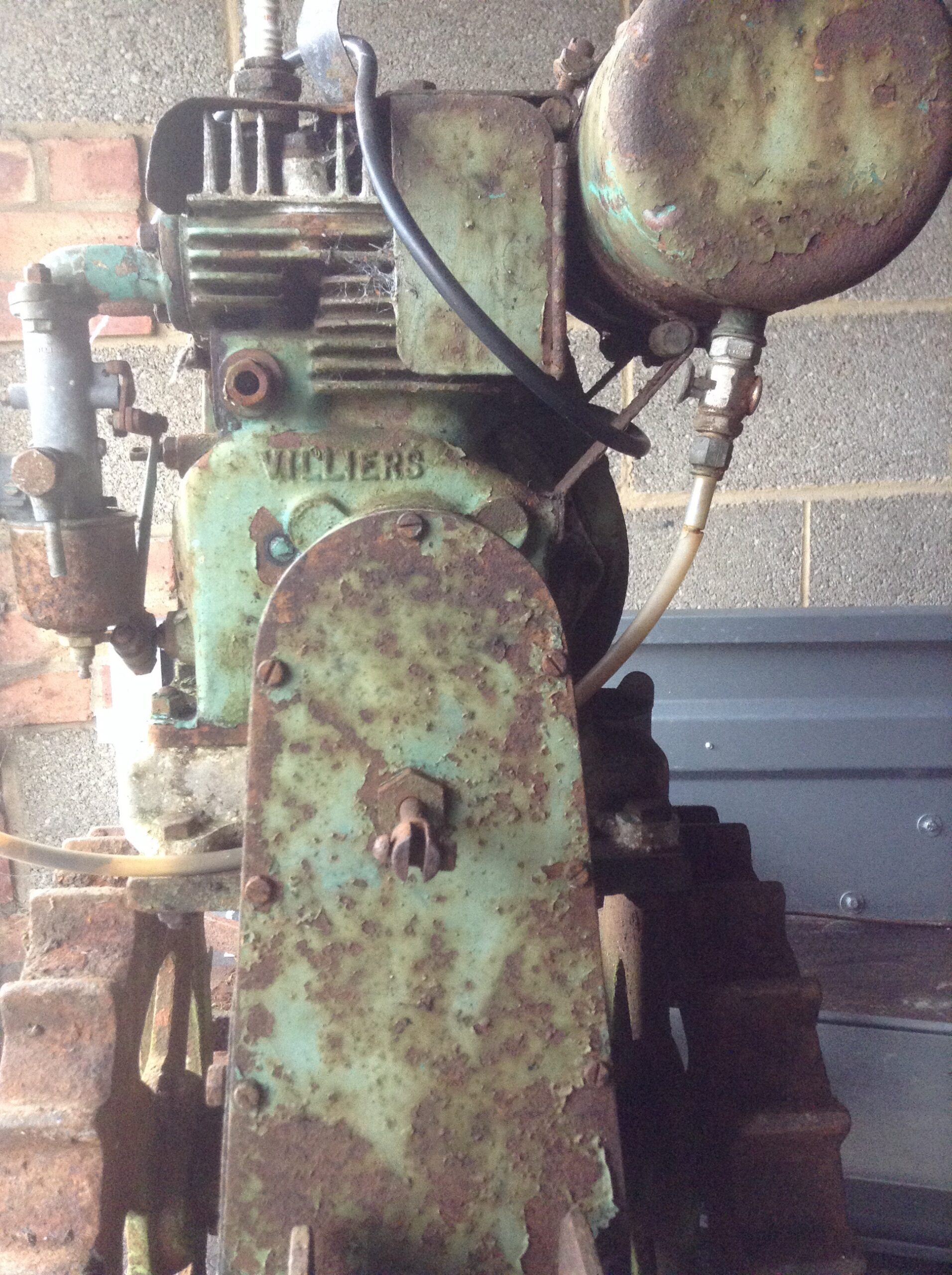

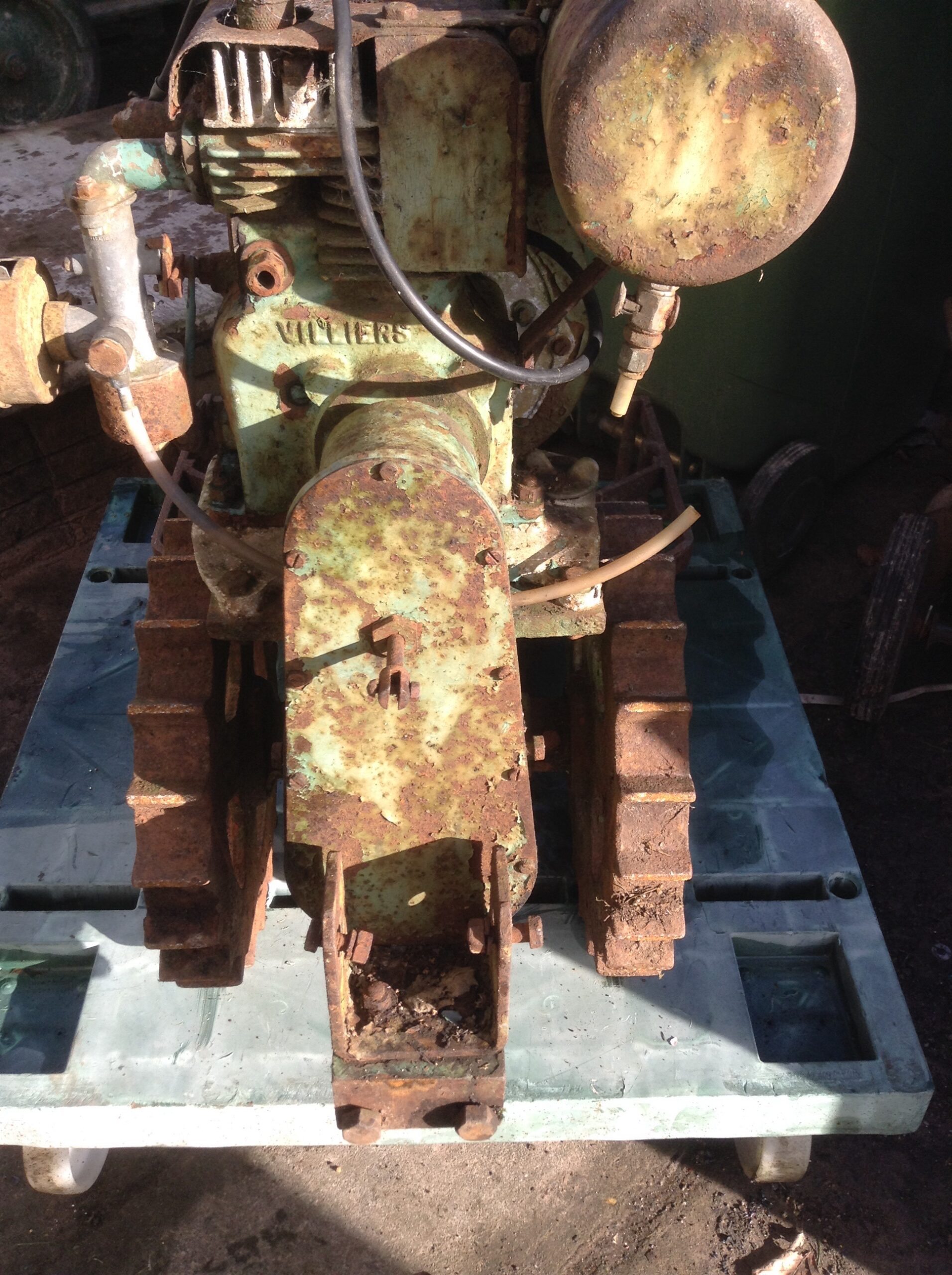

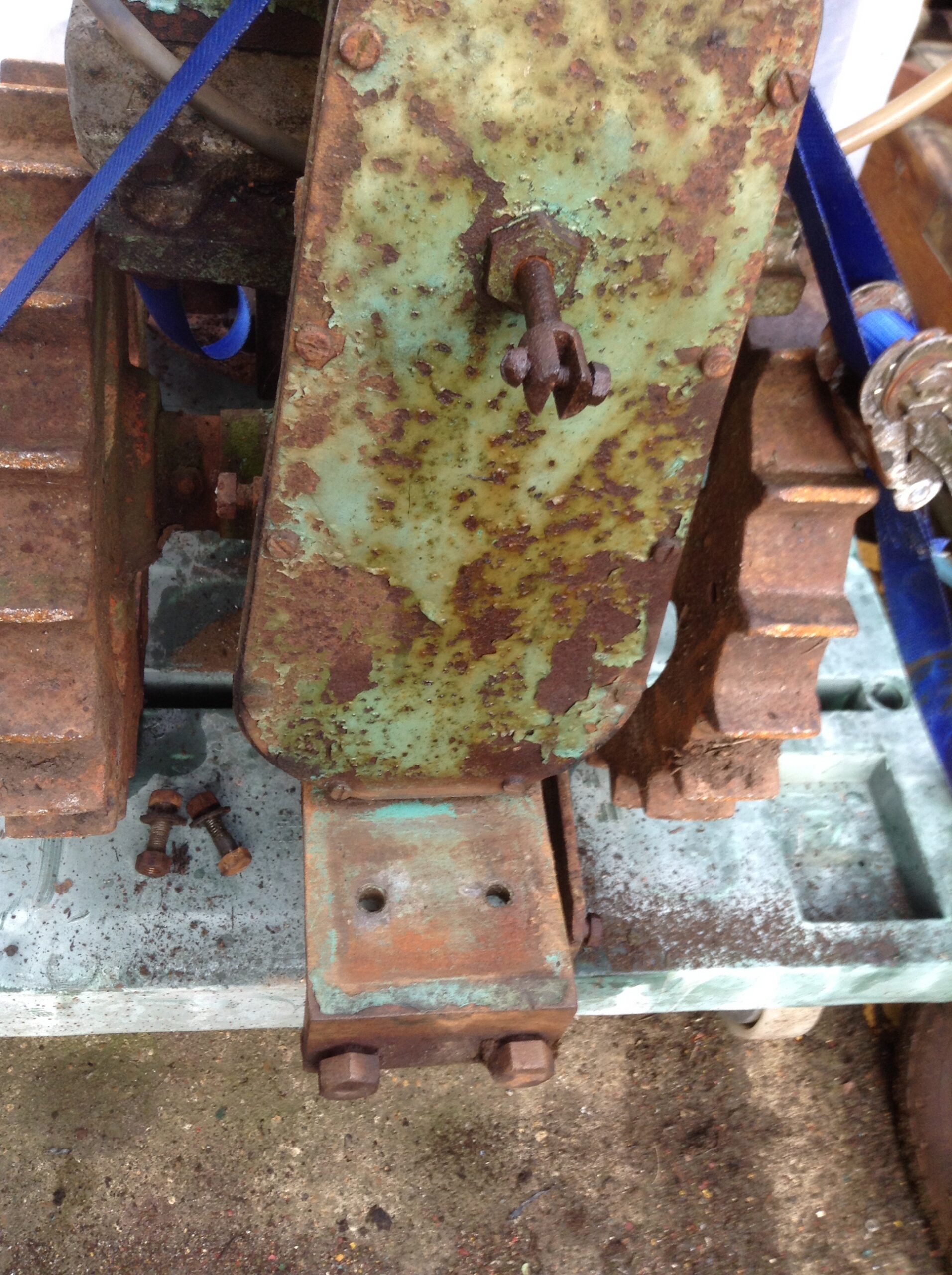

vhgmcbuddyMemberGood day to all & Happy new year. Has any one seen or herd of a Troy unit with a Brushcutter attchment on & complete with handles as the one I have got has no handles,if anyone has could they let me know the size of them also thickness of pipe work/leingth of handles, any info would be good. Thank you.

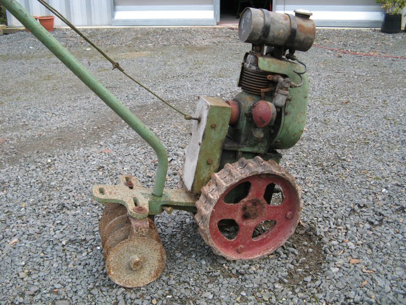

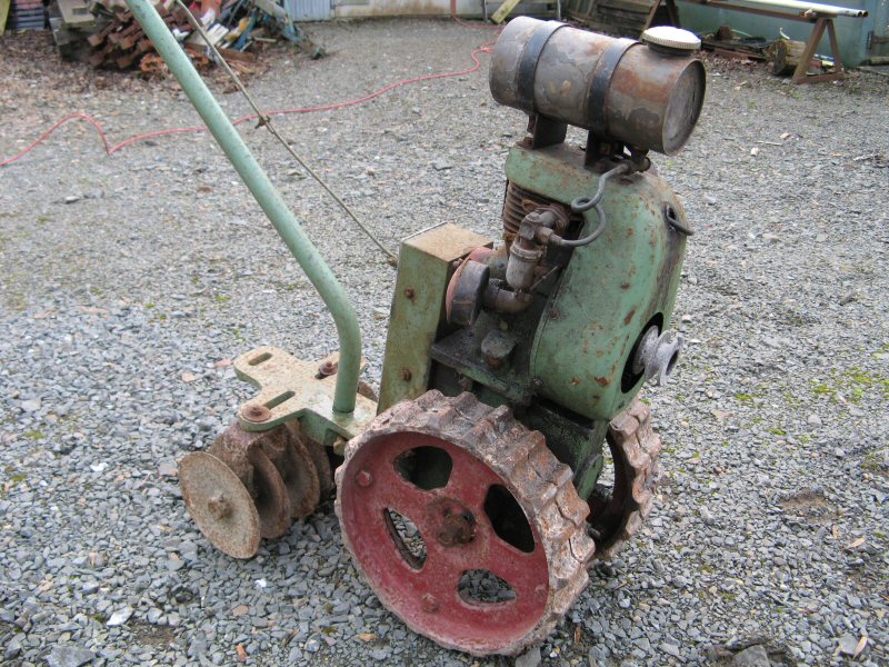

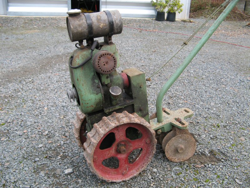

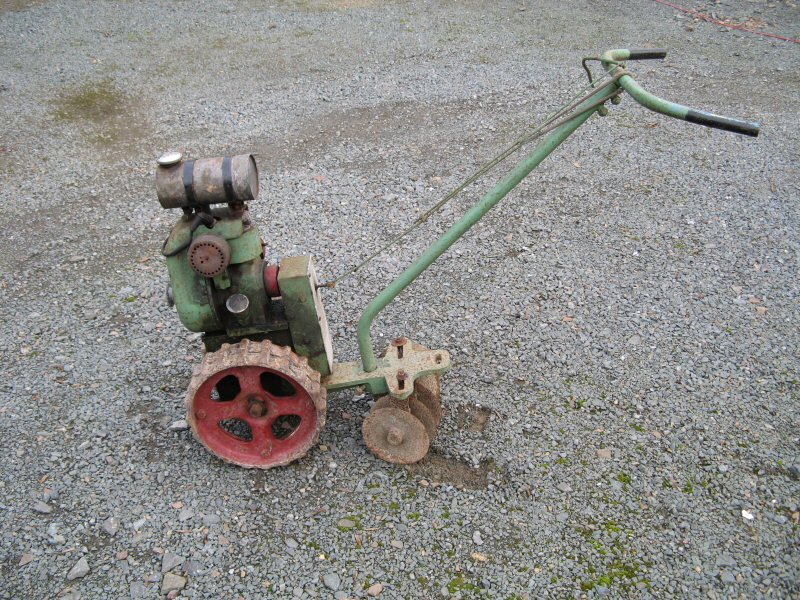

crawlerParticipantHello Tony, welcome to the forum. I have a Mk I Troy Tractivator in my collection.
I have a plough and set of discs for mine, your brushcutter attachment looks interesting.
I will try and get you some dimensions for the handle this weekend. Looking at my photos does the rear of your machine look the same as mine where the handle connects?

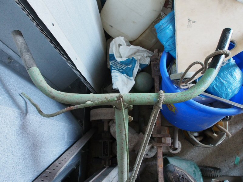

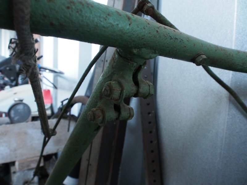

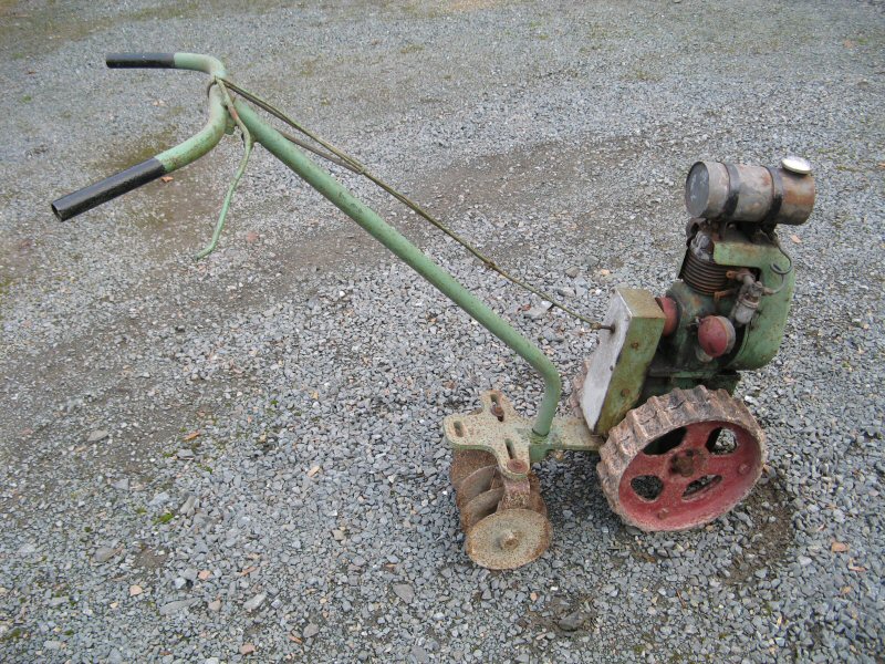

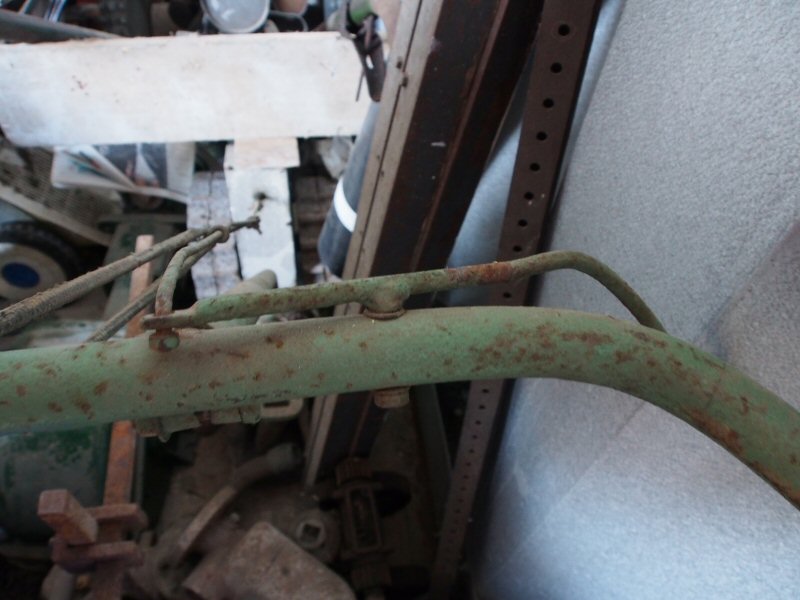

crawlerParticipantHi, I got the dimensions of my Troy Tractivator handle at the weekend. It’s just taken me a couple of days to get time to sit at my computer. It is sort of buried at the back various bits and pieces and as such couldn’t be got out so I hope the photos are okay.
The photo of the rear of your machine shows where the rod connects coming from the top of the handles, this pushes in to engage drive to the wheels.
If the PDF with the dimensions does not open let me know and I can email it to you.
If you cannot readily source tubing of the correct size you could always turn a short section of steel to fit the hole on the base of your machine and then weld whatever tube you can get on top of this.
I do not have access to a photocopier large enough to do the two brochures that I have. What I can do is photograph them and then crop the image to the size of the brochure and then email you the pics.Rob

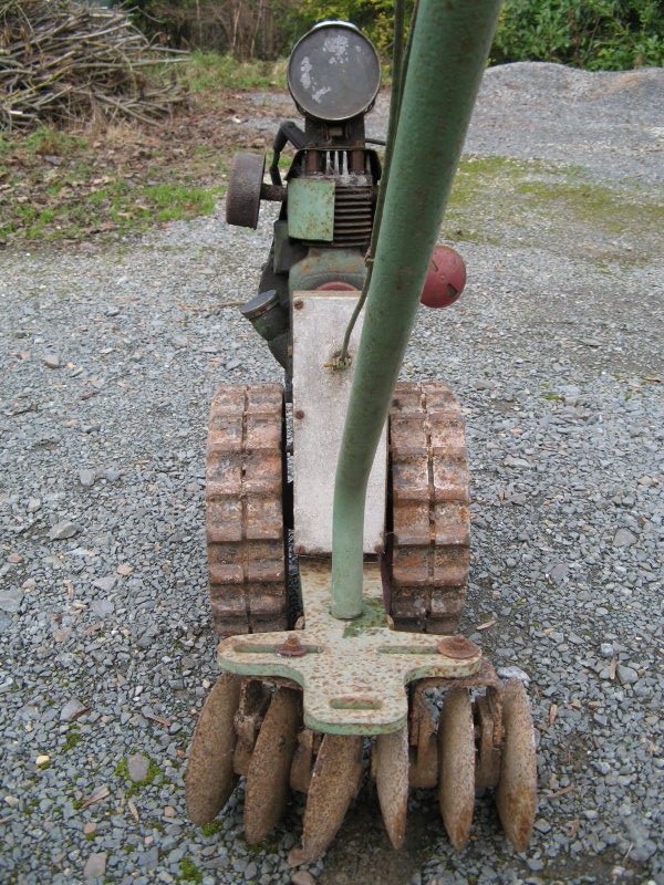

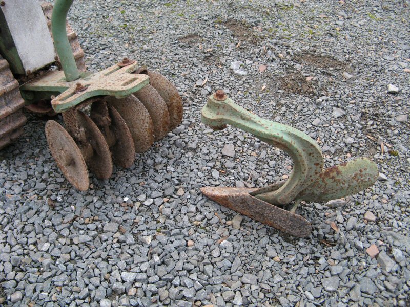

Have you checked under the ‘U’ shaped bracket that is bolted on the back? There might be a hole through the base section that would take the handle. Have a look at the attached picture, it is a zoomed in section of one of the brochures. It looks like it shows a back end similar to yours. The plough looks like it is mounted via the two bolts that you have at the rear of your machine. From the brochure it looks like the ‘extension tool bar’ also bolts on here. Perhaps this was the standard back end for the mk2.
RobJanuary 26, 2015 at 4:50 pm #11534
vhgmcbuddyMemberHi Rob thanks for that I will have a look to row and let you know.
