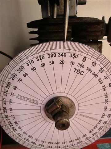

Solve for � given the rod length, 1/2 crank stroke and piston drop from TDC. You can drop that equation into a spread sheet and plot piston drop versus � then put a trend line through it if you do not want to do the inversion.No, I didn’t do it from memory !!!
A 360 degree timing disk on the crank is the easy and safe method. You can download and print a disc from the net and glue it to a bit of card.
Sending this from the tablet but will add an image from the PC later.
