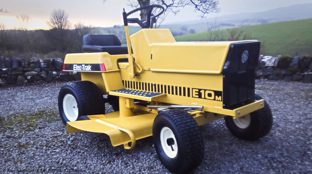

alanParticipantFinally got all the Elec-Trak parts for the 36 Volt battery powered tractor gathered into the same location and have now reassembled it and it all works including the mower deck.
We replaced the bearings in the original 36v drive motor and had it checked over and on the bench it runs really quietly. However the tractor still has a normal 4 speed gearbox from a petrol ride-on machine and when it’s working you can hear the gearbox inners, and the belts and pulleys turning without any petrol engine noise to drown it out and it’s quite weird.
I read a review in a 1970’s issue of a machinery magazine from the US and it said that the wiring in an Elec-Trak was pretty terrible with no wiring loom whatsoever and wires all over the place – and it’s true the wiring and where it all runs is quite appalling, the original factory wiring was sort of shoved in behind the dash but thankfully it’s tidier now.
Just short of a couple of deck decals now and it’s done.
Would I sort another electric tractor? Probably, there’s no petrol leaks to worry about and the electric power is easier to sort – not sure about modern electrics though.
