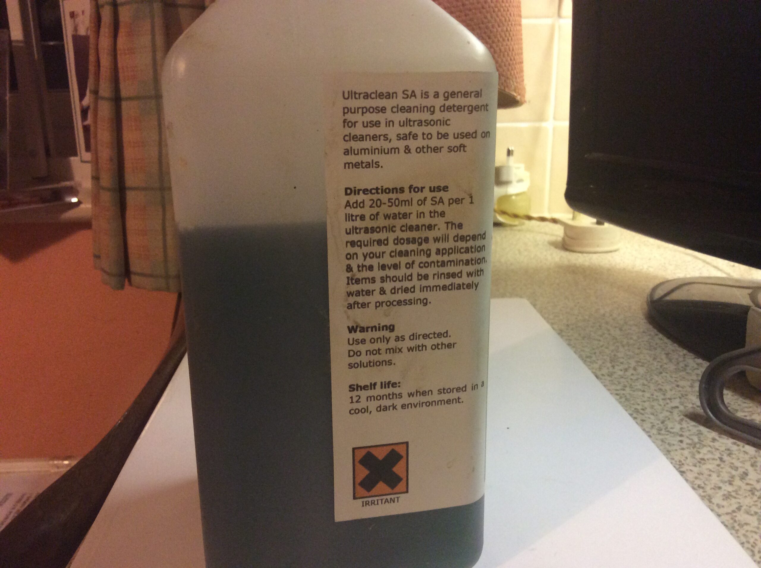

September 30, 2014 at 8:44 pm #10233
wristpinParticipantOctober 1, 2014 at 7:26 am #10237
