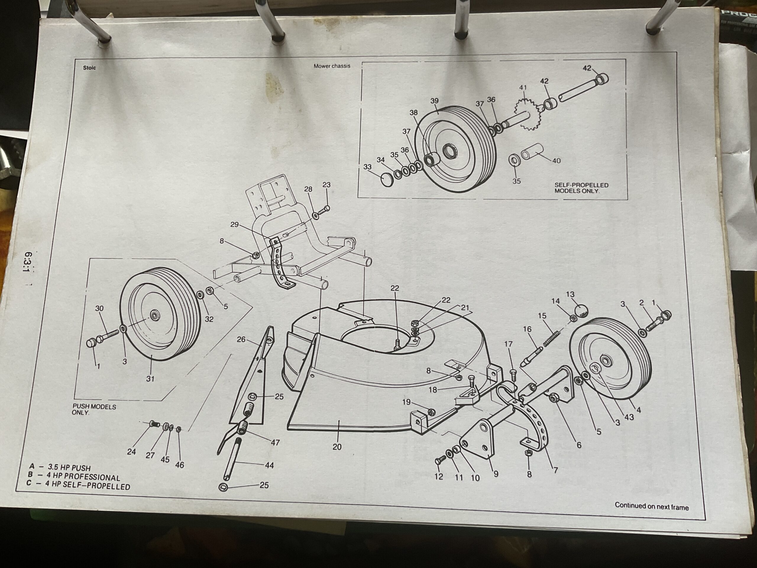

wristpinParticipantBriggs flywheel keys. From the 1983 Service Update Seminar. In standard form the Stoic had a carrier disc with three rigidly bolted blades.The carrier disc was fitted to the engine crank via a hub with two protective “Ferrodo” friction discs and clamped with a bellville washer.
I believe that some commercial users replaced the disc with a bar blade that may have been borrowed from the Hayter parts bin.September 15, 2023 at 9:27 pm #41240
wristpinParticipantIt should drive on both rear wheels. With the chain running in line the sprocket should drive the solid axle running across the back of the machine and driving both wheels via sprag bearings pressed into their hubs. The sprag bearings grip the axle to propel the machine forward but allow it to be pulled back in use. If the cross axle is turning but the left hand wheel isn’t , either the sprag bearings ( two in each wheel) are shot or have been incorrectly fitted in the wheel . The bearings are an off the shelf item – not a specific Stoic part.
September 16, 2023 at 1:29 pm #41241
wristpinParticipantGoing back to your first post and your search for Stoic parts, and in particular a rear wheel, there is a possible pitfall. There were three models of Stoic, 3.5hp push, 5hp push and what you have 4hp self-propelled ( power driven). So, if you are looking for a donor machine for a rear wheel , it needs to be a Self-propelled one so as to get the correct rear wheel which will incorporate two sprag bearings to transmit the drive.
