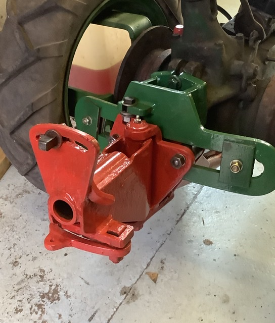

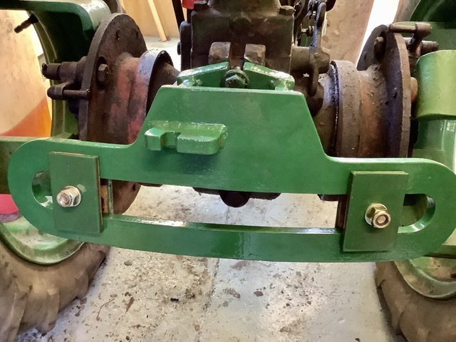

roatavatorParticipantAdjustable stops look good. I’ve found in practice using my SIMAR plough in a number of competitions that I only need to have the plough fixed in the central position for the first run of the opening split. Then I have the plough floating for the rest of the plot. I found it too hard work to keep it fixed for subsequent runs, and properly adjusted the plough runs nice and straight floating.
I’ll be interested to see how yours works for you.
PeterFebruary 18, 2020 at 8:45 am #33339
knappsterParticipantMany thanks Charlie for that info, that has cleared that up for me very nicely I have only used normal two stroke oil up to now, should work out a little cheaper 👍
Rotavator, thank for you comments, I haven’t used the plough myself yet so it will be interesting to see if the stops are any use or not, your method sound good just to let the plough follow its own track in the furrow once you have opened, I have never ploughed with a single furrow before so it will be an interesting time, I am more used to a 7 furrow reversible so this will be good fun. I am looking forward to it and some help from you guys with my efforts.
