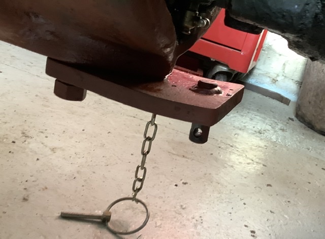

    Rebuilding my Simar Rototiller just taken the plough mount off and made this mod to it drilled a small hole in the mounting plate fixed a large split pin in to hold a chain from the linch pin holding the plough on its mounting peg. Seemed a good idea so as not loose it if it comes unclipped a simple fix if you have this type of mount

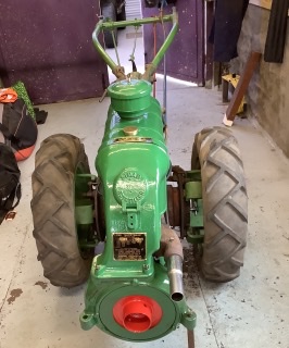

    The old girl is coming together test run soon

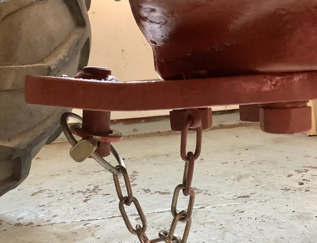

    knappster
    Modified plough mount

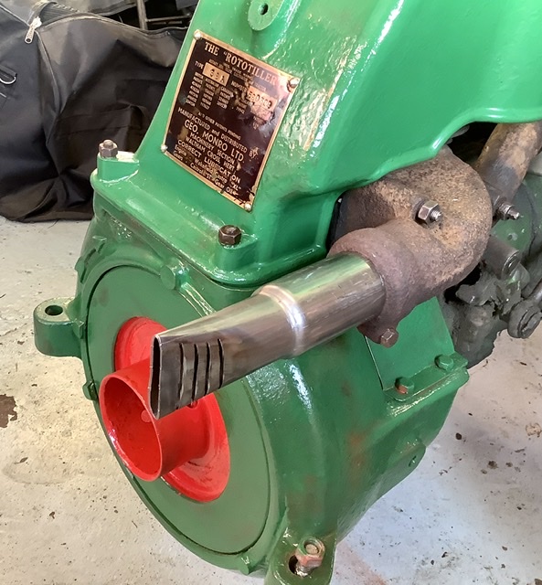

    #33190
    End of exhaust should be flattened and have slots cut into side see https://staging.vhgmc.co.uk/photo-galleries/simar-imgsimar025/

    Thanks for the interest, the paint was the closest I could find with out having it mixed, it is Buckingham Green byJohnstones looks okay when dry on the Simar. Hear is a photo of the plough hitch hope this helps

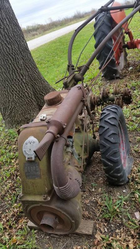

    Charlie. All the various SIMAR models with front exiting exhaust I’ve seen have the “usual “ stub exhaust. But many continental ones have large exhausts, sometimes a serpentine layout, incorporating exhaust boxes. Am I right in thinking they were SIMAR options or accessories? Perhaps they were available after market over here?

    #33200
    roatavator
    This is a typical continental exhaust.

    #33274
    knappster
    Made a replica of the original exhaust for my Simar, something close to the original, have to see what it sounds like 😳
    #33278
    roatavator
    Very nice job. What it will sound like? Answer: LOUD!!

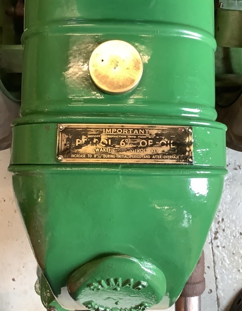

    Hey Guys help
    Can anyone give me the correct two stroke mix for my Simar, on the machine it says a mix of 6% for 5l of petrol that would be 300ml of oil 😳 that seems a lot am I reading this right ? Or is it for a full tank ? I am at a loss help
