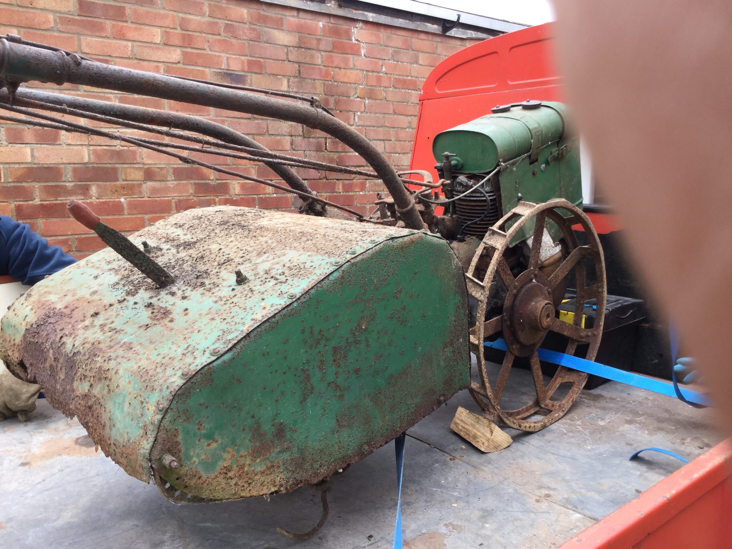

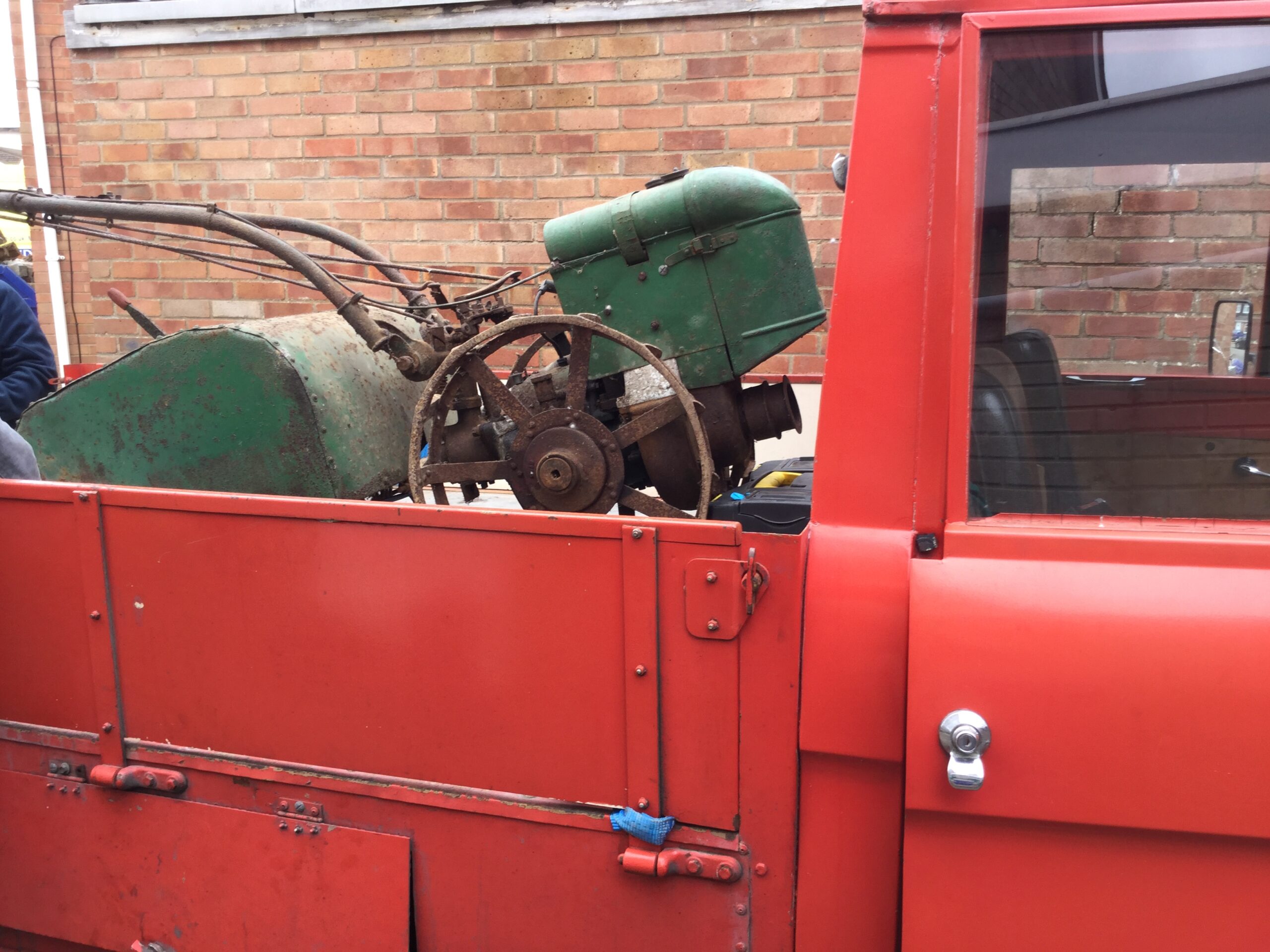

roatavatorParticipantSorry Charlie, I’ve now had a better look, its 6239.
Apparently it hasn’t been run for more than 20 years, the machine belonged to the grandfather of the late husband of the lady I bought it off, and has been in storage since, but it has compression and appears fully complete so hopefully its fixable!April 18, 2016 at 8:58 pm #20606

roatavatorParticipantThanks Alan, I posted them on the road, Jr driving Commer at 40mph produces 95 decibels according to my Ipad, must have rattled the brain!
