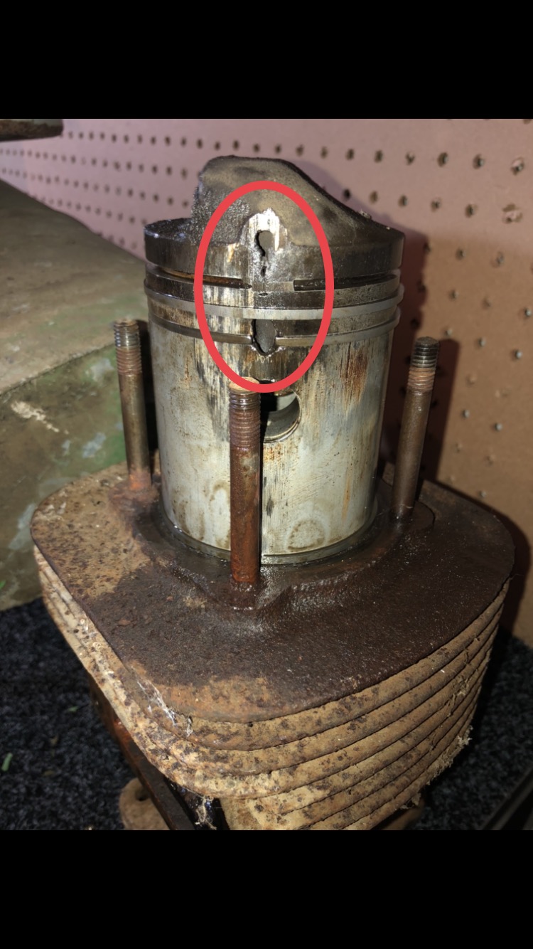

    Hi all, I have saved a Simar 56 from scrap recently. I found it had no compression and tonight I found out why. The a piston pin circlip has come out and damaged the piston and bore. I can’t seem to obtain any parts for it so I will take it down to the engineers tomorrow and see if he can repair it. I am not holding my breath though! If anyone has any spares I would love to hear from you. I am however in New Zealand. I really do want to save this old beast! Regards Alastair

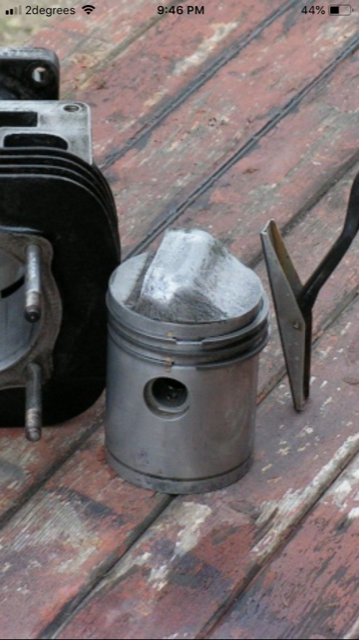

    Sorry, the photos didn’t upload but here is a pic of the piston. A very sad sight!

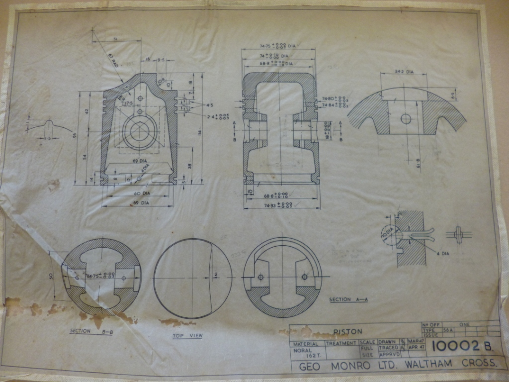

    Photo files need reducing in size, they need to be no more than 3072KB. For microsoft users there is a guide in help and information section of forum.
    The attached is a photograph of drawing for piston, the original is at MERL, Reading UK.

    Thanks Charlie, I will upload again tomorrow. Do you know where I could get a piston and barrel from? I’m hoping my amazing engineer friend can do something with them. Thanks for the drawings, very interesting!

    I took the barrel and piston to the machine shop today. He said he can resleeve the bore no problem however the piston will be a challenge but can be done. Note on my photo the large groove io the side of the piston, caused by a wayward gudgeon pin clip. Is there meant to be any sort of groove on the piston? I am not sure if I am looking at pure damage or if there is some kind of port arrangement among the damage. I found a photo of a similar Simar (55?) that shows the piston without any groove.
    It is worth mentioning at this point that your assistance is invaluable Charlie, I am indeed very grateful for all your input.
    #30308
    That is damage and should not be there. I have had it suggested that if a suitable piston from a diesel engine can be found it is possible to machine the crown to the required profile, as the diesel piston will have a much thicker crown. If you need a better copy of the drawing let me know.
    #30315
    Hi Charlie, yes another drawing would be fantastic! The engineer is quite confident that he can either repair this piston or make me a new one. The drawings are invaluable as gaining spares is impossible! I really want to restore this machine to the same level as my Monrotiller but first I need to see how much time and expense is required to raise the piston. The cylinder will be easily repaired with a sleeve and I can have new rings made. Thanks once again, Alastair
    #30316
    Alastair, two e mails with copies of drawings attached are on their way to you via e mail.
