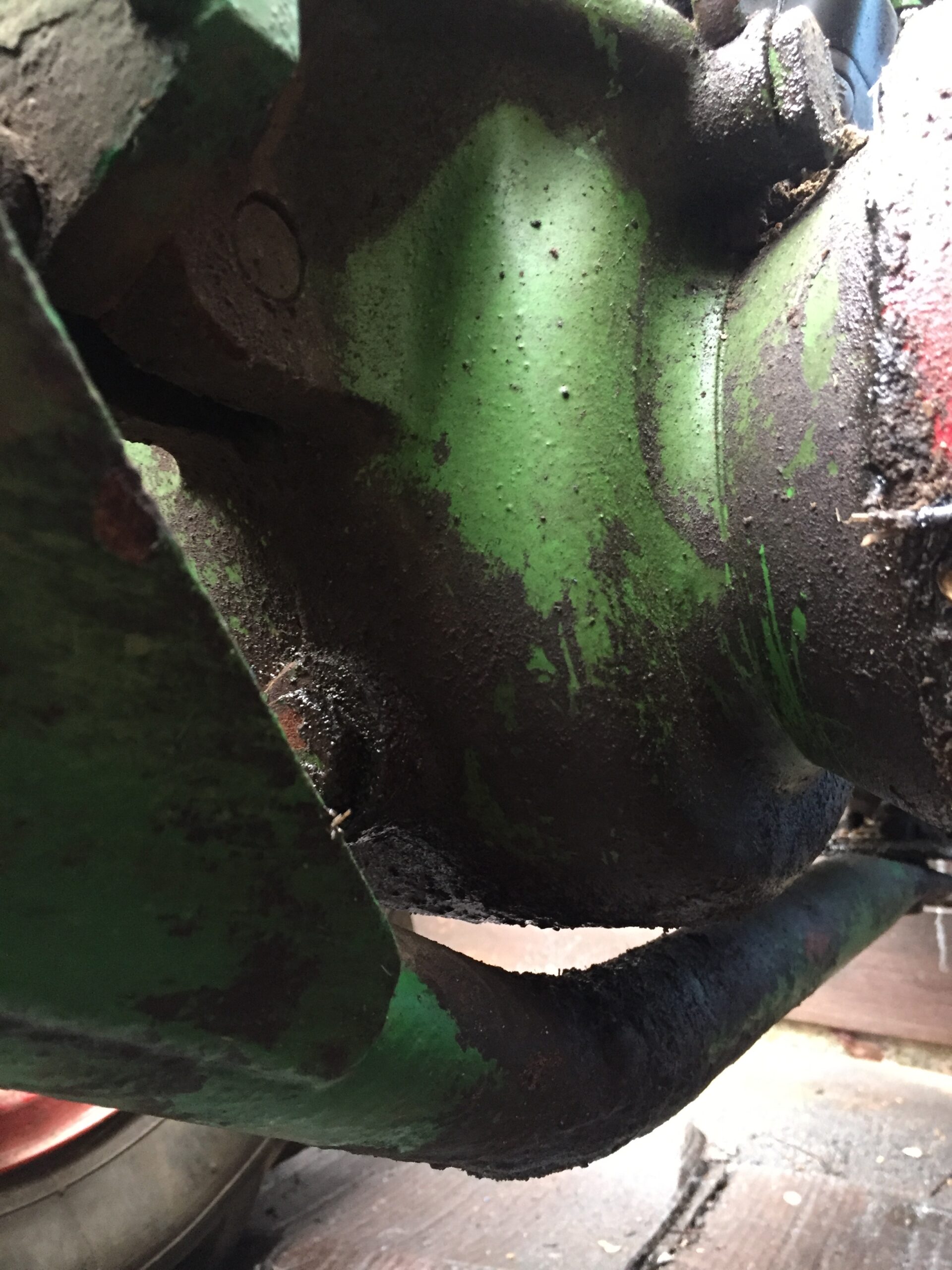

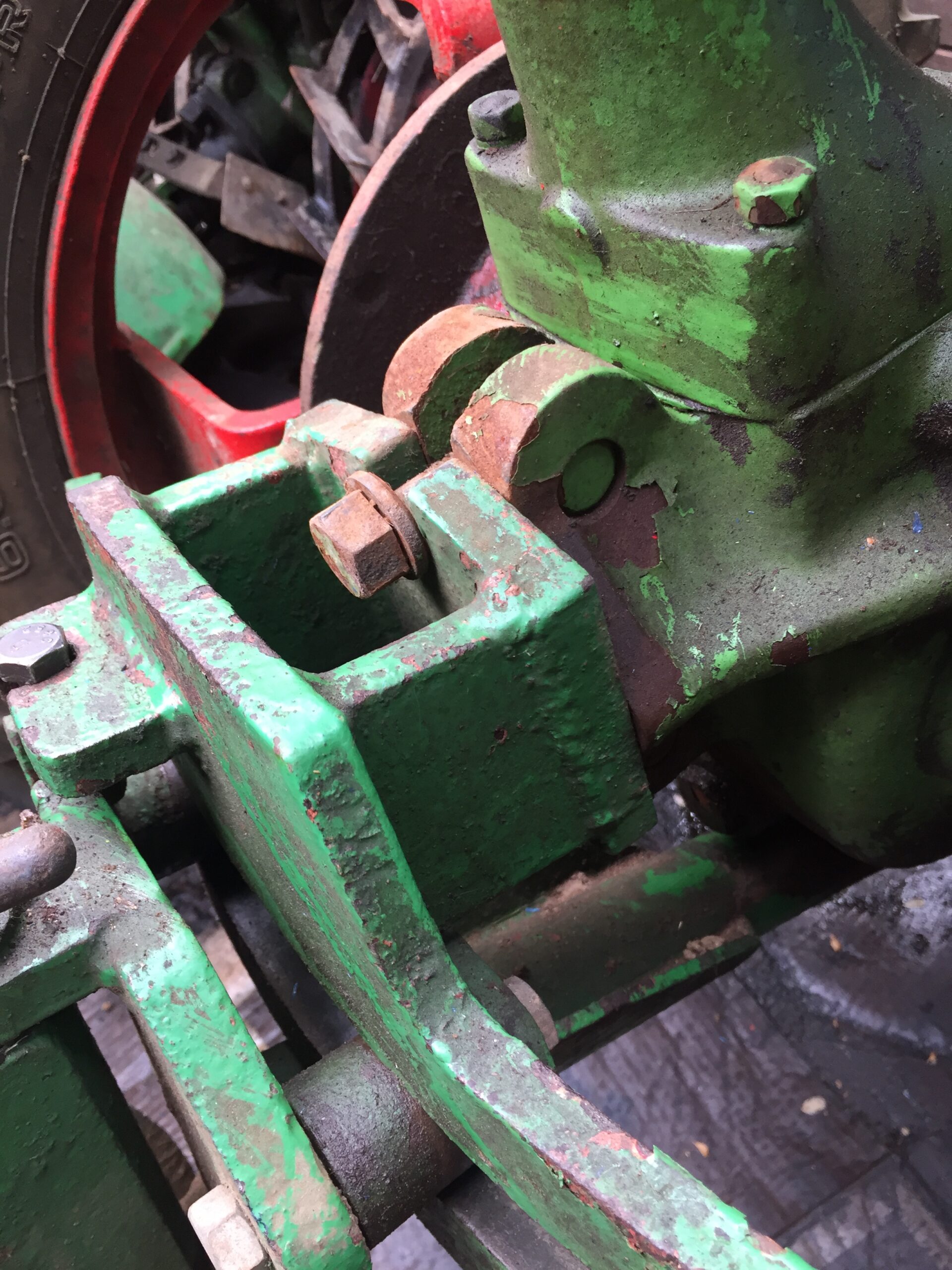

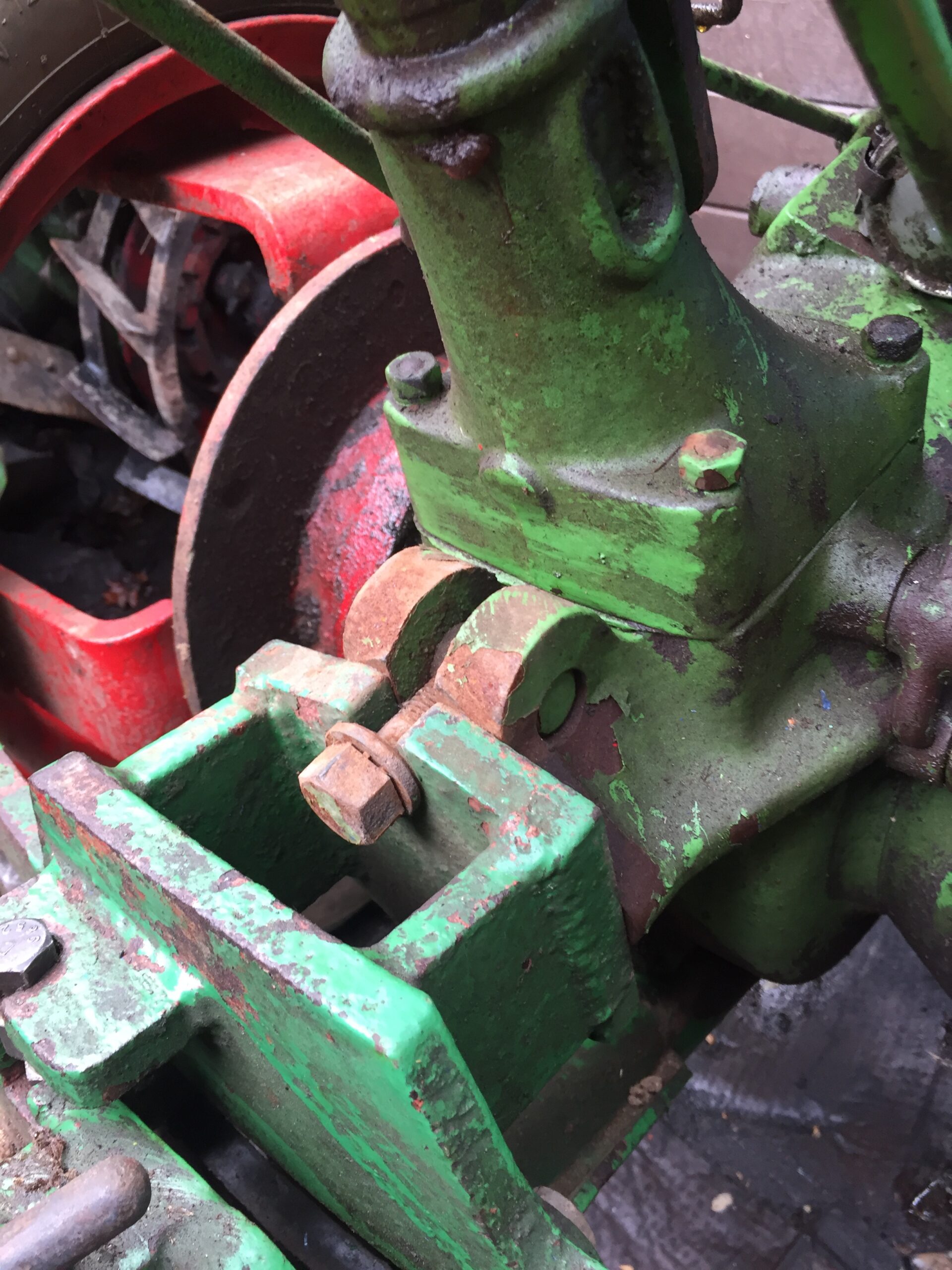

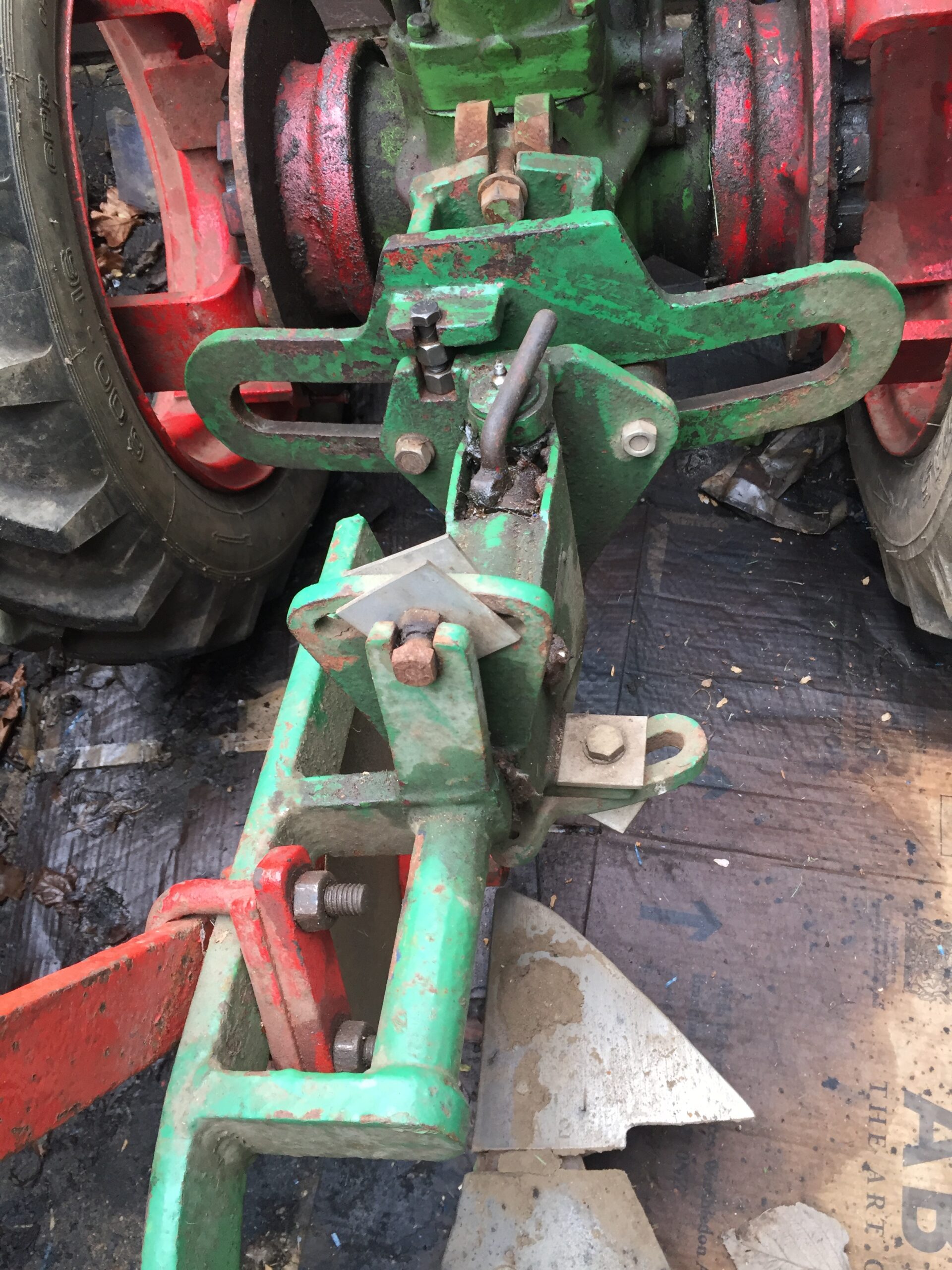

    Hope you enjoy it as much as I do. Ploughing gets a bit addictive! Let me know if you need more detailed photos of mine to help installation and I’ll gladly take some. Peter
    #31170
    roatavator
    Here’s a few which might help

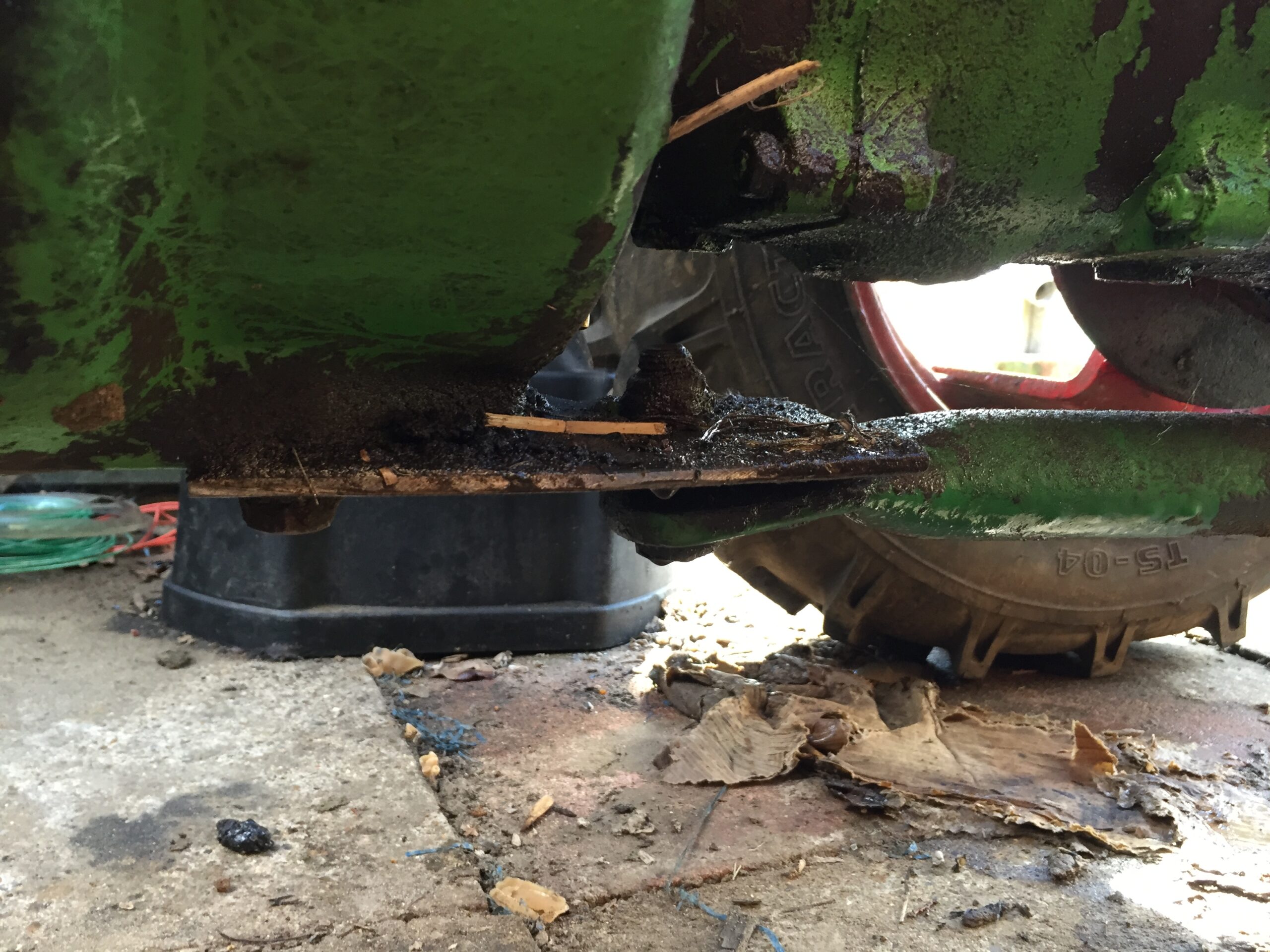

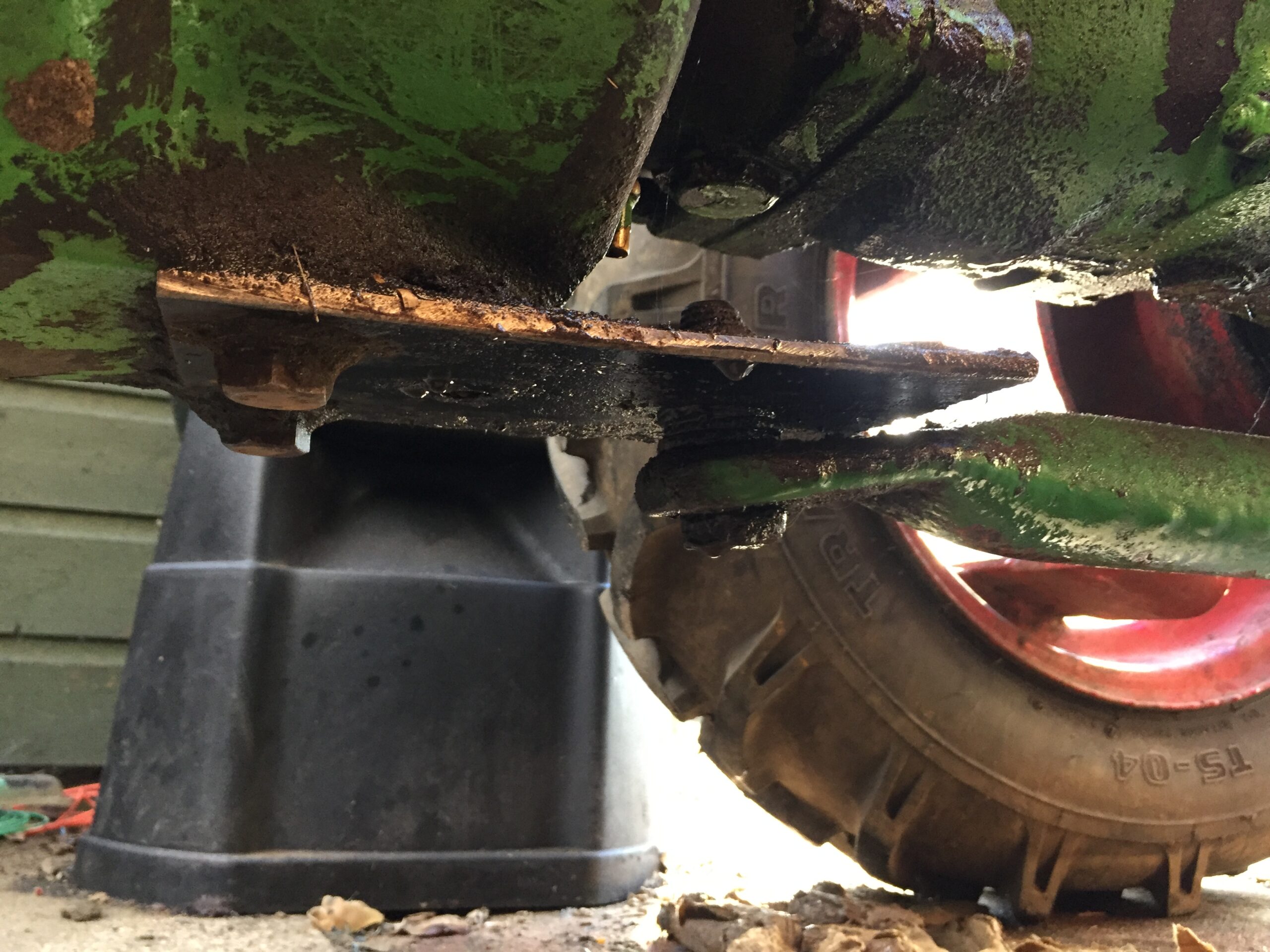

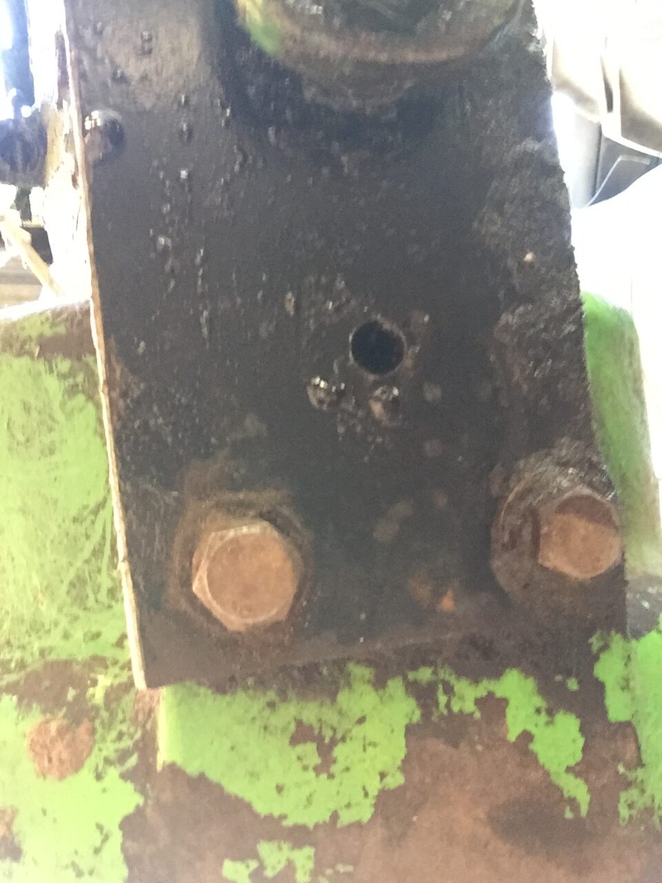

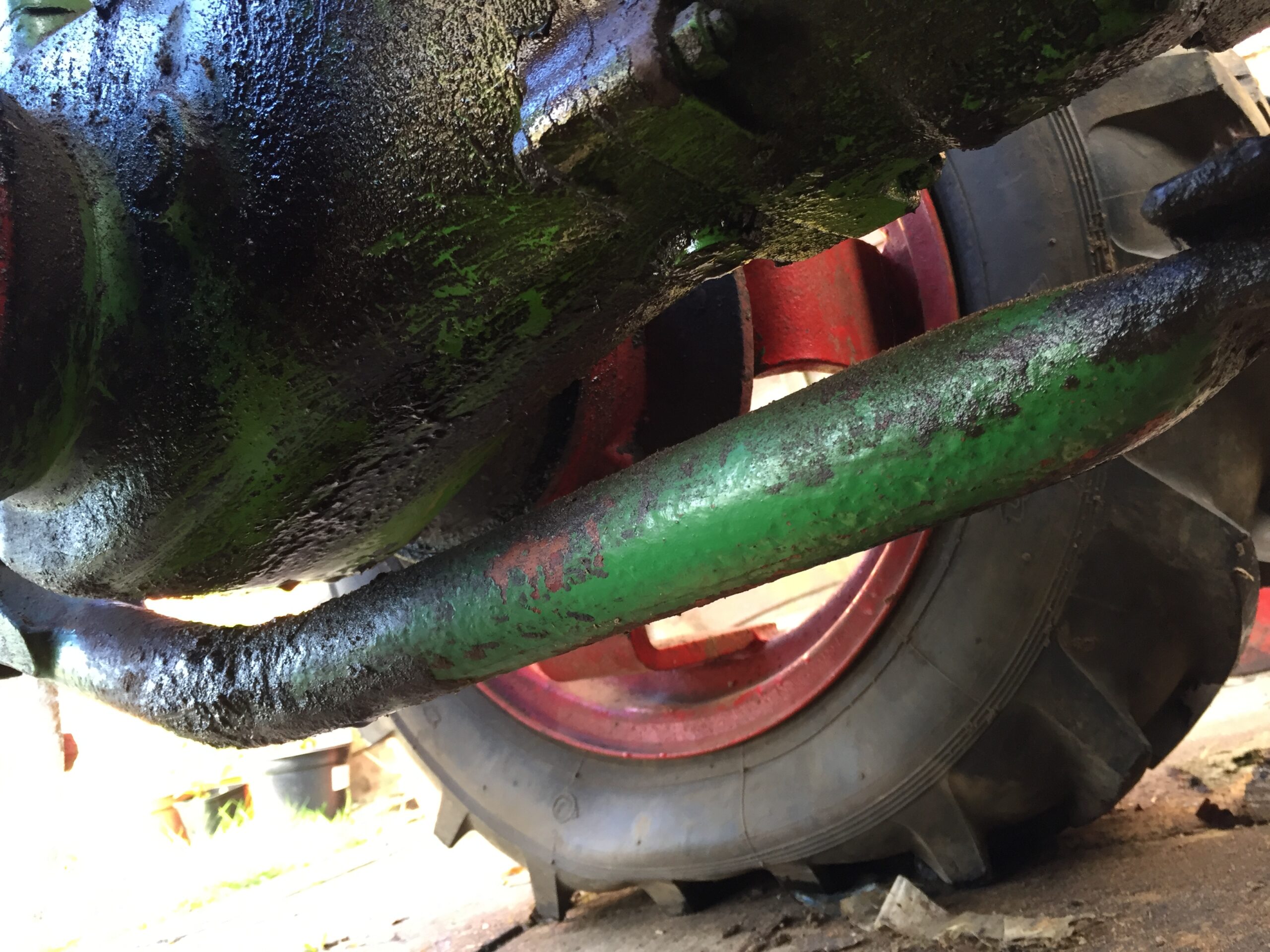

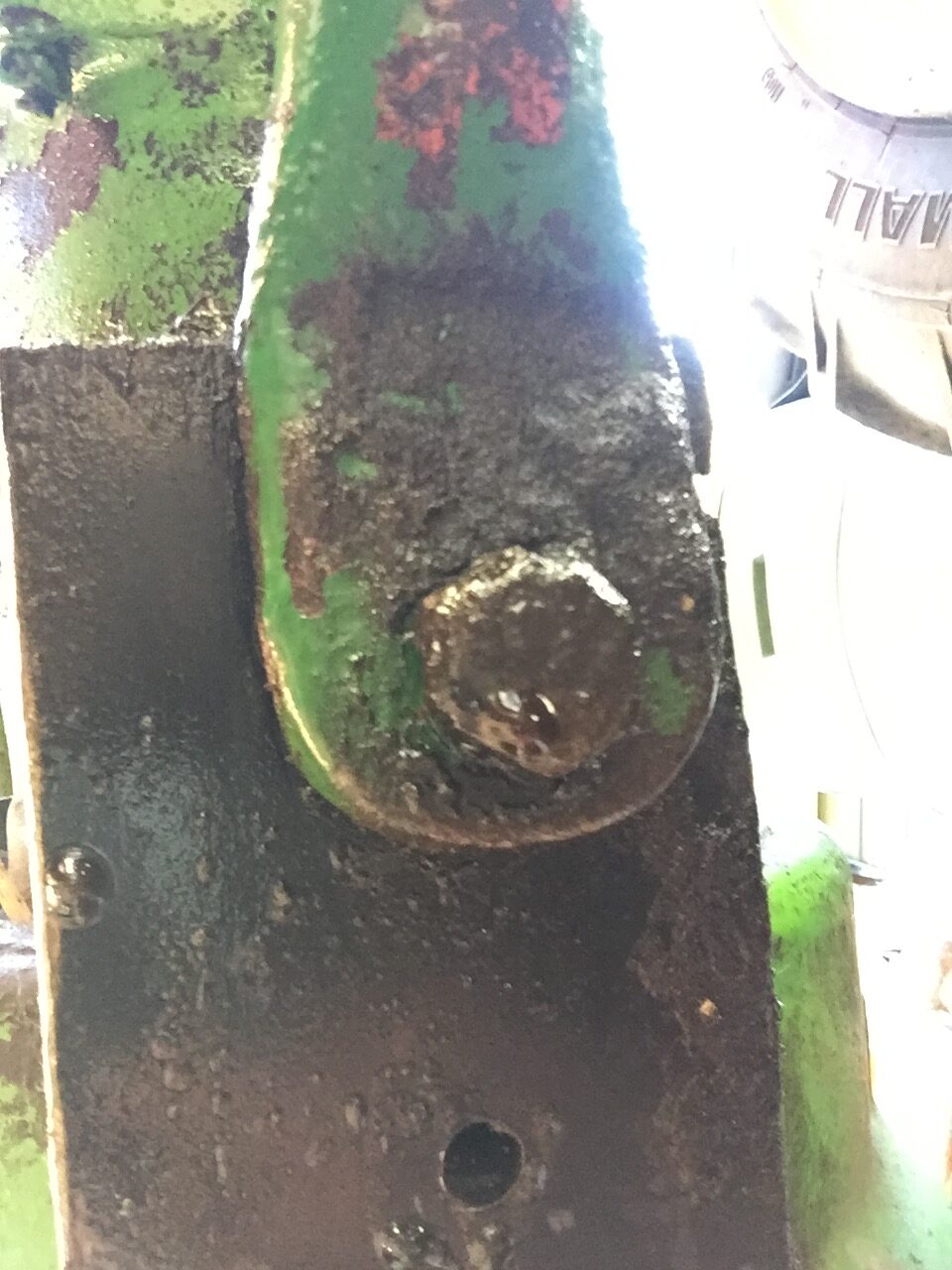

    I can’t photograph underneath where she stands in the shed. I’ll get her out over the next few days and do it. Possibly tomorrow, if not end of the week. Peter
    #31191
    roatavator
    Here’s the best I can do grovelling underneath. Hope they’re adequate for you to get the picture. If you need anything more detailed let me know and I’ll see what I can do. Peter
    #31204
    That plate looks different to the one fitted to my machine. I will see if I can get a photo or two of the one on mine. I do have drawings for one on the pc but they are in a format I can no longer open.
