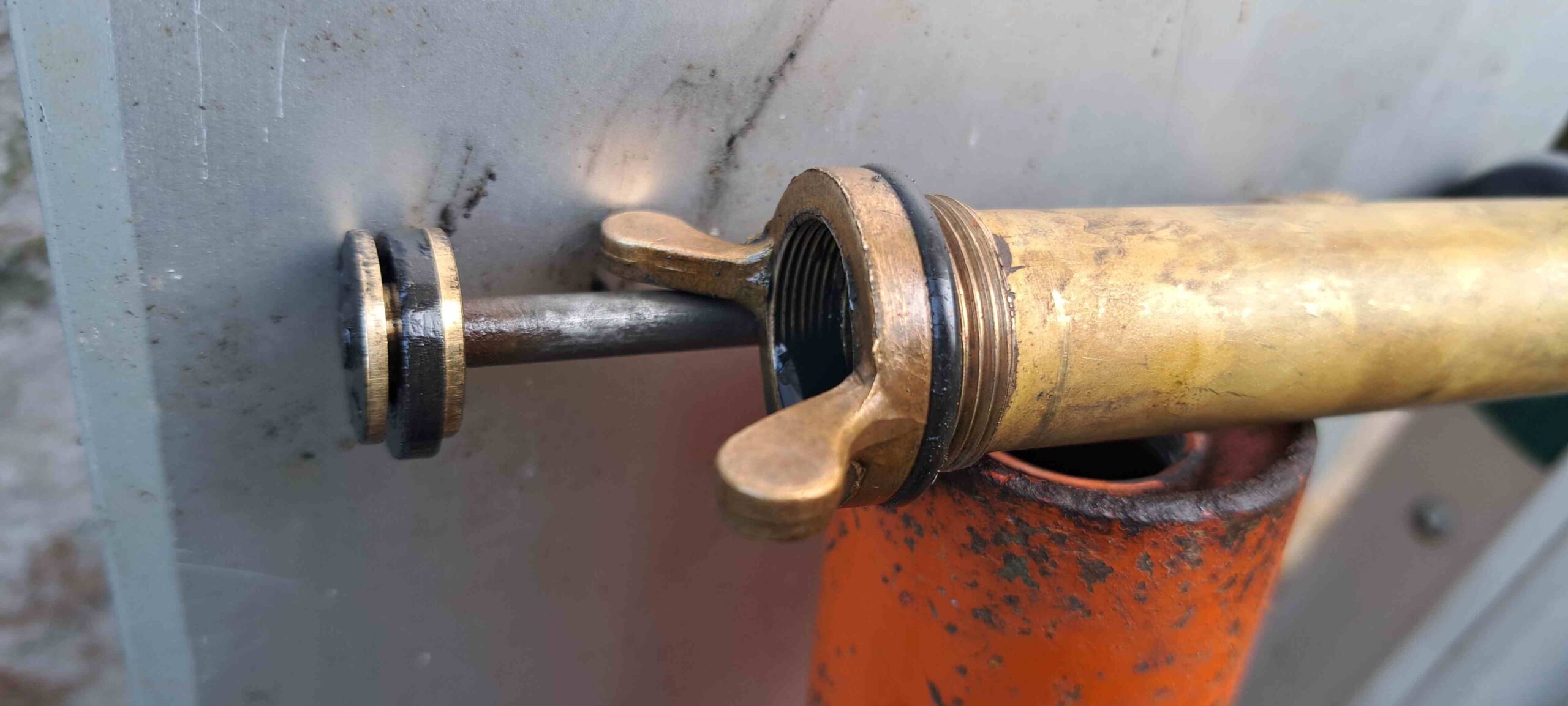

“does it hold pressure when pumped up with paraffin in it?” – No, because the seal has not only perished but is completely missing. Any chance of picture of what it should look like please? Thanks.October 24, 2025 at 12:48 pm #44250brianatbrant
ParticipantHi Charlie. I assume you mean the seal in the pump because of course there are seals also in the stop valve that control the flow of paraffin to the coil. I’ll go and take some photos and forward to you. Have you managed to dismantle the wand at all ? Still unsure how you get a replacement wick in one of these.

October 24, 2025 at 5:44 pm #44252brianatbrant
ParticipantPhotos as requested

As to the X300/x500 no, only the Flamewand which was found on fb Marketplace for £10. Another “bargain” 🙂 Folks used to have one back in the mid-80s but it got left behind in a house move.October 25, 2025 at 12:26 pm #44255brianatbrant
ParticipantOctober 25, 2025 at 12:37 pm #44257charlie616
ParticipantThank-you for this.
Interesting… somewhere along the lines I got the idea that the seal was leather. From the looks of the one photo, you have a somewhat loose fitting neoprene(?) washer. I’d guess that that is not the original.October 25, 2025 at 5:22 pm #44263davidbliss
