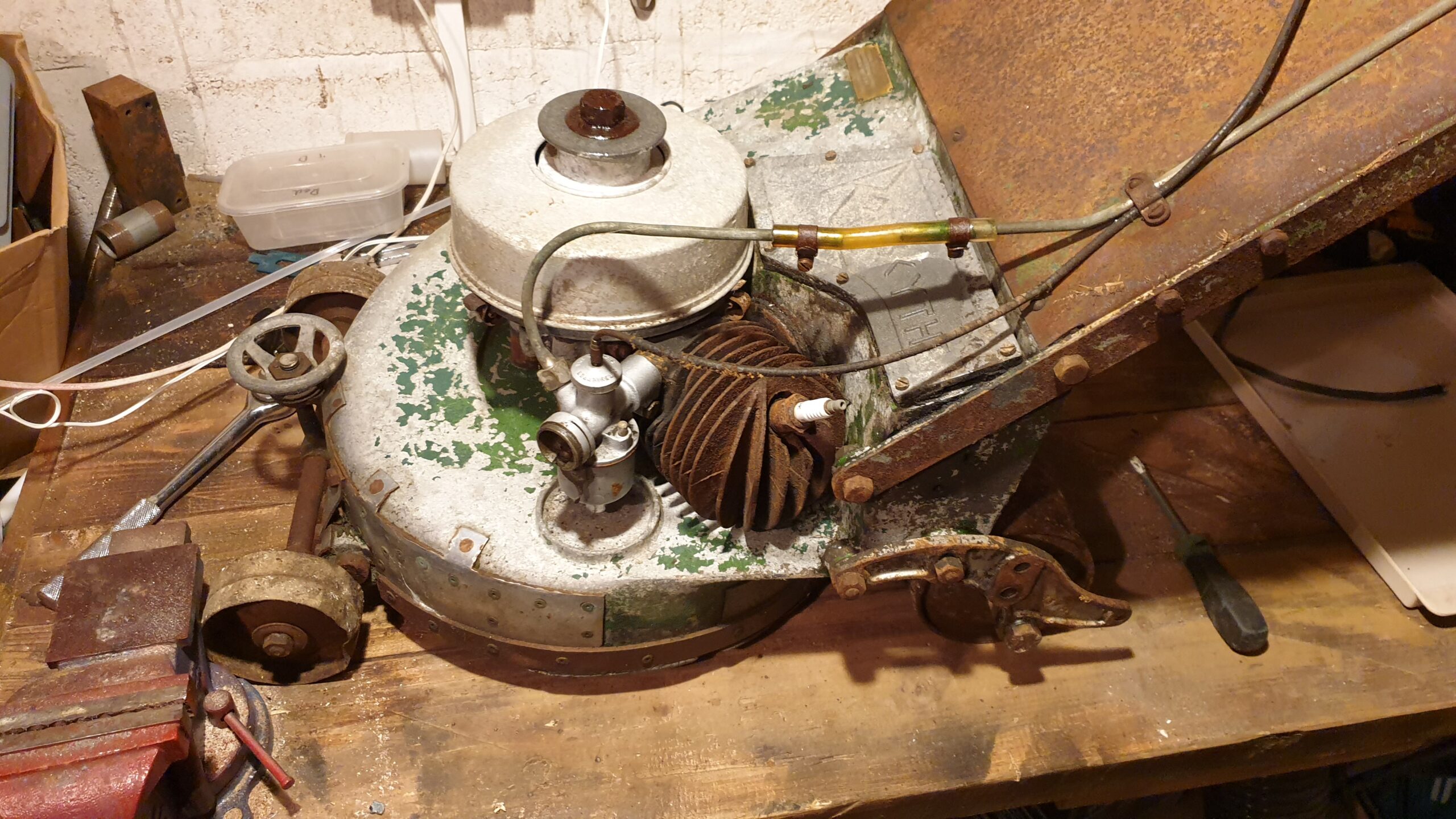

    Hello fellow vintage garden enthusiasts. I’m hoping someone may be able to help identify the Villiers engine that I have on my recently acquired Rotoscythe lawnmower. I hope the attached pic helps. I can provide more if needed. I’m looking to restore and use the lawnmower myself. I’ve also been lucky to get my hands on a working Monro minor tiller with a 7f on it. Both are my introduction to Villiers engines. Thanks in advance.
    #37064
    Welcome. The Rotoscythe engine may not be a Villiers, I know early Rotoscythe machines used a Bux engine.
    If you could post a photo of your Monrotiller and if it has it the machine number I can date it and give you some more information. Monrotillers are my speciality. It might be worth starting a new forum post for the Monrotiller.

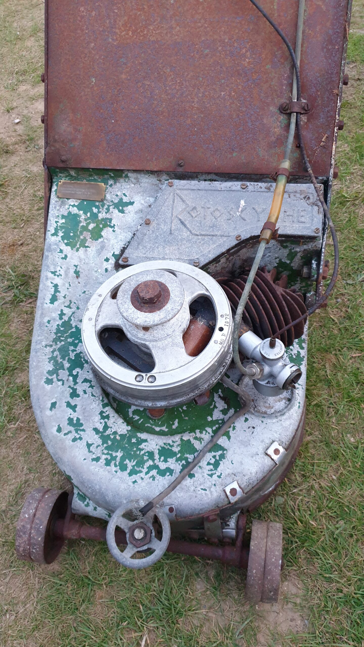

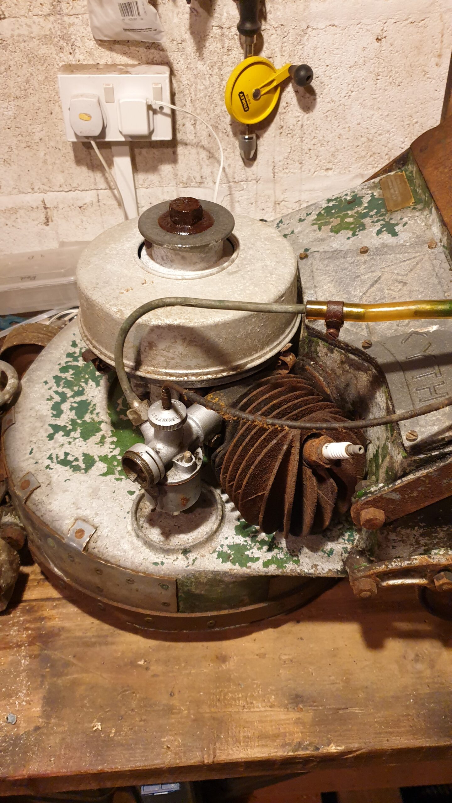

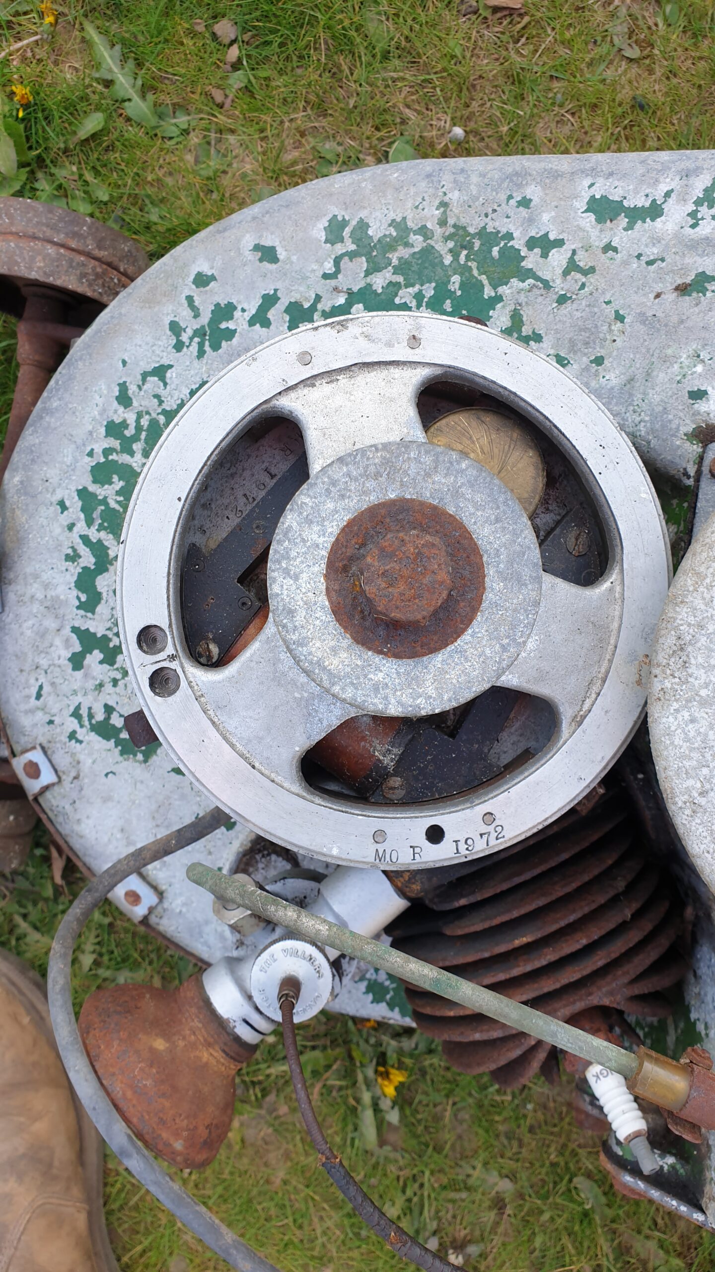

    Hi Everyone. I’ve added some more pics of the engine of my Rotoscythe. Can anyone help identify? Thanks in advance.
    #37140
    hdtrust
    Hi there, what a find!
    It looks like you have the fore runner of the Rotoscythe Eton model, you are correct to say villiers engine on that machine as yours dated from roughly 1935,Although its lost it original colour on its hood.Rotoscythe did use Bux engines from 1939 onwards. Hope this helps
    #37143
    monz
    Wow. Thanks so much. That’s amazing. I had no idea it was that old. Have you dated it purely on that time frame being the only period in which that engine was fitted? I saw an old brochure from 1936 that had one in but I assumed mine would be a later model. Now I’m even more keen to do it justice. Do you know which model Villiers engine it would be? Or any direction which might lead me to find out, so that I can get the correct spares. It has a fairly substantial crude repair to the hood by means of a steel and an aluminium strap around the base. I think it must have had a substantial crash at some point.

    Hi Monz
    You may email me direct via this web site or go by our web site http://www.hdtrust.org ,I need better photos of that engine to direct you to the right place for spares.
    The damage to the hood (aluminium cast)
    I understand Charlie saying its part of its past, but the repair appears not to be safe, which was probalby unknown to the repairer at the time.
    Steel next to Aluminium of any kind is a complete no, no the two will react via electrolysis, coursing the Aluminium to corrode internally. Again I require photos to help you
    Kind regards
