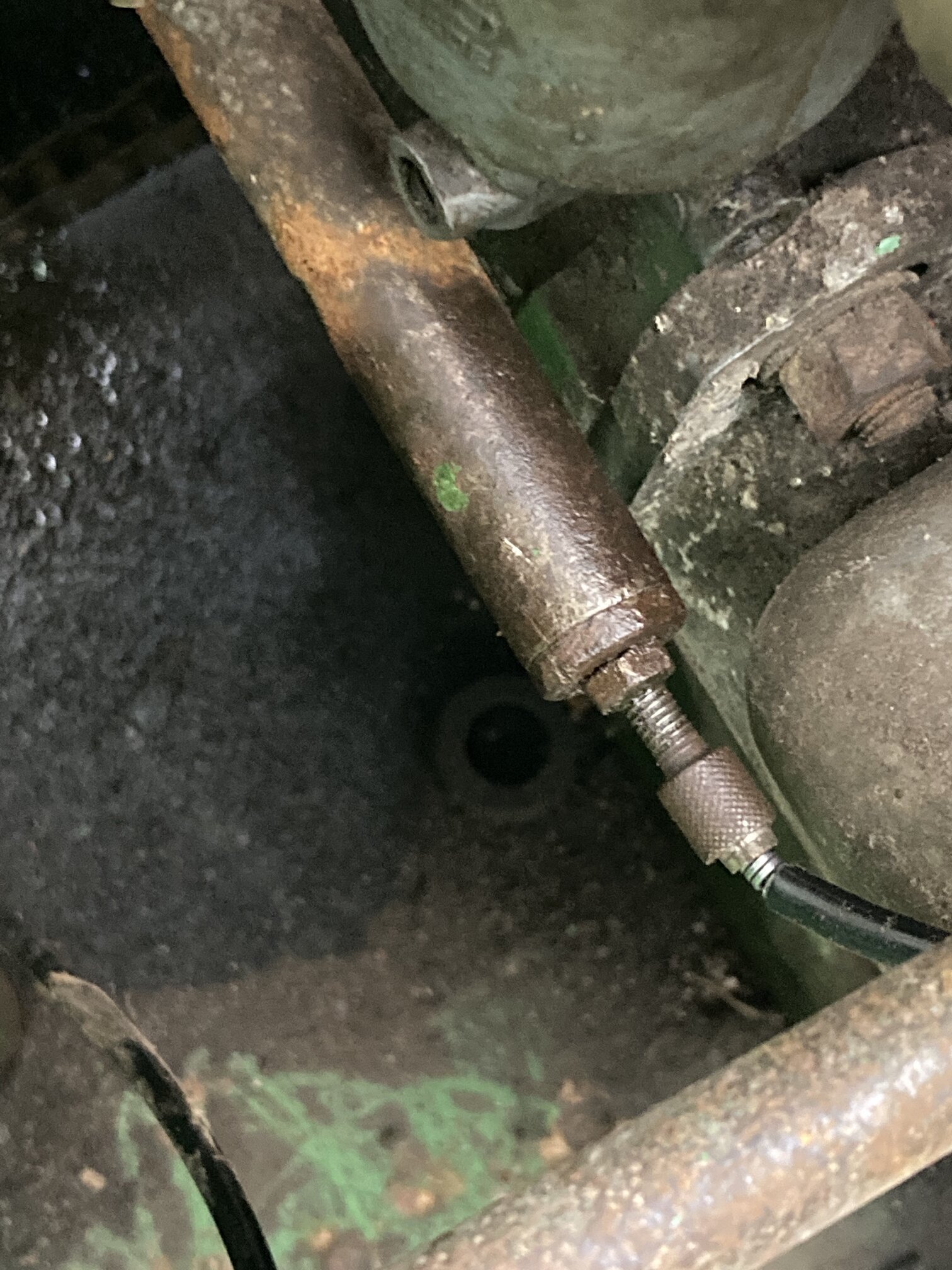

    #38128
    roatavator
    So here’s the set-up. The first photo shows the cable entering the barrel. The second photo shows where the barrel is in relation to the governor.
    On reflection I think that the thrust on the rod at the other end of the barrel is provided not so much by thrust from the cable, but by the spring located between the cable end of the barrel and the plate in contact with the rod. If that’s the case it would imply that the problem is basically that the spring has weakened. Does this sound reasonable?

    roatavator
    This may explain better. Here I’ve removed the barrel which screws into the green collar I’ve indicated. At the other end of the collar you can see the end of the governor lever the rod acts on.
    #38135
    roatavator
    And here’s the barrel with the rod poking out with the big spring behind
    #38137
    roatavator
    Finally here’s the view ins the barrel, the end of the throttle cable is visible. Behind the circular washer is a second spring. I reckon it’s this spring which provides the thrust on to the rod and this has weakened so there’s insufficient force to move the governor lever.

    roatavator
    Could be Andy but I’ve tried increasing the governor spring tension (you can change the position it’s secured to the air cleaner housing) but then can’t get enough push from the cable. I figure if the spring pushing on the end of cable were stronger it would then be possible to adjust the governor spring to suit. I’m guessing with the too weak cable spring friction is coming into play.
