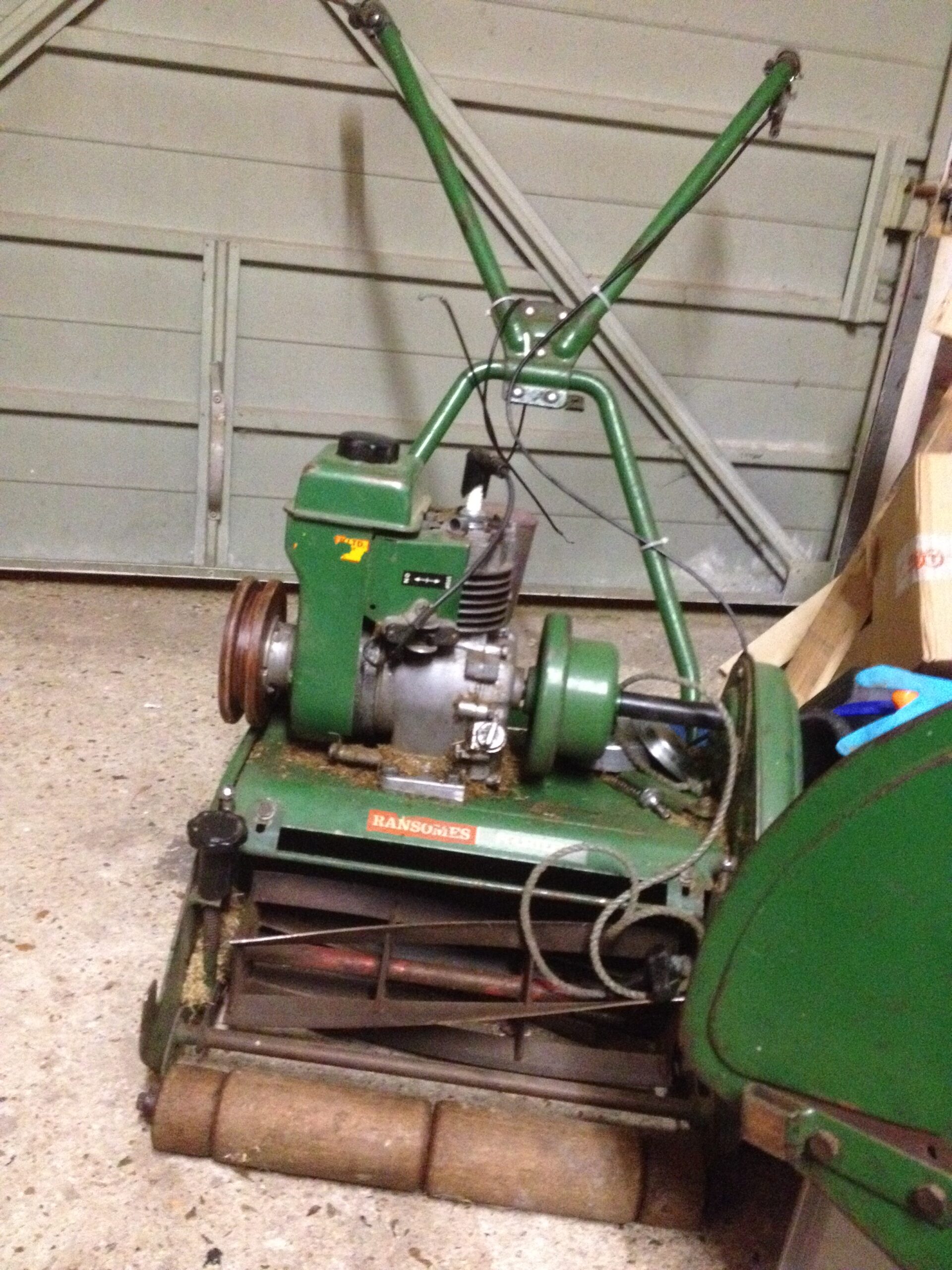

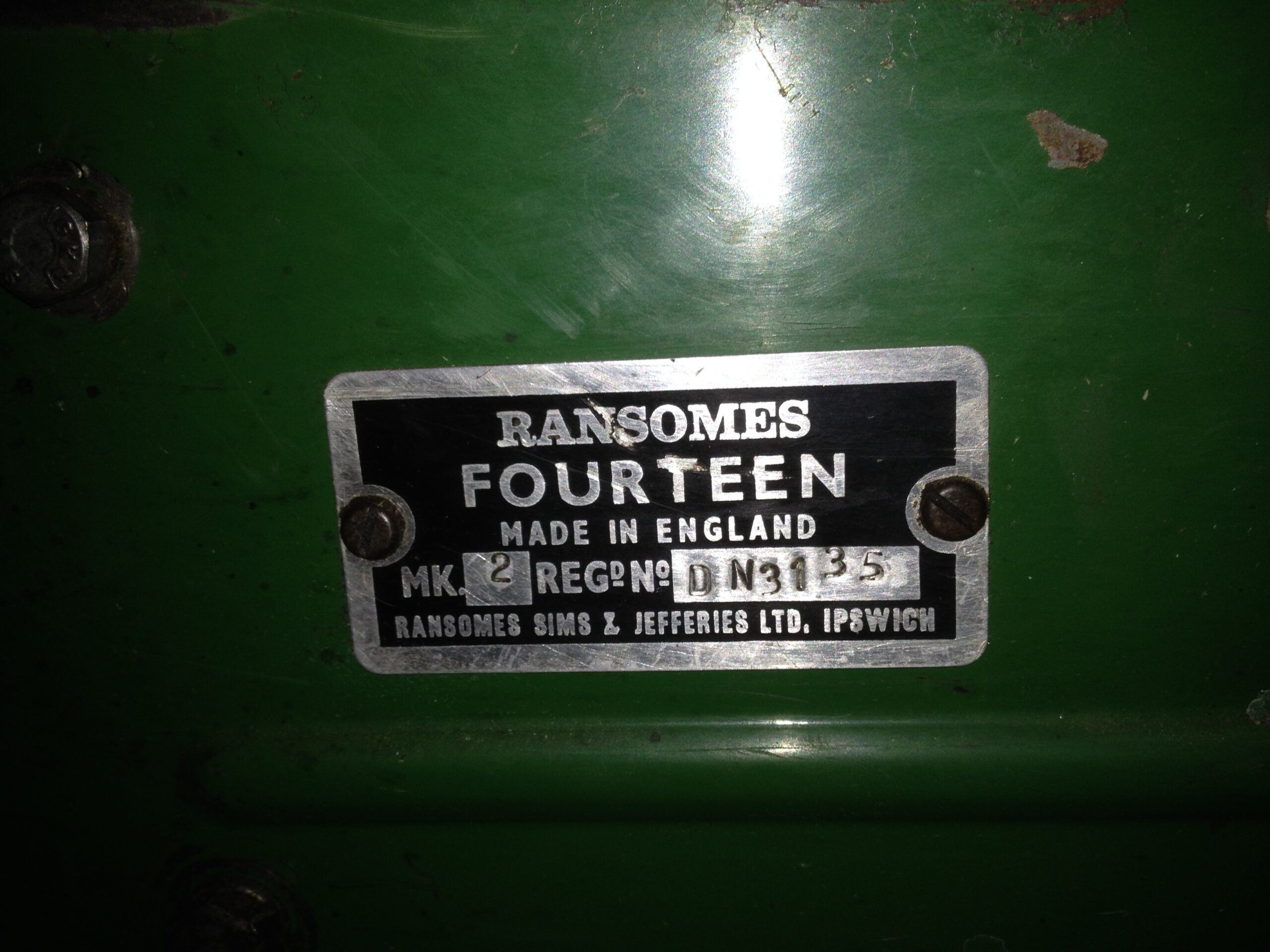

roatavatorParticipantWell Roatavator Jr has caught the bug. He’s acquired one of these, and would be grateful for any info on date etc. Does anyone have a manual we could use?
Not running yet, but won’t be long if I know him. He better not take too long, he needs it to put to work and his back garden is turning nto a jungle!

vhgmcbuddyMemberIt runs! And better than that, it cuts grass…. And smokes! I still would like more info on it if anyone can help? I had a look at the old lawnmower club website and as far as I can see you have to be a member to use the forum, I know it’s a little cheeky but, I don’t suppose anyone is a member on here are they?

vhgmcbuddyMemberThanks for looking, I don’t suppose anyone has any information on the villiers engine fitted to this? It looks like I could do with some rebuild parts if I can find them to stop it smoking

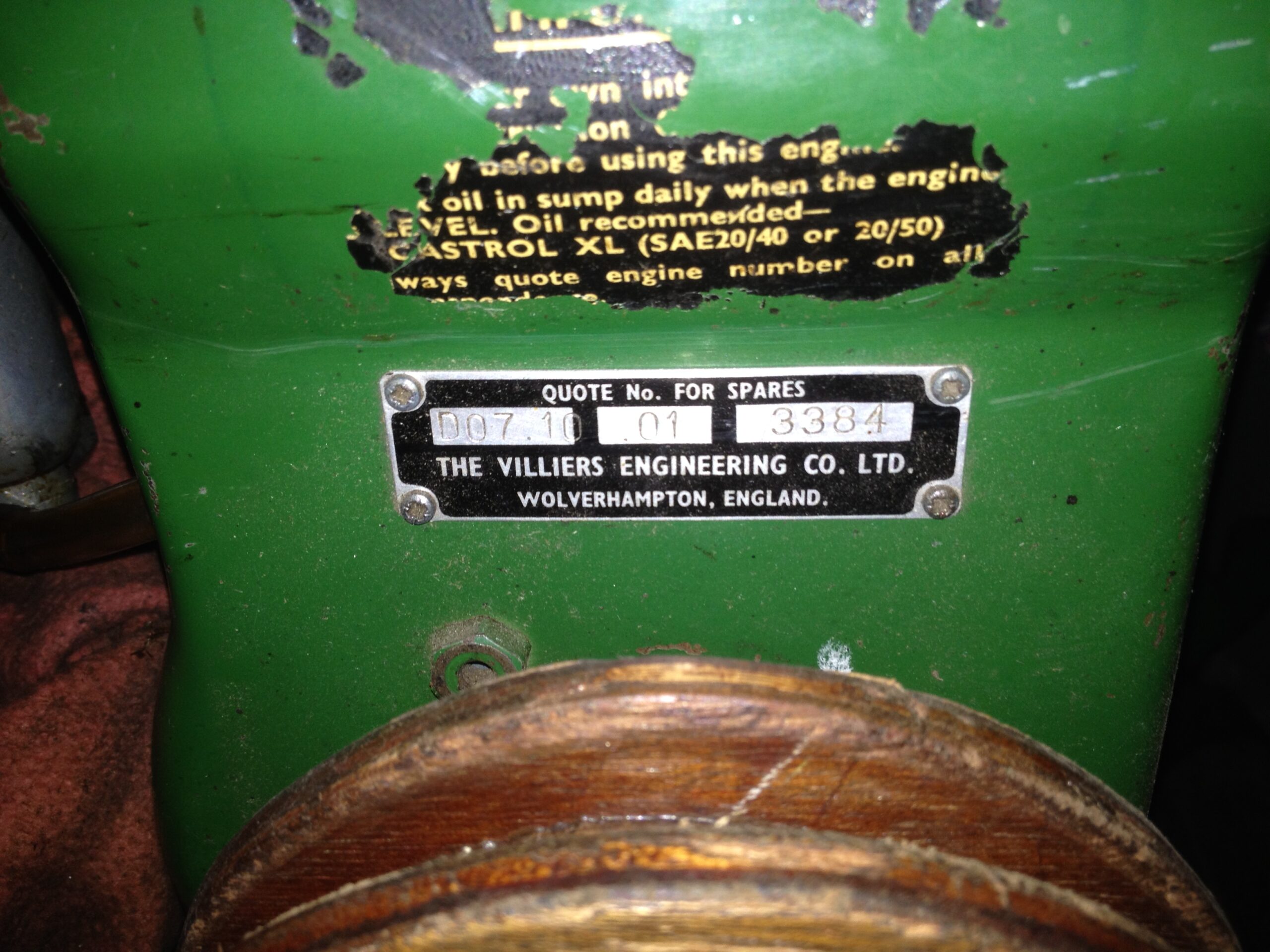

vhgmcbuddyMemberThat is a massive help, thank you for that Angus. I checked the oil this morning and it does seem very thin (and clean) so I’m going to change it at somepoint soon with the 20/50 it should have and see if the smoking improves….

wristpinParticipantI’d go for a straight 30 or even 40. Multi grades were not around when that engine was made. Quite probably ring and or valve guide wear but a clean of the crankcase/valve chest breather may help and is free!

vhgmcbuddyMemberMarch 30, 2014 at 1:55 pm #7037
wristpinParticipantCan’t argue with that-always assuming that the sticker is original!
Personally I would still go for SAE30 in a worn engine of that age.
The starter pulley looks as though it is home made – is it made from wood? We used to see a few 14s and 16s in the late 70s and early 80s and I remember that the recoil starters seemed to be a bit fragile but maybe only because the engines were worn and the starters were taking a pasting!March 30, 2014 at 2:17 pm #7038
