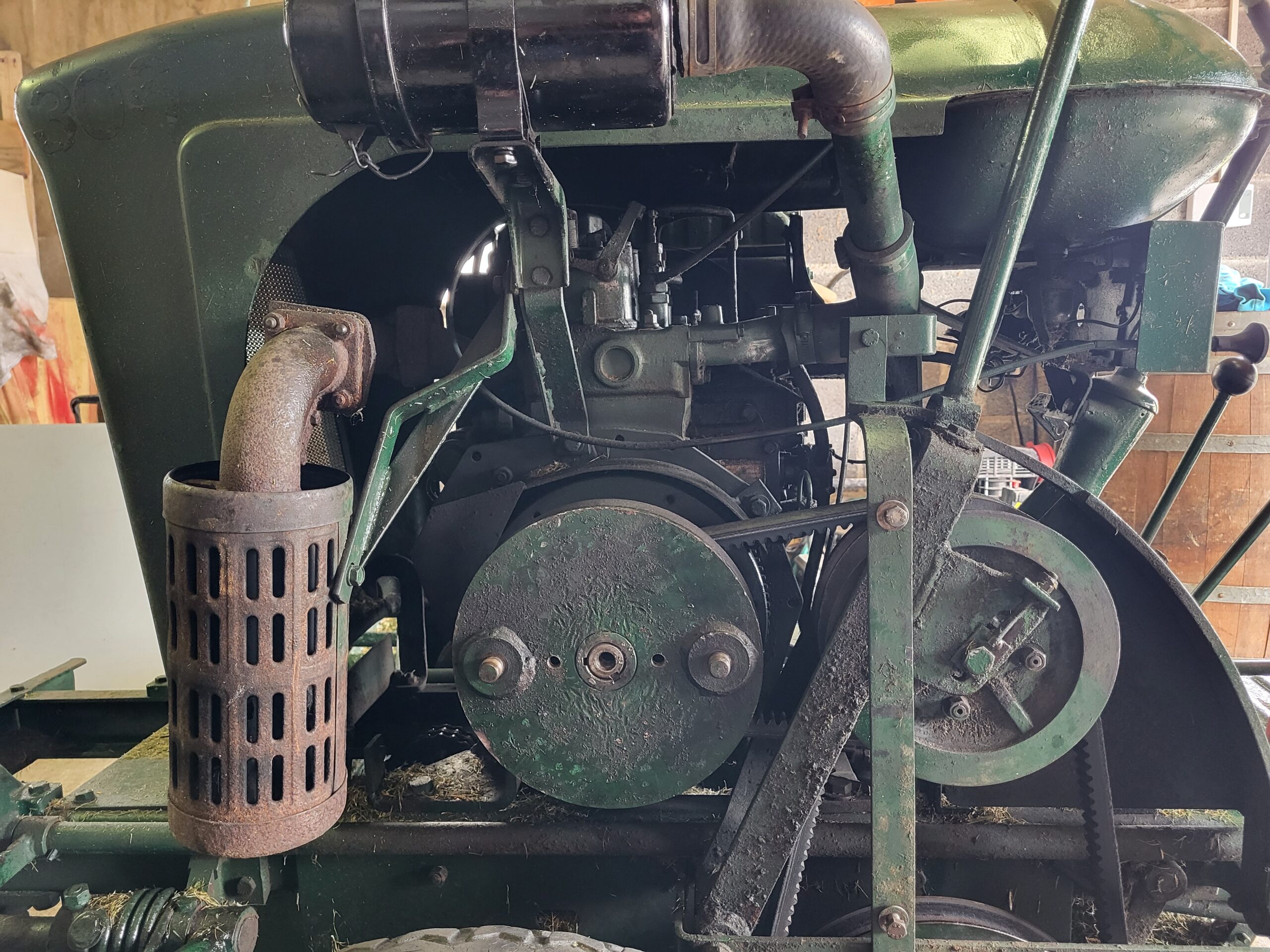

    I have a Ransomes Motor Triple Mk4, I’ve had it about 3 years and I really enjoy using it and working on it. I am no mechanic but so far I have found it reasonably easy to work on.
    A problem started this week when I was cutting the lawn. For no apparent reason the clutch would not disengage when on idle. No familiar “ding ding ding” sound and the cylinders would not stop rotating as would normally happen. I had to pull it out of gear to stop.
    I am hoping that it might be a broken spring or two in the clutch which is stopping the clutch from disengaging however my problem is I can’t get the clutch plate off.
    I have taken off the 2 stud nuts and the central bolt and I assumed the plate would slide off with a bit of encouragement. I connected a puller to the plate which is what I assume the 2 threaded holes are for and pulled against the center where the bolt was, but it didn’t budge. I have spent a few hours at it now and I just can’t figure it out.
    The attached photo shows how it is now.
    I would appreciate any information on how to get the plate off.
    The grass needs to be cut again and it’s just not as much fun on the 2 year old Honda!

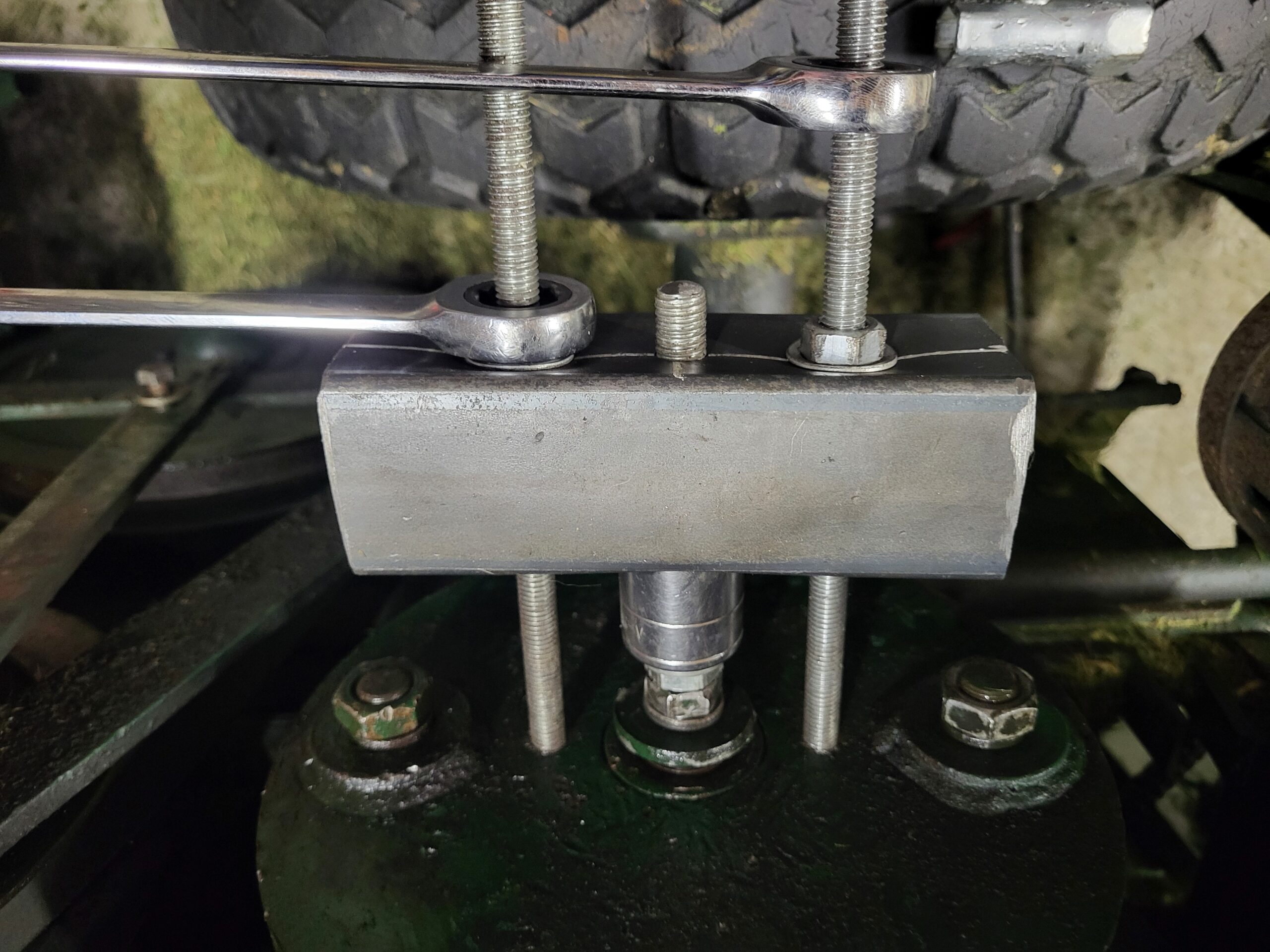

    Apart from removing the two stud nuts, I think I was heading in the right direction but just to be sure, would you mind having a look at the attached photo and let me know if this is the set up you were describing.
    I refitted the 2 stud nuts, attached the puller and started to wind it on using the partially threaded central bolt to push against. The socket is being used as a spacer to avoid the studs.
    The 50mm box section puller is starting to bend under pressure but the clutch has not moved. I will fit another socket or similar in to the box section for additional strength.
    I think I’m almost there and if the puller set up is correct I’ll keep going and hopefully it will let go.
    #39514
    A slightly different way of doing the same job but it should work. You are definitely on the right track; if it still doesn’t move you may want to give the central bolt a smack or two with a copper mallet to try to get it started, but it’s important that you draw the plate off evenly otherwise it will bind on the crankshaft.
    If it’s still tight and refusing to move, have you tried knocking it the other way (i.e. towards the engine)? If it’s rusted on that might just do the job.

    The only thing I could add to Angus’s suggestions are to make a more rigid bar so that you can get more pressure on the faceplate. PlusGas should get it moving but I’ve never had one that has been this stubborn, they normally pull off quite easily if you give it a straight pull.

    smithyb
    Thanks for the encouragement, I finally got it off but it fought me right to the end.
    I got another socket snug inside the box section so that made the puller a lot stronger.
    To finally get it moving I had to put a flat head screwdriver at 12, 3, 6 & 9 O’Clock to separate the plate slightly. Then thread the central bolt back in and smack it a good 10 times. It moved a few mm from the hammering. After that, screwdrivers out and puller reattached and it started to creep off.
    The shaft has a small bit of corrosion but nothing that should have made it such a struggle. It will get a good clean and grease before going back on.

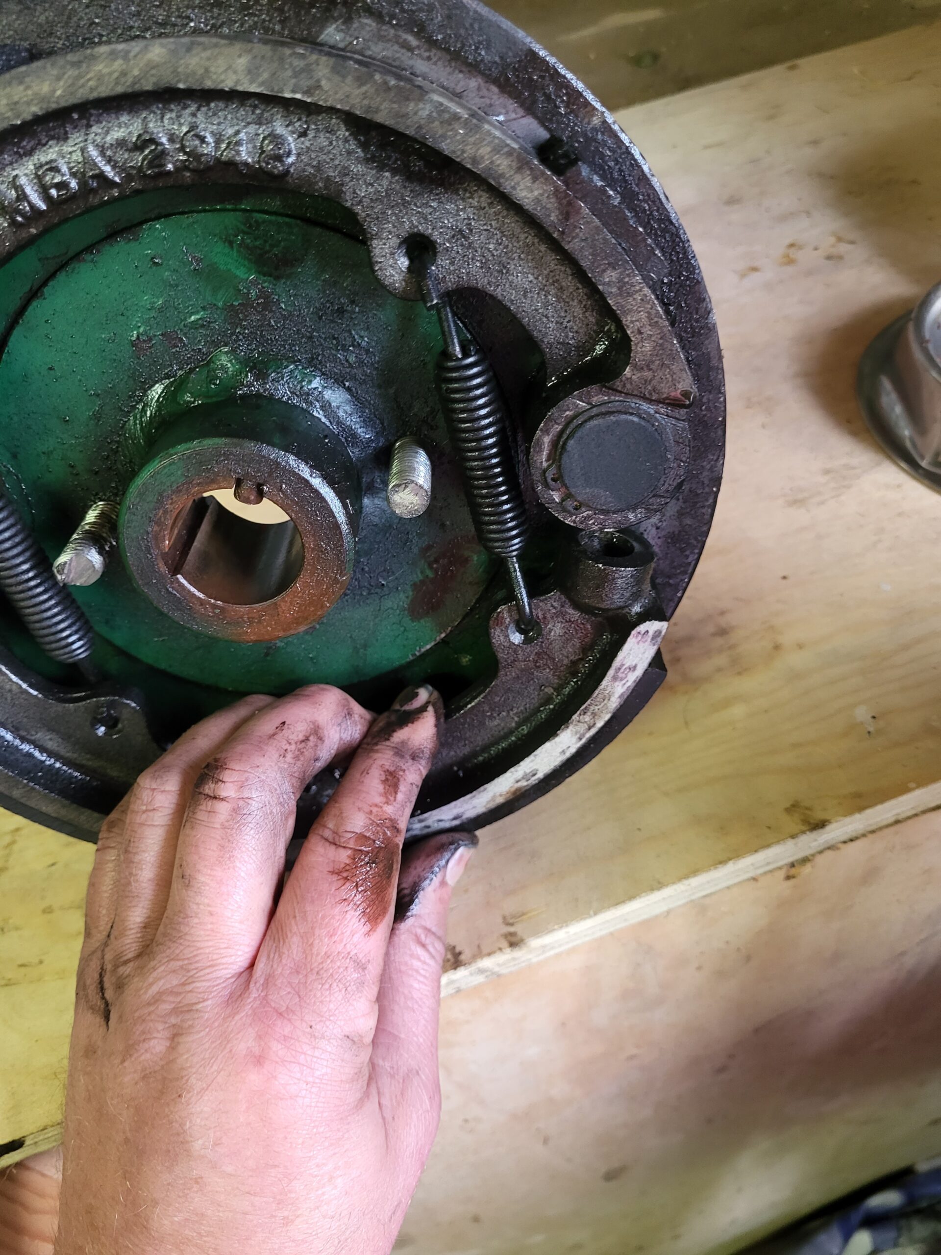

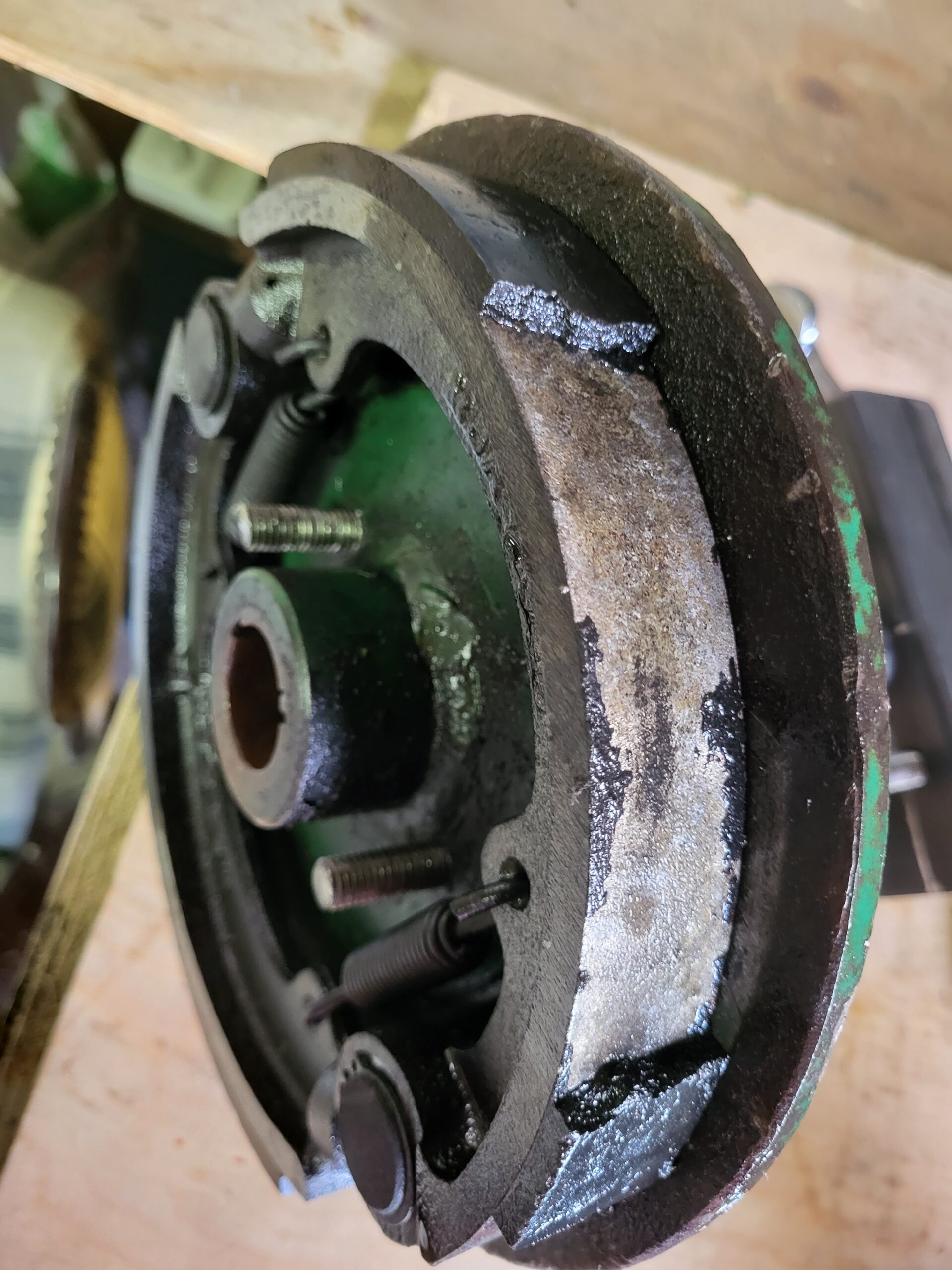

    I can see two problems with the clutch. The right hand spring is very loose and both springs will need to be replaced. Also, the lining (if that’s what it’s called) has worn/corroded/broken.
    I’m inclined to think the spring is what was causing the problem and not the lining. There were no broken bits of lining inside so I don’t think it’s something that has happened recently,
    Any thoughts would be appreciated.

    When I need new linings on the Trusty clutch shoes I use our local Truckstop branch- they send them away and get them re-lined with new material, but beware! If your shoes have rubber buffers on the floating end or rubber bushes on the fixed end they need to be removed before sending them off, otherwise they will come back melted. I did it once with some Trusty shoes and I think they must put them in an oven to cure the adhesive that the linings are attached with because they were very burnt and unusable when they came back- I had to make some new ones.
    Definitely replace both springs together as well and you will notice quite a difference straightaway. Don’t be tempted to keep using the triple- our council operators used to keep going with broken springs and very soon afterwards the gear selector ring for forward and reverse gear used to shed it’s teeth inside the gearbox. The fastest I did that job was eight hours and I had all of the lifting gear, so be warned!

    That’s progress. As Trusty has suggested, having the shoes relined is the way to go. Back in the day we used to get the shoes from all our commercial vehicle units and trailers relined and it was a 24 hour service . Not familiar with your side of the water but there’s plenty of heavy transport, construction, forestry and wind farms etc, that must generate a need for a reclining service. Also, for those springs, there will be a Ransomes distributor, maybe one north and one south. Try them first.
