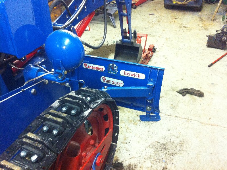

ParticipantThat looks a useful machine Chris what era is that from are they German?
Crank has taught me a lesson, I checked it for play when I had the barrel off and decide to leave well alone and not disturb the journal. Next time it will be strip and check regardless. Concerned that the crank may be too far gone for a grind but the amazing Neil Jarrett has found some -60 shells in Malta of all places so waiting for them to arrive. I am also looking for a replacement crank in case.December 7, 2014 at 9:19 pm #10992

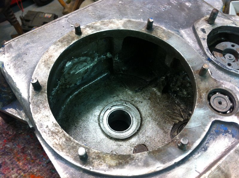

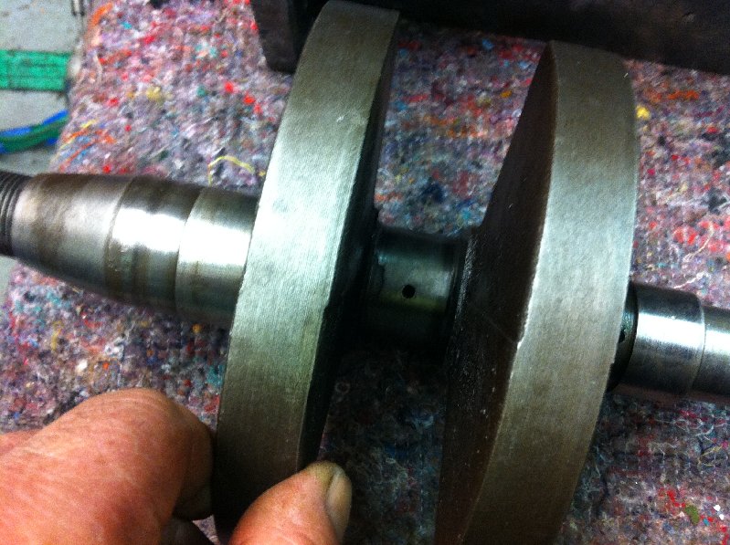

I attach some photos showing the extent of welding repair to the crankcase where it has obviously gone bang in the past.Amazing that someone should go to such trouble. The crank has been built up with stellite weld which during the regrind started to delaminate from the original, fortunately I now have another crank which has been ground to minus 30 and is ready to fit.December 19, 2014 at 2:46 pm #11124

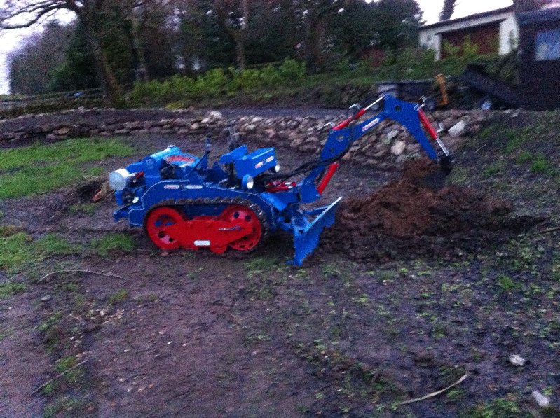

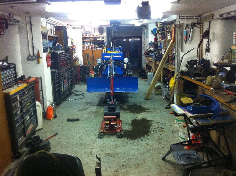

I have now completed the engine rebuild with a new crank which was ground to suit some -30 thou shells I bought from Neil. engine now has 40psi oil pressure at tick over hot.

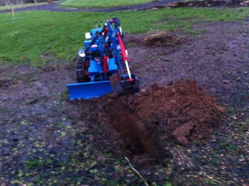

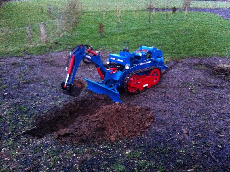

I took the digger out for its first run today along the road delivering Christmas cards to the neighbours! Back to the garden for a test dig, I am amazed it is very powerful and operates just like my Volvo mini digger in that I can crowd and lift at the same time ,which I was not expecting. I dug a hole about 4ft deep into heavy cumbrian clay with big stones and it coped admirably, on one big stone it pulled the digger forward despite the dozer blade anchor and the handbrakes on. The dozer works well, I have yet to test it in angle doze mode but it is the same as the standard Ramdozer so it should be ok.My next job is to make some oak or elm 12″ swamp pads for it.December 21, 2014 at 6:17 pm #11141

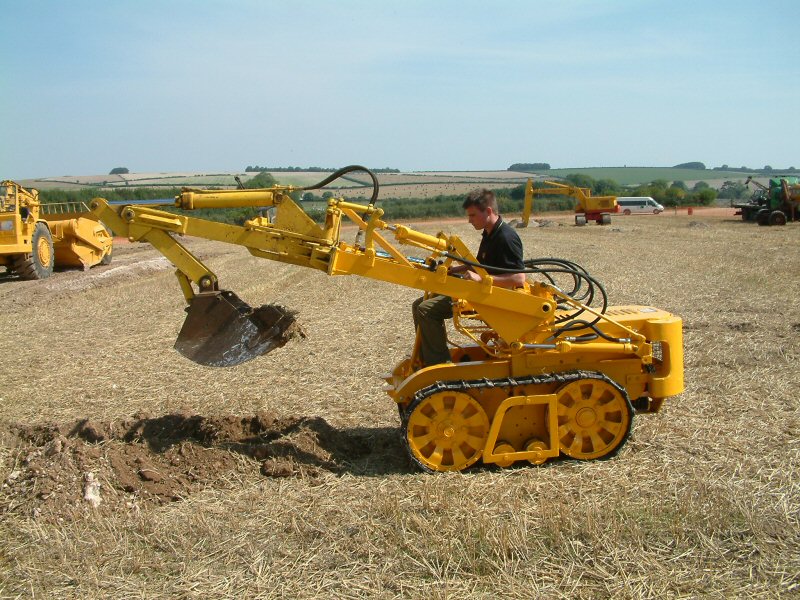

ParticipantAnother Loader for the MG 40 was the WGM Demon Loader which had Muck fork,Bulldozer Blade ,Bucket,Root crop Bucket,Fork lift,Working Platform ,lifting jib,snow plough,and buckrake attachments
Developed by a Shropshire Poultry Farmer for work in confined spaces it was also available for Unihorse,Bolens,Trusty Steed,Wheelhorse,Club Cadet,Trojan,Markham Colt,and Holder A12
Attached are a couple of illustrationsregards Joe Paget

ParticipantFrom the illustrations I have compared to your photograph it looks like a Demon.
A report from the Farmers Weekly describes that a Dowty hydraulic pump is driven by V belts from the pto with a 2.5 gallon hydraulic oil tank, cost for the MG was £69
All sorts of extra buckets/fittings were available plus two way rams etc
The Dandy scoop was also available for those that did not require lifting height
With all that weight up front the WGM transport box would have been handy with removable tailboard but also could be used as counterweight in conjunction with Demon loader
Mr W G Minshall a poultry farmer who developed the loader etc seemed to operate also as Manufacturer :- W.G.Minshall, Engineers, Greenway, Chester Road, Hinstock, Nr Market Drayton, Shropshire
