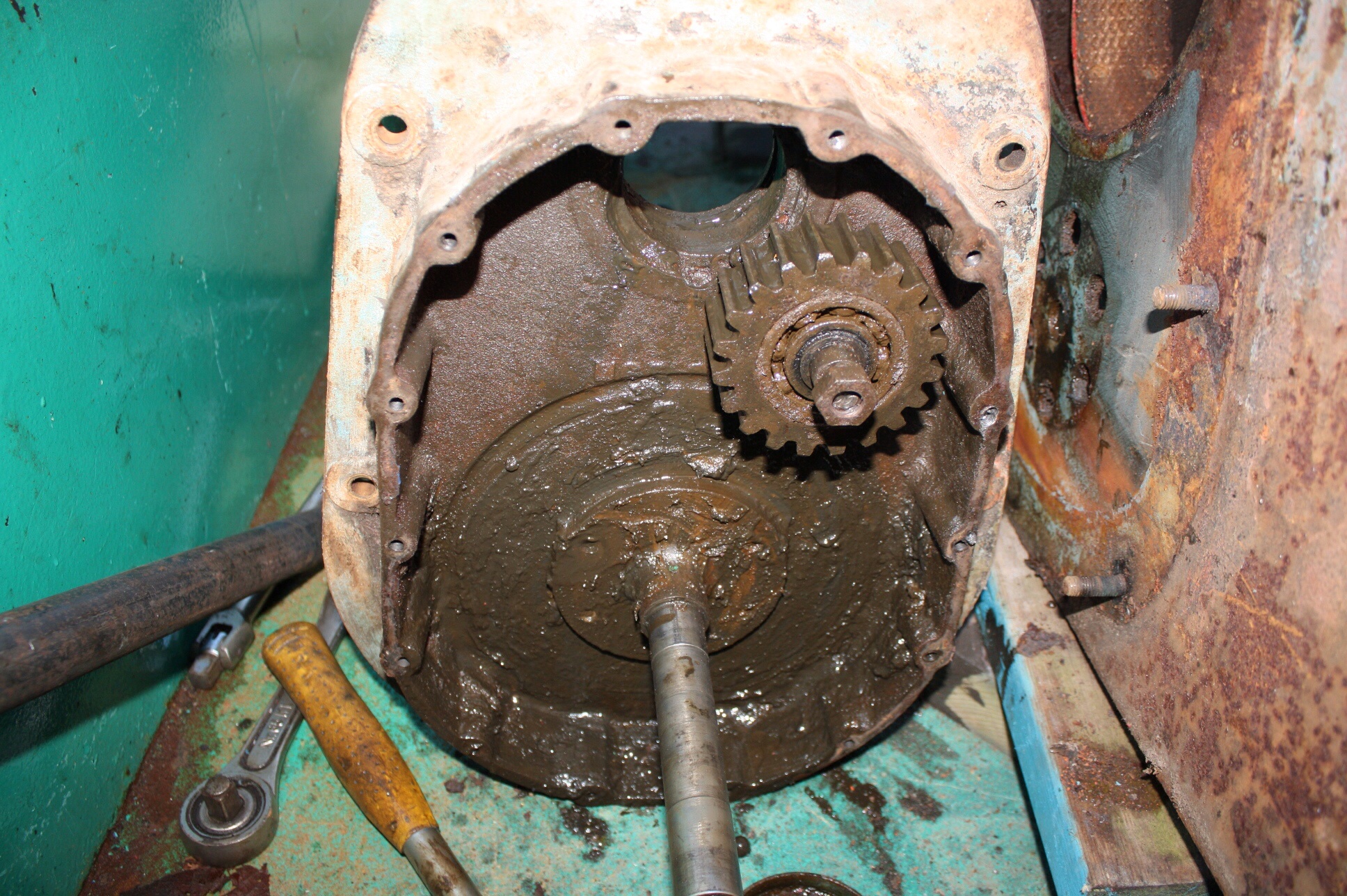

vhgmcbuddyMemberfrom dicky I am restoring a mg5 no idea of age as plate has been damaged where mumber should be.I need to check the centefugal clutch first as this was not allowing gear change on engine tick over could anyone help please
November 17, 2014 at 6:02 pm #10739
vhgmcbuddyMemberDicky,
Either your engine is running far to fast on “tick over” or the clutch drum is rusty and/or clutch shoes are stuck but that’s unlikely
November 17, 2014 at 6:37 pm #10742
ransomes256ParticipantDicky,
As identified by Rhys it is probably the speed being to fast but may also be weak clutch return springs or excessive wear in the clutch shoe pivots.
