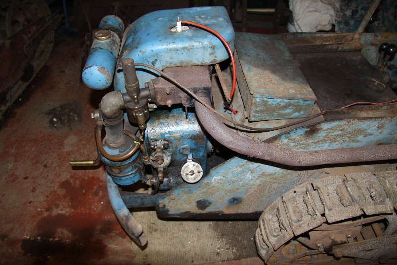

One question I have is regarding the attachment of the exhaust to the manifold. Can the design really be that bad? Can someone please post a picture of their exhast to manifold fixing for comparison. As I’d like to see if I can sort mine out this weekend.
Hopefully more pictures following the Big Event.
James
December 15, 2015 at 6:09 am #15517
ransomes256ParticipantJames,
The exhaust fitting is a simple design but due to burning can be a poor fit in the barrel. As the engine is hard mounted in the chassis there is no relative movement between the two so the clamp around the pipe to the manifold suffices plus add a little exhaust paste for a good seal.
Hopefully a photo attached of an original installation.

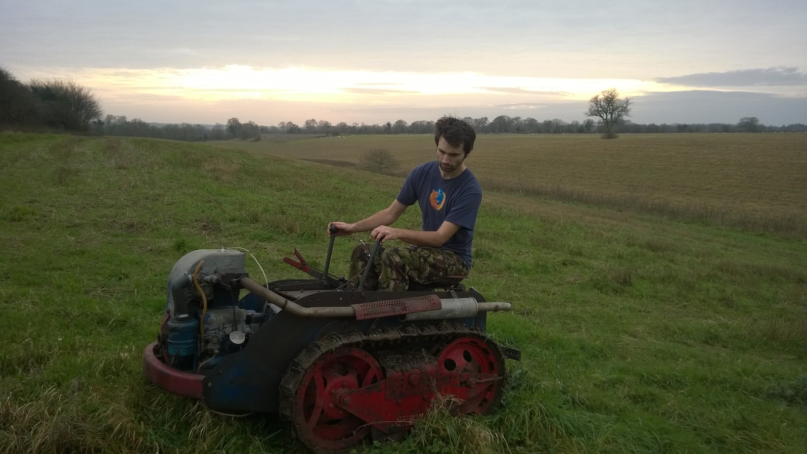

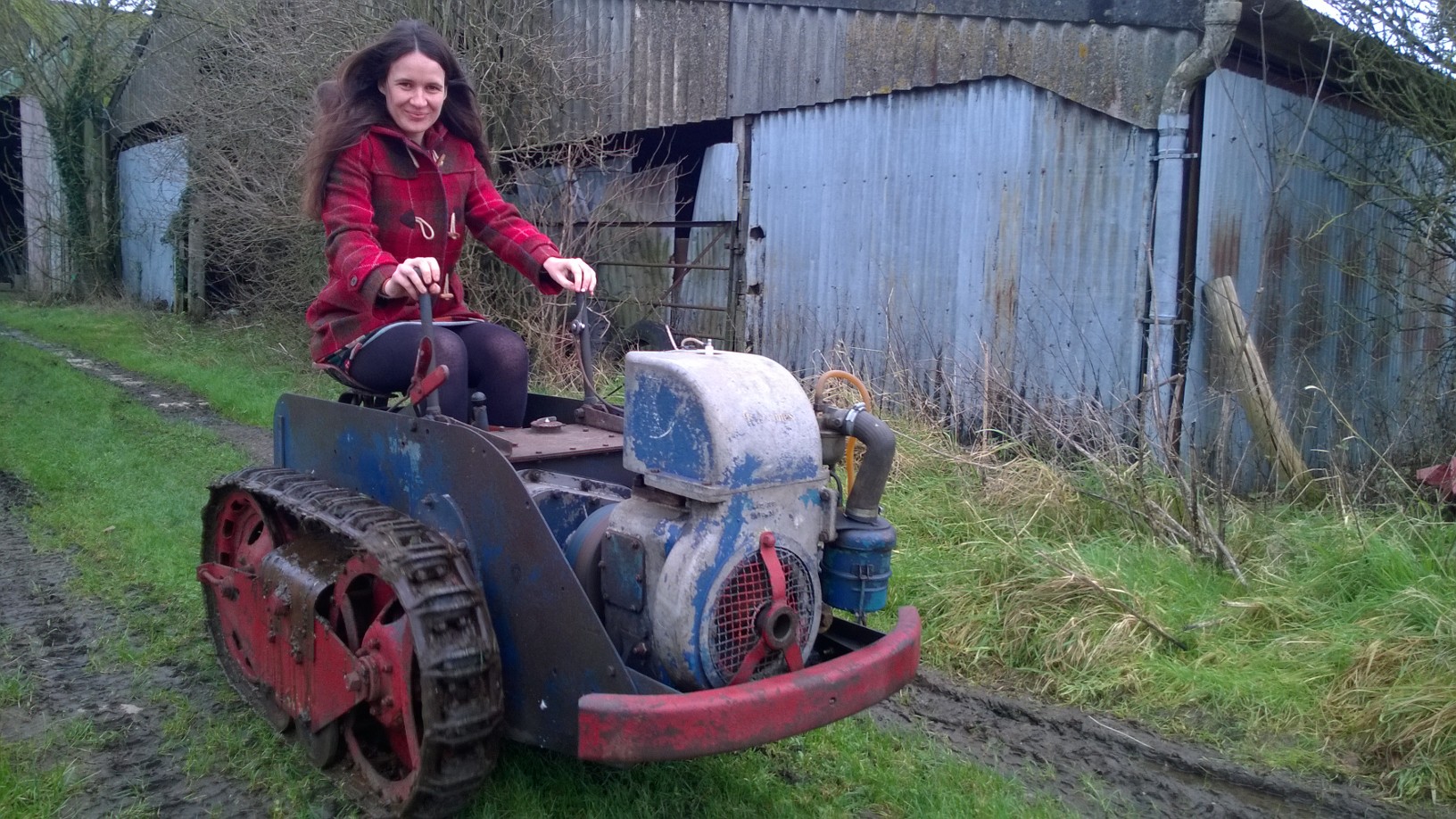

Here are a few pictures of it in action.
Regards
James
