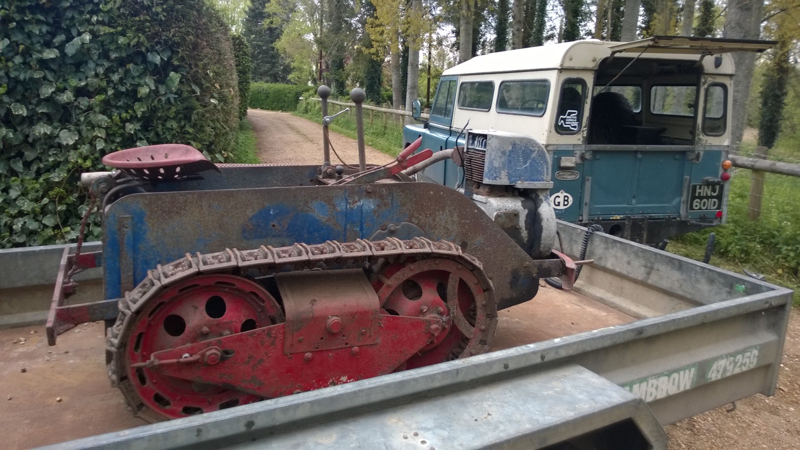

    Hi all,
    I must confess I am new to Ransomes Crawlers and have recently purchased an MG5. Something thta I’ve been keeping an eye out for 7 or 8 years now. It was only recently that one came up locally and at the right price. 🙂
    I have many questions regarding this beast, mostly around trying to see if I can get it running. I plan to purchase the parts manual online as I am certain it needs a new spark plug.
    A friend and I tried to get it to start after collecting it from the previous owner and we only mananged a few coughs and a small backfire. I’ve put fresh fuel in the tank, and confirmed we do have a spark, but it does appear to have non funcitioning fuel pump. So instead we filled the float chamber up with petrol to see if we could run it like so – no luck.
    So, back to basics it is. New spark plug and a check of the points gap and then further investigation of the carb and fuel pump.
    A few questions if I may.
    1) Where is the best place to get spares? I know I need a new pipe from the pump to the carb (the current one seems to have an inline non return valve – is this correct?)
    2) Does my manifold setup look correct to you? There was mention of TVO. Presume it is OK for petrol only?
    3) I am trying to date this machine. The serial number on the back reads: 7262. Can it be dated from this?
    I’ll try and add some pictures..

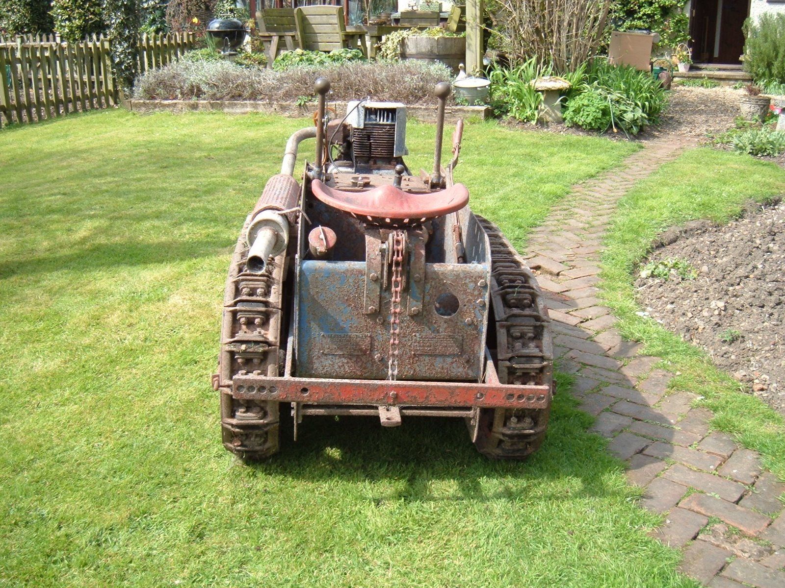

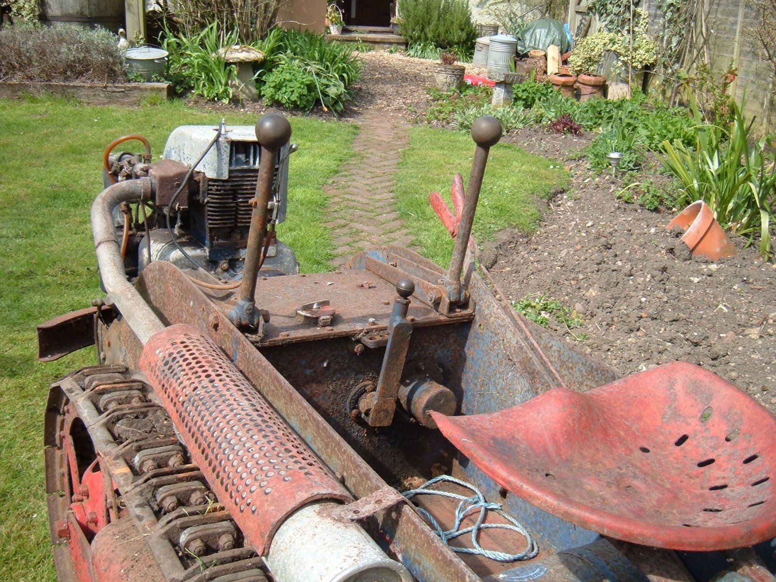

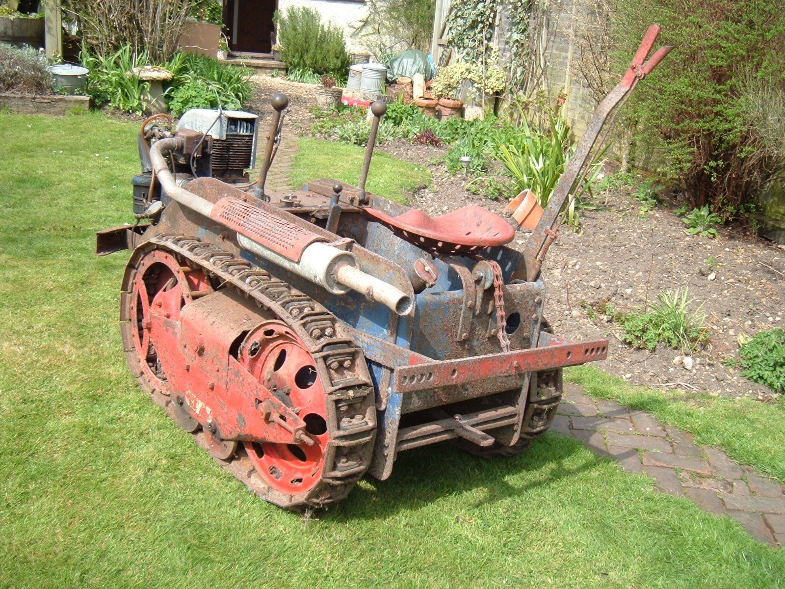

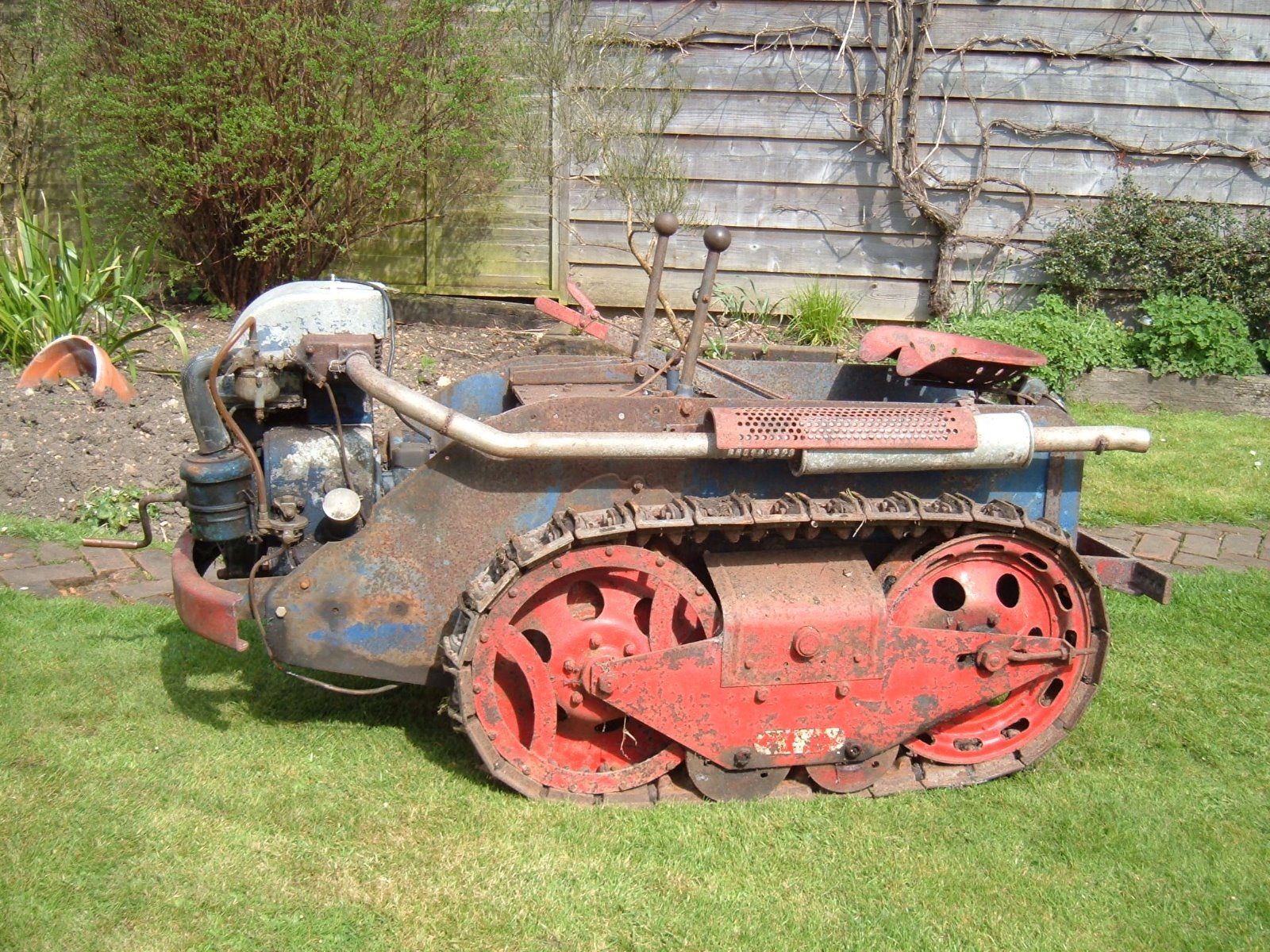

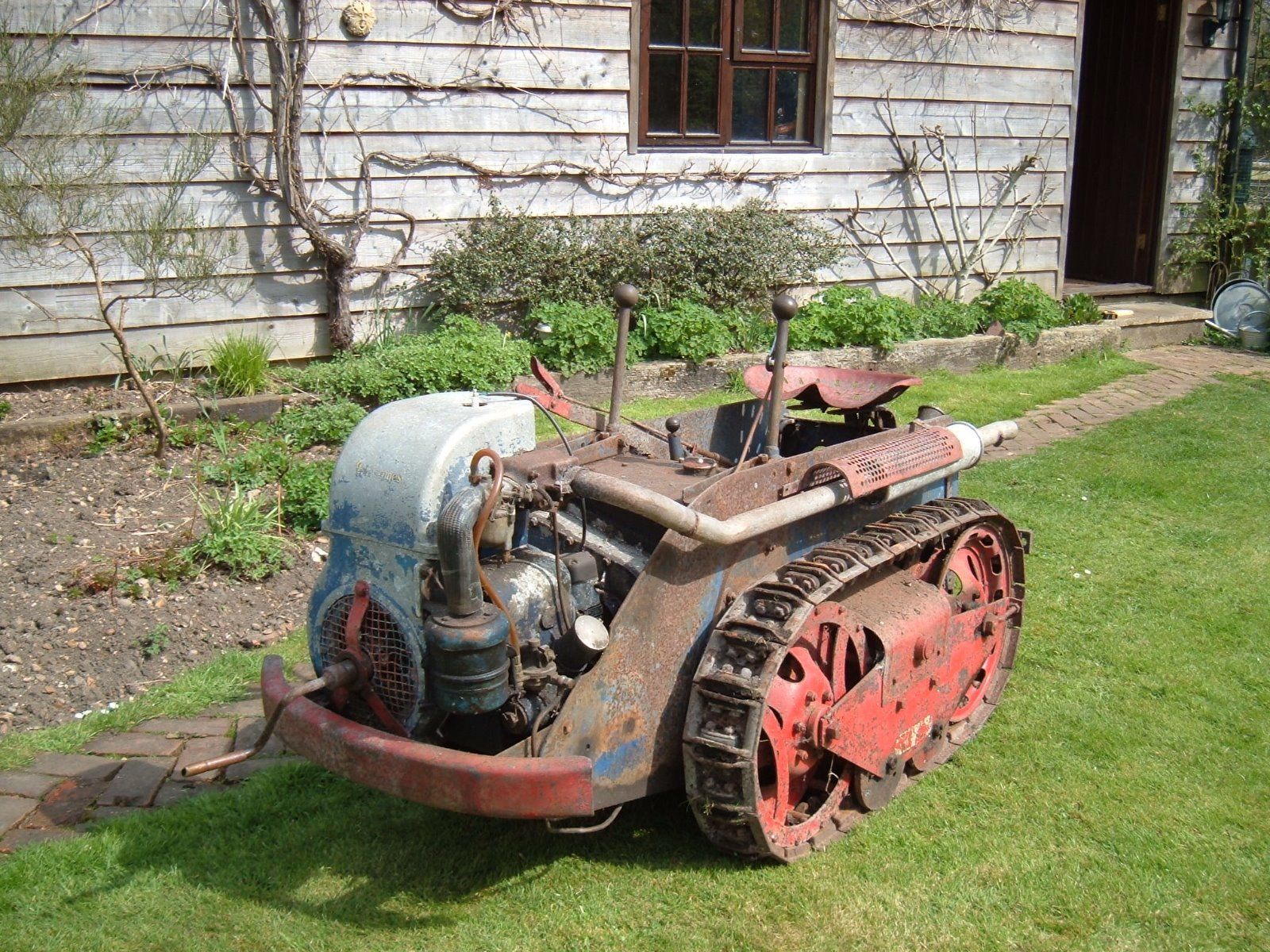

    #12916
    A few more pictures of collection.. and a picture showing the front cover off.

    ransomes256
    Congratulations on your purchase.
    I am recognised as the supplier of parts for the Ransomes crawlers and would initially make the following observations.
    The carburettor is not original for an MG5 but from a later MG6. Some consider this a better carburettor Amal 356/1.
    The engine appears original MG5 as the fuel pump has the low mount but the oil filler cap is a different design to the gearbox and petrol tank filler caps which suggests there has been a change at some point.
    Best to identify the engine by thread type. MG5 would be BSF and MG6 would be UNF.
    The engine is also fitted with a vapourising box which indicates it was designed to run on TVO but there is no sign of the second tank or change over pipework. The manifold may have been added when the carburettor was changed but the compression should be lower for TVO so head needs checking.
    Drop me an email and I will forward a list of available parts.
    Neil njarrett@btinternet.com
    #12921
    expeatfarmer
    7253 dates from 1952 . Neil is the man for spares. Looks as if the engine has been changed or at least the carb and manifolds these are from a later model. Not a problem though most machines have had parts changed over the years to keep them going. Good luck!
    #12922
    Hello,
    Welcome to Ransomes MG world. Thats a nice looking example of an MG5 made in 1952.
    Your model indeed has a TVO manifold fitted with an AMAL 356 carburettor which is unusual on an MG5 so perhaps not the original engine for the reasons Neil stated.
    Regarding you getting it started I would remove the carb bowl and then the jets and blow them out. Also remove the bung in the middle of the carb on the top, then removed the emulsion tube, clean and check for spliting. If you don’t have compresssed air use a WD40 aerosol with the straw attached and spray em out. Obtain a new spark plug. Strip and clean fuel pump – the non return valve is correct. You should also check valve clearances and perhap valve condition as you get deeper into it. Check outlet from fuel tank is not blocked with rust & debris.
    I would change the oil now before any starting attempt to avoid pumping the contaminated old oil around the galleries and bearings. Drain the oil overnight, replenish with new oil for example Morris Goldenfilm SAE 50 is what I use. When you get it started and run for an hour or so change it again.
    Best of luck with it. You’ll get lots of help and guidance on here.
