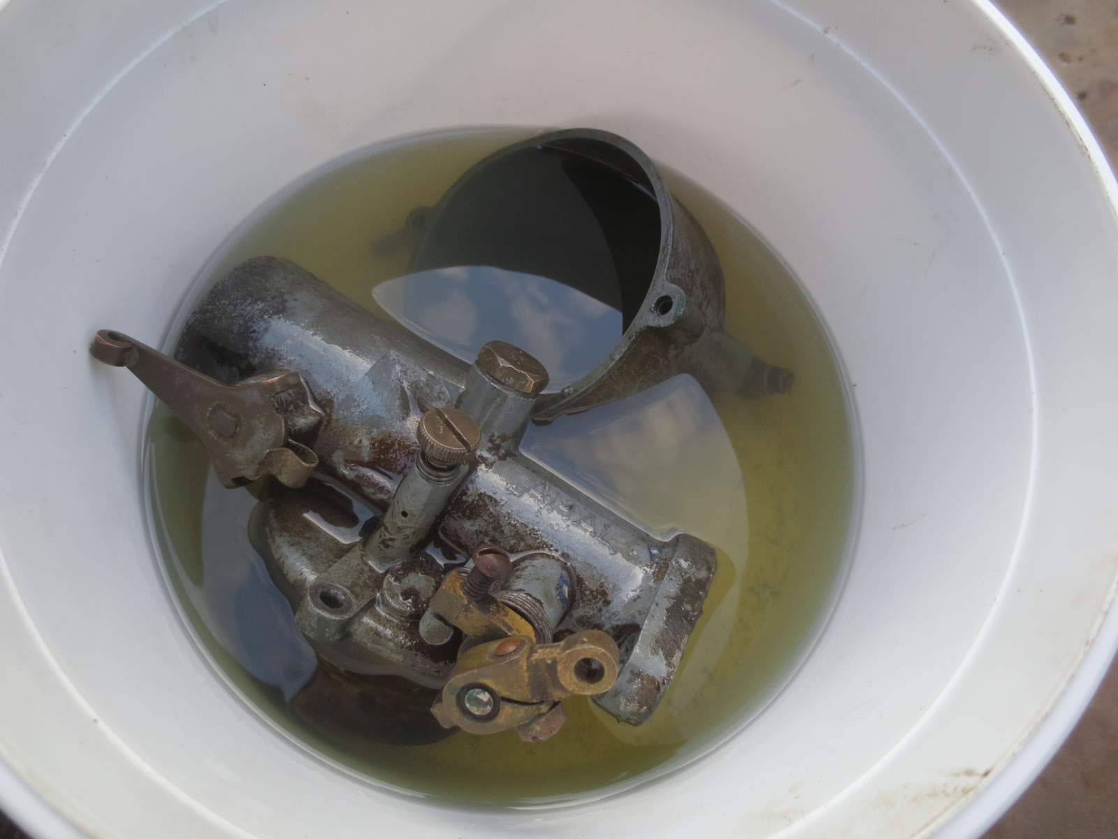

Just a quick post to say that after some help from Neil I finally managed to get the old girl running this weekend. Was a bit of a challenge. Major fuel system overhaul. First stop was to strip and clean the pump and fit a new diaphragm. Strangely this did not solve things. So, to test the pump I ran a pipe from a jerry can. No problem lifting fuel, so I checked the tank and fuel pipes. It turned out the fuel pipe was blocked and the tank was full of rust. I ended up removing the tank for cleaning and blowing the pipe through with an airline. Sorted!
I changed the oil as suggested and fitted a new plug. She fired up no problem and ran OK. Although the manifold is blowing a bit! My main problem is the carb (which I’ve also had to bits and soaked in fuel), mainly the float needle. It doesn’t seem to be cutting off the fuel. Hence the bowl is over filling and leaking. Should there be a gasket between the bowl and carb body??
Or can you buy new new float needles?

vhgmcbuddyMemberGreat. Ok I will order new needles and gaskets from Neil. I’ll need to check the float – actually floats! Good thinking. Yes it does vibrate A LOT!

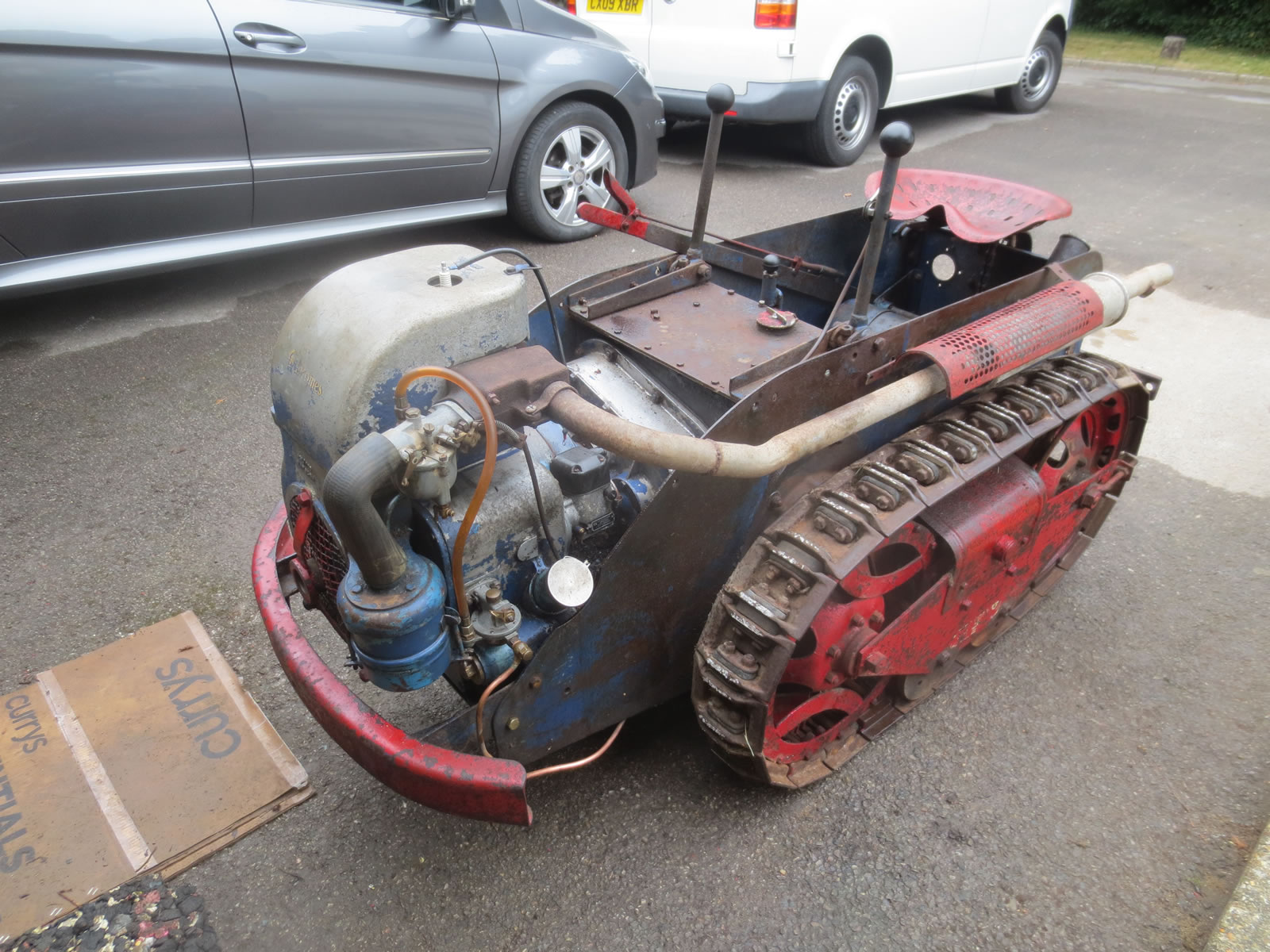

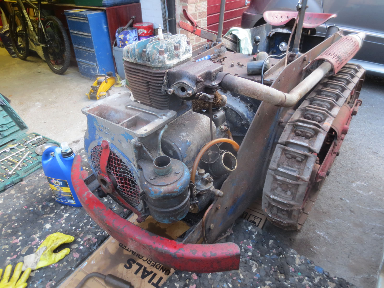

What are peoples views on this carb I have? Is it worth holding onto? I never intend to run with TVO, so can I swap out the manifold to get better performance from it? Is it really worth it?
A few pictures from the weekend.
Cheers

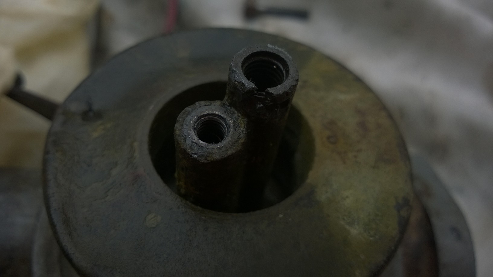

Back to the carb and I decided to completely remove and fit the new pilot jet. (I’d already fitted the new main jet on Friday).
I enclose a picture of the damage/wear that I have discovered around the pilot jet area. I have cleaned this off and applied some araldite in the hope of making good.
Removing the old pilot jet was quite tricky, and it was obviously in a bad/gummy state.
I am however a little confused why the there woule be a screw threading into the end of the pilot tube blocking it off? (Threaded into the damaged part)
Would this pilot jet prevent starting? Is this not the equivilent of the idle jet on a modern carb?

ransomes256ParticipantJames,
The jet is fed via one of a number of cross drillings in the carburettor body. These are blanked and may be blocked causing your starting issue.
