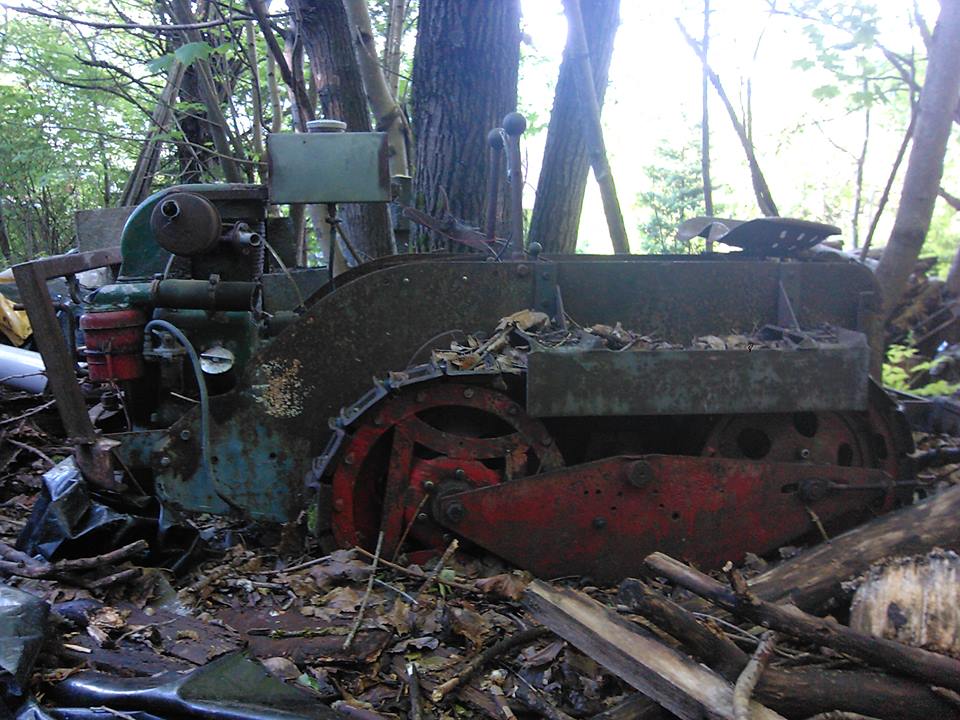

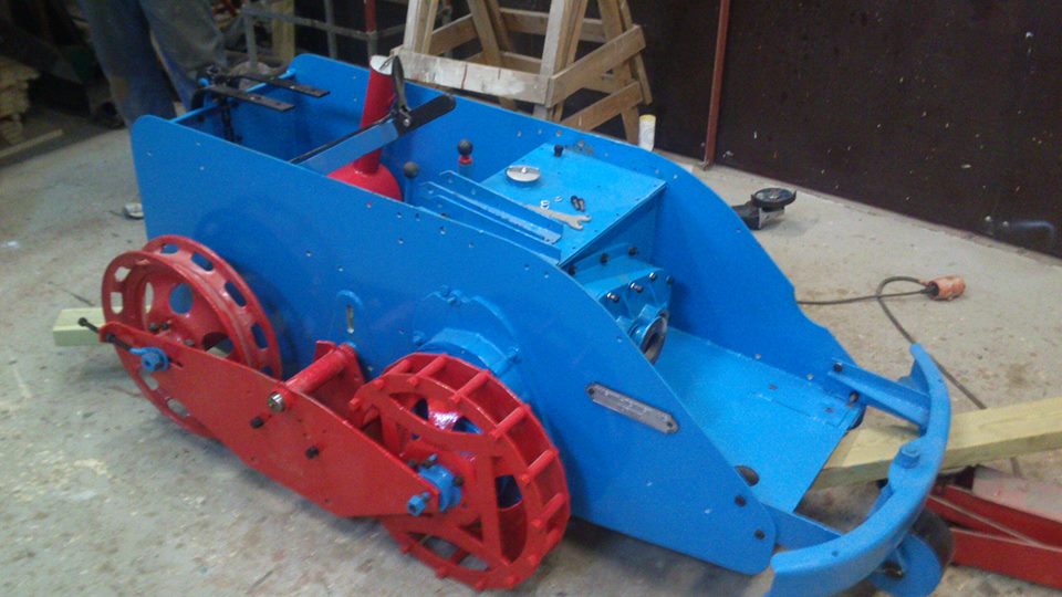

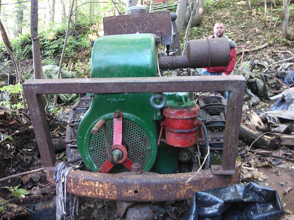

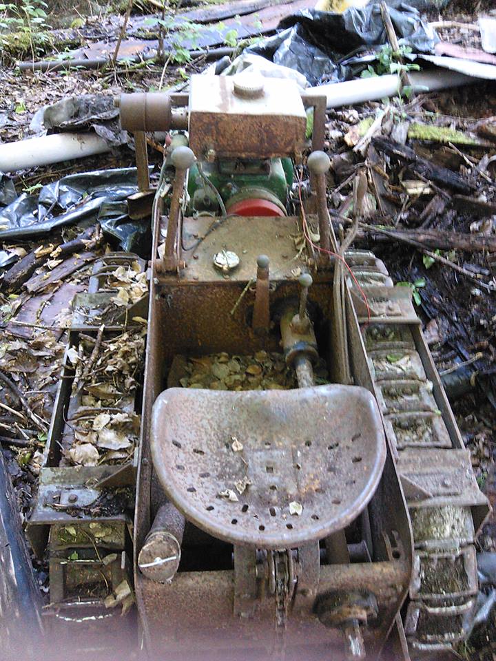

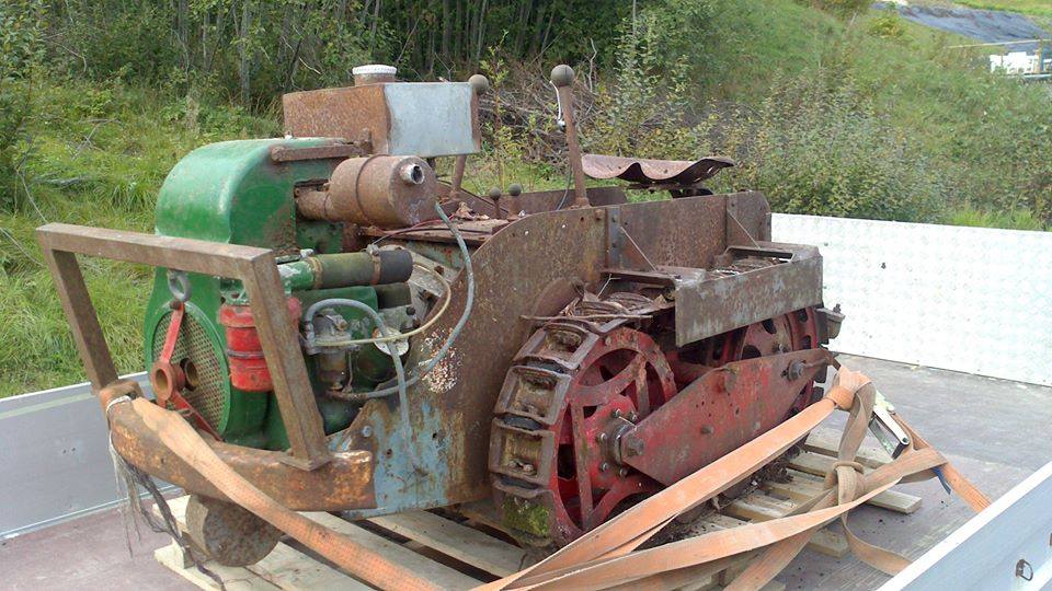

My name is Lars-Kristian and I am from Norway. I have a Ransomes MG5 under renovation. There are few of these in Norway. When I bought it a few years ago it was in very bad condition and had been out for over 30 years under a tin plate.

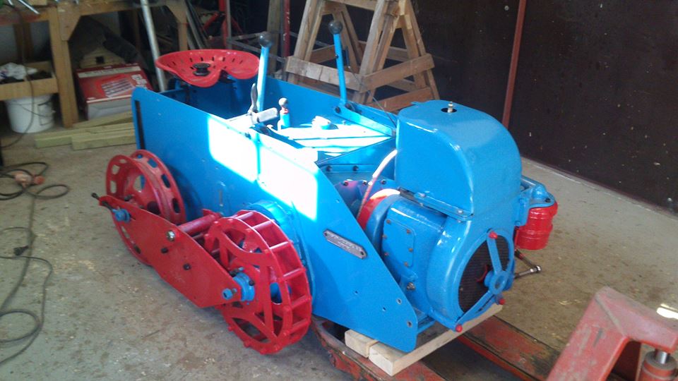

Now now I’m in the final stages of renovation and need some help from you.
When I bought the tractor was no carburetor on it, but now I’ve finally got hold of carburetor to it. But now my problem following:

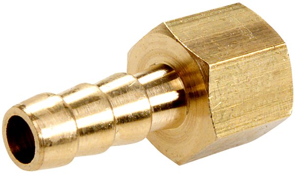

The two petrol pipes that go from the tank to fuel pump and from fuel pump to the carburettor is gone. I bought new rubber petrolpipe. But I need something so I can plug them into the tank and carburetor. I understand that all threads on MG5 is BSF, the BSF is impossible to obtain in Norway. Is there any place I could buy “air nipple” like the one I put the image of that I can use? Any other suggestions?May 31, 2015 at 2:23 pm #13240oddhatuk

ransomes256ParticipantLars,
Excellent work and looking good.
The pipe from the tank to the fuel pump was originally copper. The end at the tank would be direct fit to the in tank filter via an angled connector and the fuel pump end would have been fitted with a banjo connector soldered to the pipe.
The pipe from the pump to the carburettor would be flexible.
I can probably supply all the parts you require but would like a photograph of the pump and carburettor connections to be certain.

vhgmcbuddyMemberThanks for all the feedback. Tractor is not at my house for the time, but I’ll take some pictures of the carburetor and fuel pump next time I see it, I’ll send an email to you Neil. Regarding the serial number I’ll check the next time I see the Ransomes too.
Jonathan, regarding the nosewheel I not sure about the story behind, but it maybe mounted in Norway since it is very steep in many places. I can also take pictures of the tractor when it is finished for you.
