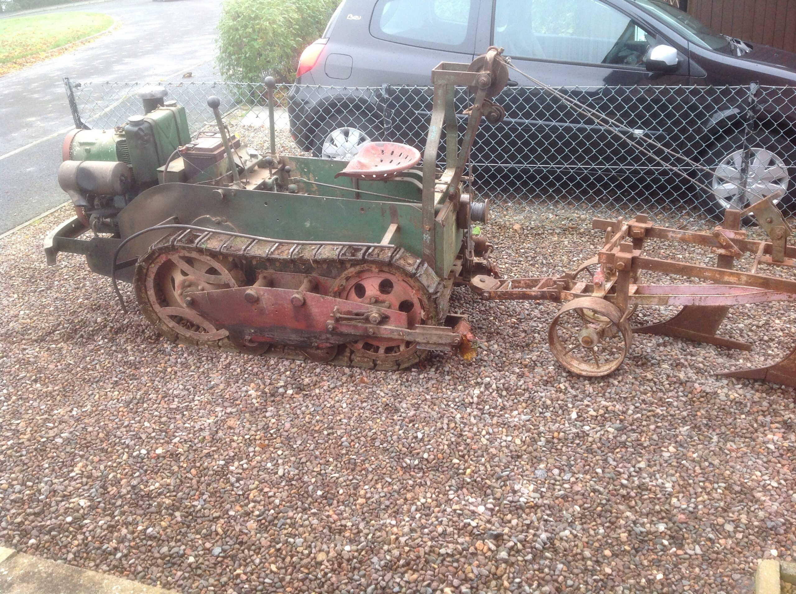

    A new toy arrived this morning from the south of France, it is a ransomes mg40 Sachs diesel.
    Looking to find out a bit more about them and who else has one.

    Very nice MG40, I’ve seen some photos of that type of implement lift posted on some French websites.

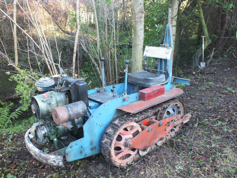

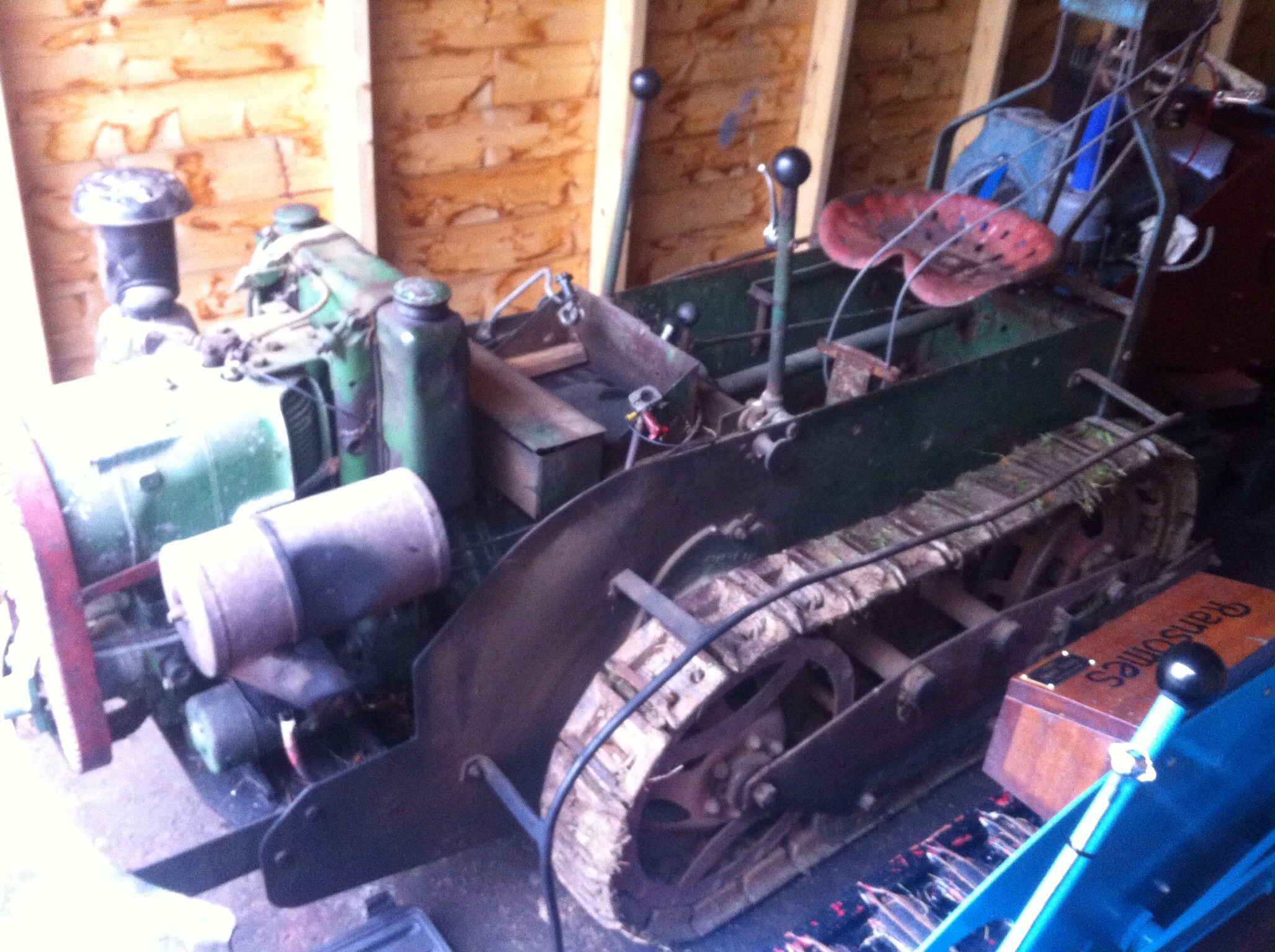

    Have you seen my post on here for my MG40 with Sachs engine? I started it on the old forum and then carried on with it here. The Sachs engine on mine is not original but has been fitted at a later date, the engine bay has seen a bit of cutting to make it fit. My engine is green just like your MG, the main body on mine is blue and dates from before Sachs engines were being fitted.

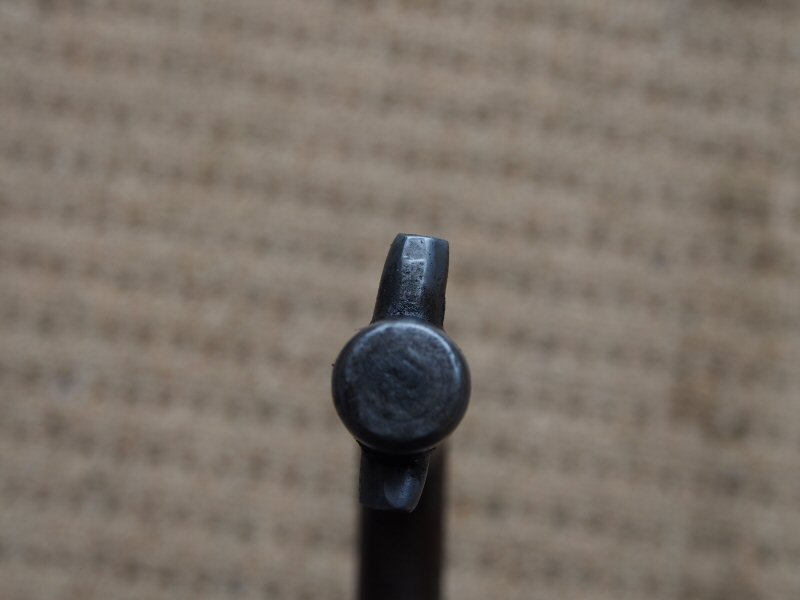

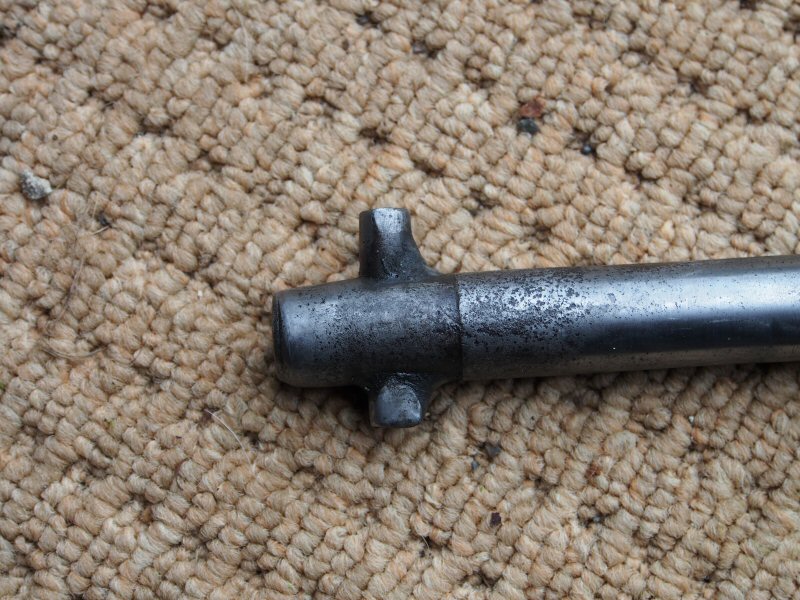

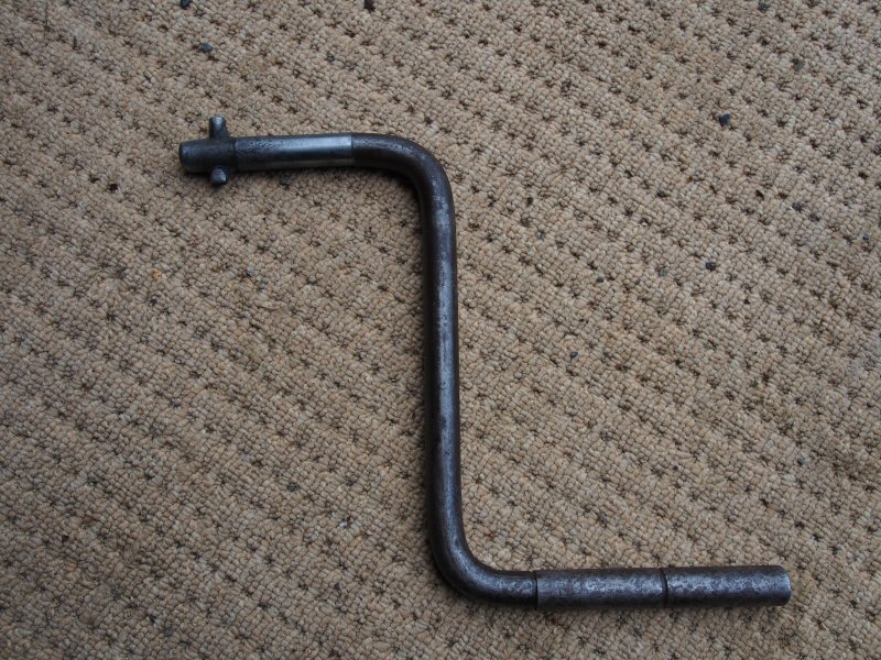

    (Do you have a picture of the starting handle with measurements, I would like to make one

    I’ll take some photos and measurements of the starting handle when I’m next at my fathers where I store my machines. It will probably be Friday or Saturday.

    I managed to get the photos and dimensions for the starting handle. The dimensions are in the PDF file, let me know if you have any problems opening it.

    What are your plans for the Ransomes, restore and repaint or keep it in its working clothes? I opted to keep mine as it is.

    Never seen that plough arrangement before, others I have seen in France had a toolbar fitted all operated with the rear lifting A frame pulley with cable drum on pto
    Was this arrangement fitted by SEDIM the French distributors ? either to suit local requirements or to keep costs down by not fitting hydraulics ?
    I think France was quite protective of its own manufacturers by import duties on foreign equipment at the time

    Much appreciated Rob, will have a go at making one, although i prefer the electric start!!

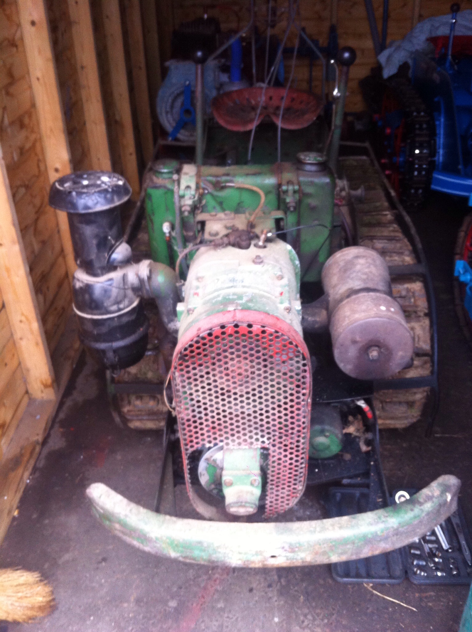

    I do not plan on restoring this one, although i do plan on repairing it mechanically, the track roller bearings seem worn and theres some track rubbers missing.
    The rear lifting arrangement would have been added in France and i believe it was so local implements could be used, however i do not know if it was fitted to the tractor from new or f someone was fed up of the manual lifting frame and fitted this to the back. The tractor would have been ordered without hydraulics, and just the standard PTO.
    i have confirmed my suspicion of the clutch slipping, as i was able to put the tractor in gear and rev the engine without any sign of the engine bogging down when both brakes were applied.

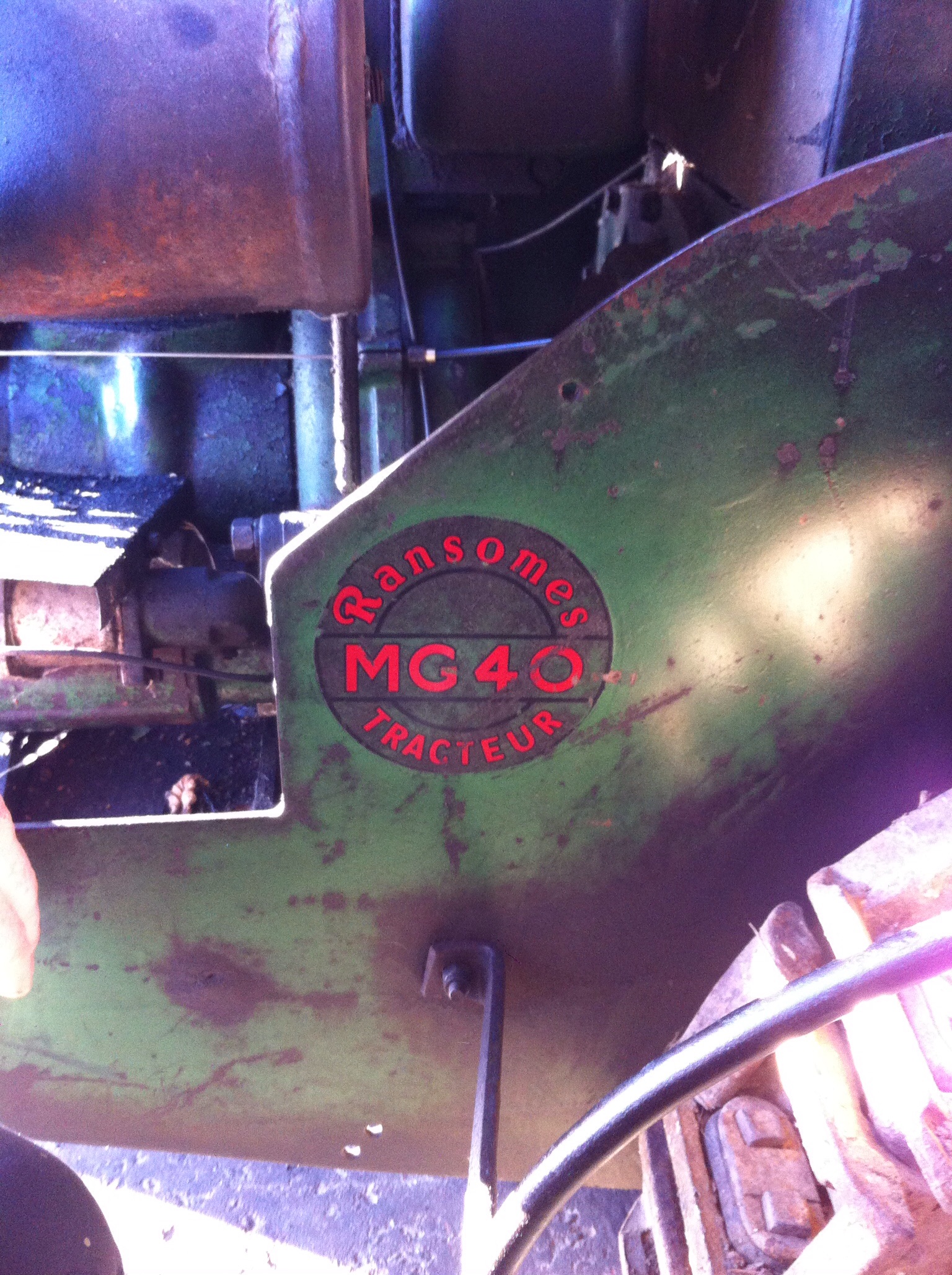

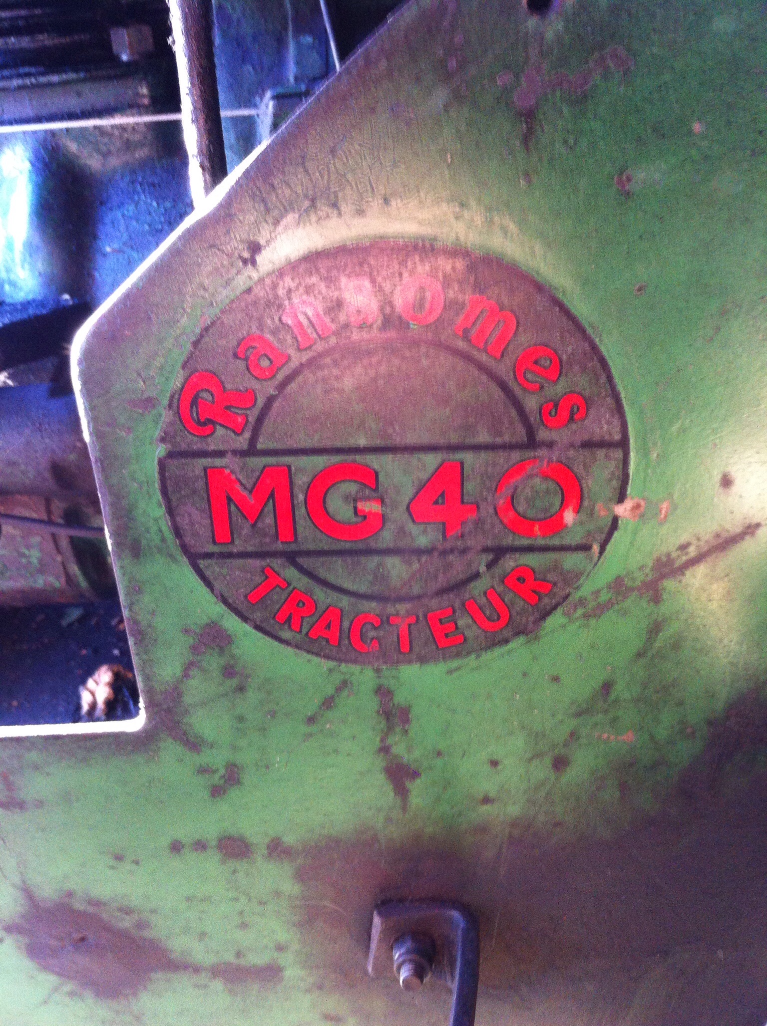

    #11303
    Found this decal after I wiped away some of the grime where the dirty old exhaust has been blowing, re angled the exaust to blow away from the body.
