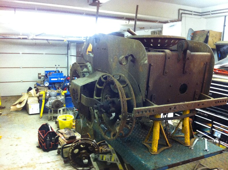

    Restoration began in earnest today on what is believed to be the oldest Motor Cultivator surviving, dating from 1936 the tractor looks rough but is in remarkable condition, every nut and bolt has come undone without brutal measures. I gave it a good soak with penetrating oil about a week ago and so far it has paid off. The track drive roller wheels are shot so I will cut them off with a plasma cutter and weld in replacement rings from Neil.

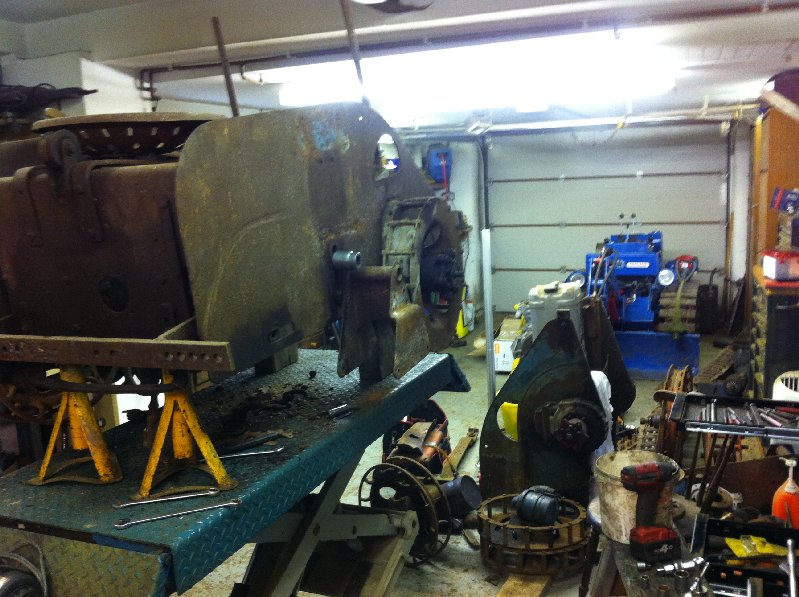

    Both drive roller wheels on 137 were badly worn, the drive rollers are actually bolted on with a nut either side, incredibly all bar one came undone with sockets. I have bought some repair rims from Neil and using a plasma cutter I cut down the wheels to suit the repair rims and pleasingly the rims are ready to weld on with minimal grinding to clean off the slag.
    One concern I have is that as I plan to restore to as new for the 2016 80th anniversary, the engine cowl cover ( threepenny bit shape ) is badly battered and suffering from vibration tears I think it will be hard to repair, but in view of the rolled ribs in the original stamping it will be even harder to replicate. Fortunately I have a better one on my other T /2, but I have promised myself not to rob bits off it unless I am absolutely desperate.

    Finally managed to get round to welding up the drive wheel rims yesterday, the 1/2 1937 model came in handy as a swivel mount for the welding. I tacked them up first and then welded a quarter at a time front and back and then ground them down flush I will have to apply a light skim of filler just to fill the rust pitting and the odd low point in the weld edges.Rhys has made me two new sets of rollers and spindles.

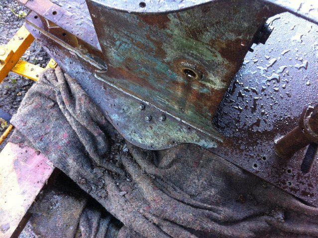

    Finally managed to get back to 137 today, pressure washed off the body, degreased it and cleaned all the crud out of the gearbox. I had to use a chisel and a descaling gun to remove the Worcester marl from the underside but just look at the condition of the eighty year old bolts under the clay!
    #14700
    expeatfarmer
    I also found that the tractor had originally been painted lawnmower green under the blue, I wonder if they originally planned them to be green and then changed their minds, primer underneath the green is grey.
