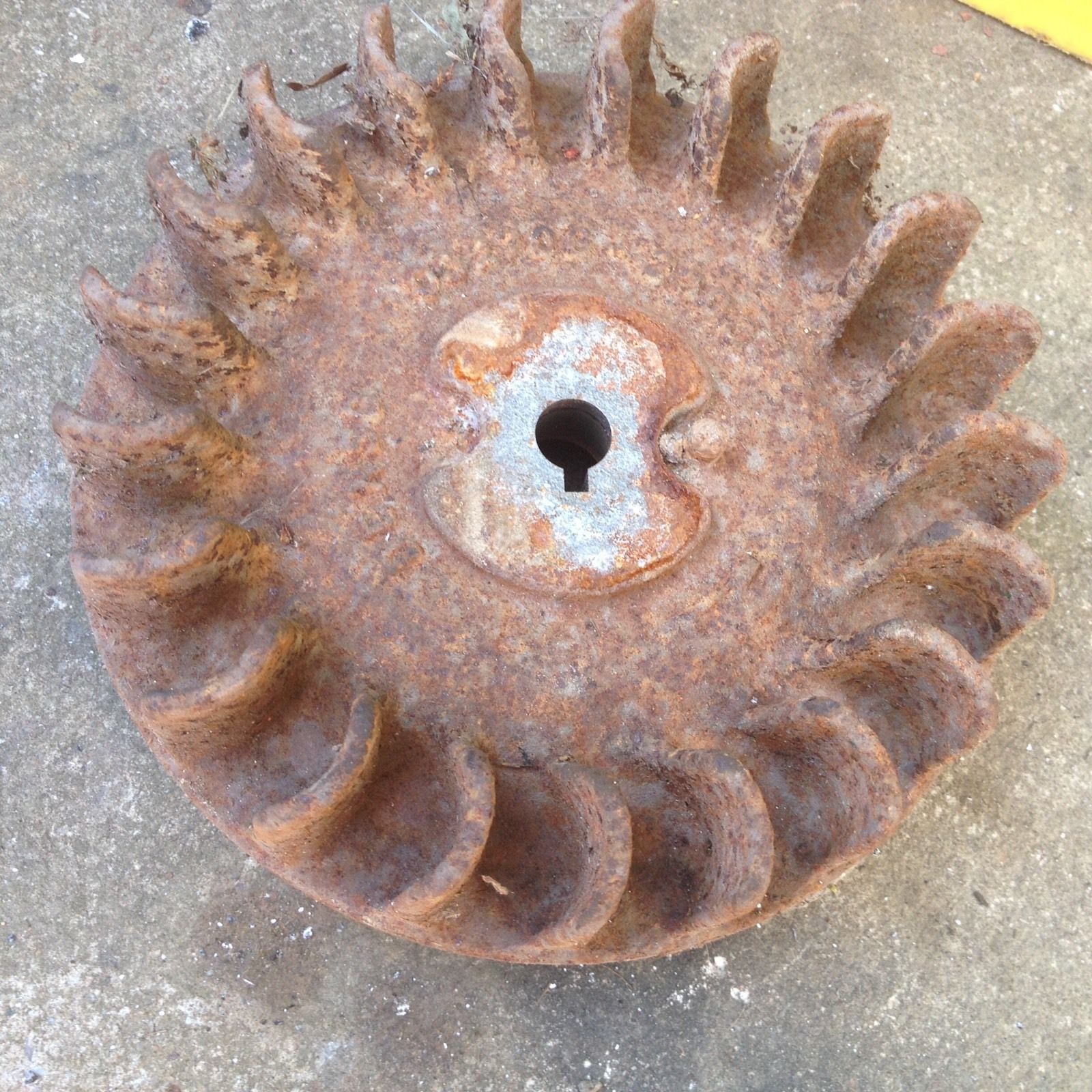

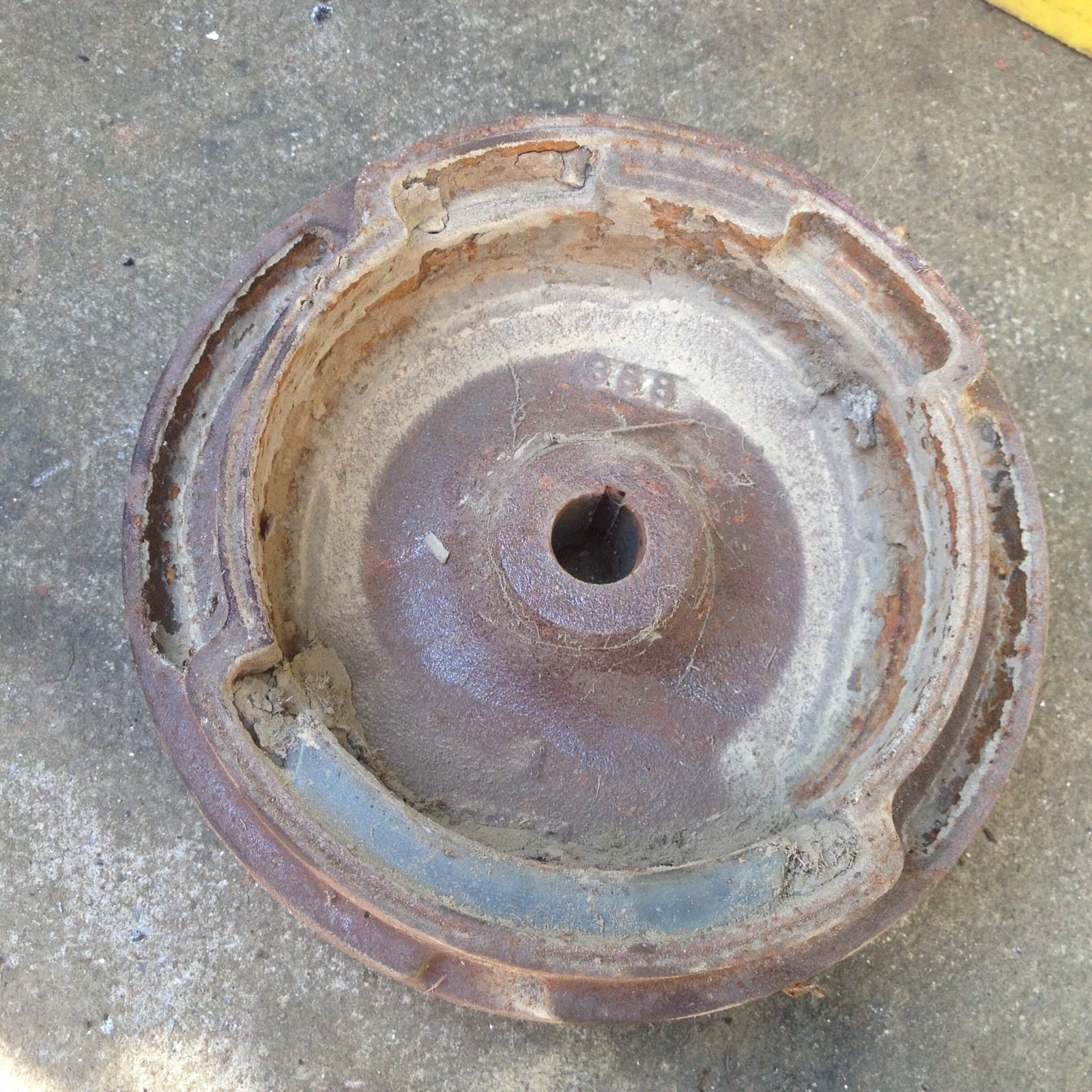

So I opened the ignition-part and that was very dirty and rusted. I cleaned everything but still the same result.

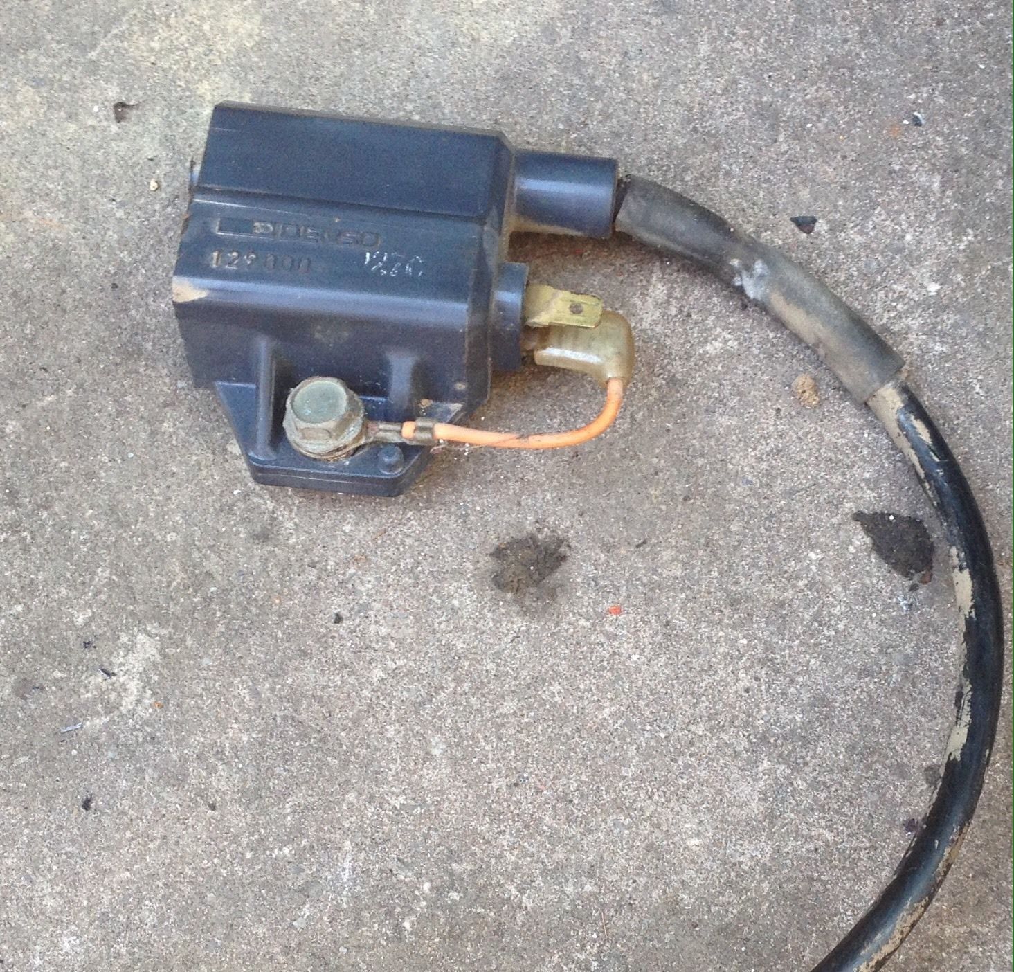

vhgmcbuddyMemberI measured the ignition coil.
Coils resistance primary is 0.13 and secundary is 9.73
Multimeter on 20k
I don’t know how to measure the clearance from the rotor to ignition core because the coil is located at the inside of the flywheel.
Is that ok?
