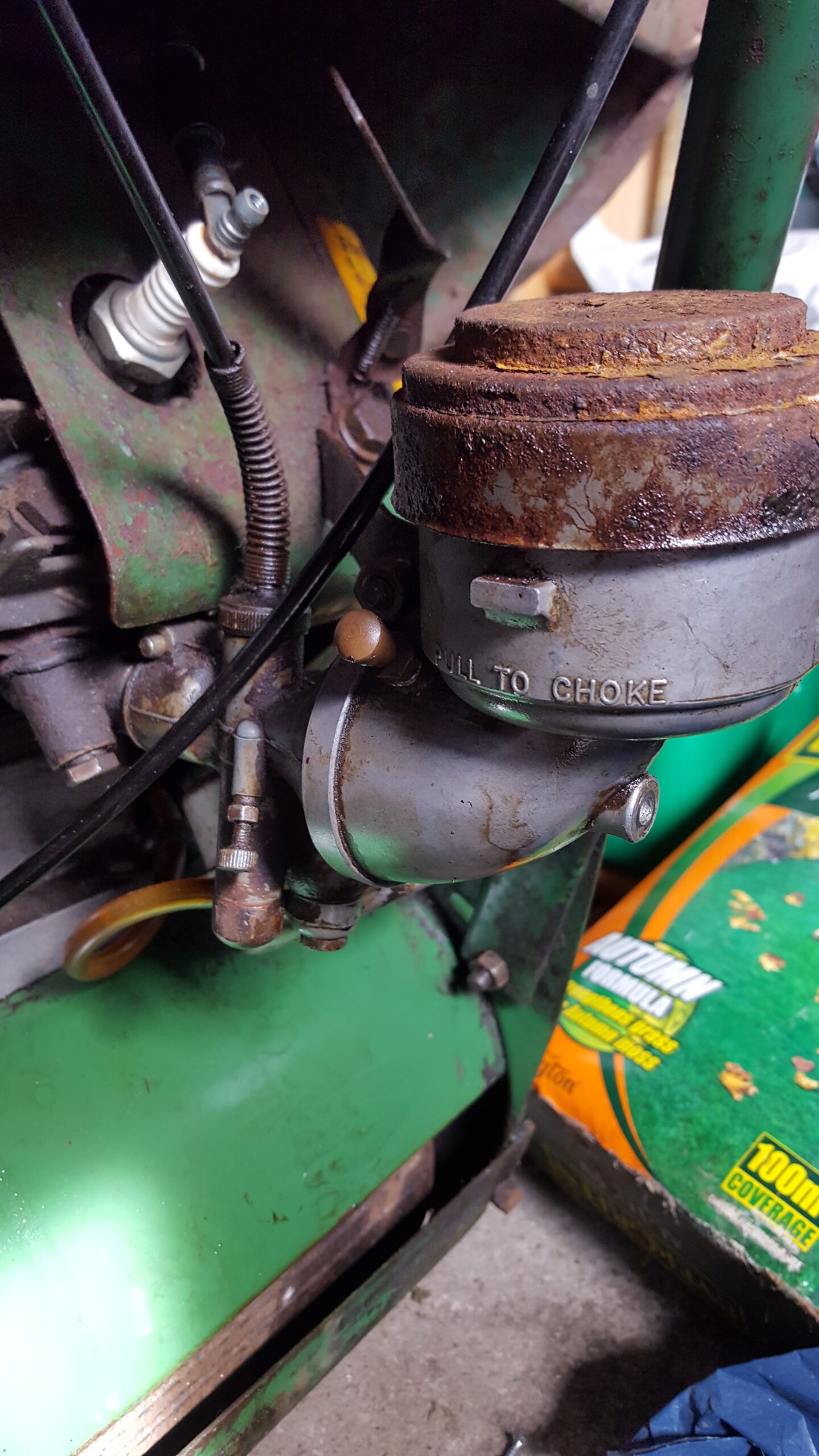

    I’ve just managed to get my Grandfather’s old Marquis running. It is, however, very hard to control, it is either running very fast (and cutting beautifully) or stopped, it is very difficult to get it to run at a fair walking pace.
    Is this likely to be an issue with the engine or the running gear? Should I strip down the clutch or lubricate the gears?

    I guess the carburation needs some attention.That particular engine should idle beautifully so strip and clean the carburettor and adjust the throttle stop screw (the one with the lock nut in the pic) to obtain a nice “tick-over” speed.It may also need the ignition system looking at too.

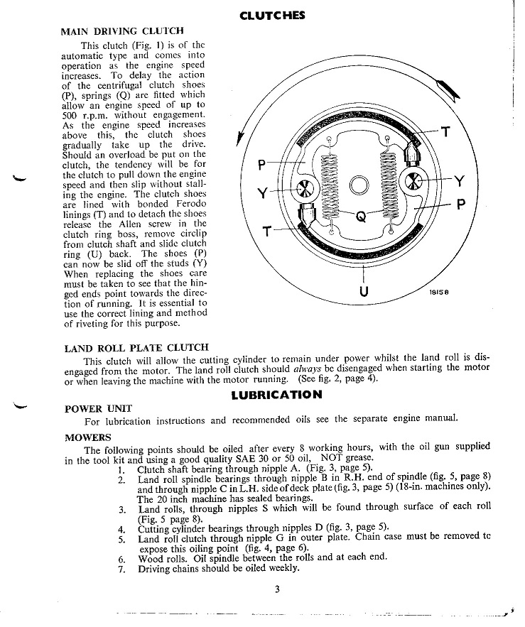

    There is also just a possibility that at some time the centrifugal clutch shoes have been refitted incorrectly: this results in a snatchy take up of the drive rather that the correct smooth take up which allows a Marquis to be driven “on the throttle” and the landroll clutch reserved for emergencies and parking.

    While in the clutch checking the shoes also check that the clutch shoes move freely on their pivot pins. If these are not moving freely the drive may not take up cleanly and will only drive the machine at higher engine speeds.

    If your machine has the telescoping shaft guard it may be easier to remove the engine but some access may be gained by sliding the drum away from the engine.
    If you look at the shaft there is a circlip which limits how far from the engine the drum may be slid. Clean off any old paint etc from the shaft and open the circlip enough to slide it and the drum along the shaft. In the drum boss there’s a small grub screw, undo it a couple of turns and you should then be able to slide the drum away from the back plate and expose the shoes. Carefully lever them away from their pivots and when free you can unhook one spring and remove the shoes from around the shaft. Clean up the pivots and put just a smear of oil on them before refitting the shoes. The pivot ( anchored) end of the shoes should lead. If assembled with the free end leading the clutch will snatch.
    Personally I would just unbolt the engine and pull it and the clutch back plate away from the drum but sometimes separating the shaft from the spigot bearing can be a bit of a fight.
    Looks like the forum software is cropping the scan of the clutch but clicking on it seems to bring up the full page!
