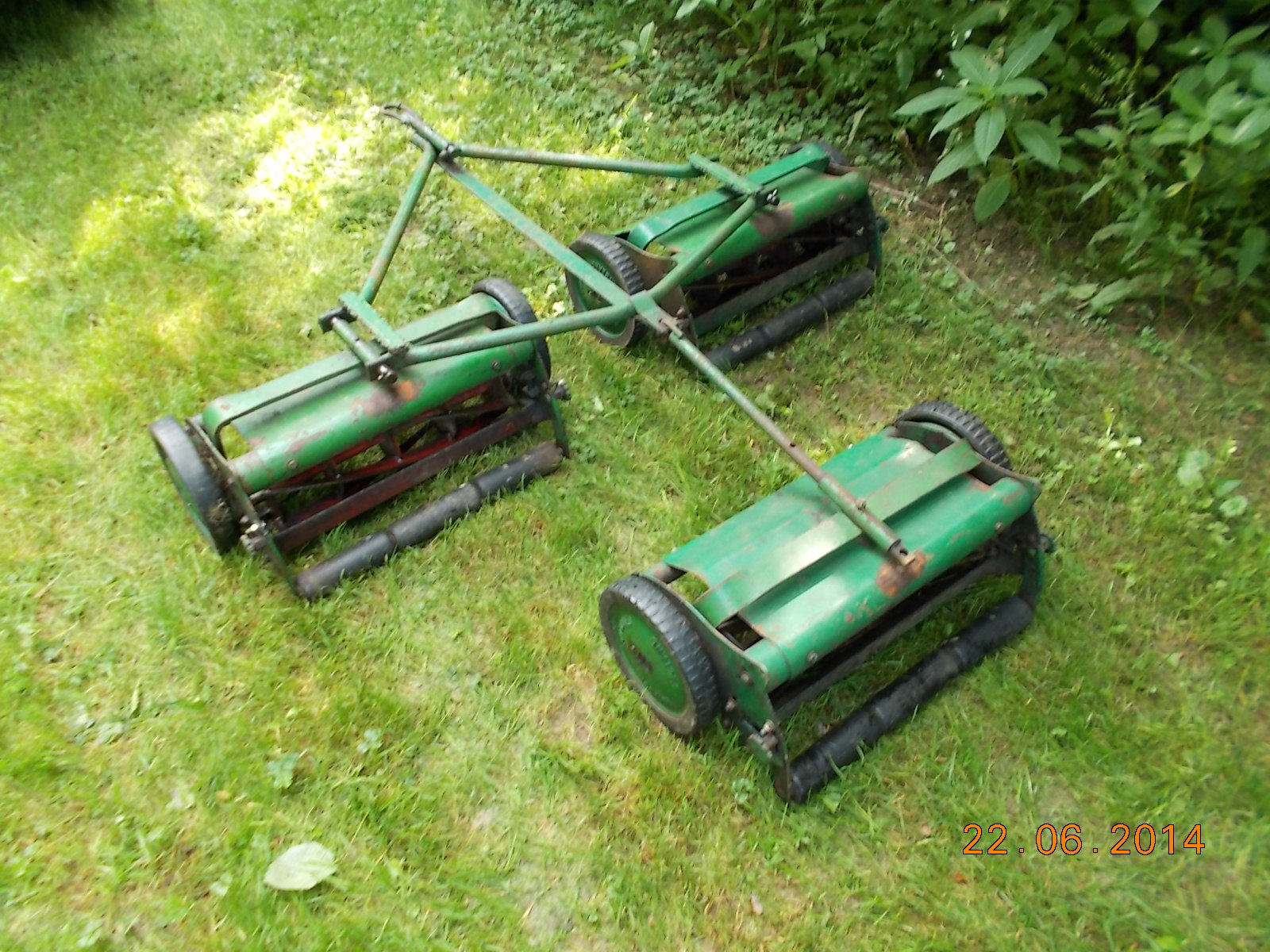

    Picked these up so we can keep on top of the grass cutting!
    In good order for there age. Cant wait to try them out in the week

    They look in pretty good order, usually the tyres are totally bald, I guess they are three antelope units, should cover the ground quickly.
    #8740
    Specifically these are J5 gangs, based Antelope units, some of the early versions even still had the sprockets on the left end of the cylinders. Make sure that there is no wheel wobble which, if not attended to, will lead to the drive pinions destroying themselves and the ring gears cast into the insides of the wheels. Both the pinions and the wheels are getting hard to find so it may be worth inspecting them all sooner rather than later.

    Thanks for the info Angus. There is some play on some of the wheels.
    I do have some spare parts. If not I can get local machine shop to make me some new shafts up for the wheels to turn on
    I have seen a set in the past with sprockets on the cylinders

    After posting my reply re your gangs something was bothering me and then the penny eventually dropped (age thing!) – they appear to hitched up the wrong way round!. It’s more usual to have the single unit leading. That sent me burrowing through the manuals but all I could find is an operators manual for the very early units where their Antelope ancestry is very apparent. Looks as though your hitch may have originally been for a five set rather than a three. Anyway it may be of interest
    https://www.dropbox.com/s/s4io0a0f5au44c2/Ransomes%20Junior%20Gangs0001.pdf
    On the wobbly wheel issue I am wondering whether as they have a cast wheel running on a steel (hardened?) pin that the wear is more likely to be in the wheels. If the pins mic’ up more or less standard would an option be to put oilite bushes into the wheels. If you go the new pin route you would probably have to true up the bores in the wheels anyway.
    Just a thought!

    Thats interesting, thanks!
    Yes I do have some extra bracket wings to turn it into a set of 5. I have the remains of the other 2 units in a box by the looks of it!
    Had a play with them tonight. They do cut. Not the best I have seen, but do block up every so often. The 2 fronts do seem to choke the rear so you may have answered my question. Once I had been over an aera several times it seemed to be better. Had them on full height & had plenty of cut grass flying out!
    Think I will have to strip & sharpen then & sort the wonky wheels when & get the other mower sorted.
