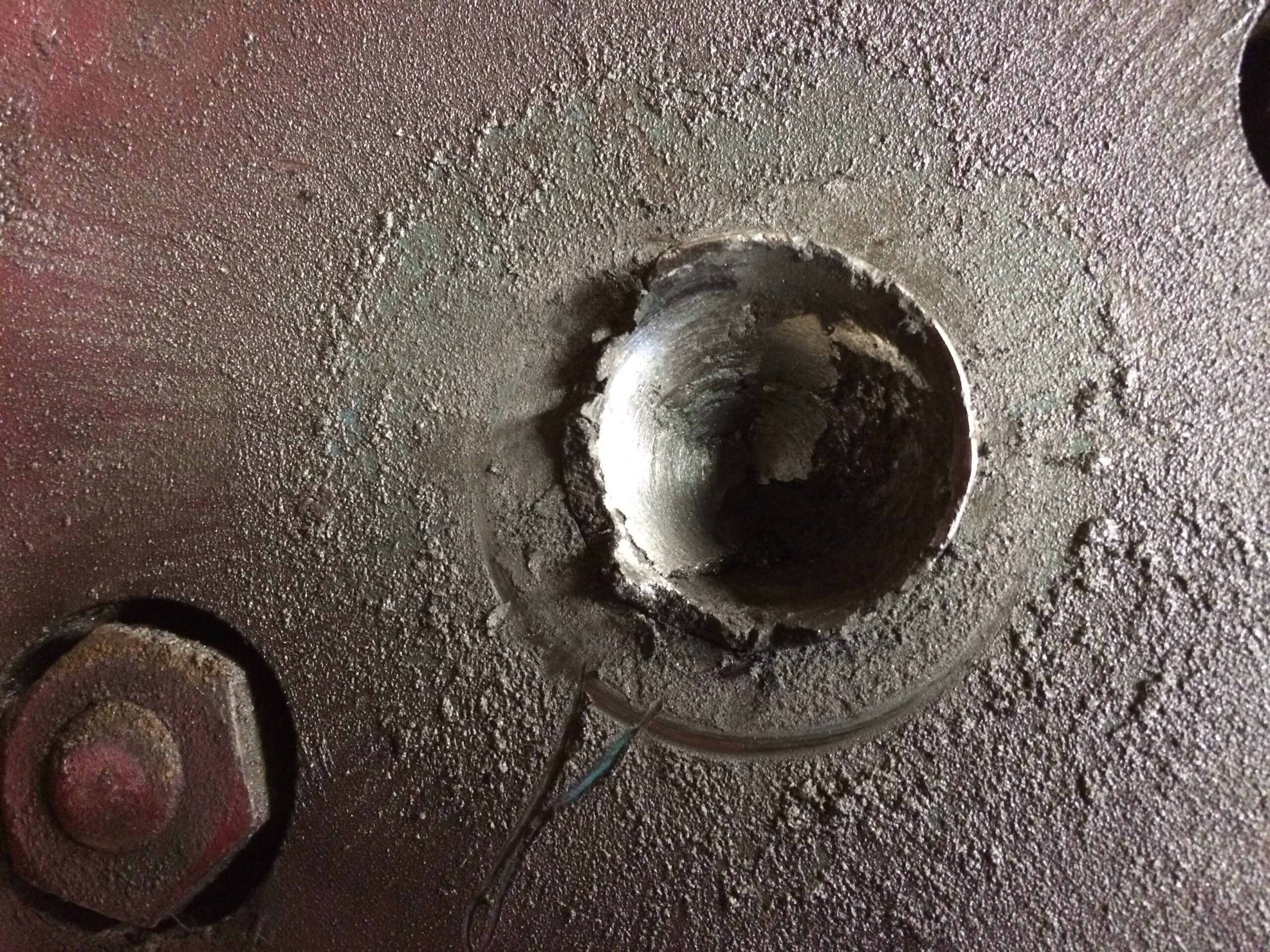

    #10753

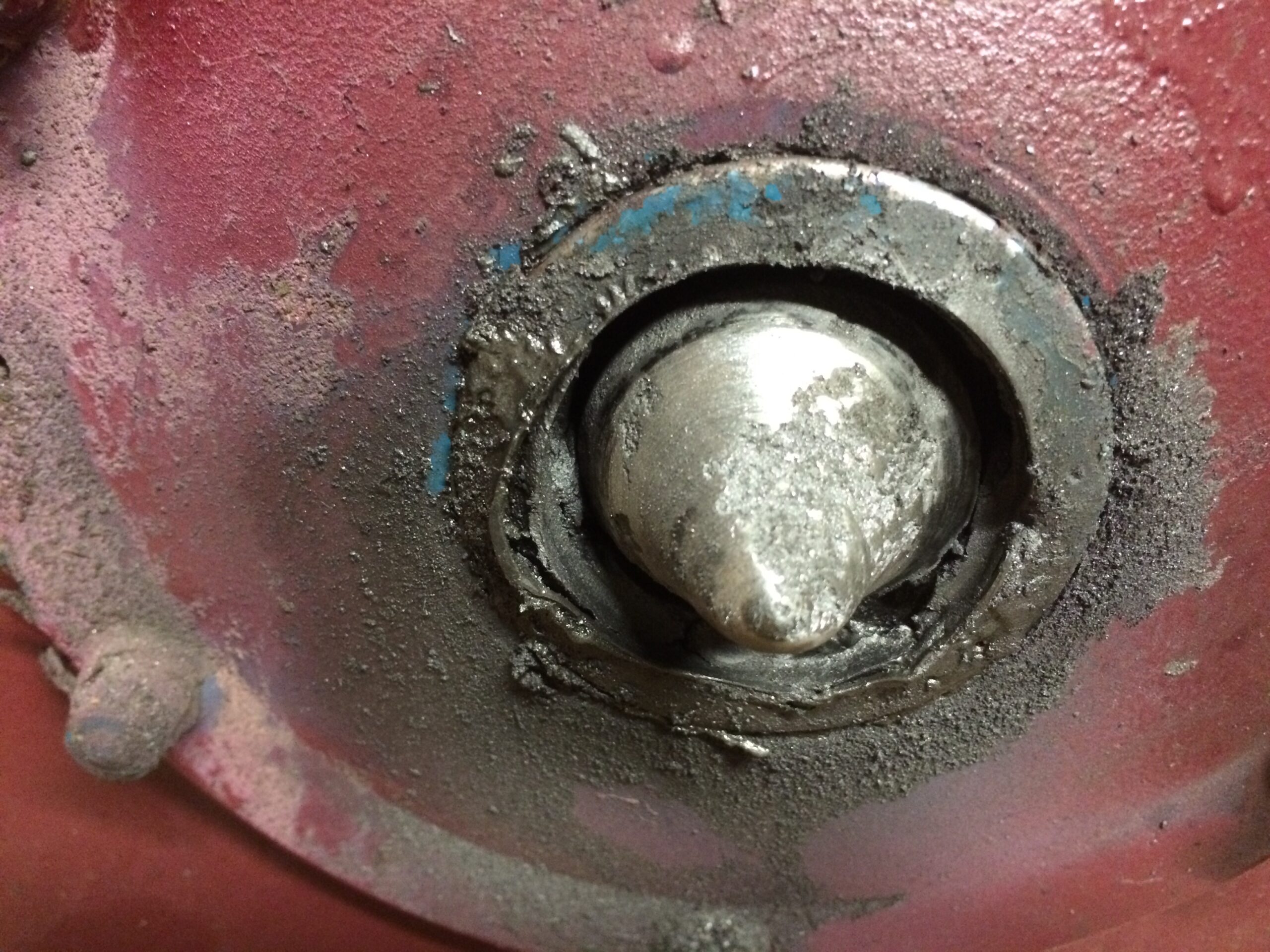

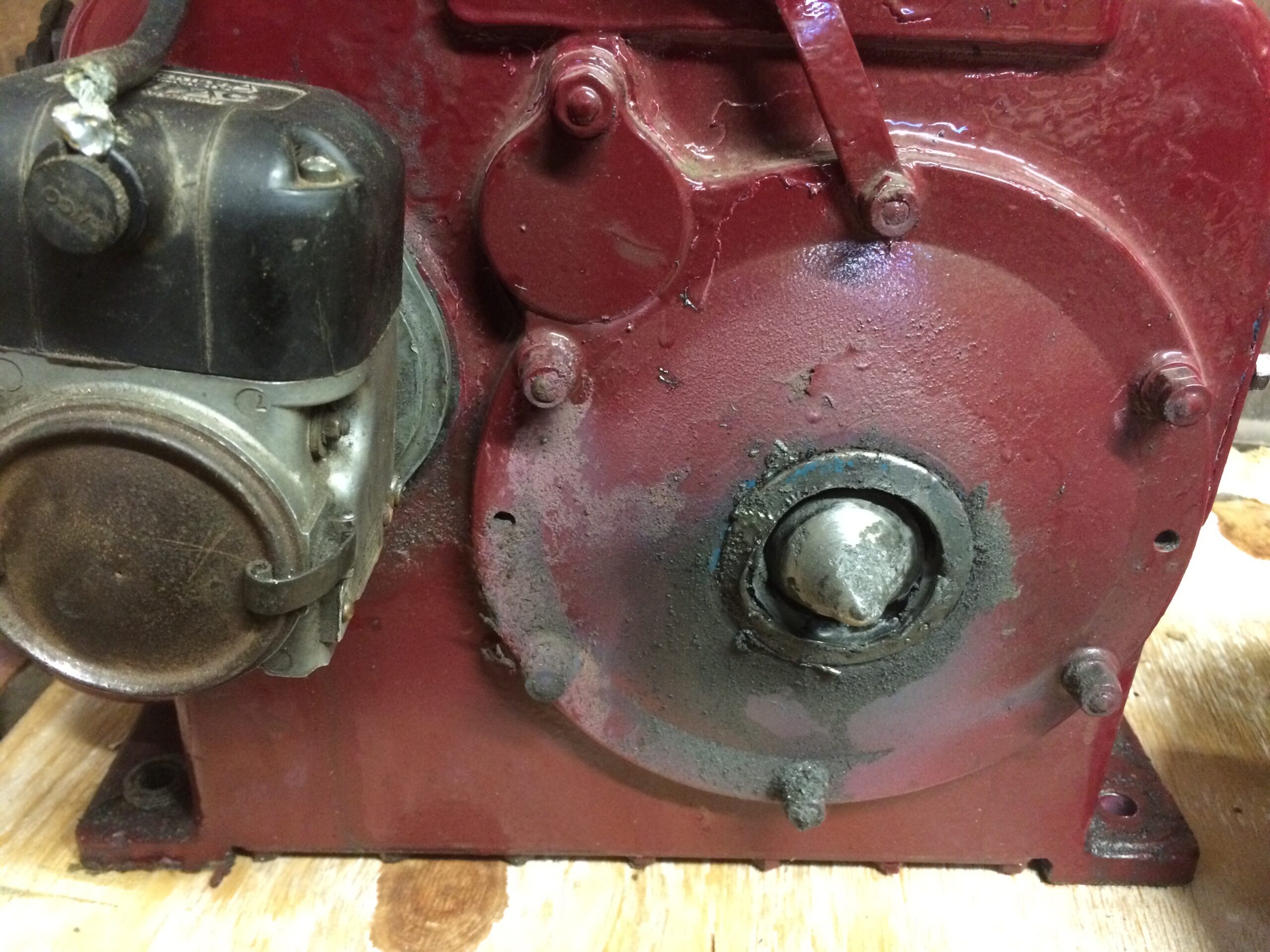

    So
    After a busy rally season , this happens …

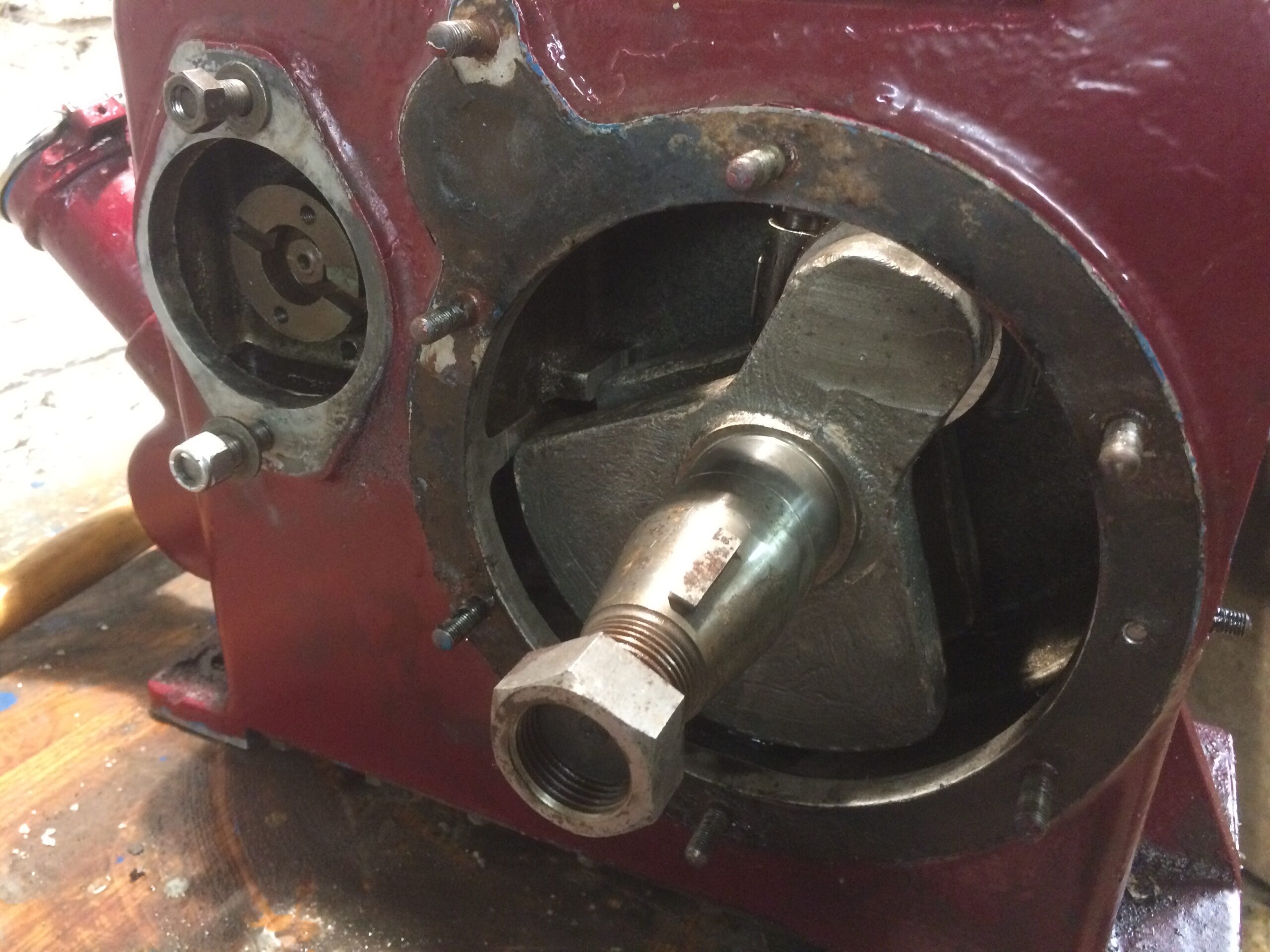

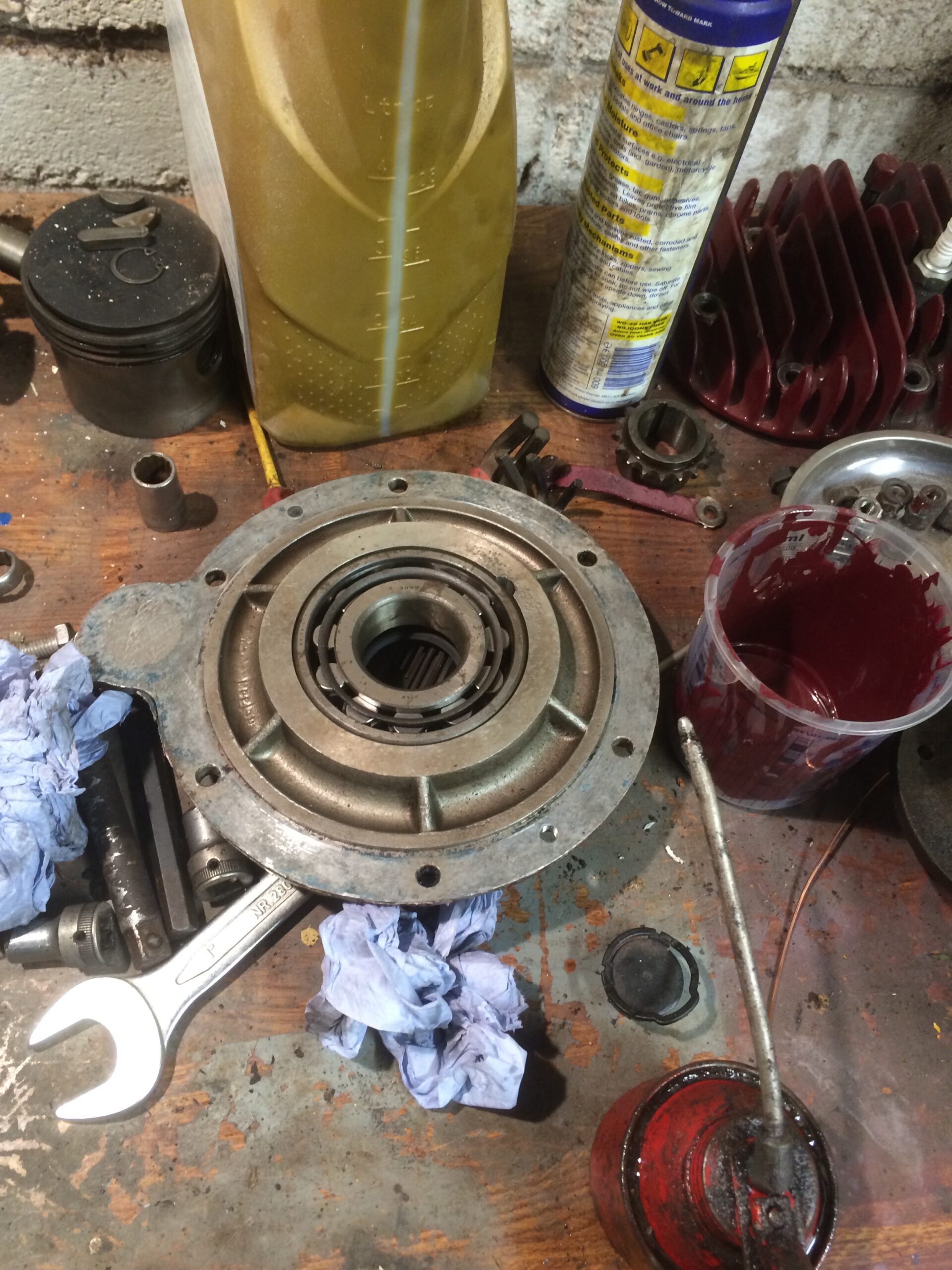

    #10757
    So, got a new crank shaft from Neil , along with new big end shells , roller bearings , seals and gaskets. Had to resize the conrod. Then the web on the crank would not fit into the crankcase. Got it in , and it was hitting off something inside ! Too big for my lathe so a mate took it down on his.
    So here’s what it looks like tonight ….

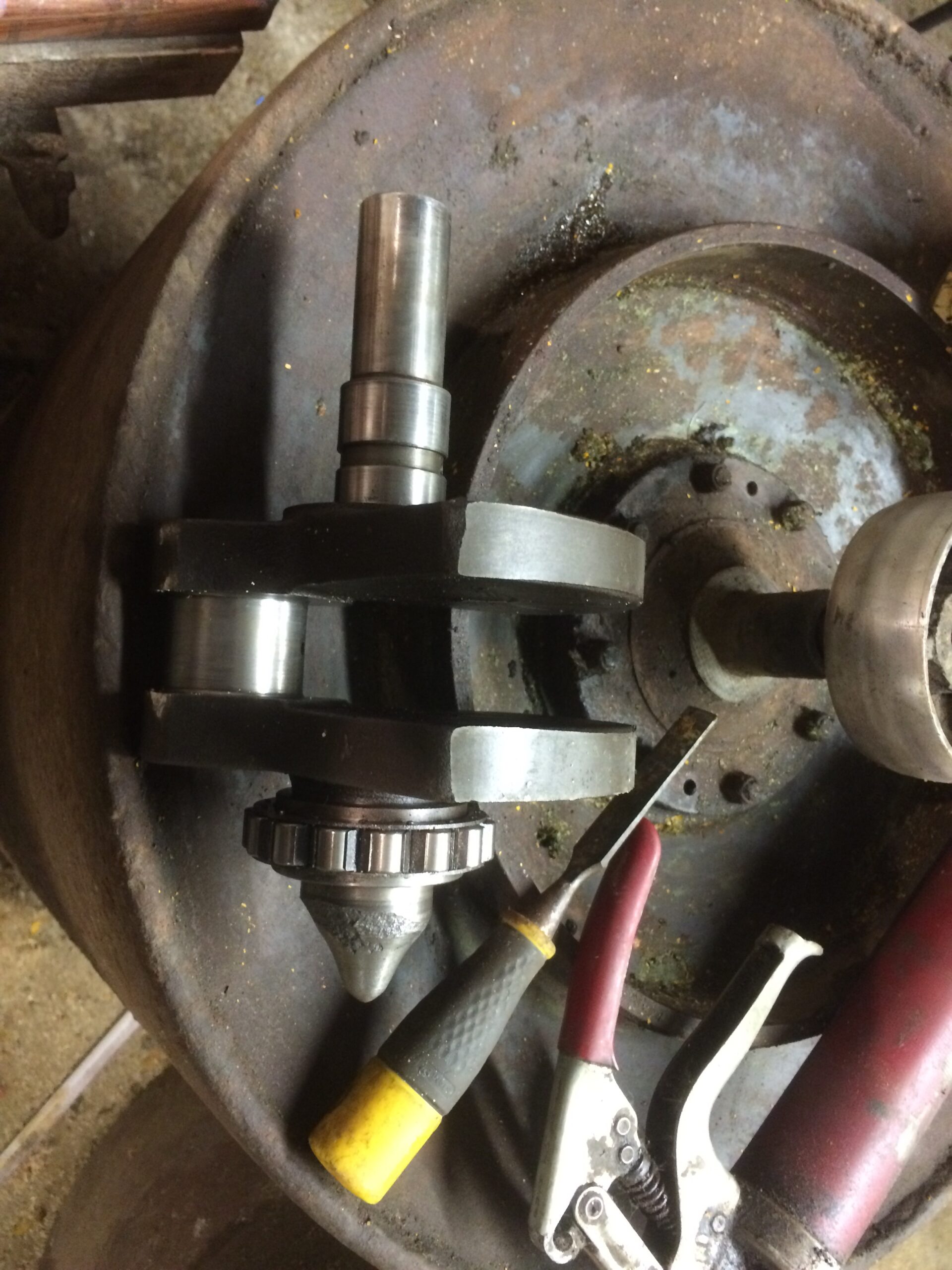

    #10762
    The broken crank
