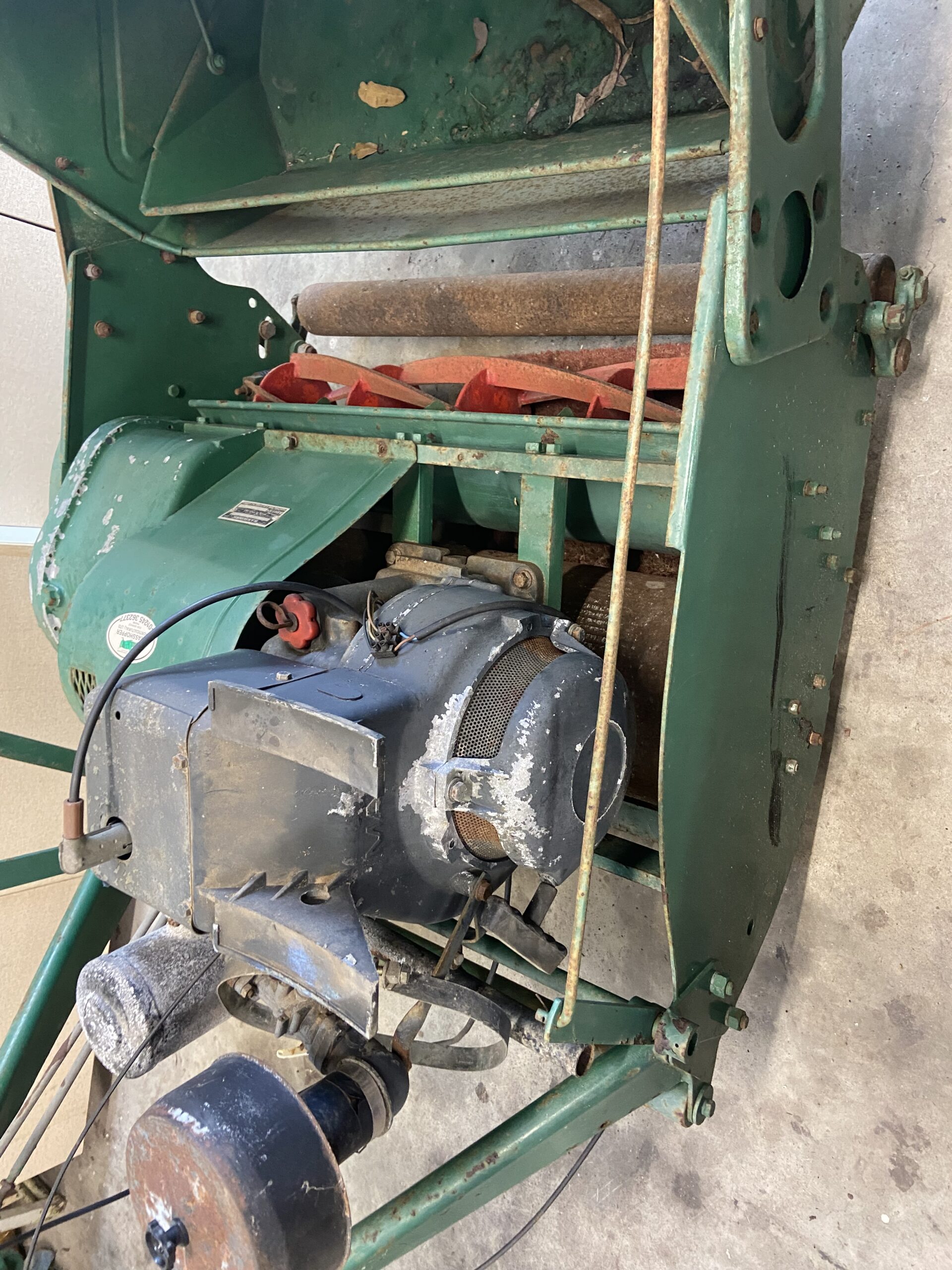

    I have acquired a Mastiff30” to start rejuvenating my lawn (yep it’s big).
    (MAG engine not battery model)
    Unfortunately it’s not running atm. So far l have been unable to get spark. I have taken the mag off and had a bit of a look – all looks ok except for slight rub mark on HT coil.
    My first question is l have 4 wires coming from the coils, Yellow, Yellow Black from LT coil, Brown from earth point on plate and Black from the condenser. Where/how should these be routed

    You don’t identify the engine – SRL xxx ? However back in the day many of the MAGs fitted to Mastiffs etc were equipped for electric start or lighting even though that wasn’t fitted. So, as you say coils – in the plural, you probably have a surplus charging coil.
    Identify the ignition coil with the HT plug lead and probably a single primary coil wire going to the points where it will probably share a common terminal with the condenser / capacitor and maybe a kill wire going to an on/off switch on the handle bar. Memory says that the internal wires are often taken to a terminal block on the outside of the engine cowling.
    If it will help, I can possibly find a wiring diagram but it will assist if you can supply the SRL number.

    burls
    Gidday mate, thanks for your input
    Reg’d No DW 02348
    Makes sense its a charge coil, l thought it must have been a trigger coil. With this new info, l will check points work correctly. I do suspect the spark coil has failed though.
