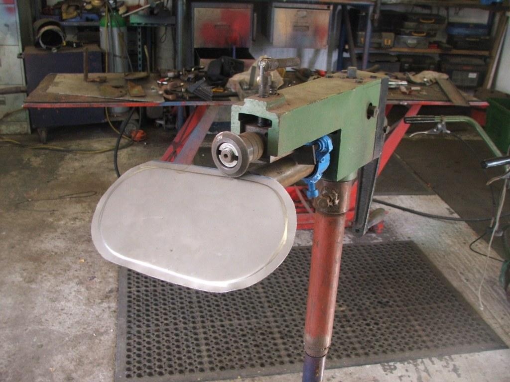

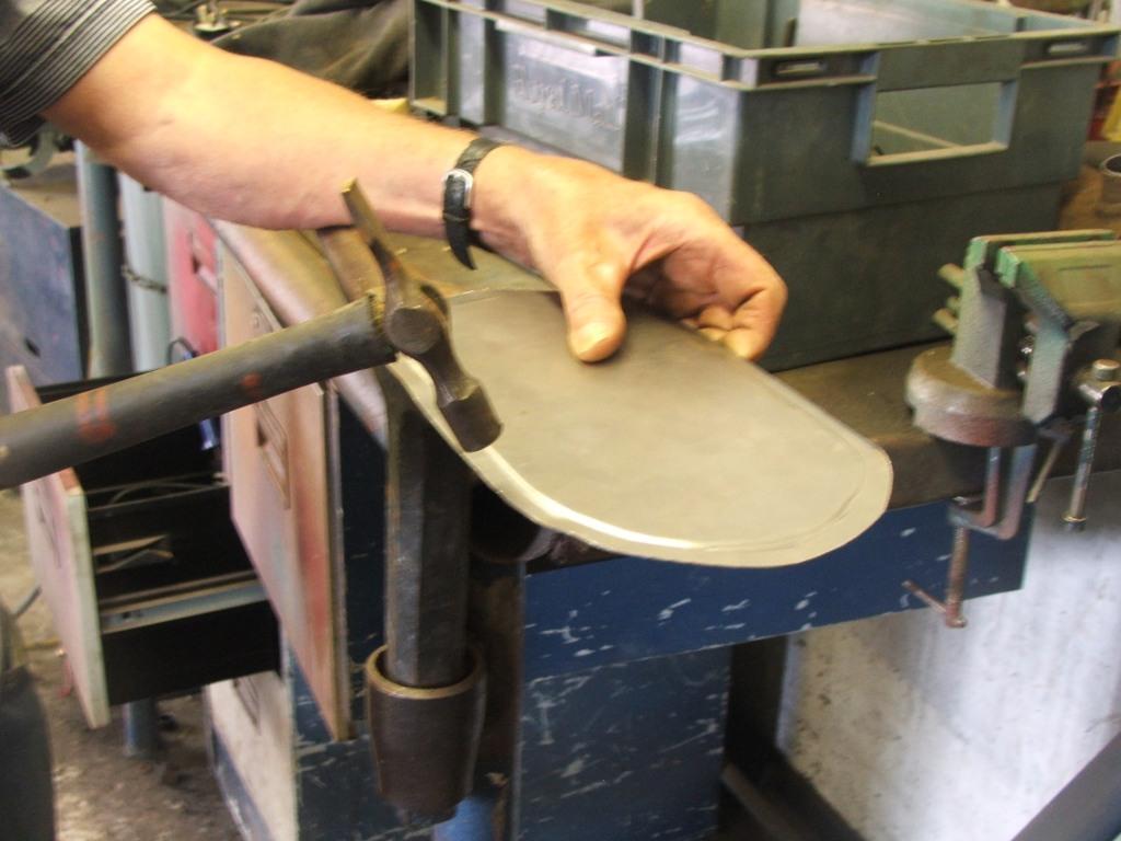

    #1229

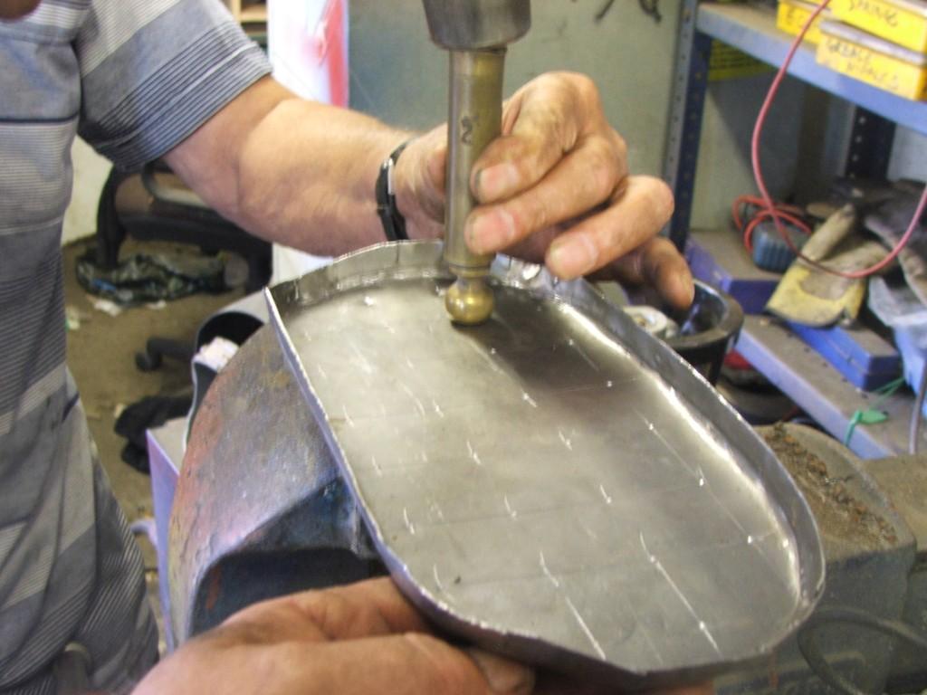

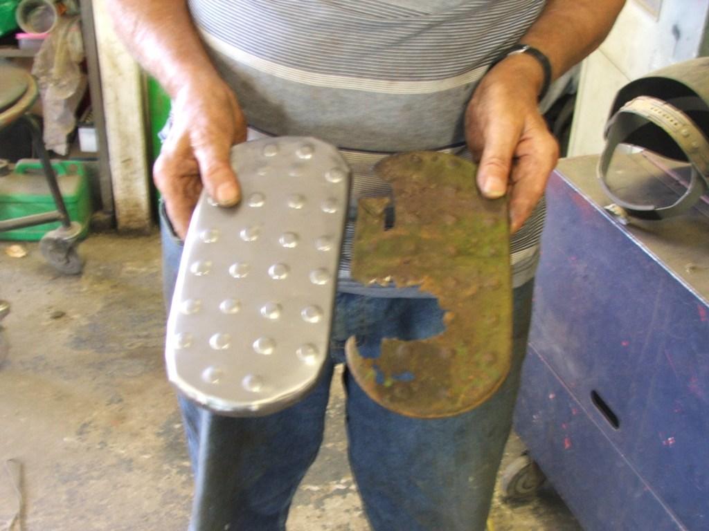

    making new footplates
    #1237

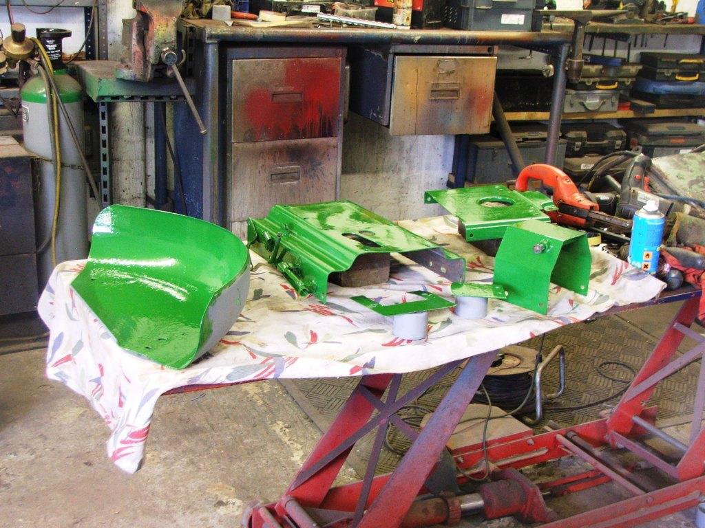

    Good to see the big green beastie on here !!

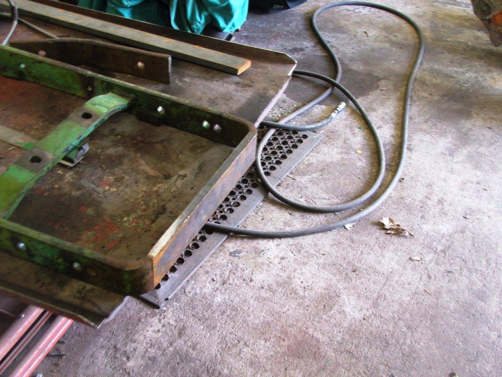

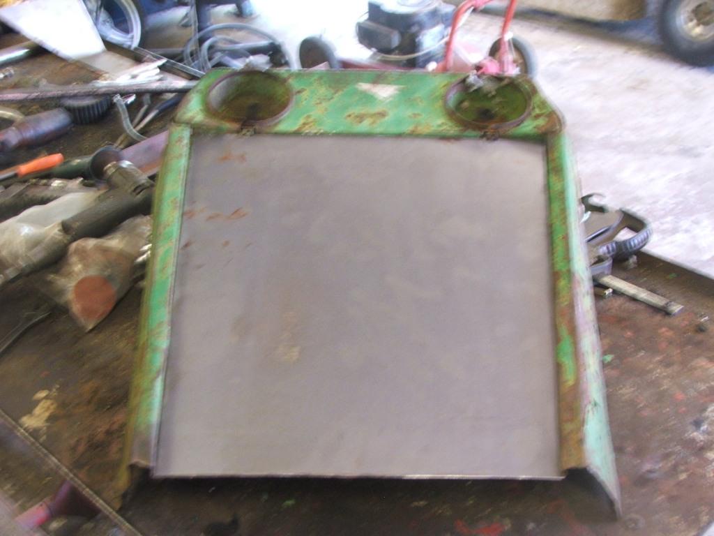

    #1239

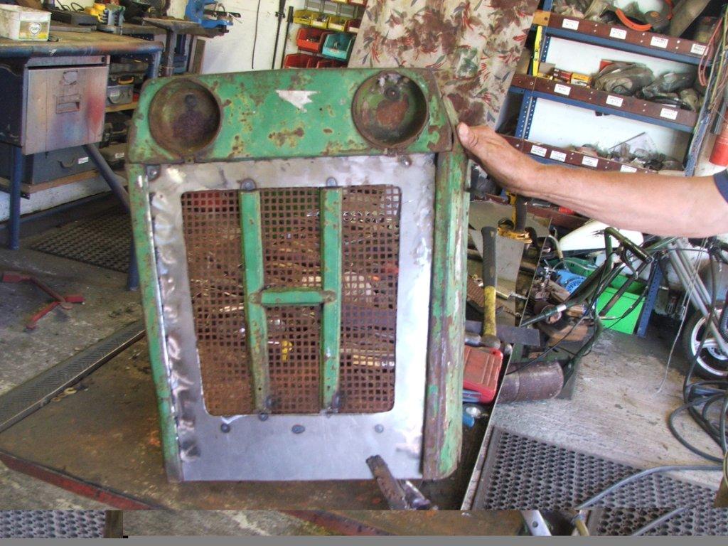

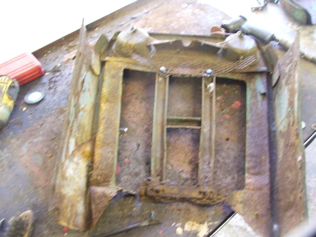

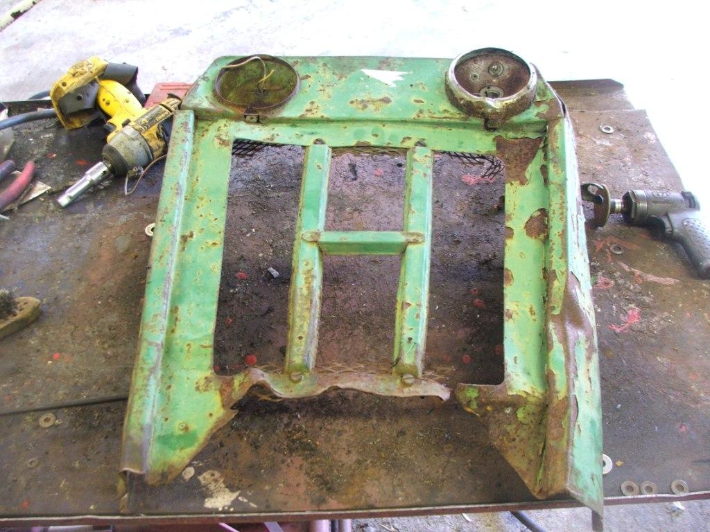

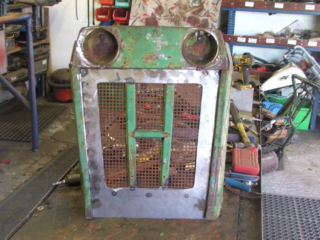

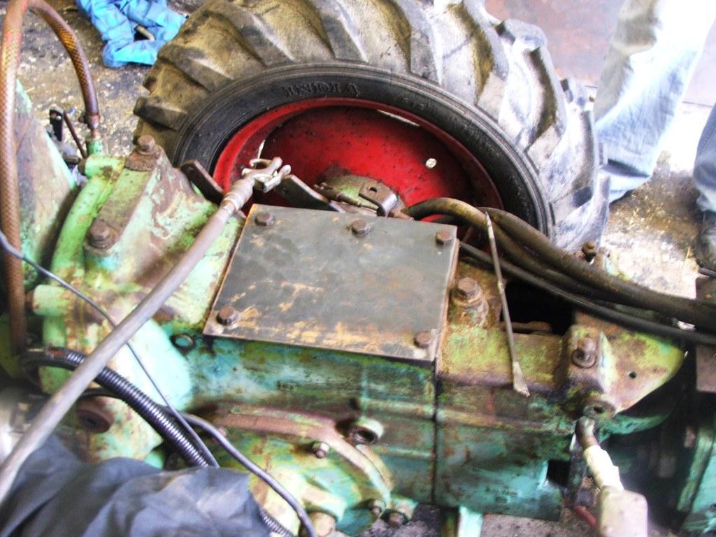

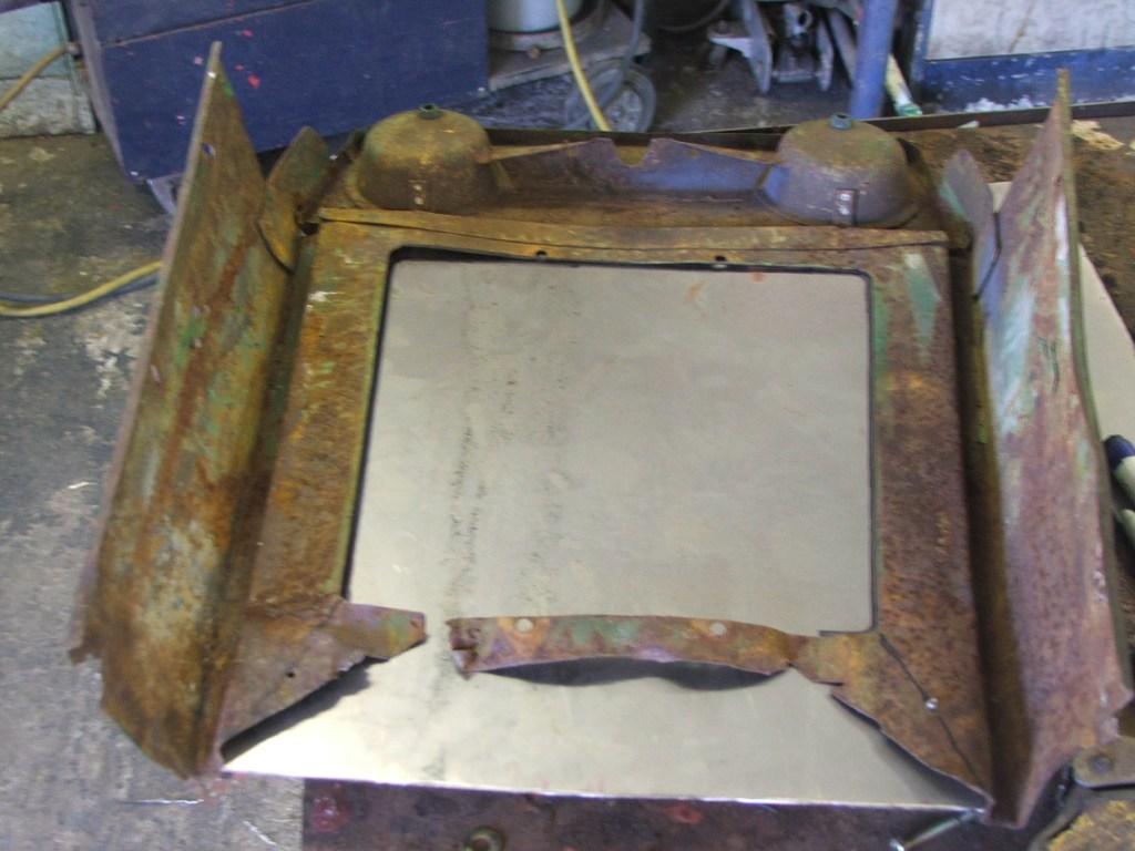

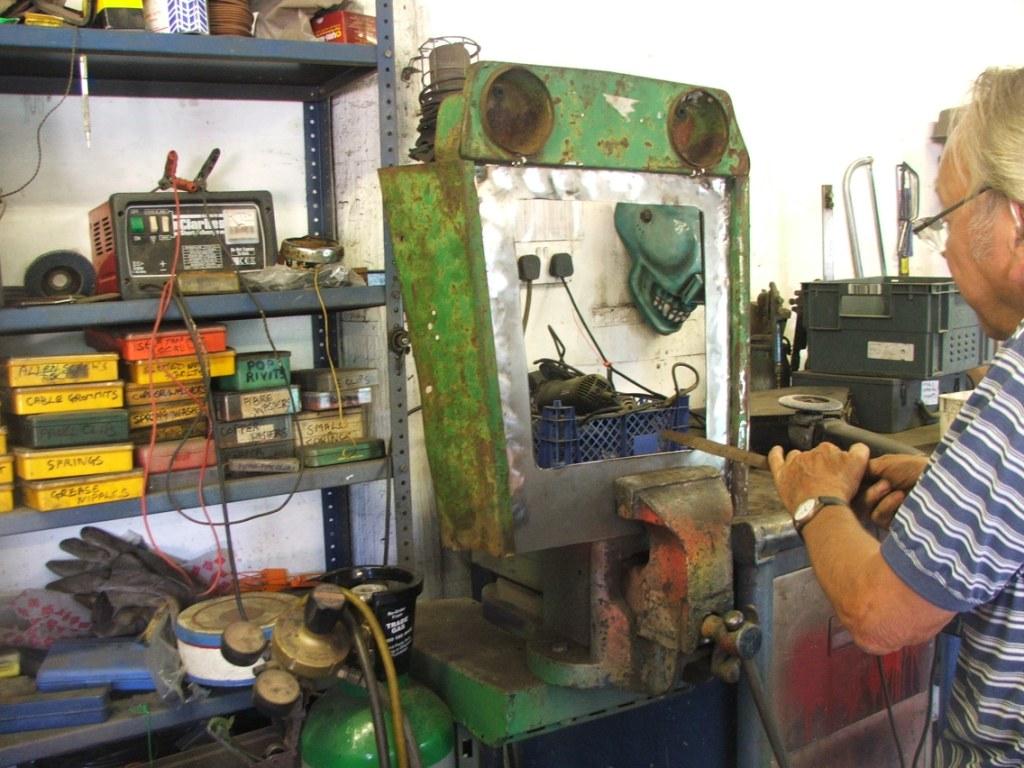

    well the next bit to tackle is the front panel and grill again its knackerd

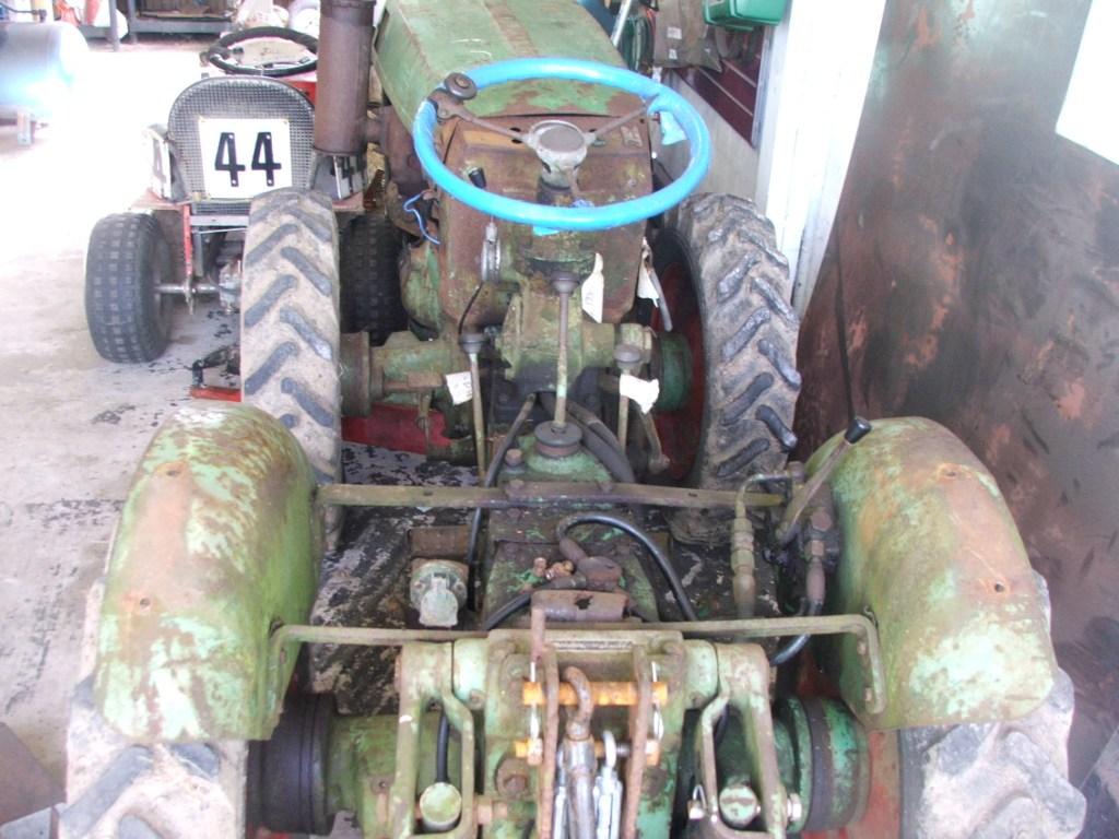

    #1273

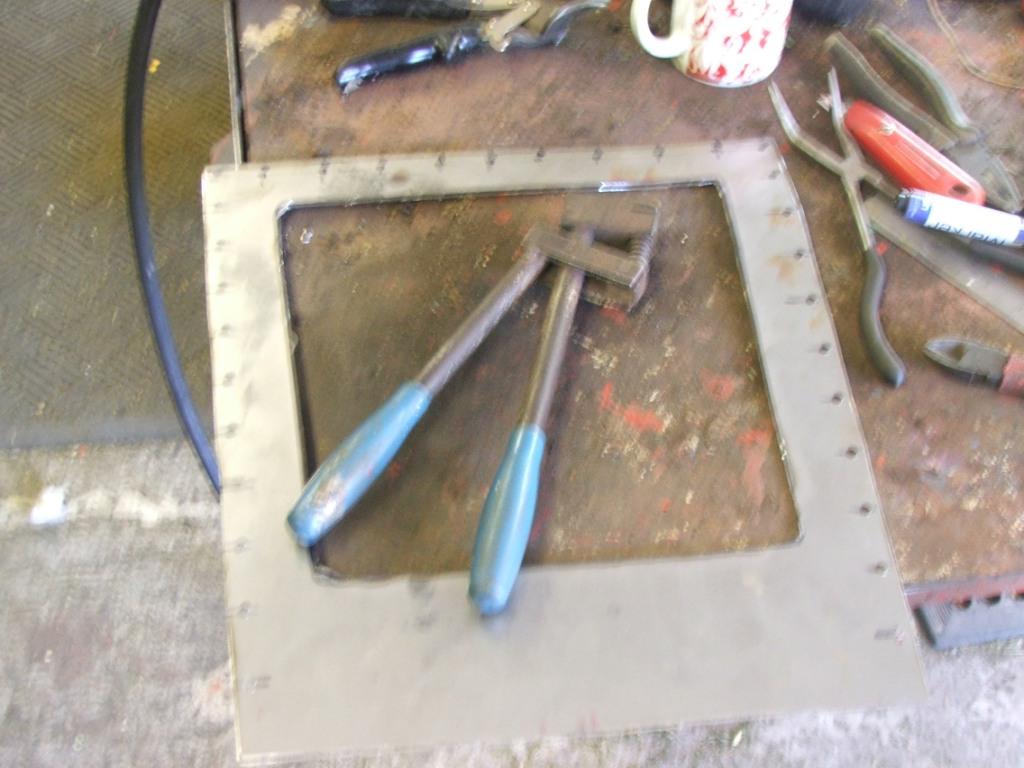

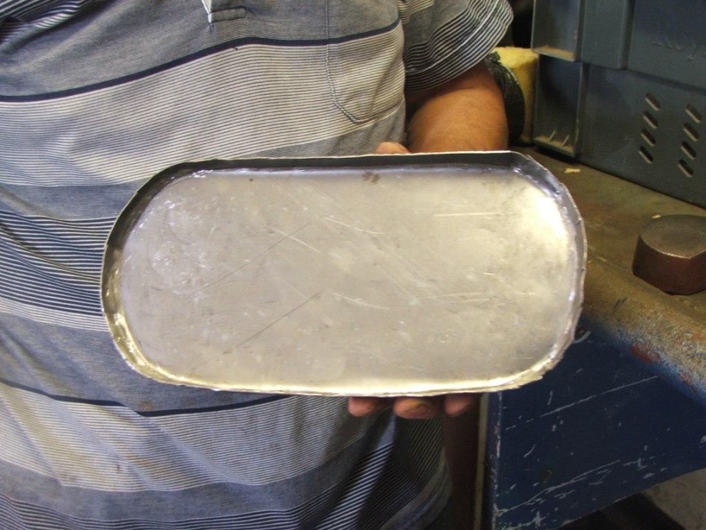

    after taking the tank out i was left with a big hole so have made a tempory plate to stop any sh*t geting in

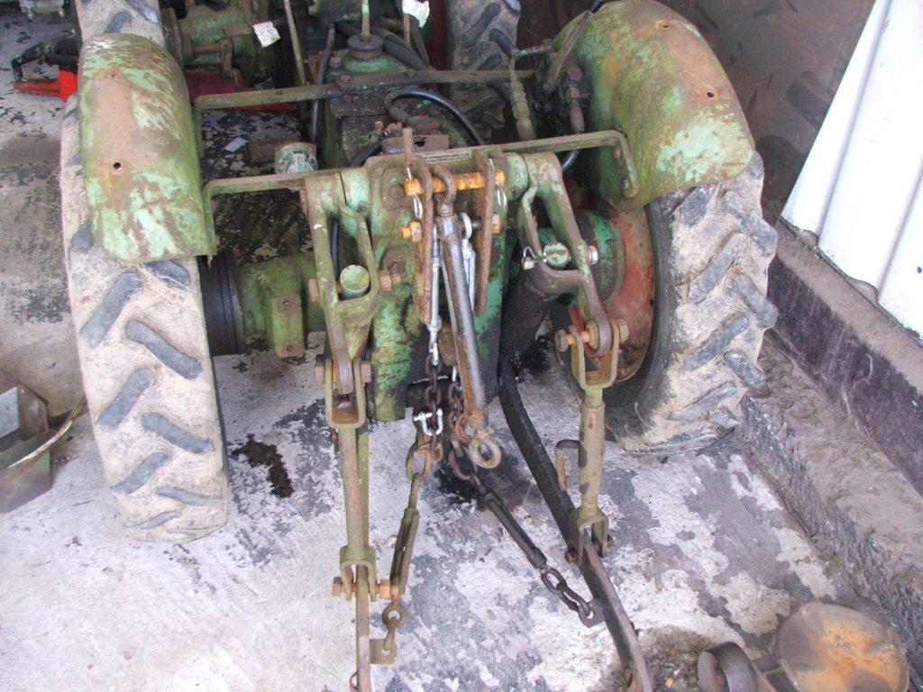

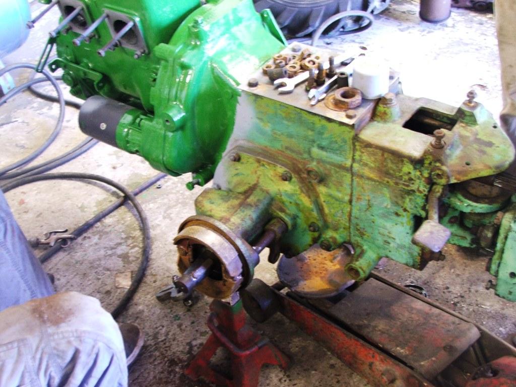

    #1277

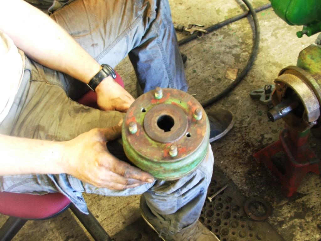

    well my boy and i decided that today we would sort the brakes out that were sticking on and replace the seals behind the drums, big mistake! the drums just would not come off we tryed every thing including heat, so after four hours we took drastic action we drilled two holes in each drum then tapped a thread in each and inserted two 10mm bolts into these hoping by doing them up it would push the hub off but there was still no movement then we tryed a puller connected to these bolts hey presto 7 hours later i now have good brakes all round and no leaks

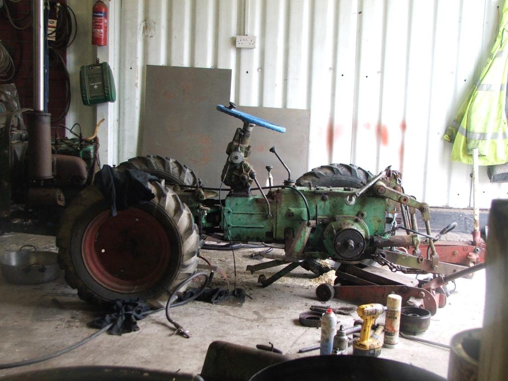

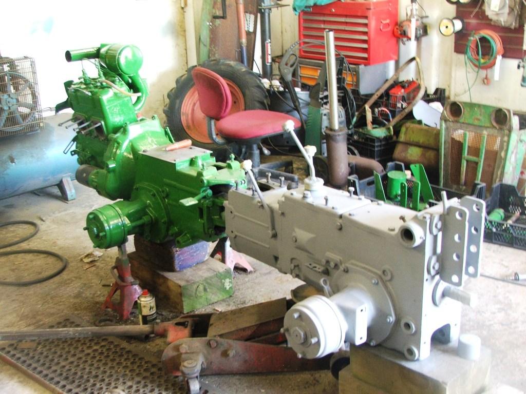

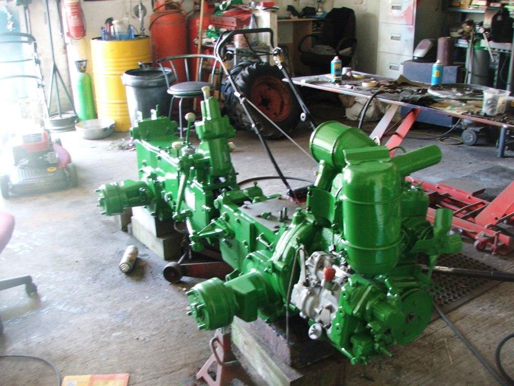

    #1281

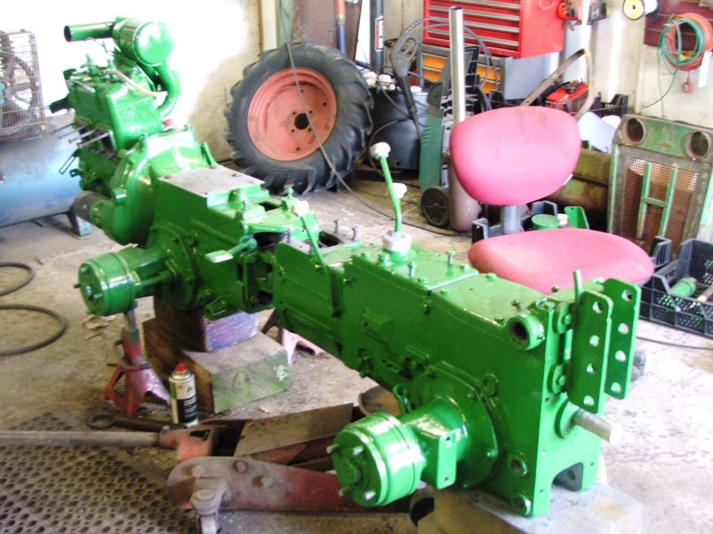

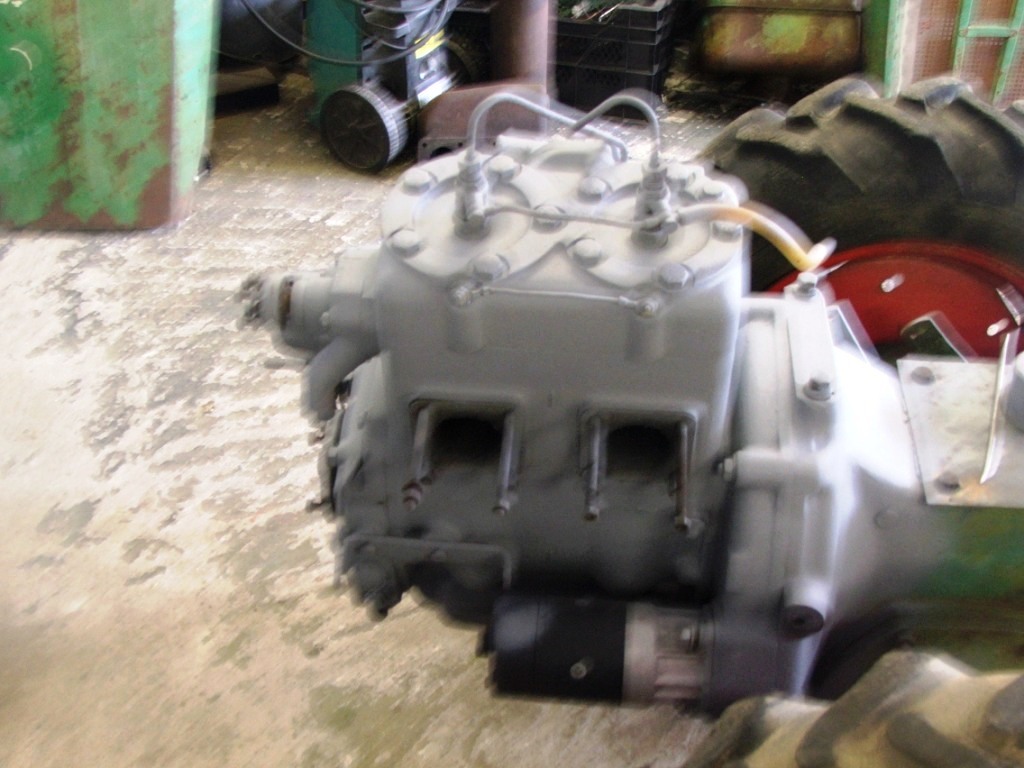

    done a little bit more

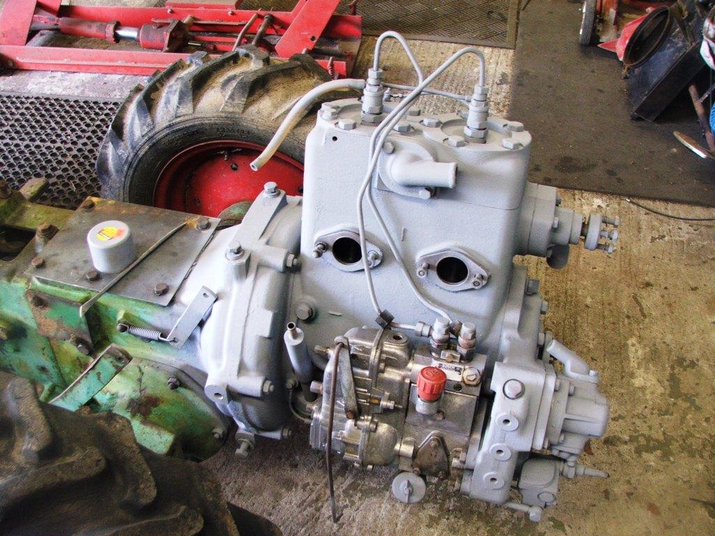

    #1286
    bit more

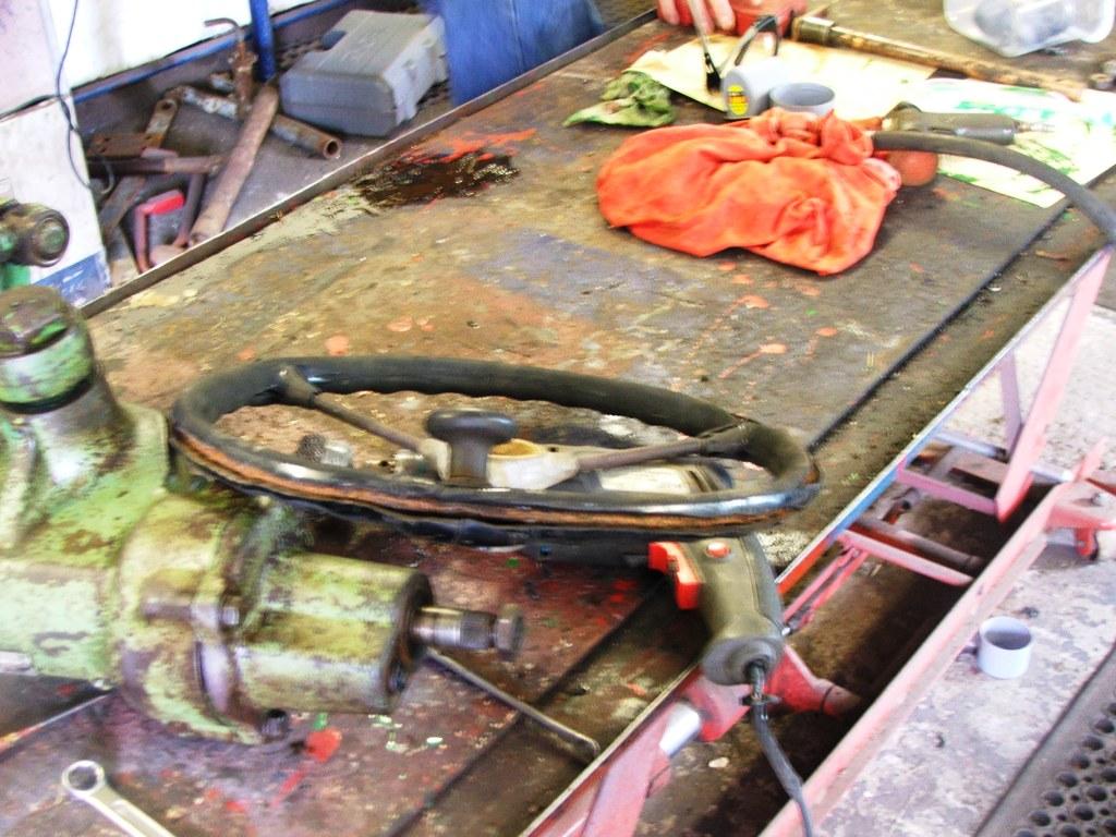

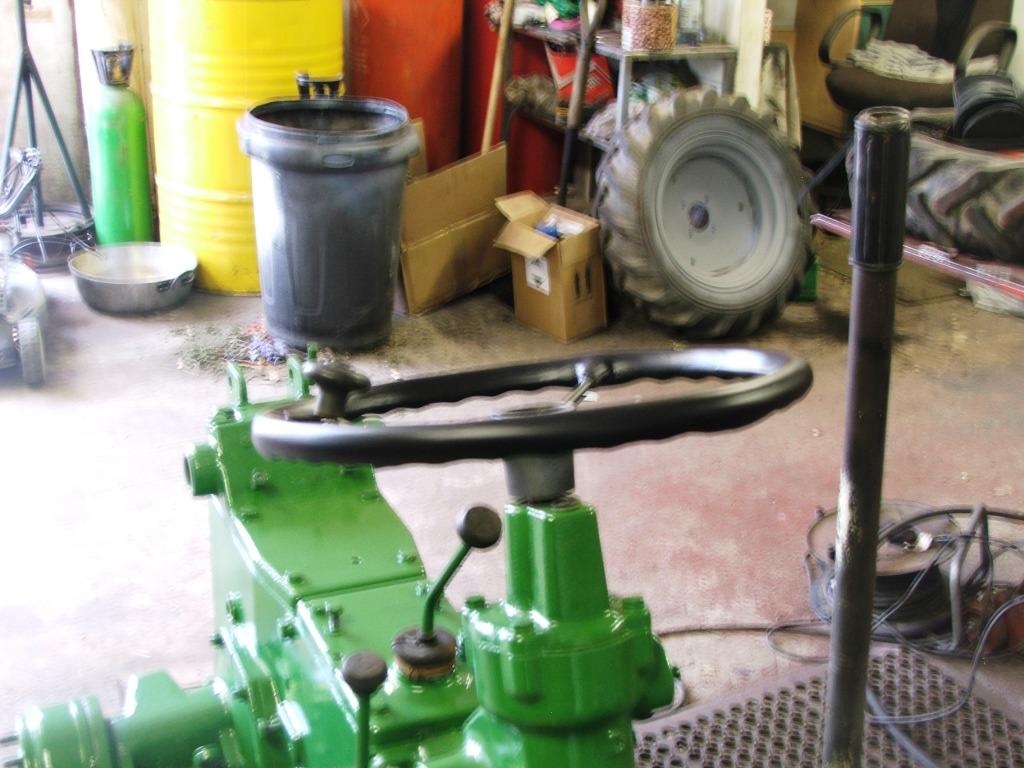

    #1292

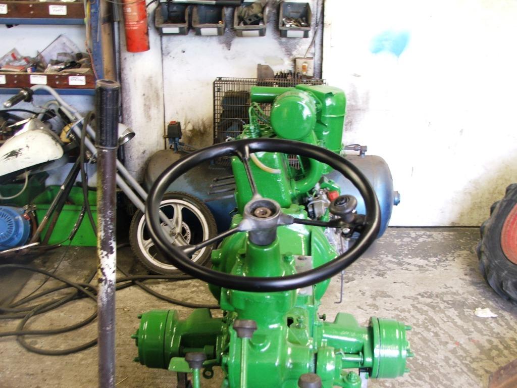

    i had a fight taking the steering wheel off i had to use heat, once the blue tape was removed you could see the extent of the damage i will use the simar kids suggestion of the way to repair this

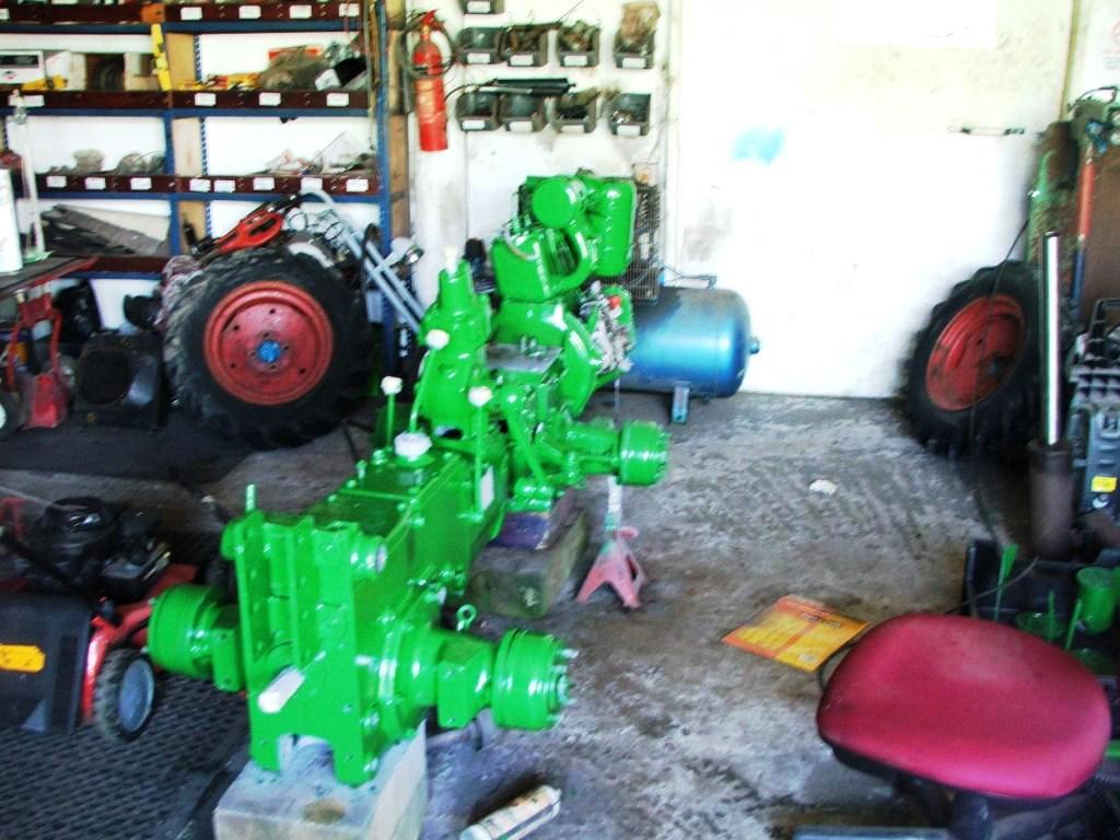

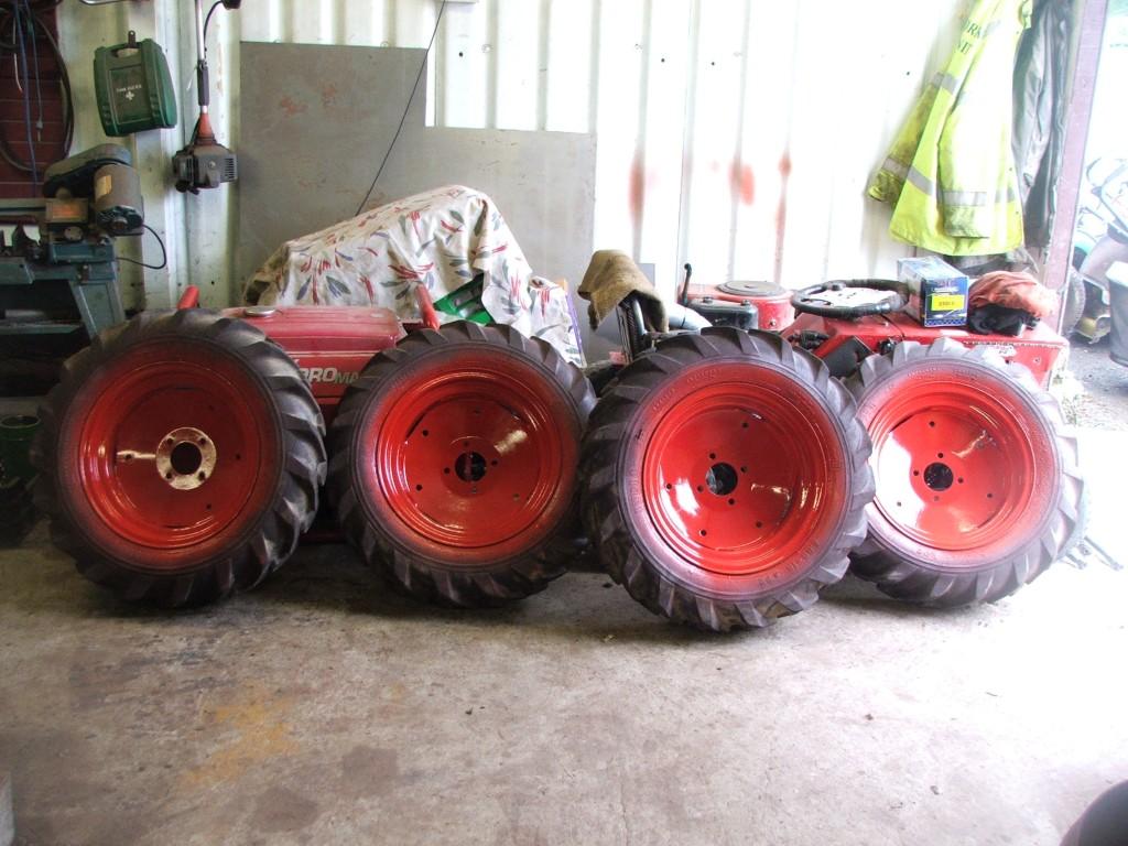

    #1299

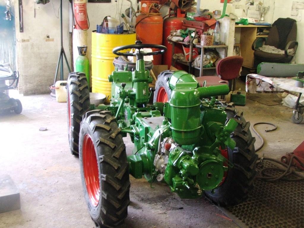

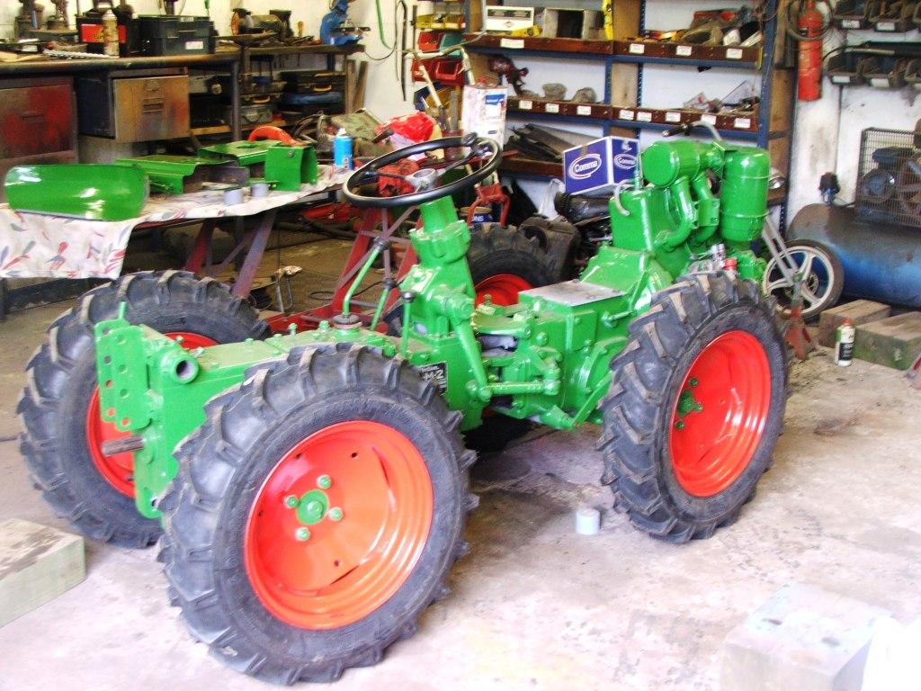

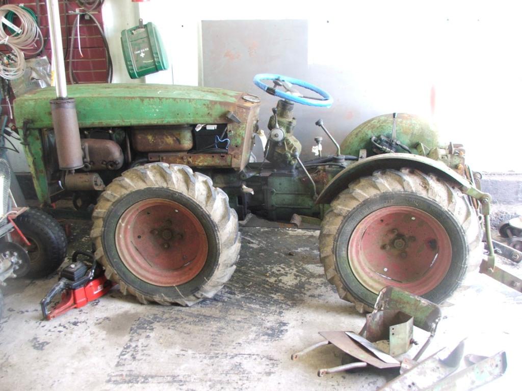

    got the wheels painted today i left the old tyres on cos i need to get the chassis movable again and i want the paint to harden off i will probaly give them another coat just before i fit the new tyres

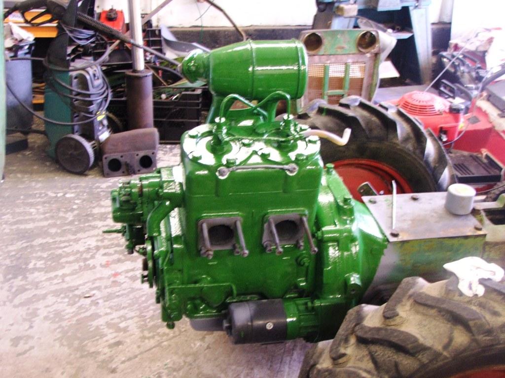

    #1307
    new tyres on, and a few more bits done

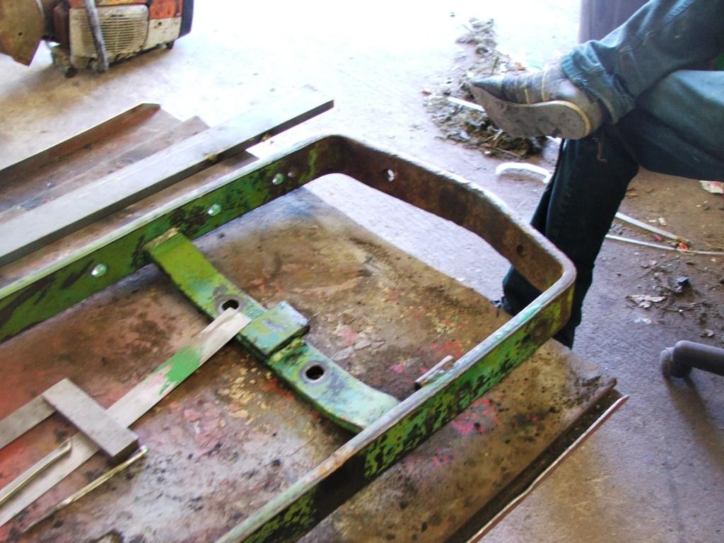

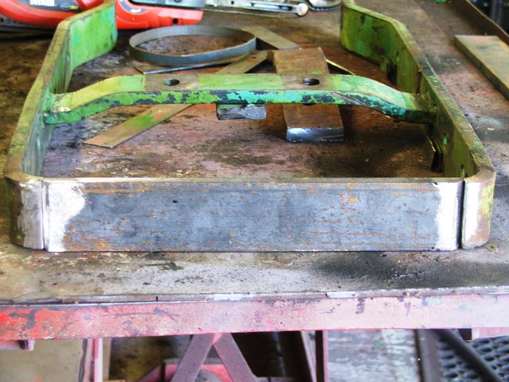

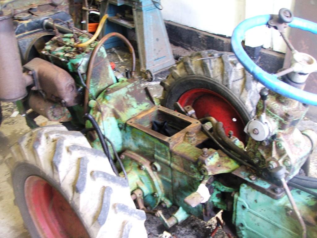

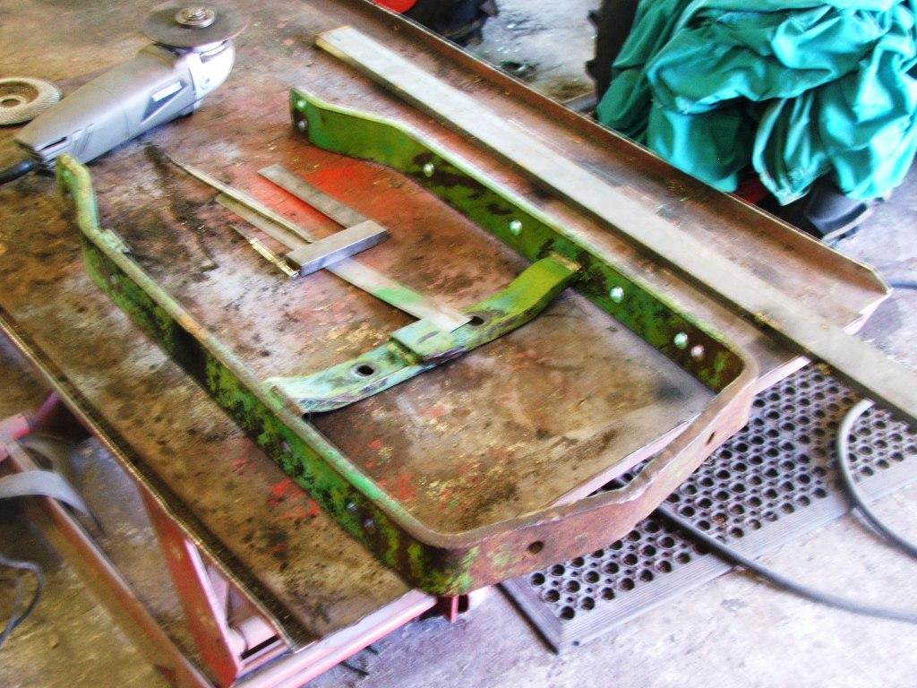

    #1312

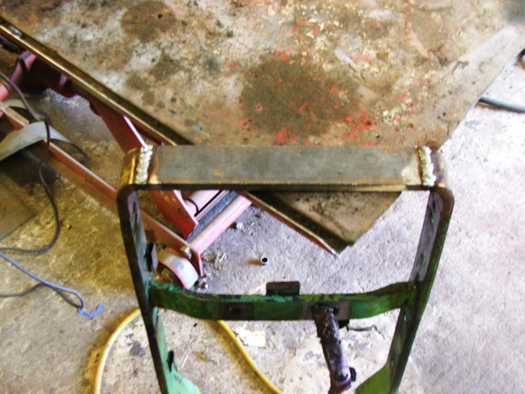

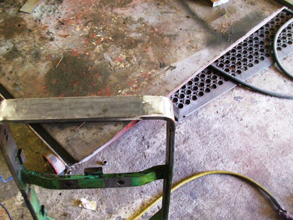

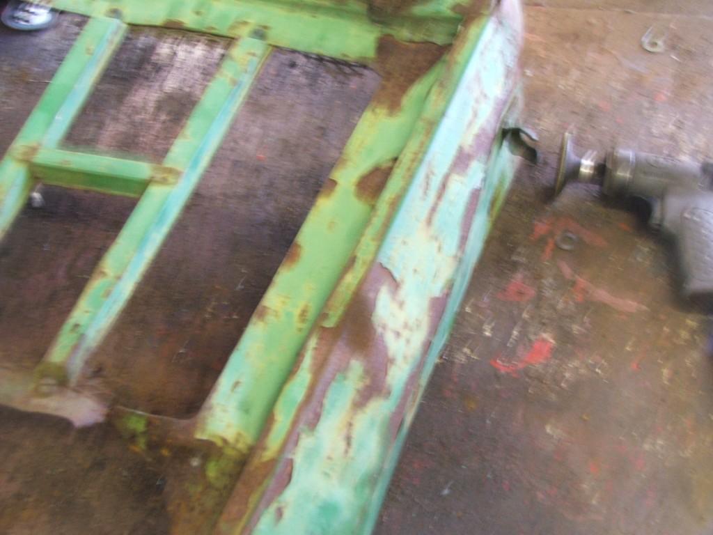

    did a bit more today this is the front chassis rail it bolts to the engine and holds the front cowling /rad etc, it had in its time got very bent and had been welded many times so it could not be straitened so this is how i solved the problem
