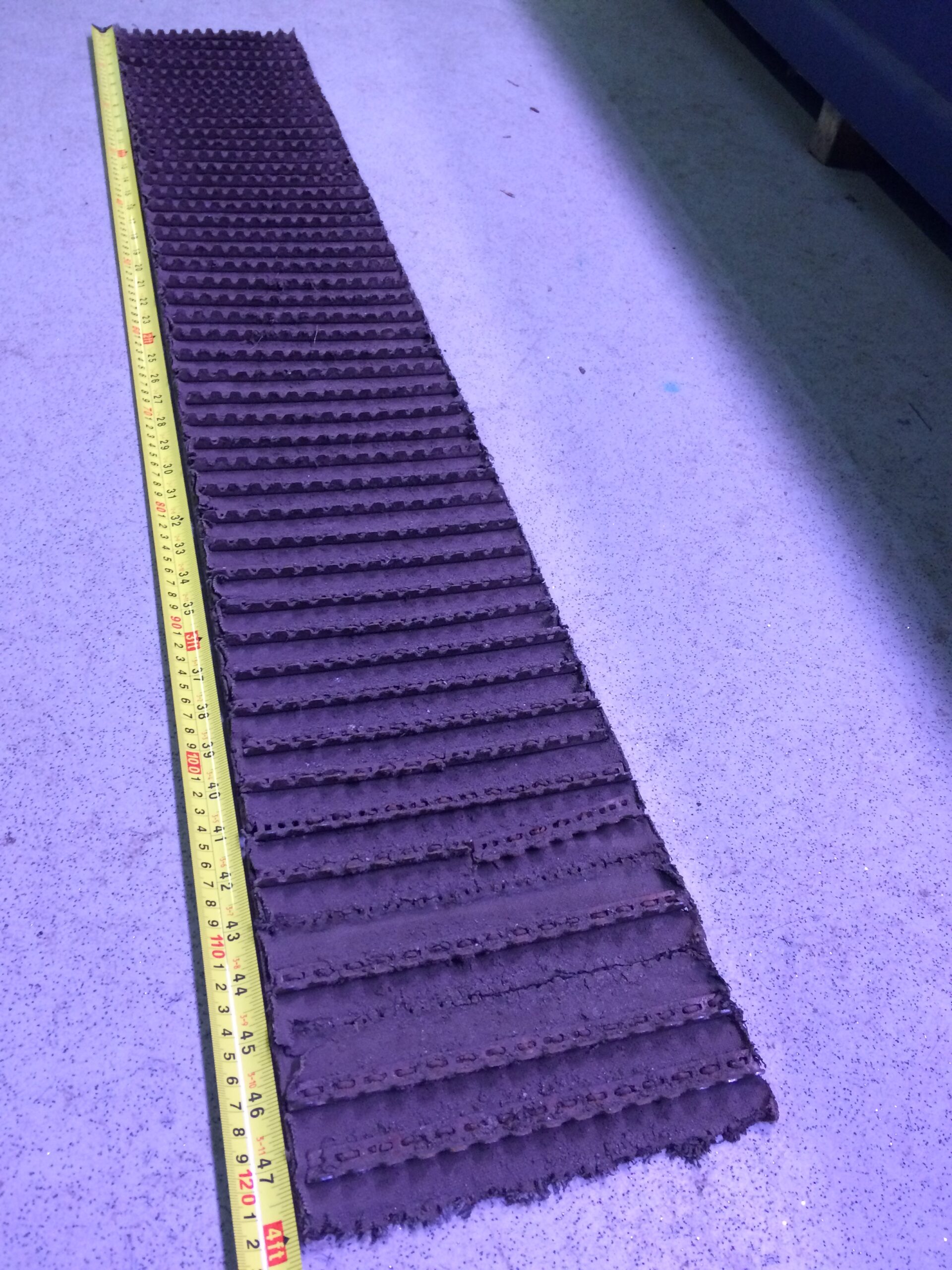

    Hi Guys. Thankyou for the responses, I thought I’d post a few photos so you can get the gist of what I’m talking about.
    The problem I’m getting isn’t the belt, everyone does belts Lol, it’s the tines (teeth) attached to the belt where I get stuck.
    Royer industries was the one that wanted $600 for the privilege, which I thought was a bitter pill to swallow just for a belt.
    I am trying the other contacts joegrgraham and you hortiman kindly gave me but I’m not holding out much hope.

    Are the upstanding combs stapled on to a canvas belt? If so why not try rebuilding what you have with new canvas?

    Yes the steel combs were stapled on the standard looking conveyor belting, the replacement one I purchesed 20+ years ago from Royer Industries was not as well stapled as the original one. If someone could cut out some combs for you they could probably be fixed with industrial quality staples, I think they were copper if I remember correctly, I guess pop rivets and flat washers would do the job.
    It could be worth trying Peter French, Hillside Nurseries, he just might have a spare belt, 01424 870315, he is quite an elderly Gentleman now, but keen on his horti machinery.

    So it looks like I might try stapling the tines to a new canvas belt myself. Any idea’s, hints or tips on where is might get the staples and what tool/ tools to use to attach it to the belt.
